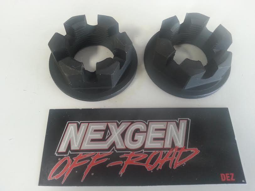

jpaull wrote:
Neil,
I have a few of the Empi Axle nuts and they are downright scary. I would not torque those over stock specs at all.
I ordered a few of these Latest Rage brand below and they are way better then the Empi. Notice they are flanged but still maintain the proper height. Those Cheap empi ones don't have the amount of thread contact area needed, and metal quality is a big guess.
These 36mm Heavy duty Forged Chromoly are the best I have seen:
I noticed the lower EMPI thread engagement as well, plus the notches are not radiused. I'll keep the EMPI axle nut as a spare for my next 1500 cc stock
Beetle.
I ordered the forged chromoly Latest Rage axle nuts (501130) from CIP1.ca, as I'm in Canada. I'll be more comfortable torquing with the torque tool to 270 ft lb (plus a few pounds more, to line up the cotter pin).

Glad you found them! Yes thats the part number, you will be much happier with those

Why not go nuts and order these?:
http://www.csp-shop.de/cgi-bin/cshop2/front/shop_main.cgi?func=detail&artnr=24478a
It not only reduces unsprung weight but is made out of titanium(stronger and lighter)and reduces the weight of your wallet in the process Laughing Laughing
I would search for stockers or go chromoly.
