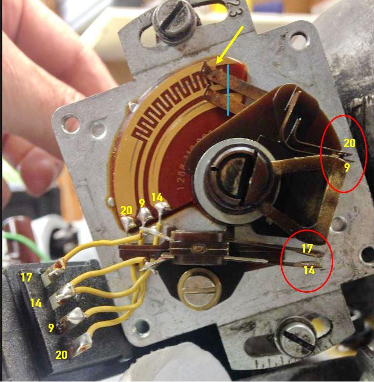

Right now we are ONLY talking about what I call the early 4 wire TVS….with the four wire soldered plug.
It has two main circuits/switch sets:
A. the idle running circuit and switch…which is NOT enrichment. It’s just basic fuel for idle.
B. The fuel enrichment circuit for during the period of throttle opening movement.
This enrichment does not happen or continue…unless the throttle is in motion. It is essentially…the equivalent of the accelerator pump in a carburetor.
In the red circle with red trace connected to pins #14 and #17 is the “idle”/throttle closed contacts. When these are closed/connected, the switch in the yellow circle will be open. There will only be fuel supplied by the ECU to run basic idle.
In the yellow circle is the enrichment switch that connects to the inside wiper arm or ground track and is ALSO connected to pin #14 as you can see in the white circle and the switch connects it to pins #9 and #20 alternately as the outer wiper arm moves over their tracks. When the throttle moves and the “idle” contacts open/break contact, the enrichment switch connects/makes contact.
Pin # 14 does double duty. It is effectively the ground pin for the wiper/enrichment circuit AND the idle switch/circuit. It should never serve both contacts at one time. One should always be open and one should always be closed depending on throttle position.

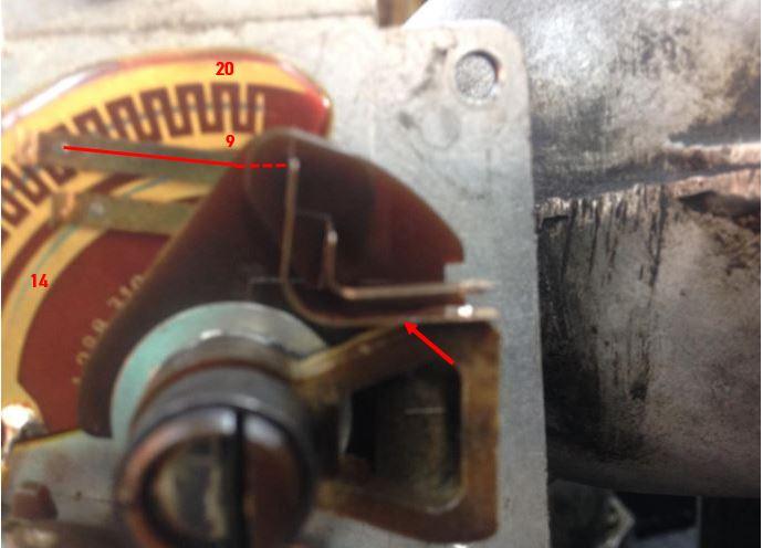

BUT…..at the same EXACT time that the acceleration “start” contact closes….the position of the actual contact on the tip of the wiper arm MUST be either on…or very close to the lead edge of one of the alternating wiper contact strips for # 9 ….it must be within just a couple of thousandths of an inch….from moving onto one of the wiper strip contact pads and starting enrichment….like in the sketch below.
Sorry I did not redraw this…..it is just to show that the actual wiper contact DIMPLE…must be at this very close position to the first wiper pad of track #9.
Technically the wiper arm contact could even be positioned already ON or in contact with the first contact of the closest strip…which is #9….but the difficulty is that with the slop in the hub…by the time the acceleration contact is actually closed and making contact…..the wiper tip may actually in one of the spaces BETWEEN two contacts on tracks #9 and #20…leading to a FLAT SPOT.

2. First important Observation: Look at the contact button/tip on the wiper arm. Where is in in relation to the first step or crossing point of the “zipper” on circuit track #9? It should be about 1/32”…maybe a little less… from the first contact on the wiper strip?
If this contact button on the wiper arm is too close…..like maybe just a few thousandths it is a little too close….turn the TVS plate slightly more toward closing the idle switch you just checked in step #1. It will bend that leaf switch back a little more but this is no problem.
This is why that switch is a “leaf” switch…so you can bend it back a little under pressure during positioning without damage.
The most common observed condition is that the wiper arm contact…will be some distance…like 1/32” or a little less from the first step on track #9.
This is normal.

Thanks for the feedback. To clarify:
1. what you are doing at step #3...is identical to what you are doing at step #6.
To clarify....I added to step #3 to look at the diagram below step #6. I also added to the image....a red line from teh contact you need to have your probe on so its clear what tracking you are checking.
To further clarify....at a quick glance....without inspecting what you are putting your probe on...you WILL get it backwards. The copper contacts...cross over each other.
This is the altered sketch I added to clarify which half of the switch to put your probe on. You can now see that just because the wiper arm is on the outside...does not mean that its switch contact is on the outside. Wink
Here is a shot of that from your picture:

Back at it. You can see in my pictures that the middle "button" that connects to the throttle shaft has play. I can rotate about .04 inches without the throttle shaft turning. I think that this play is making adjusting per Rays directions difficult. Should there be movement of the button about the shaft without turning the shaft? If so how do I adjust the play out? Thanks
The throttle is closed in this picture. Picture meant to show free play not contact placement. Just to verify from top to bottom the wires on the TVS pin assembly are 17,14,9, and 20. Thanks
No....That play between shaft and D shaped hub.... is NORMAL and required.....
This is what makes TVS adjustment.....not just a "move it one notch" and lock it down process.
Understand.....when the throttle is closed .....and the TVS is properly adjusted.....the hub....is very lightly spring loaded.....forward.....towards enrichment.......by the enrichment off/idle contact switch leaves....which are a spring. And at the same time the throttle plate and shaft are kept pulled closed by the throttle return spring......loading the shaft in the opposite direction toward closed/off.
The whole object of this.....is that when you push the throttle..... the throttle plate will move just about 2° toward open before taking up the slack in the D shaped hub and starting to move the hub and wipers toward enrichment.
The throttle NEEDS to open this 2° .....BEFORE enrichment starts to get air moving into the engine to mix with the fuel you are about to give it.....AND....give a small but critical drop in vacuum to trigger the MPS to give SOME enrichment.
This is what this adjustment is ALL about. You need that 2° of throttle movement BEFORE enrichment starts......or you get a rich stumble......BUT..... you also cannot have MORE than 2° movement before enrichment starts.....or you get a lean stumble.
And.....most importantly.....because of how critical this extra fuel enrichment is to off the line drivability....and especially shift points and the "bucking syndrome".........DO NOT......start adjusting the TVS......until FIRST adjusting the valves and ignition correctly, making sure advance is working and coming in on time.......and only then adjust the TVS.........and then....when its nominally driveable (knowing the TVS may still cause issues off the line).....make sure your fuel mixture at the MPS and with fuel pressure is spot on.
This is critical to getting very smooth driving and perfect fuel mixture.
Why? Because if you are already running rich or lean.....the TVS is an intermittent load enrichment device. Its input is a multiplier to whatever fuel mixture the MPS, fuel pressure and TS-1 and 2 are already giving you. If your baseline is wrong.....the TVS can make it,feel worse.
Really......if you are correctly adjusting the TVS.....you can adjust it at any time. You do not have to adjust the ignition first......but I suggest you do all of the footwork first.
The volt meter and observation of the contacts will tell you when the TVS is adjusted properly.....but not being used to it.....when a perfectly adjusted TVS causes the engine to run "different"......too many people starting dicking with it.....when the problem is really elsewhere. Ray

I explained a piece of that last answer poorly. So to clarify......a small amount ....the smalleat amount.....of the slack you are seeing between shaft and hub.....is actually between the shaft and the walls of the D shaped hole in the hub. That hog ring/ C-clip keeps this uniform.
Most of the slack is between the shaft hub and the wiper arm hub.....but the amount of slack you are seeing ia pretty normal. It is only deemed excessive......if you notice that the slack eqyals more than 2-3° total rotation at the wiper tips. Ray

Question #1 from back on June 23rd:
Question #2 from July 16:
Ray, I have been following your instructions on adjusting the 4 prong TVS and I can’t overcome the slack in the center hub. I keep getting a beep on 17, and 9,20 whisker before there is any movement of the arm on to the first contact strip. It seems that if I bent the whiskers apart some it might allow the contacts to close when the arm is on the first contact strip. That might overcome the slip in the hub which seems to allow the contacts to close before movement of the contact arm. Does this sound reasonable? Any other ideas? You can follow our conversation on the type 3 early TVS thread. Thanks a lot. Tom
So, the picture you posted June 23rd is instructive in several ways:
As a recap so you do not have to keep scrolling backwards, below is your picture with the wire/pin #'s applied and a few cryptic marks I will explain:
First: a couple of things you must remember and keep in mind:
1. There are two sets of contacts in these and all TVS. One for off/park/throttle closed and one for on/inject/enrich. In the picture below the “park/off” contact set is in the red circle with 14 and 17. The “enrich/on” contact set is in the redcircle with 20 and 9.
2. At park/off the 17/14 contact set is closed/touching together and the 9/20 enrich/on contact set is open/not touching.
During enrich/on cycle when you open the throttle, that reverses and the 14/17 contact set opens and the 9/20 contact set closes.
3. These two contact sets (depending on the hub tolerance and wear) “MAY” both be “open” for a very small amount of degrees of rotation…..BUT….they can never both be CLOSED at the sme time.
4. MOST IMPORTANT RULE TO REMEMBER:
Ideally, the 14, 17/park contact set MUST be open…not touching… AND…. the 9, 20/enrich contact set MUST be closed….touching….BEFORE the wiper arm starts to move.
Why is this?
Because if 14/17 contact set does not break contact, then the 9, 20 contact will not be “live” and you get no enrichment.
The IDEAL situation is to have the 14, 17 contact break open the smallest amount of time/degrees as possible before the 9, 20 contact closes, to not have a time lag.
SIMULTANEOUSLY…..that same small gap/time lag should also apply to how long it takes the wiper arm to move onto one of the hash markes on the wiper strip.
However, Its too difficult to get all three of these “time gaps” to happen at one time….so to take the wiper arm tip out of the equation….it should be “parked” within a couple of thousandths from the edge of the first hash mark or right on the start of the first hash mark so that the very millisecond that the 9, 20 contact closes….you have instant enrichment start with no time lag.
An observation based on your picture from June 23rd:
Observation:
You say the throttle is “closed” in this picture. You also note that you are only trying to illustrate the amount of slack in the hub at the D-shaped shaft. I get that.
I am assuming that you are holding the throttle plate closed and have rotated the plate counter-clockwise for this picture right?
Note the yellow arrow points to how far you are advanced onto the wiper strips. You are either on strip 3 or in between strip 3 and 4. The blue line shows how far you are from the maximum “park”….throttle closed….position.
This is too far.
Its not the slop in the hub you are fighting. It’s the adjustment/position of the 14, 17 contact set.
Do this:
1. Clamp the throttle plate closed
2. Turn the TVS plate clockwise until the wiper arm tip on track # 14 is approximately on the blue line park area.
Really, since the inner wiper arm in contact with track #14 moves at the same time as the outer wiper arm that contacts tracks #’s 9 and 20, you really want to make sure that the little “pellet” or ball on the outside wiper arm is either JUST touching the first mark of track #9 or is just a couple of thousandths from touching it. A really minuscule gap. Track #9 is the first wiper strip in line.
3. At this point you TEST THIS by the book method of rotating the plate CLOCKWISE by 1 mark….which is ~2°. As you rotate through that 2° mark….the 14, 17 contact should open. And when you rotate even a half or third of a degree further, the 9, 20 contact should close and the outer wiper arm tip should be in the middle of the first tick mark on wiper track #9.
What will usually be found wrong at this point:
4. You will probably notice that with the throttle plate clamped closed, and the TVS plate rotated counter clockwise to put the wiper arms in the park position…..that the 14,17 contact set is BENT backward too far.
THIS IS THE PROBLEM YOU ARE HAVING!
What you need to do is:
5. As per above, clamp the throttle plate closed. Use a clamp or something. You will need both hands. Rotate the TVS plate counter clockwise until the wiper arms are in the position I described above in #2. At the blue line and the first hash mark of circuit #9. Contact set 14, 17 should be closed-touching each other and contact set 9, 20 should be open- not touching each other.
LOCK THE PLATE SCREW LIGHTLY…temporarily…to hold this adjustment.
6. Loosen the screw in the yellow square in the picture below: Rotate the contact set clockwise just slightly until the 14, 17 contact set just opens up. Now close it by rotating the contact assembly counter clockwise until it just touches and closes the 14, 17 contact set.
All this while, the wiper arms should be stationary and the 9, 20 contact set should remain open.
7. Now, lets do the factory adjustment. Make sure the throttle plate stays clamped closed. Rotate the TVS plate clockwise 1 graduation mark which is ~2°.
During this 2° rotation, the 14, 17 contact should NOT open up…..but should be very close to it.
Also, the 9, 20 contact set should NOT close…but should be very close to it.
Also, the wiper arm tip should not be fully on the first hash mark of wiper strip #9 but should be either just a few thousandths from touching or just touching at the very leading edge of it.
The OBJECT being is that another 1/2 degree of rotation should close contact 9, 20 AND simultaneously have the wiper tip somewhere on the first hash mark of contact strip #9.
So, the tolerance in your “D” shaft may or may not be excessive….but you should be able to work around it. The trick is to do that by adjusting the position of the 14, 17 contact set via the mounting screw on the TVS plate.
The reason that 14/17 contact set is installed with a screw is because all of this had to be done at the factory on some jig.
Over the eons, you get throttle plate/shaft wear and maybe some bushing on shaft wear and some fatigue to the contact set spring rates etc. Or, it could just be that a previous owner played with that screw!
Then this “sensitivity” adjustment needs to be reset.
Is this all clear?
Ray
