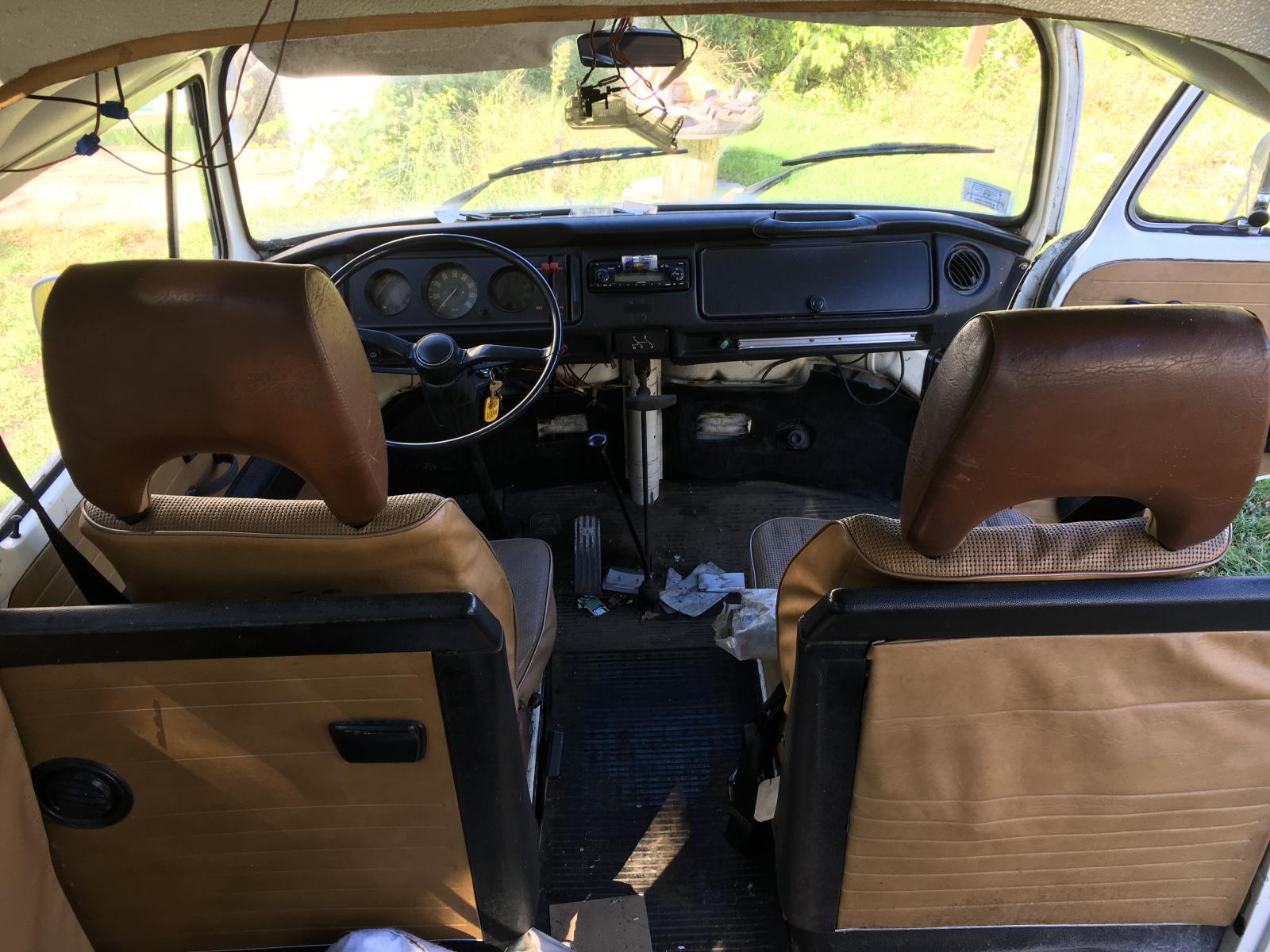

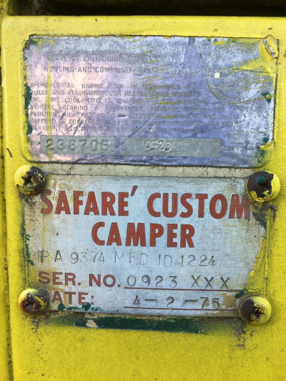

Some more pics of the bus.
Here on the door jam you can see the safare paint job matches the top with a tan and tan/cream top

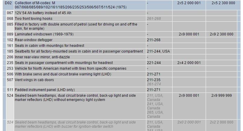

m code plate

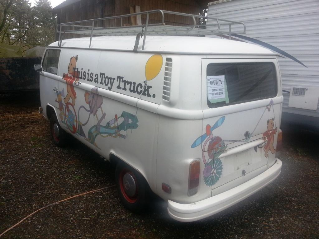

The tire cover reminds me of the Toy Truck.

Ah, the toy truck. Yet another piece of vw history forever erased.... Smile

That Grateful dead Marching bears tire cover would look bitchen on the Toy Truck.

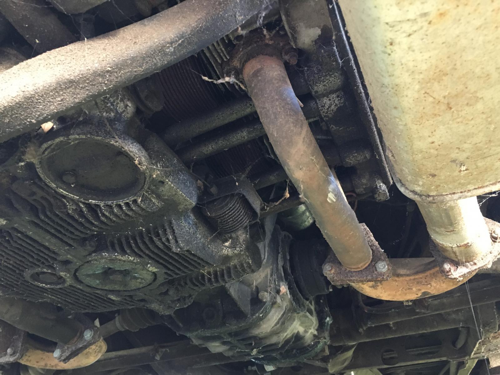

Got around to taking some pics of this weird exhaust. Super homemade but solid as a rock!

You're missing the lower engine tins that go between the heads and pushrod tubes. You'll want to hunt those down so the engine doesn't overheat. Also, because the heater boxes are gone you'll need to block up the holes that usually blow fresh air into the heater boxes. You'll just be letting hot air in from the exhaust that'll get blown back into the engine bay.
