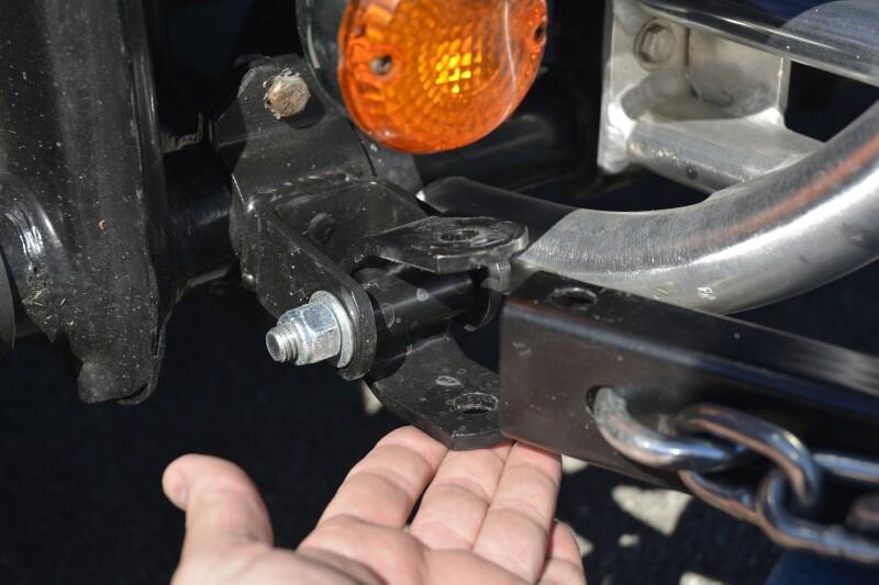

I purchased a Tow Ready Tow Bar (part #63181), along with an extra pair of front beam chassis clamps. Because the tow bar’s factory bumper bracket adapters would not be the optimum way to go for my application, a friend of mine was able cut down some U channel that he happened to have laying around and weld them on to the chassis clamps. We were fortunate that the inside measurement of the U channel was what we needed. He was also able to drill perfect holes to allow for the included ½” wire-lock pins.
Once I painted and installed the modified chassis clamps, it was time to assemble and attempt to install the Tow Ready tow bar. In order not to need an extra set hands, I decided to find something to use that would give me the correct height as I attached the tow bar to the brackets. I was lucky to have 3 foam shipping blocks that I could use as risers. At one point I thought that I was going to have to remove my front bumper, but once I decided to switch the positions of the ½“ bolts and the ½” wire-lock pins, my clearance issue was resolved; although just barely. (Because this is not the way the system is designed, I am not saying that I recommend this for anyone else; but in my case the modification fit my needs). I was also fortunate that my front turn signal mounts are actually made of rubber; this allowed me to easily drop the wire-lock pins into the mounting holes. As you can also see by the photo, I added nylon ties to the wire-lock pins to act as pull tabs so that I could engage/disengage them with less effort.
Once the tow bar was installed, the next challenge was to come up with a way to suspend the A frame coupler of the tow bar so that I could maneuver it over the hitch ball (a 2” ball is required with this Tow Ready Tow Bar setup). This actually ended up being easier than I anticipated. I attached a ratchet strap to the A frame coupler; it ran over the windshield and back to the roll bar. I ratcheted the coupler up a couple of inches higher than the ball, and with that setup I was able to literally drive up to position the coupler over the ball. Just as a precaution, I decided to add padding to the hitch, just in case I got too aggressive with my positioning.

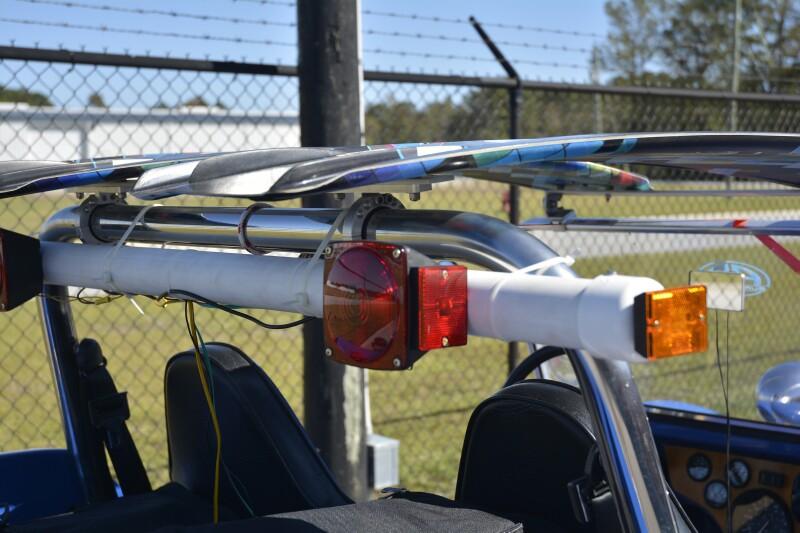

As far as trailer lighting was concerned, I decided to mount a set in a PVC tube and temporarily attach it to the roll bar using nylon ties. My wiring layout was more functional than cosmetic; I may rewire the tube at a later date so that more of the runs are hidden. I also added a 4 prong splice between the PVC tube and the tow bar so that they would be 2 separate units. I may even tap into the rear taillight wiring on my dune buggy so that I could eliminate the PVC lighting tube entirely.
Now, what I am about to tell you is only based on one trip, to Manx on the Banx and back; approximately 3 hours each way. Knock on wood; it was literally a breeze. The overall length of the tow bar is 42”, so it easily fit behind the backseat of my 4Runner after removal. I did not have to find a place to keep a trailer when it was not in use. I do not have a locking steering column, so that was not a factor. Front end should be in good alignment. As we also know, gearing must be (and stay) in neutral. Anticipate where you park; backing up is not an option. Please let me know if you have any questions. _________________ Gary David Holbrook

Gary, Great idea on making a towbar setup for a non VW front suspension. This looks almost foolproof. You may have solved the towbar problem I have with Jayne's KickOut. Thank you.
Is there a reason that the safety chains do not attach the actual buggy frame. It appears that the only thing that is protected is the towbar. From experience, it is necessary that the safety chains/cables be attached directly to a solid mount on the chassis. This also requires that the safety chains/cables bypass all of the hitch and towbar attachment locations.
You always want the towed part of the vehicle to remain behind you, and be controlled from it's position. You vehicle may get a ding or two, but no one will be seriously injured or killed. |
Back to top |
Gary0302 Samba Member
Joined: August 29, 2007 Posts: 596 Location: Coastal NC
Posted: Mon Oct 24, 2016 10:20 am Post subject: Re: Tow Ready Tow Bar - install and use |
IowaRedManx, thanks for the compliment.
In the photos shown, the safety chains are not actually hooked up for travel. There are 4 separate safety chains. The set closest to the front beam actually wrap around the lower tube, and the set closest to the A frame coupler attach on either side of the receiver that is mounted on the rear of my 4Runner.
However, even though it was not designed as such, I like the idea of connecting the 2 sets of chains, using extra chain and quick connect links; I may take you up on that. _________________ Gary David Holbrook
