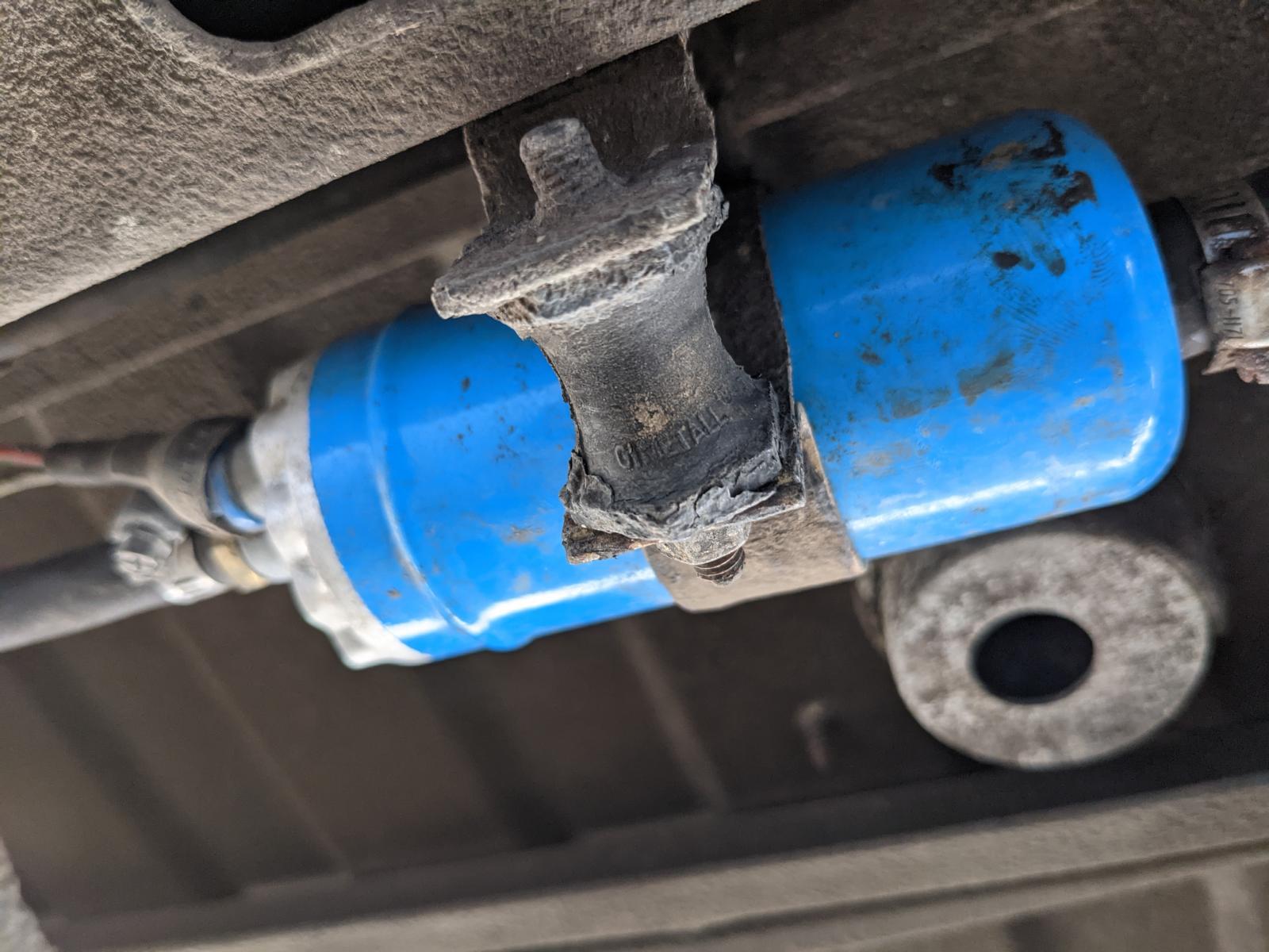

Fuel pump and filter - look relatively new from PO. Fuel lines also newer than expected (I didn't replace)

Vacuum hoses - indeed did replace the hoses connected to the AAR, and vacuum advance. also sprayed the rest (i.e. intake manifold) with starter fluid to check for leaks and no change when sprayed. You're right may still be cracked underneath.
Throttle switch - @wildthings checked with voltmeter and it should be working properly. Also according to Bentley, for my rig (2.0L air cooled) that is a rich-related switch only engaged when at full throttle. So potentially unrelated to my stalling issues (see reproduced scenario below).
Also took for test drive yesterday to these results -
Started fine, and held idle in driveway without issue for 1-2 minutes. Then took on road, no issues for 5-10 minutes going 30-40 mph.
Decided to go further and faster. Another 10 minutes and going ~50 mph, I hit a red light. and can feel it stalling. Pull it into a parking lot and it dies. I then had to keep it gassed while in neutral (it's A/T) at all lights to get it home.
Seems as if it's not getting enough fuel when warm. This is also the exact scenario that led me to create this post a week ago. So was able to reprodue the problem.
Thinking maybe it's a sensor or something else fuel related. What do you all think?
