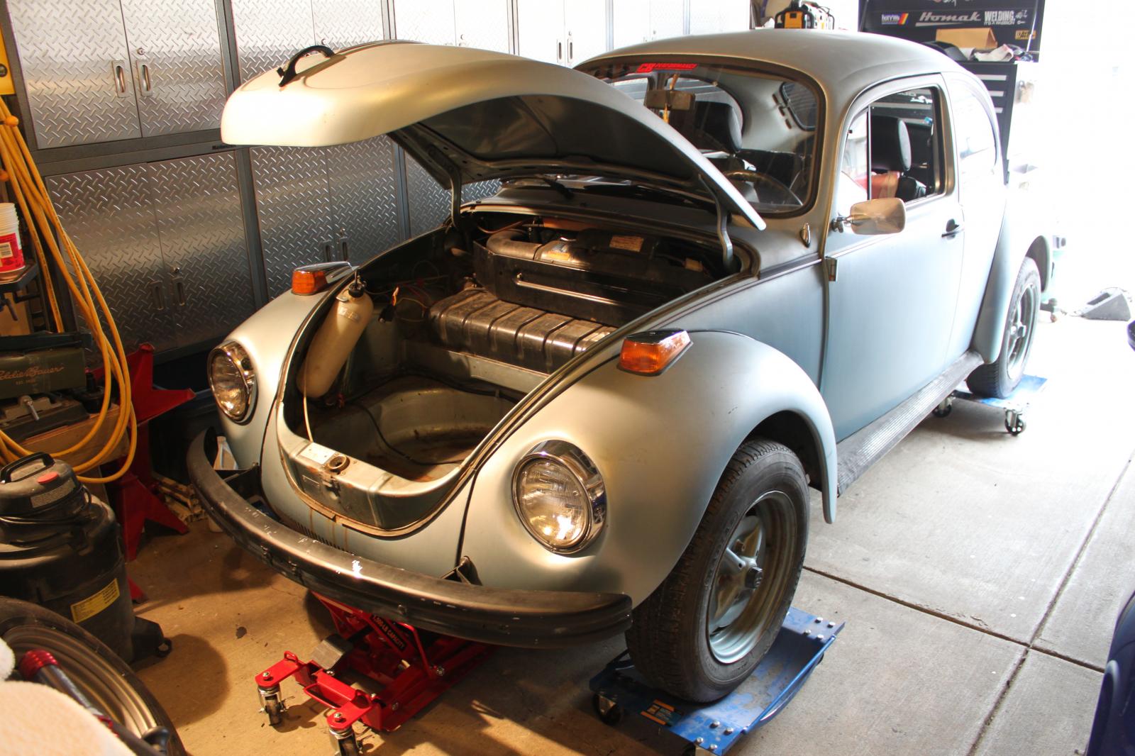

Well, I've been around here for a while now, and have been running my Sports Bug restoration for some time (sadly making little progress). Unfortunately, my available time has been so limited that for now I've decided to shelve those projects. There was still just so much that needed to be done. My desire to drive a Sports Bug again drove me into a new direction. That being the case, I've packed them away in storage.
Picked up a real solid 1973 Sports Bug (Marathon) off a seller right here on thesamba. The car arrived late last week, and I've been pouring over it ever since it arrived... The car has happily turned out to be very solid (as I had hoped). One minor rust hole in the driver side fender well that's going to need to be patched, and some holes that were cut in the rear fender wells to adjust dual carbs. That's the bulk of the major bodywork (quite minor in fact).
Planning on taking all of the new parts I've been buying over the years and apply them to this car in hopes of getting the car on the road this coming summer.
Inside... OMG does it smell NASTY! Probably the worst smelling VW I've ever encountered. Think that dealing with that is going to be the first thing I dig into. Carpet, headliner will be stripped out first, and the seats pulled. Planning on going with new Sewfine covers for the front and back.
Looking forward to turning some miles this summer... Should be able to make some good progress installing new parts over this coming winter.

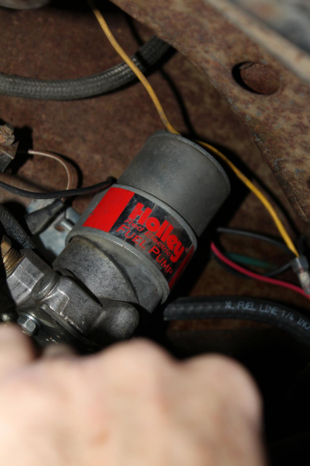

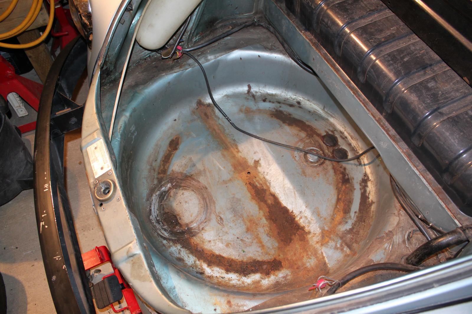

So yesterday I felt it prudent to drain the fuel tank before turning on the garage heater. As it turned out, whoever owned this before me had reasonably recently been driving/maintaining it, as it had a newer looking electric fuel pump and fresh looking lines under the car. Drain the gallon of gas that was in there anyways (better safe than sorry).

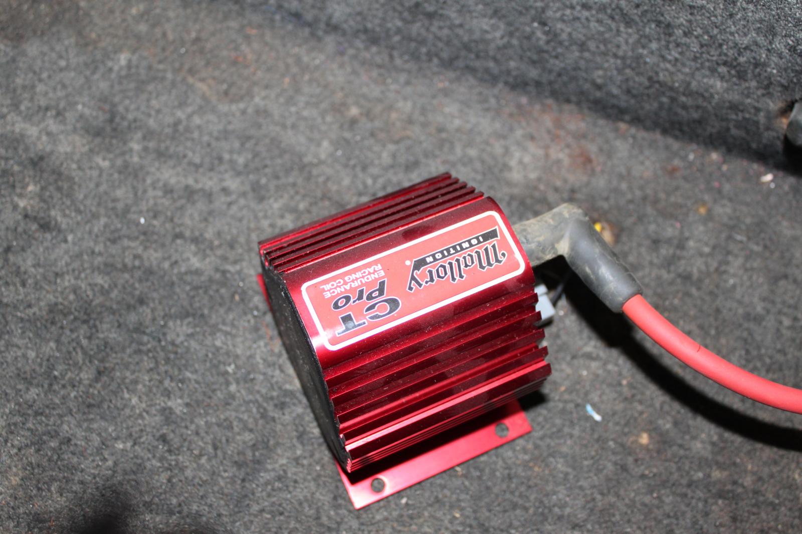

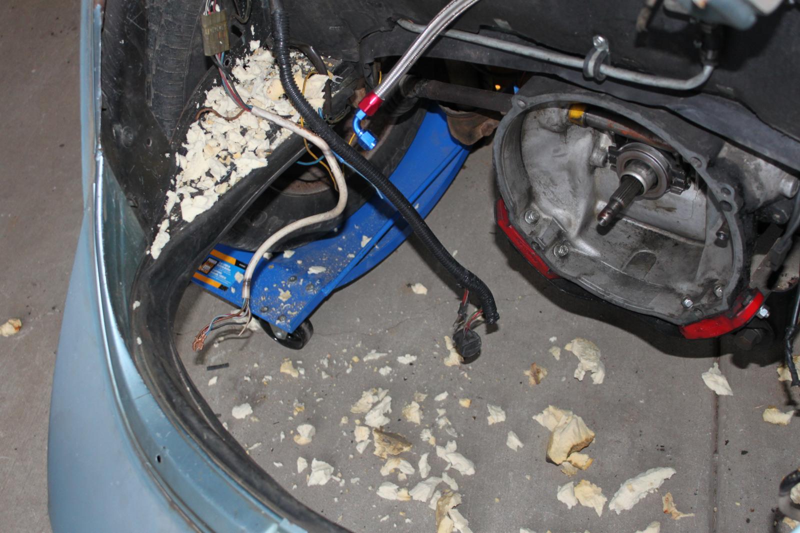

Poking around, I found some interesting evidence of what used to power this car.
Guessing some of this stuff is the remnants of the motor that was previously in this car. I plan on putting a stock 1600cc engine in this, so I'll be pulling at least the fuel pressure regulator and coil out.
Wondering what your guys thoughts are on electric fuel pumps. Historically I've had problems with the mechanical stock ones. With the emergence of mexican reproductions I can't imagine their reliability has gone up. Confused
Do you think (if that Holley pump works), it would be a viable option to leave it in there (of course putting a fuel filter in line might be a wise decision).

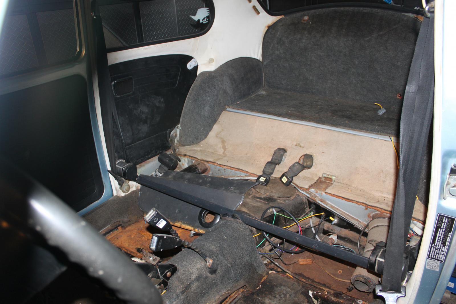

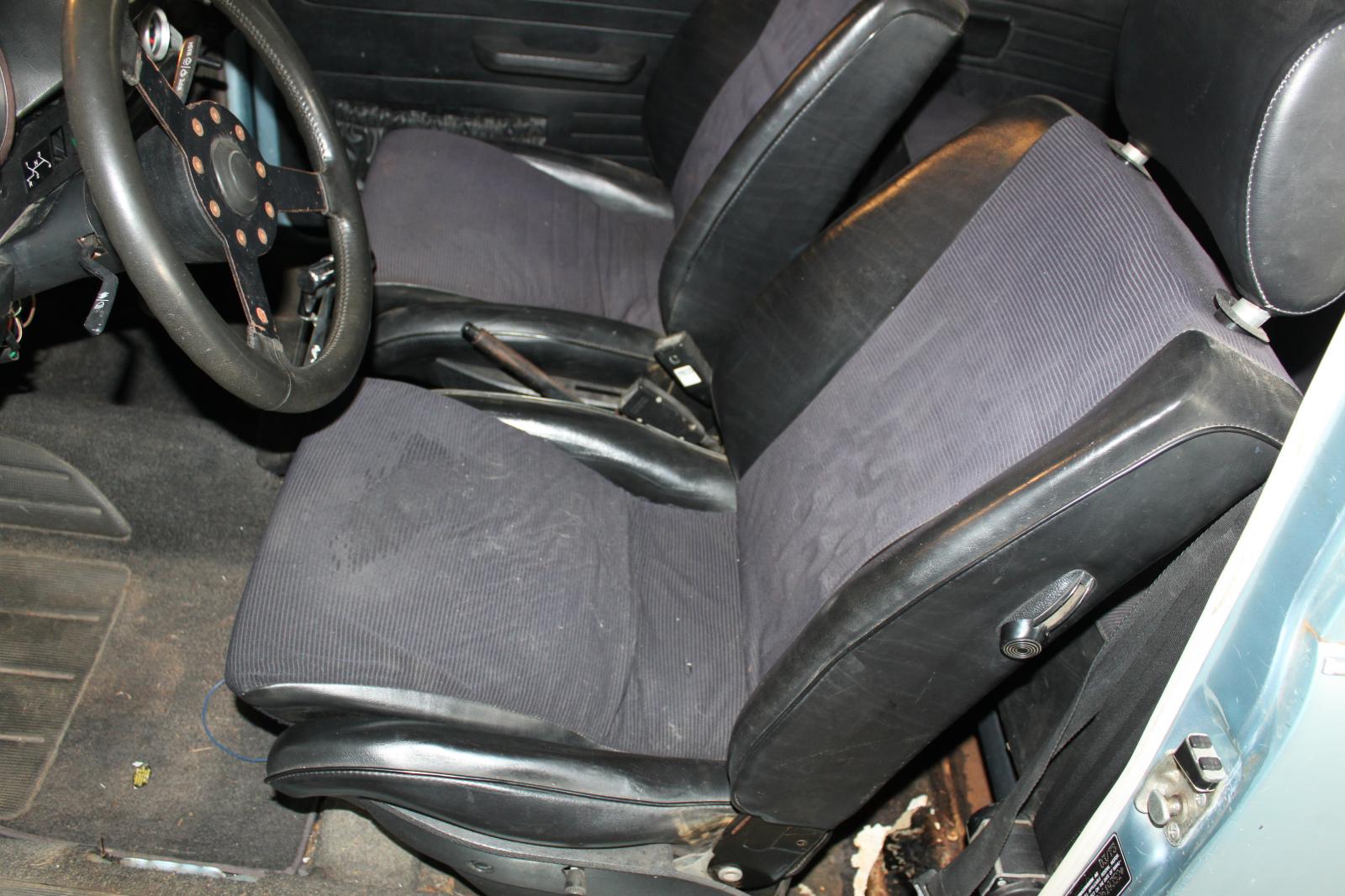

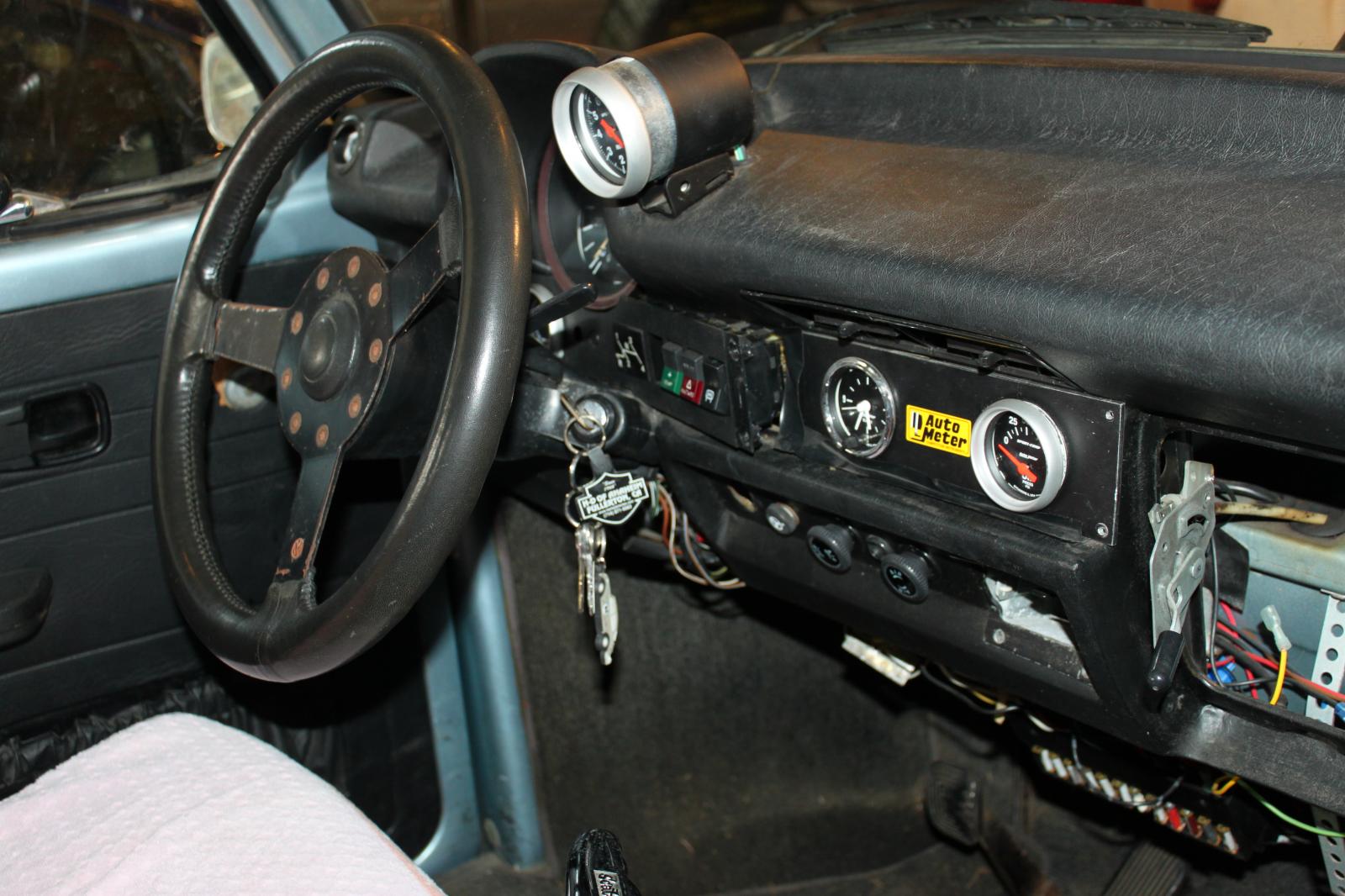

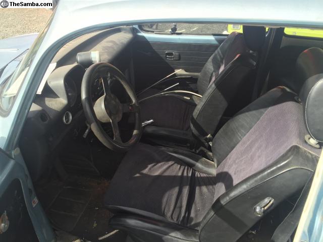

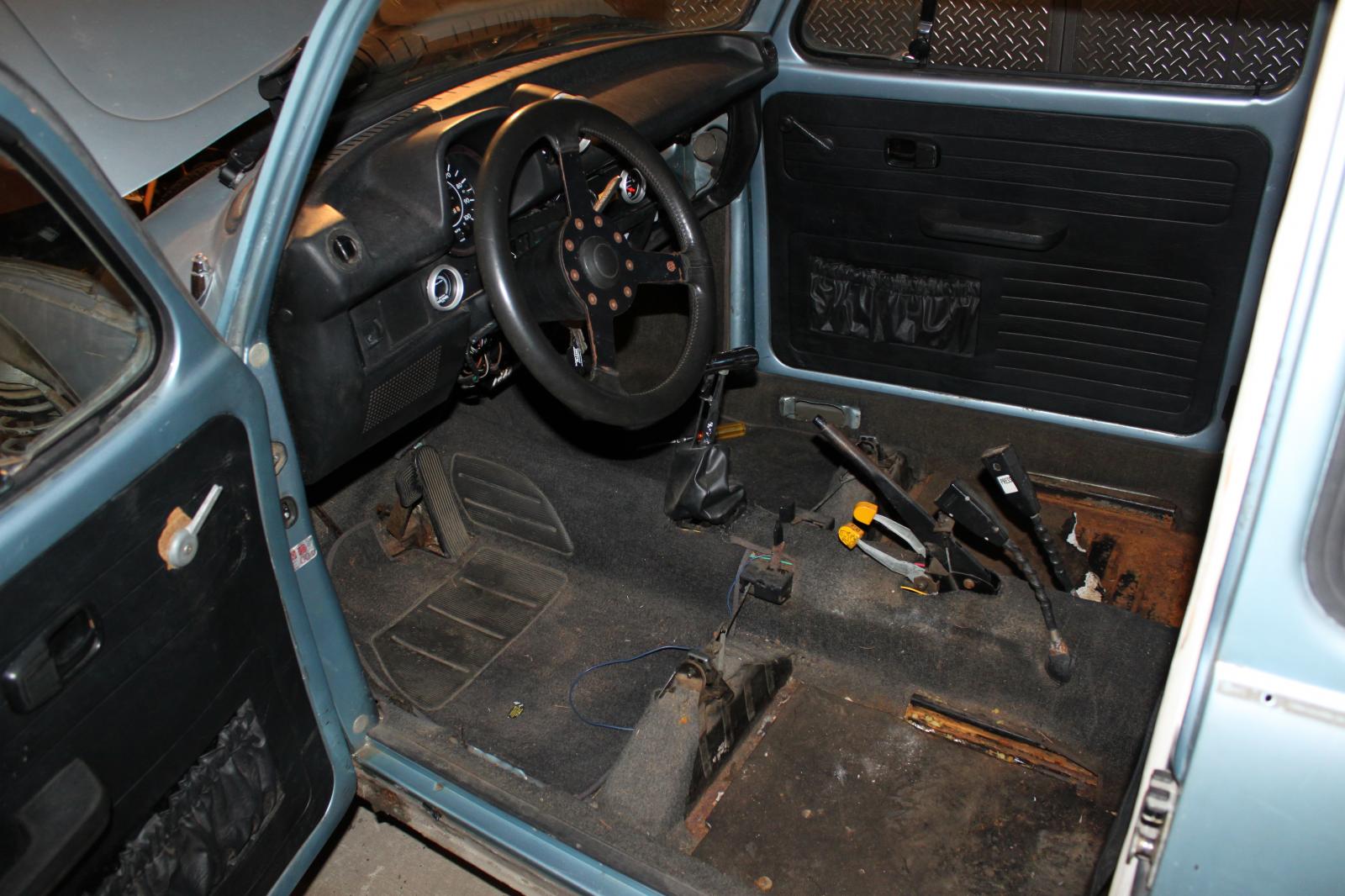

Here are a few photos of the interior.
Other than one hole in the driverside wheel well, no holes found anywhere else in the car so far. Whew...
LOTS of surface rust however. Was thinking of POR-15 on all those surfaces. Anyone's thoughts on that would be appreciated.

If you are going to keep that pump, I would keep the regulator with the gauge as well.
It may need a plug for the port you do not use, unless you want dual carbs on the 1600.

Thanks Horance. Been thinking more about this, and have decided that I'm going to pull the electric pump afterall, and go with a stock fuel pump. Want to keep this car (for the most part) stock. There are a few "upgrades" that I will be doing. I have a complete set of front and rear suspension parts and four wheel disk set up from Topline, and NOS Kamei spoiler, a nice strut bar from Vdubengineering and a brand new NOS Hurst shifter with a new white Hurst shifter knob. Those will be the bulk of my non-stock upgrades to the car.
Outwardly for the most part (save for the spoiler) the car will look stock. It'll just stop (hopefully) quicker and hopefully ride a bit smoother...

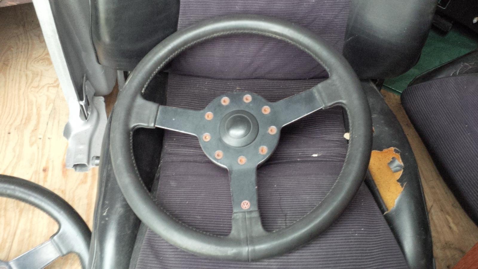

Sweet car!!

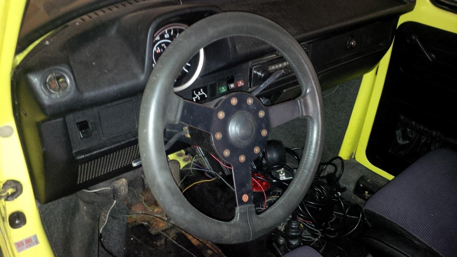

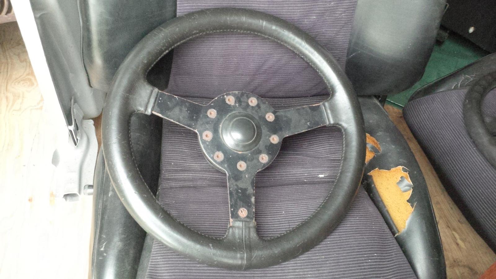

First thing that caught my eye is that steering wheel, WITH a horn button. I had that same wheel in my bug and put it in the spare parts bin since the horn button was broken and gone. No replacement available and apparently ALOT of people with that wheel are missing it...

Thanks.

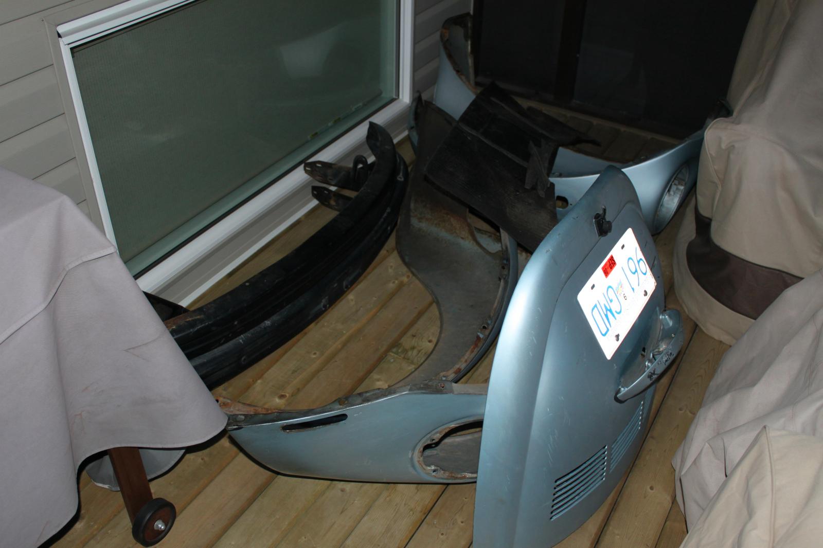

Back in my younger years when I had a sad old rusty Sports Bug (I lived in Ontario at the time where cars dissolved from the salt) mine too was missing the horn button.
I think I've aged more than the car has! Heh. Since I've been collecting parts over the past few years, I've managed to now obtain four 1973 Sports Bug steering wheels, all of which have horn buttons. Go figure.
Here they are:

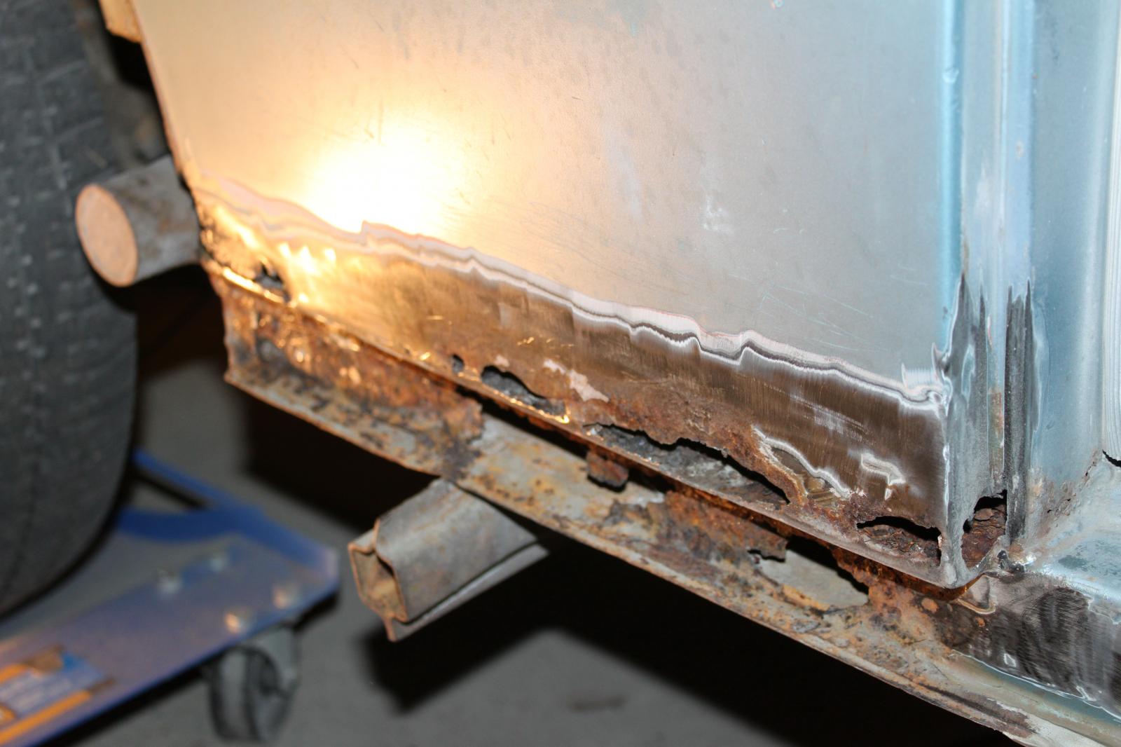

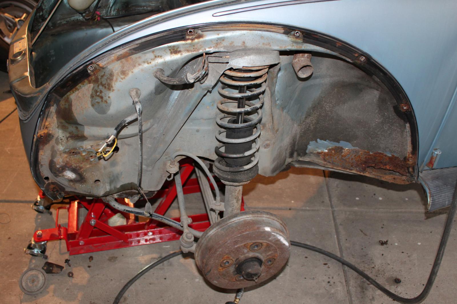

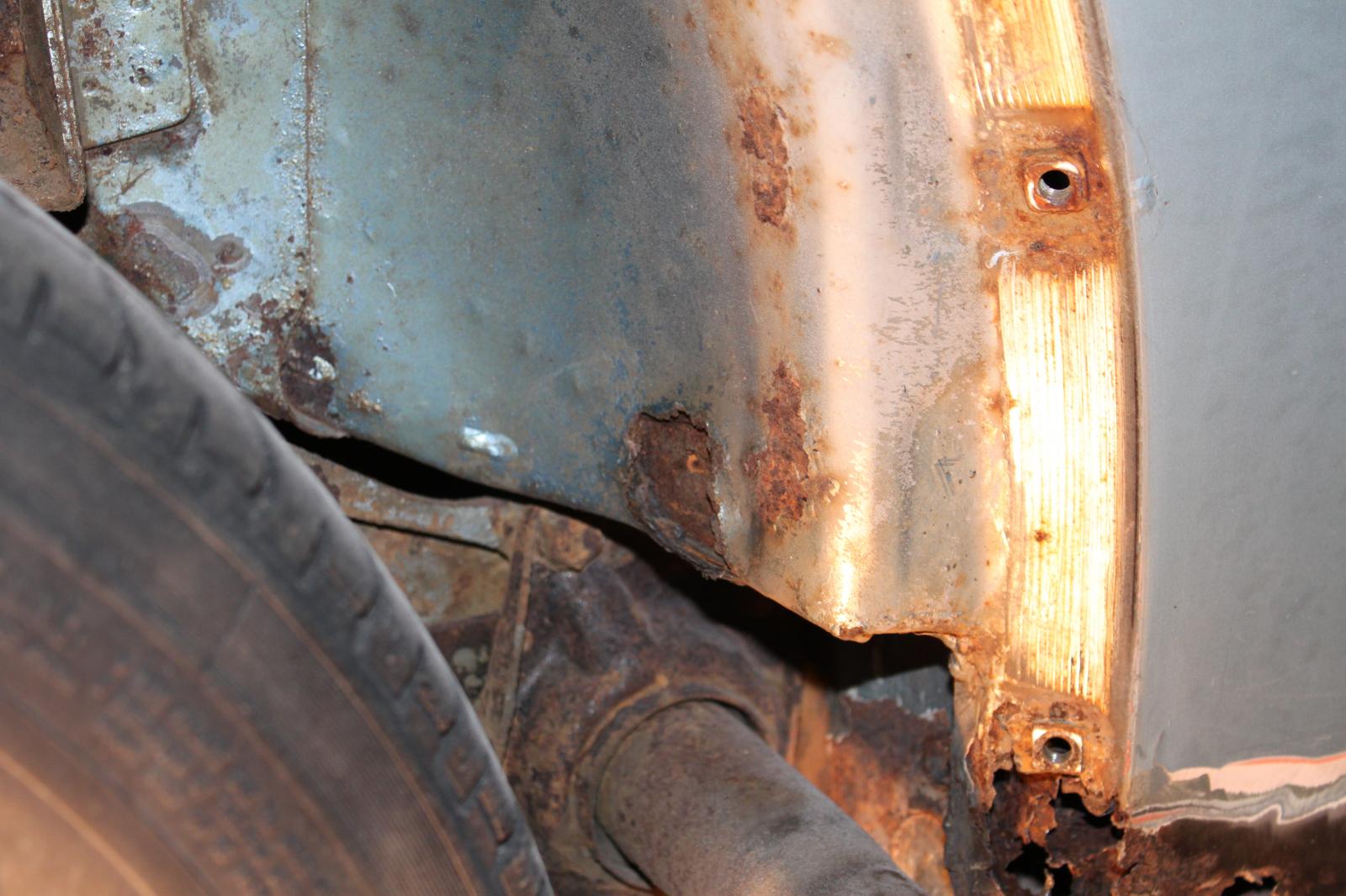

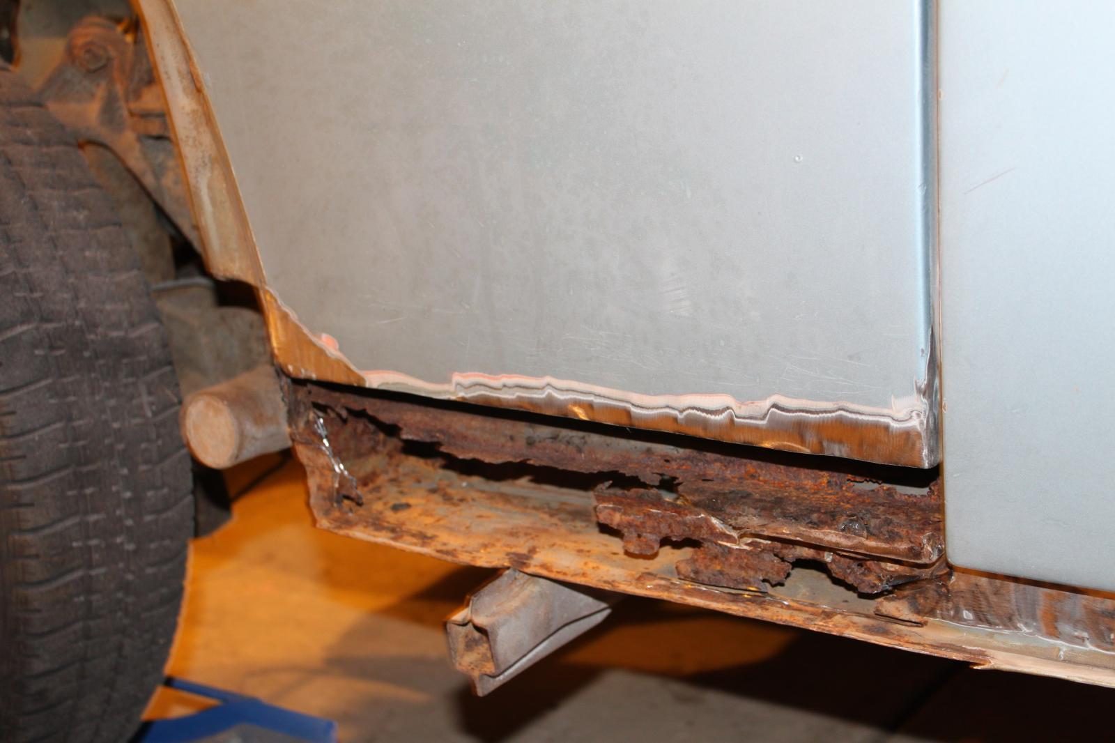

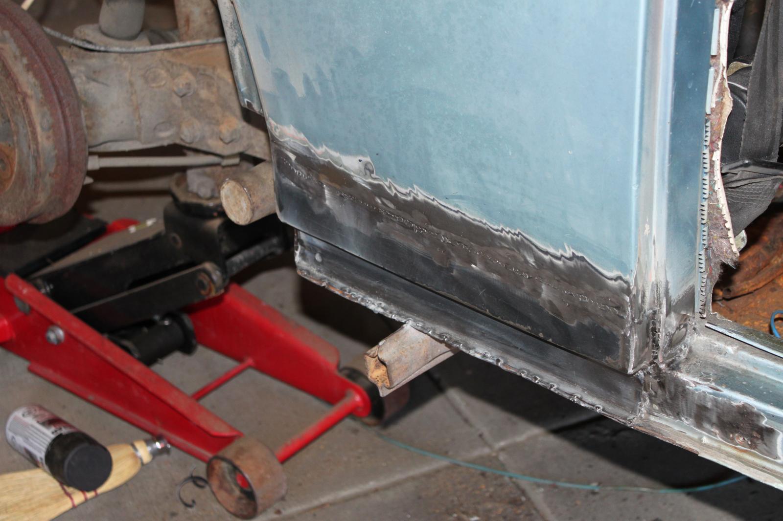

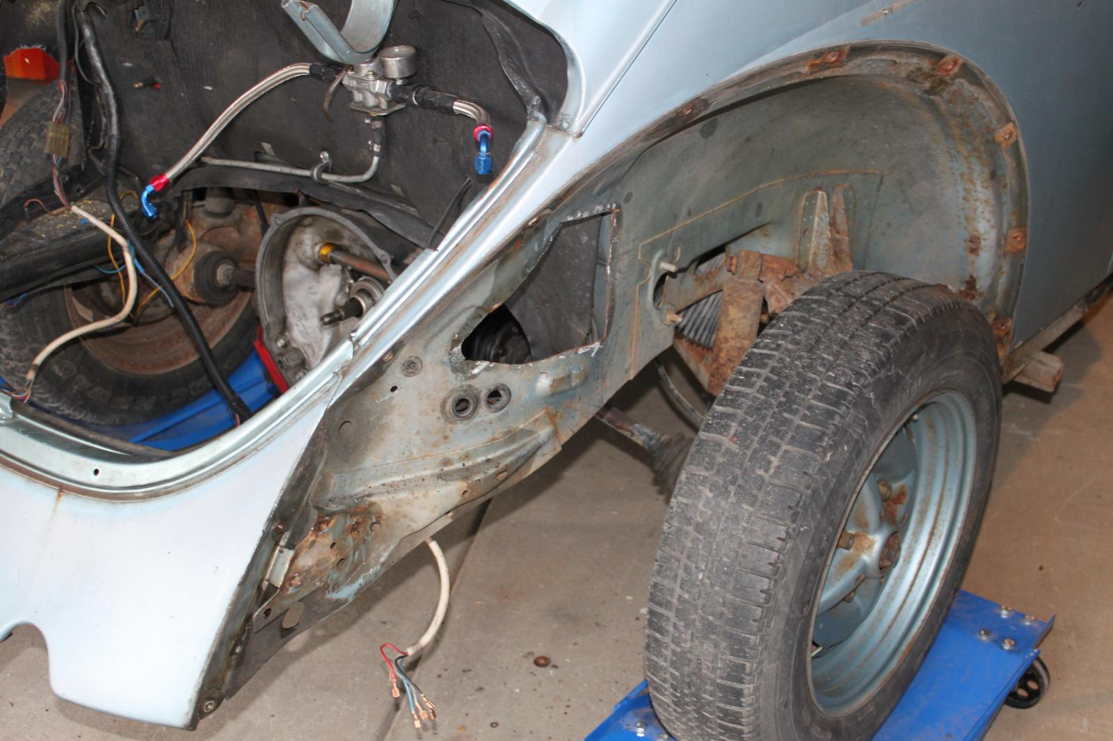

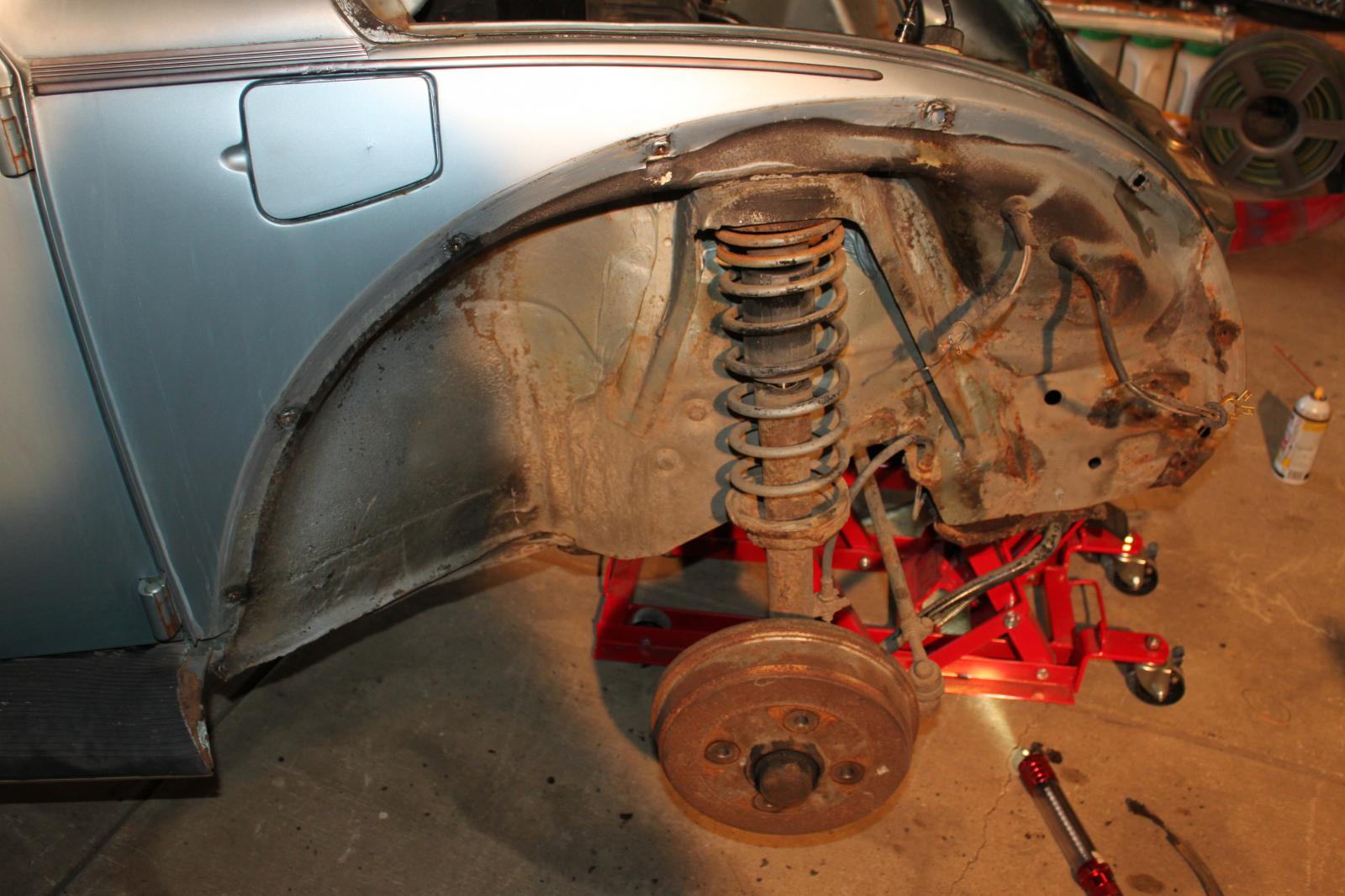

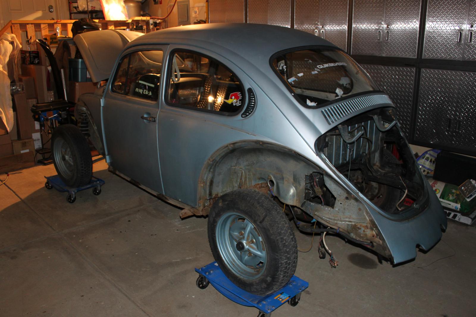

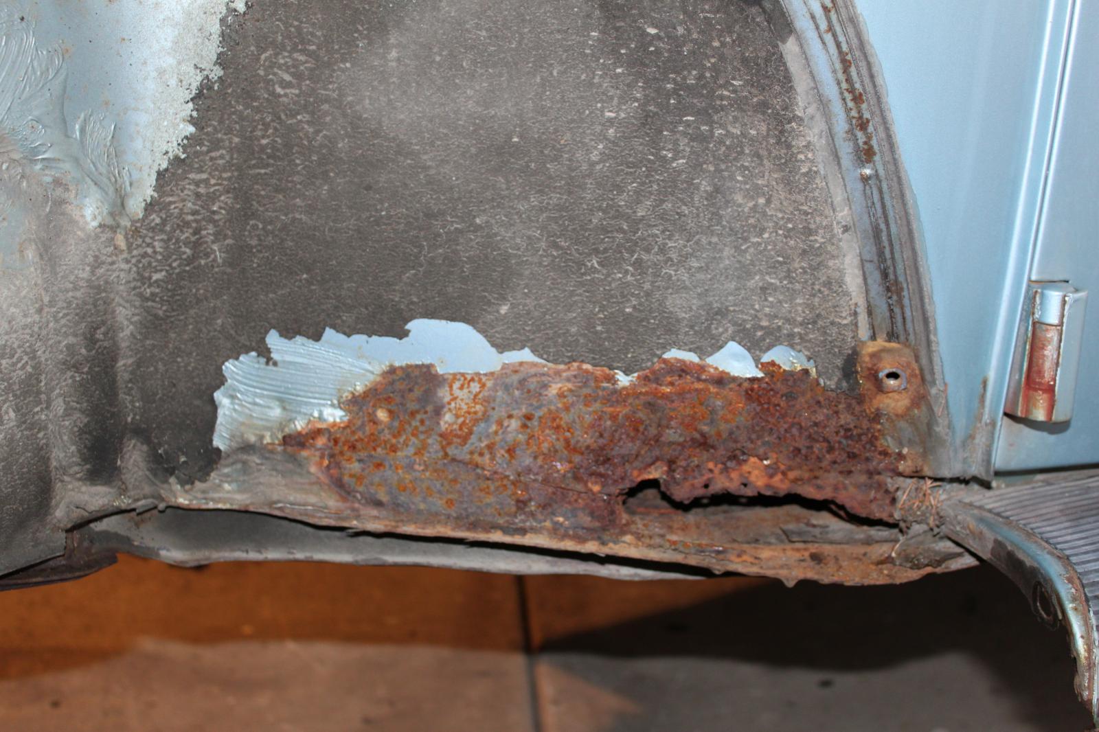

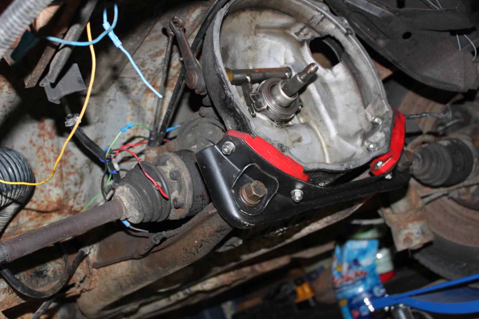

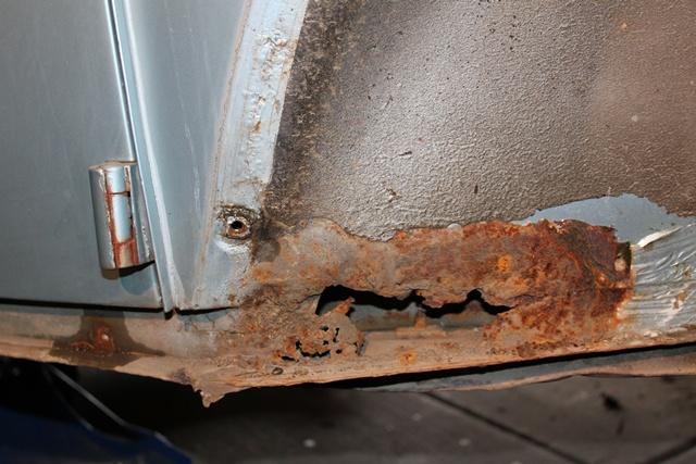

Spent the day tearing into the car, and uncovering some poor repairs. So, as it turns out there's a bit more rot than originally seen... but still, not bad.
Both front wheel wells have holes, and below the rear windows at the heater channels there's some rot. Rear fender wells are pretty good.
Thought I'd get a bit further today, but decided to put aside the impact, and carefully take my time removing the fender bolts. This was the right decision, as they all came out without twisting or breaking off. So, that alone still leaves me happy and impressed with the condition of this car.
The bolts that hold the running boards on all came out fine with the exception of two of them, and those were in an area that's going to need some repair.

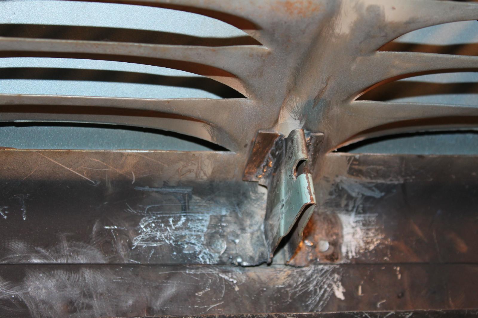

After that I pulled the rear deck lid and discovered that the bracket that the spring attaches to was cut off. I have a spare of that, so I'll weld a replacement in, in the next few days.
Made a tool to rip out the death foam, and started digging away at that until my arms were tired. Figure I got about a third of it out on both sides. I'll keep at that. Thankfully there's no rott caused by the foam, but it's gotta come out.

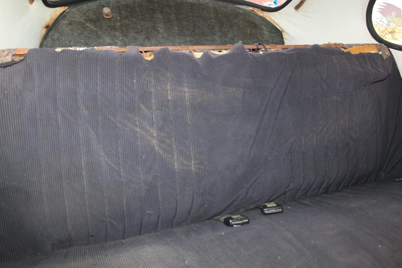

Pulled the stinky seats out. The rear seat, I'm going to toss. The entire frame is completely rusty. I have another out of a 73 super that is in nice structural shape with no rust, so I'll use that one to recover. The front seats came out nicely.
Tomorrow I'll visit my storage lot and get all of the replacement panels I need to repair all the various areas that need attention. Over the years I've ended up buying just about every replacement panel that's sold, so I have all the panels I'll need to fix the car. Plan on starting those repairs on Sunday.
Here are some photos of my efforts from today.
More updates to follow as I start cutting out the bad and patching the holes.

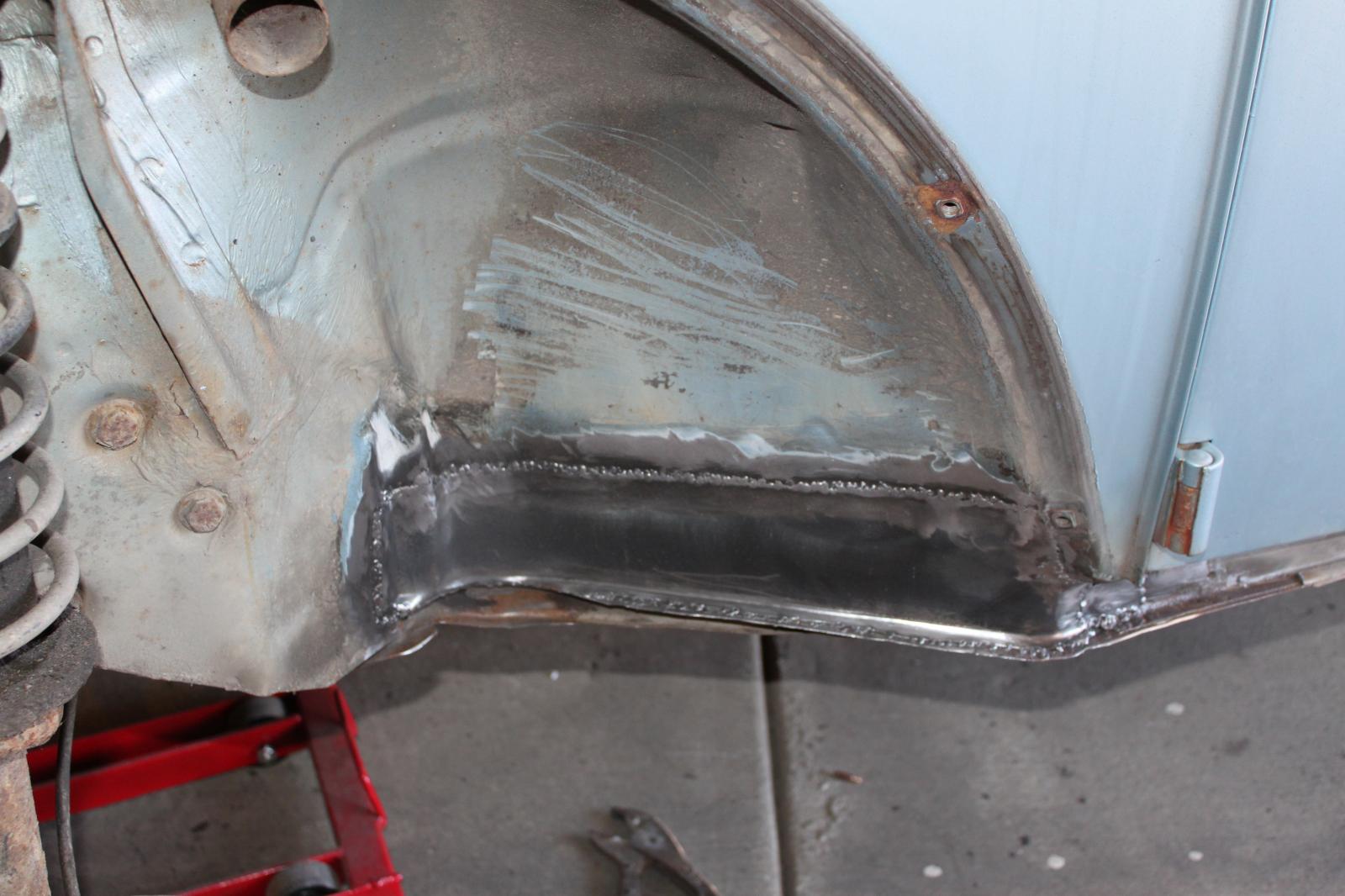

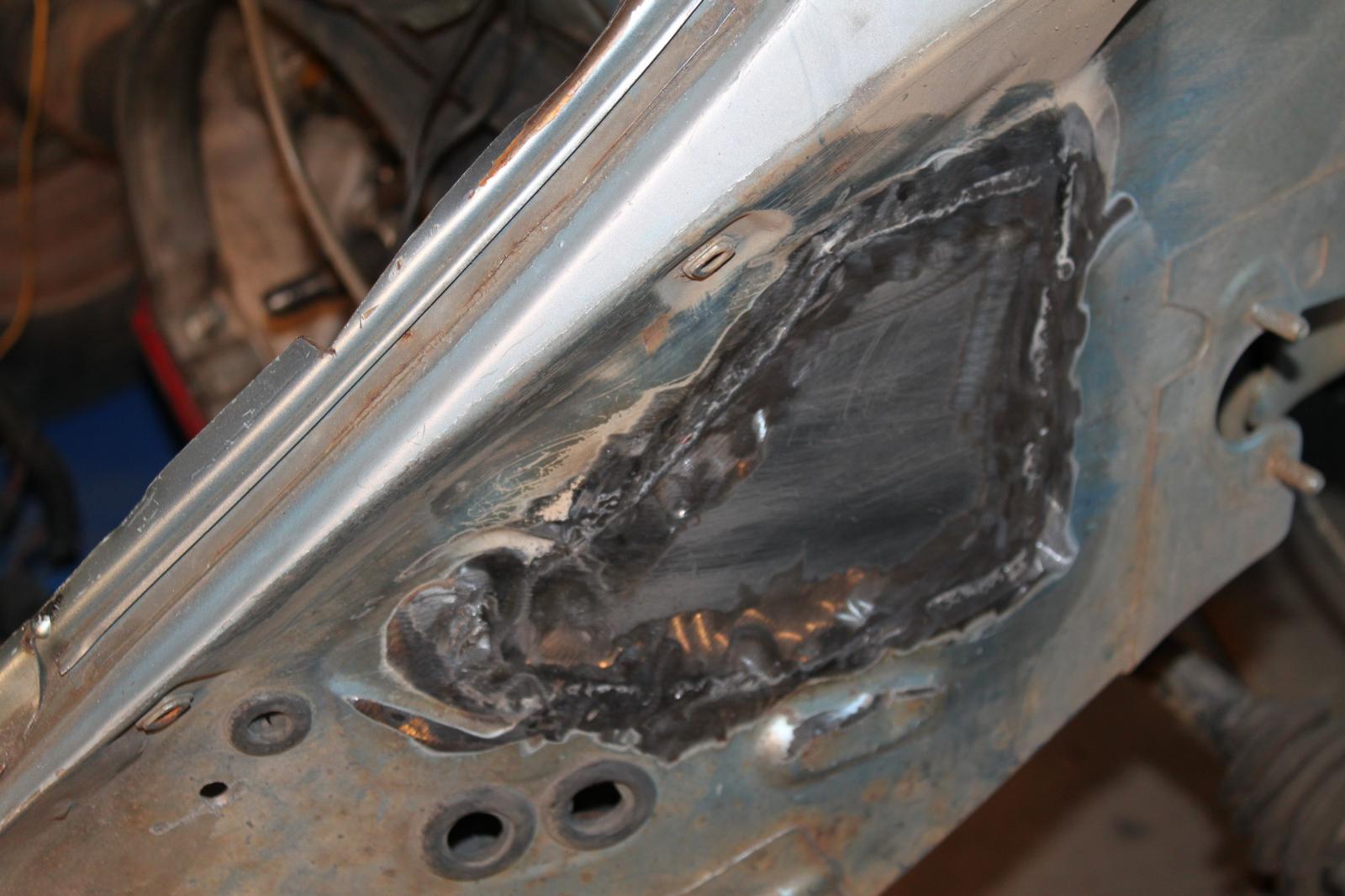

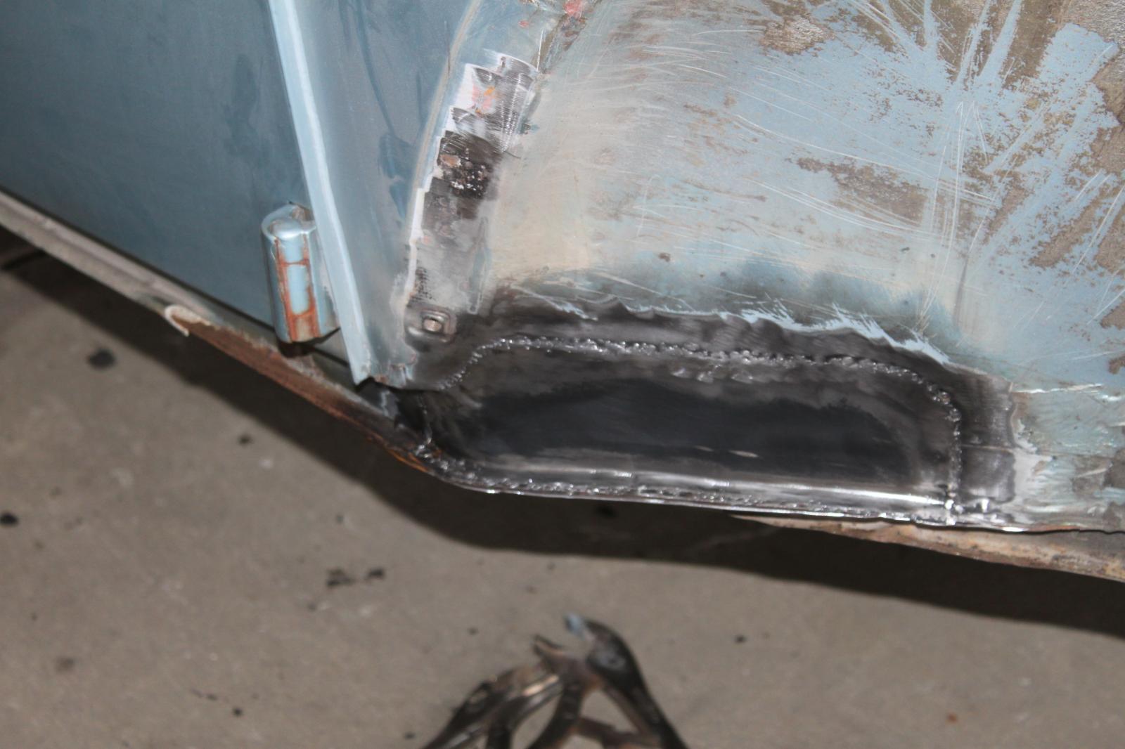

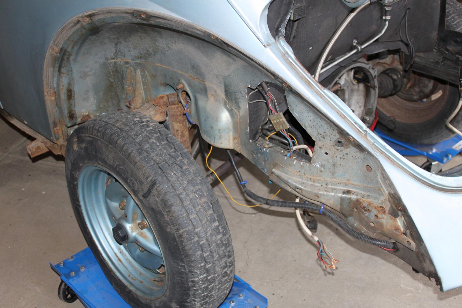

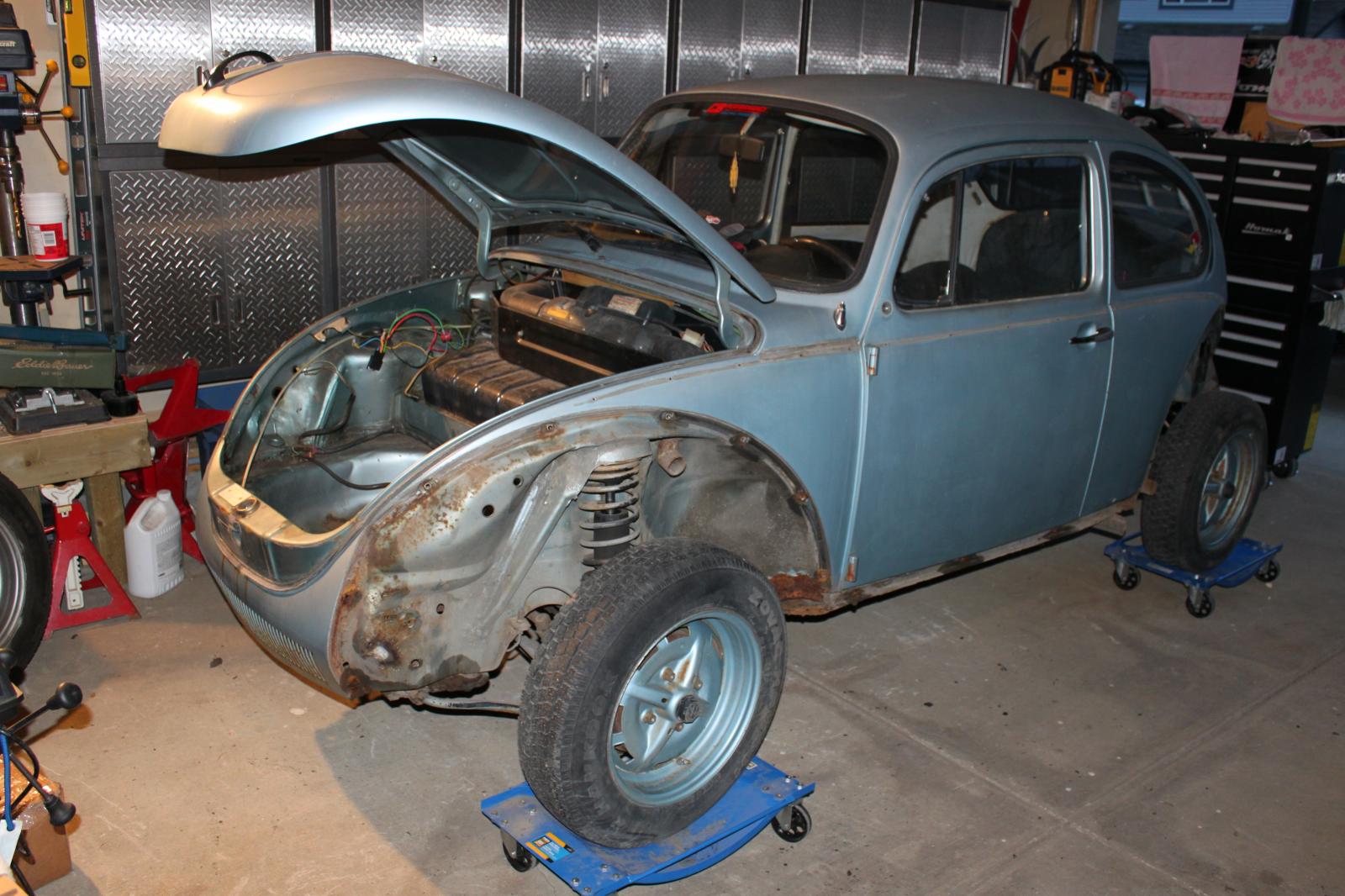

So yesterday as planned, I picked up all the replacement panels I figured I'd need to affect repairs.
Today I began removing the bad, and welding in new steel. It goes remarkably quickly when you're using the right tools. Last time I did work on a beetle it was back in the mid 80's, at which time I didn't have the right tools or the skills. Fast forward to today, I'm happy to say that I have a properly equipped garage, and I guess time will tell if I have the right skills. Very Happy
Today I managed to patch the two holes in the front wheel wells. Went quite well. They didn't didn't span much larger when I first saw them.
Was kinda wiped out by the time I finished those two, and the daylight was starting to wane, but I pressed on and started on the next section. Didn't get too far, but did expose a fair amount of rot. Still, there's plenty of solid metal in there to weld to, and it's really not as bad as it looks.
Tomorrow I'll continue working on this area. The hope is that I can complete welding in this repair panel by the time I call it quits for the day. More updates will follow.

PostPosted: Mon Nov 14, 2016 7:56 pm    Post subject: Re: 1973 Sports Bug Reply with quote
More progress today.
Got the passenger side of the car done. Have a few holes to patch in the firewall, then it's on to the last repairs on the driver side. It's looking like the driverside repairs that remain are going to be less work than the passenger side as the rot appears to be less.
There was considerable decay in this area and as such, it took the better part of the day to repair it.
Closing up the carb access point into the engine compartment was pretty straight forward.
There was a bit of a hole here, but was an easy fix once the bad was cut away.
The last thing I did was re-attach the spring mounting point for the deck lid. I presume the previous owner had cut it off to accompdate the engine he had in there. Personally, I don't want the decklid to bash me in the head. So I opted to put one back in.
Don't know what I'm going to be able to get done the rest of the week, but I've earmarked the weekend for trying to complete the welding work that needs to be done. It's slowly getting colder. Supposed to be a high of -7 this weekend. I can still work/weld at that temperature, so I should be able to wrap that up.
So the plan after the welding work is done will be to clean up the wheel wells and por-15 them as well as the floors in the car and the entire underside of the pan and body. Then the glass and remaining interior will be pulled and it'll be close to being ready for the body shop.
I'm on a mission to drive this car next summer!
