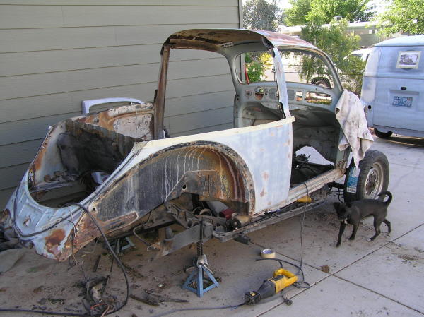

Looking good! What about the outside door handles? You going without?

Yea... those doors were already shaved and suicided. After welding the latch and hinges back in the right way, i decided i worked on them long enough.

Heater channels look later, is it a dash graft body?. Nice work, pretty unique ride!

... I was wondering too how many pieces of different bodies have gone into this project. Surely no-one would cut up a perfectly good split Wink
Clark Kustoms, which way you heading with this - slammed or rised?
splitjunkie
Joined: April 04, 2006
Posts: 4191
splitjunkie is offline
PostPosted: Wed May 28, 2008 6:48 am    Post subject: Reply with quote
look in his gallery. It started out as an oval.

Does the back piece pull off so you can get at the engine? How does it get air for cooling?

The oval was rusty so i used a 65 and grafted on the roof, window and dash section from the oval.
The only split part i used was a rear apron from a 52.
The engine lid lifts up through the type 3 style opening in the bed...i dont know how the factory did it.
The cover has a 2'' gap on the top under the bed for air flow.
... pan scraping low...
what about the dash?
And the rear fenders. Repops from Wolf?

thebucket wrote:
I'll let you in on a secret.. The dash is made from sheetmetal... Wink

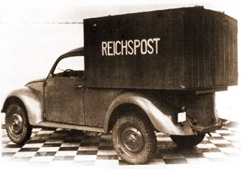

I wonder what the originals had for a rear suspension. That can hold a lot of mailbags.
splitjunkie
Posts: 4191
PostPosted: Wed May 28, 2008 1:56 pm    Post subject: Reply with quote
it was a 82-E bug on Klubel chassis.

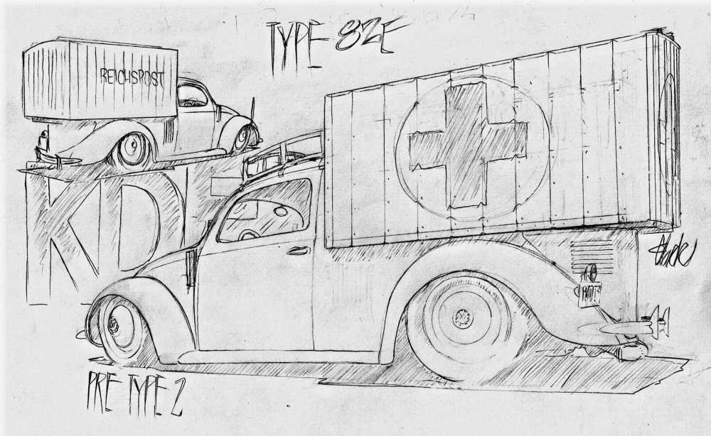

this is bad ass, me likey likey. Smile of course i wish it was lifted like stock. but its cool that one is even being made. slammed will make it stand out too. tiiight.
