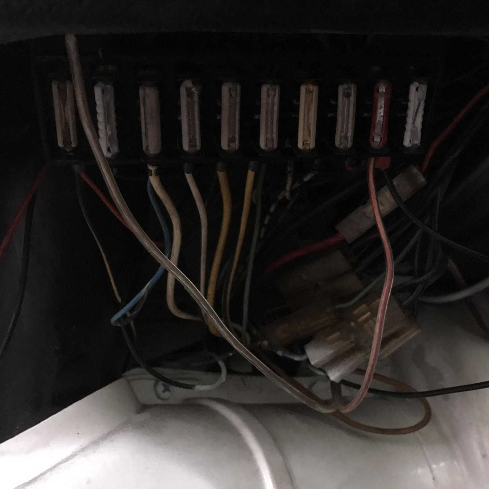

Disconnect battery and pull that speaker wire out of the fuse box. Trace it first, to find out what it is powering. That's pretty much telling you previous owners were butchers, which isn't uncommon.

Well I looked at that speaker wire and seems to be that it is attached to the back of fuse box someway. It is super cold so I just snapped a couple pics to see if u see any thing else. Still no progress on key turning.

Fuses 1,5,6 are not seated well with the end of the fuse in the puka.
Spin all the fuses to make sure they are making good contact in their holders.
Which is the speaker wire you are referring to? A speaker wire may pass around or behind a fuse box, but there is no reason why it would be attached to the fuse box. Is it a speaker wire, or the power supply wire to the stereo?

As to the fuses screw rotating them and buy new ones. They look pretty hammered.
