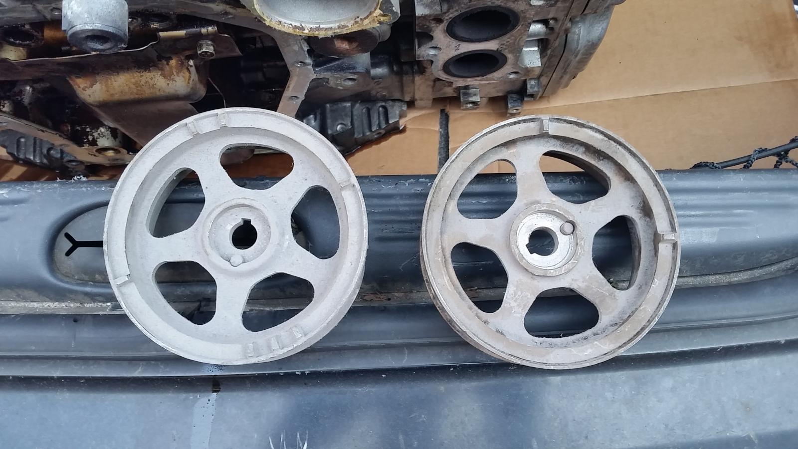

Well, I have my new (used) engine in the van and I'm dealing with it not starting before I go back to it running rich.
For the new engine I went with PMP in Philly. They had great reviews on the subaru forums, but quoted me a delivery date and then shipped it out a day after it was supposed to arrive, then told me it would be there in a day, and it took 3. Two weeks later... It wouldn't matter except I'm doing the swap in a friends driveway and he's getting sick of my van being there.
When I went to start it, the new codes were cam position sensor performance and crank position sensor performance. I replaced the sensors, still no start....which means I'll be redoing the timing belt tomorrow. Thanks PMP!
Needless to say I wouldn't recommend buying an engine from them at this point. I hate to write a negative review, but having to redo my timing belt from a shop that does them all the time, and buy another $150+ in parts and new tools, and two days of my life gone. I should start a thread titled, "How not to put a subaru engine in your vw van" I thought I'd passed my low point with this project but this is a new nadir.

kalispell365
Joined: April 01, 2010
Posts: 889
Location: PNW
kalispell365 is offline
PostPosted: Thu Oct 08, 2015 5:40 pm    Post subject: Reply with quote
You most likely have the wrong crankshaft timing sprocket on your engine...years ago I learned this the hard way when working at the dealer. There are two different sprockets and you will get a no start as well as the codes you mentioned. One has many small teeth for the sensor to read off, the other has few. Look down the hole after you remove the crank sensor on each motor and youll see they are different. Change them out and youll be good to go. Youlllnow need to change your oil, as it is filled with gas from cranking the engine.

PostPosted: Sun Oct 11, 2015 5:20 am    Post subject: Reply with quote
Thanks for the support guys. Kalispell365, you nailed it. Photos of the gears attached below. They sent me a 2004 engine to replace my 2002 and both cam and crank gears had totally different teeth. The computer probably thought it was going at 9k rpm at idle with all the extra teeth on the new engine's gears. That would explain why it was dumping fuel.
I took the old engine block to my subaru mechanic. We pulled the tensioner, cam and crank gears and he showed me how to do the timing. Super nice guy. Not as big a deal as I thought, just a pain to pull the exhaust and take the mustache bar off... again.
Once the timing belt was done with the old gears in, it fired right up and sounds better than the old engine, and no smoke out of the tailpipe.
