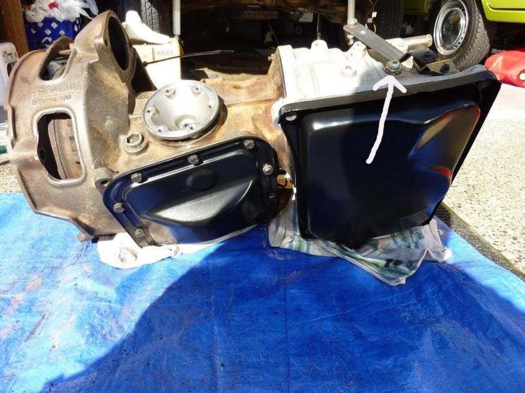

Hi guys;
After engine rebuilt work in my Westy 1978 2.0 type4 (3 months) , I'm having problems with the automatic transmission, after run some minutes begin to "slipping"....the same occurs in all speeds, is necessary turn off the engine a few seconds after start run again, but after a few seconds slipping again ...... ATF was removed before rebuilt the engine , after this ATF added again, the rod level has been check several times at normal temps in idle position "N", the marks are good.
When slipping aparently Torque converter without ATF, and the westy does not move.
It is the first time that happens to me....TC and trans was not removed in the rebuilt engine process.
picture only for refernces trans type
In my blue bentley manual appear another auto trans version, exist a manual for my trans??...ATF filter for clean or replace??
thanks and Regards.

The pictures you have show a Plain Jane 010 Automatic for a Vanagon.
Be sure and compare carefully with the transmission you have..I thought 1978 Vanagons had a 030 automatic transmission..which look like an 010..but are different. I think the shifter linkage on the 030 exits the automatic transmission on the driver's side..the 010 exits the transmission on the passenger side. Could be wrong..I know the governor cover is different too.

My trans definitly look exactly like a photo, shifter linkage passenger side...and all the rest details.....my westy is european version with dual carbs, maybe that explain the differences....but I need information about this trans type....filters, fluid capacities, bands calibration, etc....check the link ...really appreciate your advice...

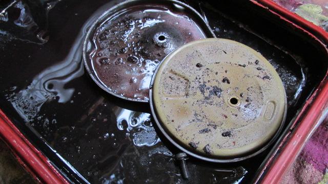

bad news....today, after 10 miles run in summer (85ºF), trans slipping again.....Turn off key engine a few seconds and work again for a some meters or minutes....Definitly fail when engines hot ...Trans work with dexron III (only 3 lts. new)Rest ATF inside TC....ATF pump wear??...any similar experience?
AtlasShrugged
Joined: October 30, 2008
Posts: 1605
Location: Decatur, Ga. USA
AtlasShrugged is offline
PostPosted: Tue Nov 24, 2015 9:09 am    Post subject: Re: Slipping automatic trans ~ help (Westfalia 1978) Reply with quote
Probably not the pump. They are very tough. The metal clad seals inside the clutches will get worn, hard, brittle and crack in older automatics. When that happens you get pressure loss and the clutch pack will slip.
Just a guess but I have seen it before. Time to refresh the transmission.
Here is a picture of a worn metal clad seal..it worked when the transmission was cold and the ATF was thick..once warmed up..no go.

The screen is cleaned only does 40 miles ago, now again dirt or maybe internal disc parts.......Screen was not really blocked, aparently the fault is inside the trans!!
AtlasShrugged
Posts: 1605
PostPosted: Wed Nov 25, 2015 8:43 am    Post subject: Re: Slipping automatic trans ~ help (Westfalia 1978) Reply with quote
When the metal clad seals fail the clutch(s) will slip and and throw friction material around..sorry..that looks like what is going on in your transmission
