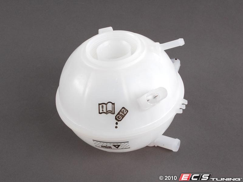

Hmmm, well I've figured out this is the Mark IV Jetta Expansion tank. The connection plug to the exterior of the tank looks clean. No corrosion since it's basically new. Is it possible I'd need to replace the tank since it contains the sensors? It's $20.

On this tank, it's not like the stocker. The probes don't come out. It's all one piece. Did you mean the paperclip test between probes? That won't work with this tank since the probes don't come out. I will try the relay in the fuse panel next. This shows it better

I have a Passat tank on my 1.8t, same built in sensor. I would suspect the connection where it's tied into the stock wiring first. Then expand my search to the entire run back to the dash. Good luck.
