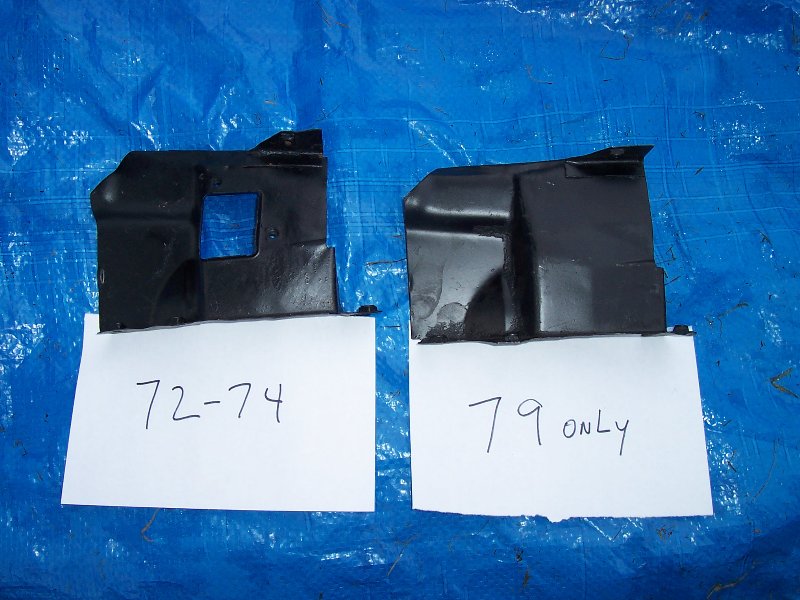

While deciding on a final paint scheme I figured I'd get my engine cleaned and detailed. I searched and came up with that I'm missing the lower right front tin but from my search it is exclusive to the 79 california 2.0 which is to te best of my research the motor in my bus a picture of this piece or a part number would greatly help out in trying to locate it. Also going to order new screws need a good source and about how many needed for the tin. Thanks
The lower fronts are not Calif only. The left side is the same as 72-74. The right side is 79 Fed or Cal.
The lower tin covering the pushrods is different between 79 Fed and 79 Calif on the left side. Same piece for both 79 Fed and Calif on the right side as 72-74; except 79 does not have the hole in the front edge for the 3rd hose coming off the fuel pump on the 72-74.
On the lower right front: the tin shape is the same between 72-74 and 79 except for the square hole for the hot air duct for the carb pre-heat.
Here are pics of the 2 pieces:
Karl

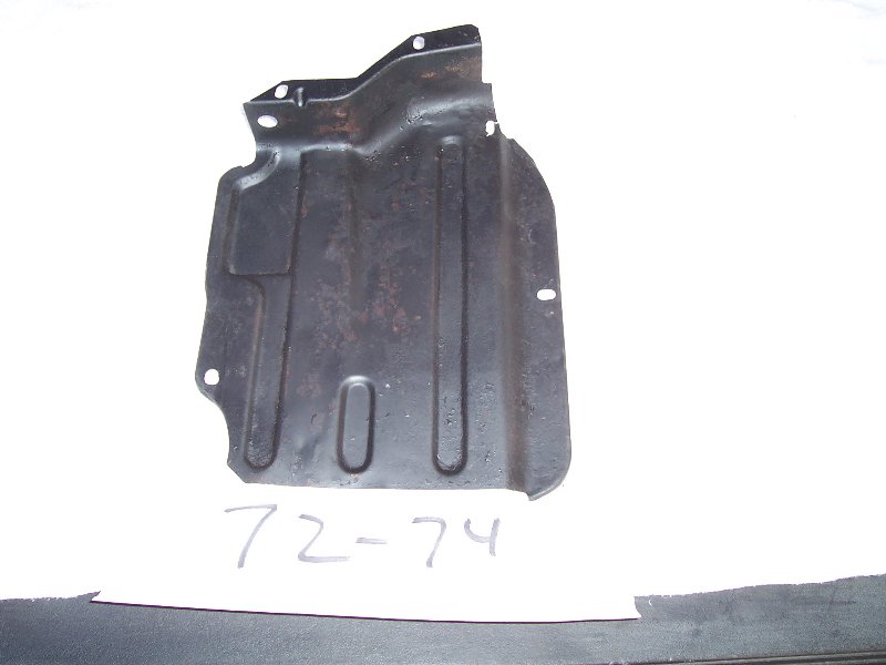

Here are the right lower pushrod tin. Only difference is the hole for the 3rd fuel hose coming off the 72-74 fuel pump.
The 72-74:
The 79:
I can post pics of the 79 Calif only left lower if anyone wants to see it.

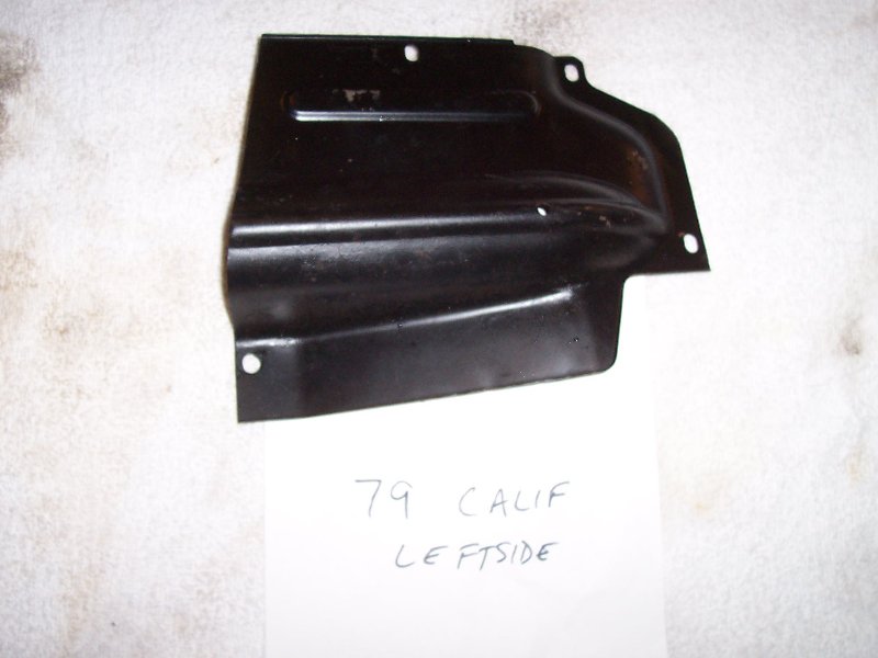

Here is the 79 Cal left lower:
and
It is easy to confuse it with 80-83.5 Vanagon Calif left lower except......
On the bay the flat section, along the top in the upper pic and along the bottom in the lower pic, is over an inch wide. On the Vanagon, it is about a 1/2 inch wide. Both resemble 75-78 bay lower where it is curved to clear the exhaust manifold.
