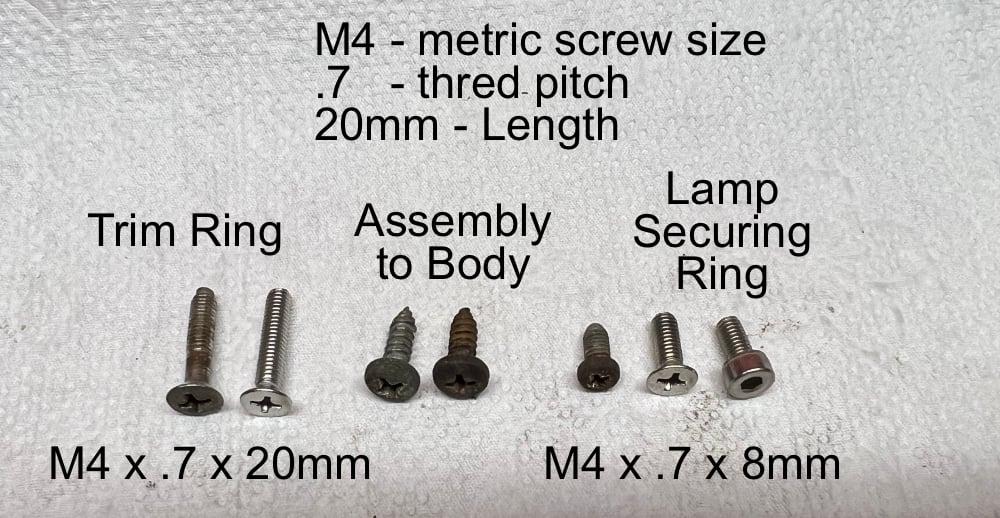

I have a 1969 Squareback and a 1974 Karmann Ghia.
I just went to my hardware store and bought some stainless screws to replace some of the original, rusted screws.
The headlight outer trim ring is held in place by a tab at the top in the center and (1) M4 x .7 x 20mm screw at the bottom in the center.
The headlight assembly is attached to the car with 3 round-head or oval-head sheetmetal screws. I don't know the size.
The headlight lamp chrome ring (which holds the headlamp to the headlight assembly) is secured by (3) M4 x .7 x 8mm screws.
The original M4 x .7 x 8mm screws are the worst. They are usually completely rusted in place and the cross in the head is usually stripped out by people trying to back the screw out when it is completely rusted in place. I had to drill one of mine out.
I experimented with both flat-head and hex-head screws in stainless for the lamp retaining ring screws. They both work great. The hex-head screws have the advantages of staying on the tool (Allen wrench) better than a screw stays on a Phillips screw driver and the Allen wrench being more slender than the shaft of the Phillips screwdriver.
Do not remove the headlight adjusting screws unless you really have to. If you do, you will need to readjust them after you put the new lamp in.
I further recommend that, if the lamp retaining ring screws are badly rusted or stripped, you remove the entire assembly from the car to work on it. Particularly if you are working with original style screws, you may end up dropping them into the assembly multiple times when putting them in (like I did). So, remove the assembly and at least start the retaining ring screws before you put the assembly back into the car.

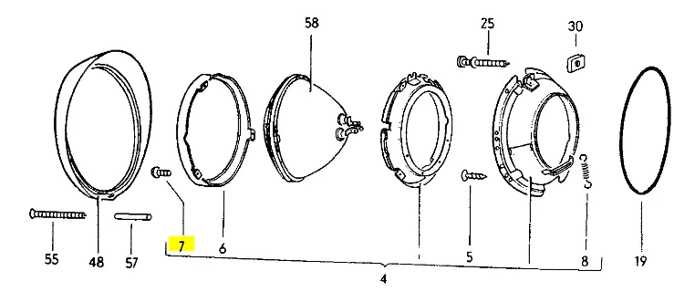

Hello, just waded into replacing the mismatched & burnt out Sylvania/GE sealed beams on my 1971 Super Beetle, Sunday past with a pair of E-Code H4 headlights acquired from the Bus Depot.
Unfortunately, both sets of machine screws attaching the retaining ring to the bucket were rusted/fastner-drive-heads destroyed requiring some delicate surgery to extract with out damaging the threads.
Specifically speaking to #7 highlighted in the below exploded parts diagram:
Photo Courtesy: Kafer by Texas Air Cooled
Note that I've been able to find these screws at local Ace Hardware stores in the past. They generally have them in stainless too, which makes for easier removal next time around.

Hi,
thanks for the detailed picture.
where can I get item #30 on this picture, please. mine is broken.

alidabiri wrote:
Found a seller on eBay selling packs of six (6) as of 06/04/2024
https://www.ebay.com/itm/386252778218
Also appears ISP sells sets of six (6)
https://vwispwest.com/headlight-retaining-ring-screw-kit-113941183
WW has them:
https://www.wolfsburgwest.com/wolfsburg_new/electrical/bug_electrical_2/head_lic_light.cfm
https://www.wolfsburgwest.com/cart/DetailsList.cfm?ID=311941195

Stated as M5; "311 941 145"
The adjustment screw is M5 then and stated as 40mm (length) "311 941 141 A".
