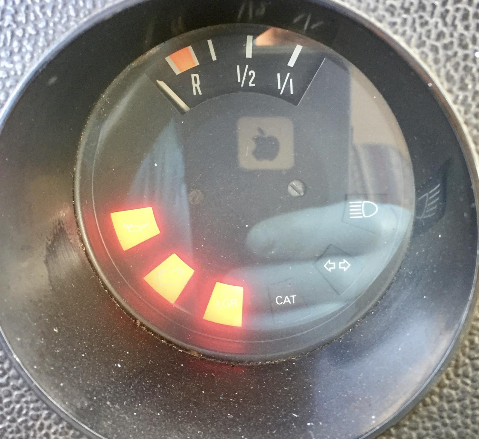

1) This is what I am seeing when the Key On / Engine Off

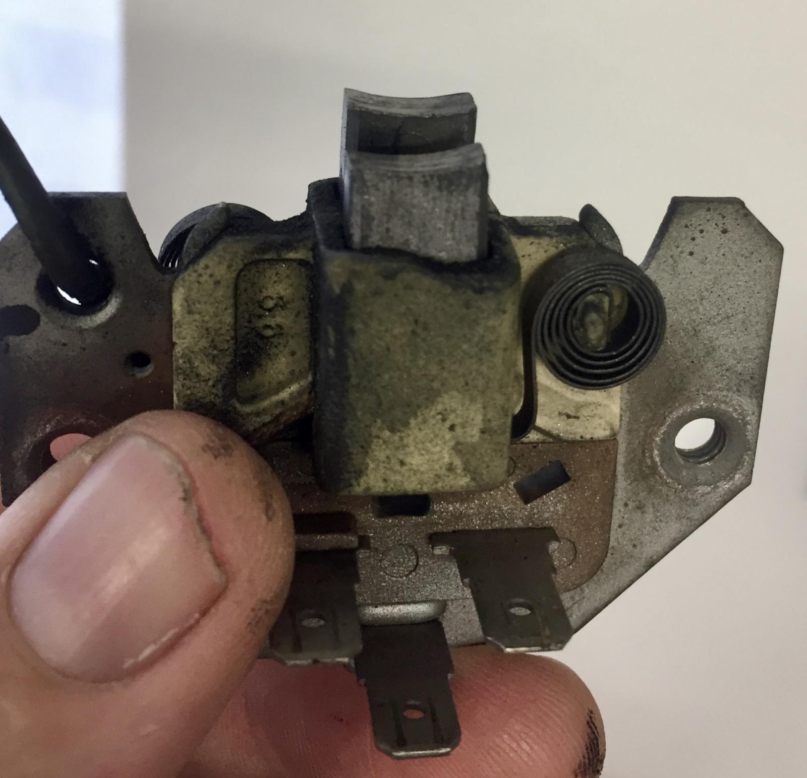

Opened up my regulator. But It doesn't appear to be the old school type...Solid State?

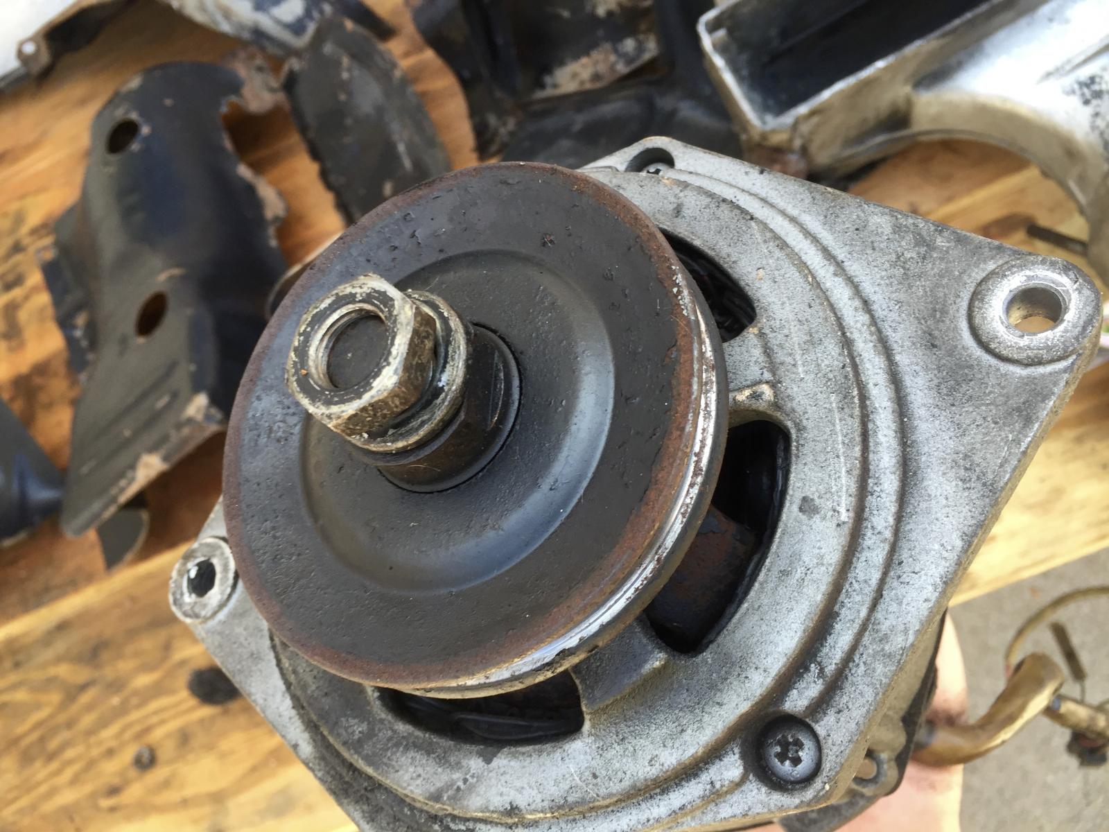

Can't speak about weather or not the alternator is aftermarket or not. But her are some pics from when I rebuilt the motor.

OK, well I had to practically pull the alternator to conduct this test. But I tested all three wires (Red, Brown, and green) from Regulator plug to alternator plug. All continuity checks are very good. I also checked the large red cable from the alternator to the battery, it also checks good.
I guess it's time to take my alternator in and have it checked?

PostPosted: Sat Feb 25, 2017 11:46 am    Post subject: Re: Alternator / Battery Light Reply with quote
I tested and verified good ground from the Regulator case to chassis.
Installed new (auto parts) regulator, still no light with ignition on/engine off.
Any other thoughts?
I still haven't pulled my alternator to have tested. Should I? What is the next step?
Thanks again.

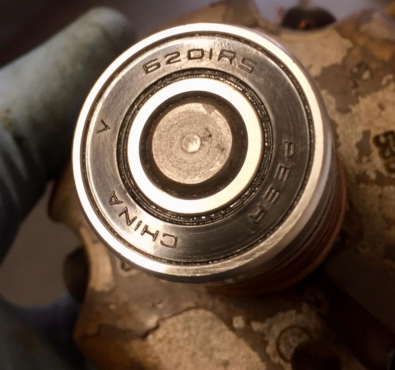

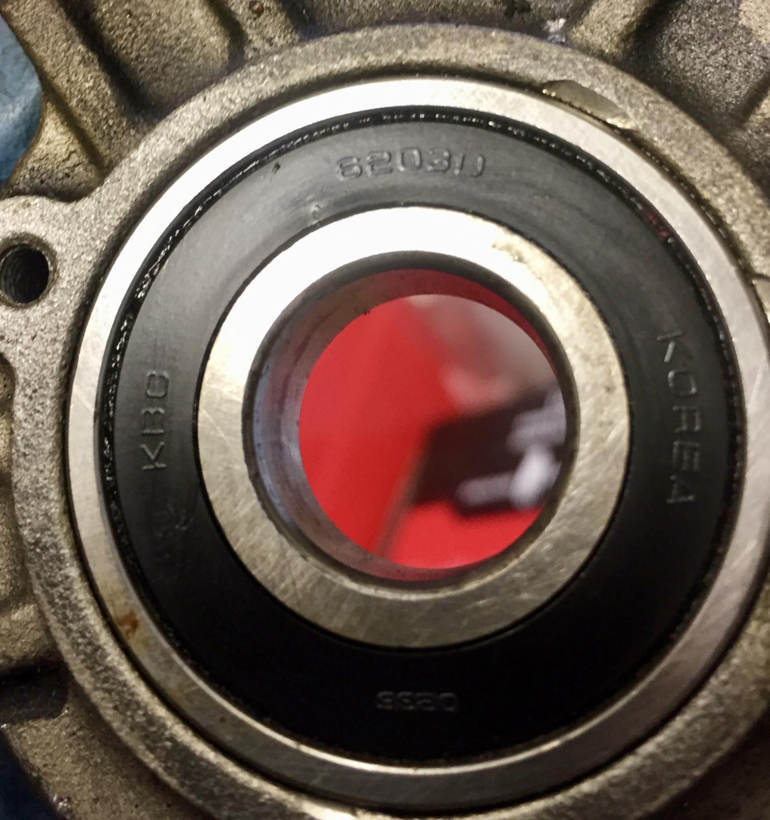

Well, I tore the Alternator down. Didn't "see" much that would suggest why it wasn't working. I took some pics. I did note the front bearing was slightly wobbly, didn't feel bad, but the front shaft (armature assembly) wasn't very solid. Rear bearing seemed in better condition.
Brushes; one was significantly more worn than the other. My theory is one spring is suppling more pressure than the other. I don't see any other reason they would wear so differently.
As far as any of the other parts (diodes, winding, exc...) how would I test them?
1-Rear bearing (from Korea)
2-Front bearing (from China)
3
4
5
I can get new bearings, brushes, and slip ring for just over $10 shipped. But I am worried none of this will fix the no charging issue.
And lastly, If my Alternator wasn't charging (I verified with a multimeter while the engine was running) why wouldn't my light in the dash illuminate? This is still confusing me. I feel there is something else I am missing.
Thanks

PostPosted: Mon Feb 27, 2017 4:31 pm    Post subject: Re: Alternator / Battery Light Reply with quote
The dash light only lights when current can flow through the regulator, then through the brushes to the alternator rotor. Once the alternator starts outputting power normally, voltage from the alternator 'diode trio' (the three little diodes) overrides everything, forcing the voltage across the GEN indicator to (near) zero. Thus, the light goes out.
Grab your ohmmeter and measure the resistance between the two slip rings:
It should be a low value.
Also measure from either ring to the rotor shaft. Should be infinite.
If either test fail - bad rotor (e.g. bad alternator).
Otherwise, polish up those slip rings, reassemble, and remeasure the resistance between the green and brown wires, and see if it has changed any.
If the rotor measured OK but the other test fails still, I'd try a new brush holder assembly.
