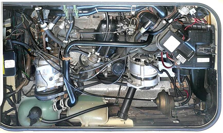

Here is an amateur photo pointing out hoses I cannot find. In the middle I circled one, and two lines to mark the two hoses I need. Also those three hoses are collapsed, almost clamped off. Upper right circle, on the bottom of that thing is a rubber vacuum boot that goes from large diameter to that very small plastic vacuum hose. Any help on those?
I also am going to fiddle with the Tps this weekend.
84 Wolfsburg Edition Westy

PostPosted: Thu Mar 02, 2017 8:30 am    Post subject: Re: 1.9L O2 sensor Reply with quote
All those hoses marked look like stock auto parts store items to me - sold by the foot.
I do not recognize the part you have circled but as I have a manual trans and no power steering perhaps that makes a difference.

The true circled part is the round black thing in the upper right corner in your picture.
Every time I've gone to "oreillys" they have heater hose, fuel hose or some other hose that my vw doesn't require. None of it is ever braided either and for the larger braided hose, I need that so it doesn't pinch shut when bent 90*

PostPosted: Thu Mar 02, 2017 7:15 pm    Post subject: Re: 1.9L O2 sensor Reply with quote

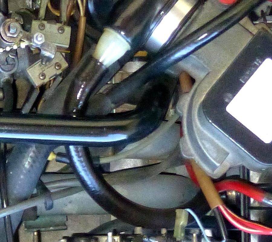

Okay - it was the part in an ellipse that I did not recognize.
I used auto parts store hose to replace the braided hose and it has not kinked:
Might have been some extra stiff special-purpose hose like 'automatic transmission fluid hose' - but it is just sucking oily fumes so it seems okay in that role.
Thanks for looking and you are right, I think I'll just grab a hose that will work. For the connection you don't recognize... I think mine should be below that breather tower hose and maybe why they are kinked. Thanks Ahwahnee
