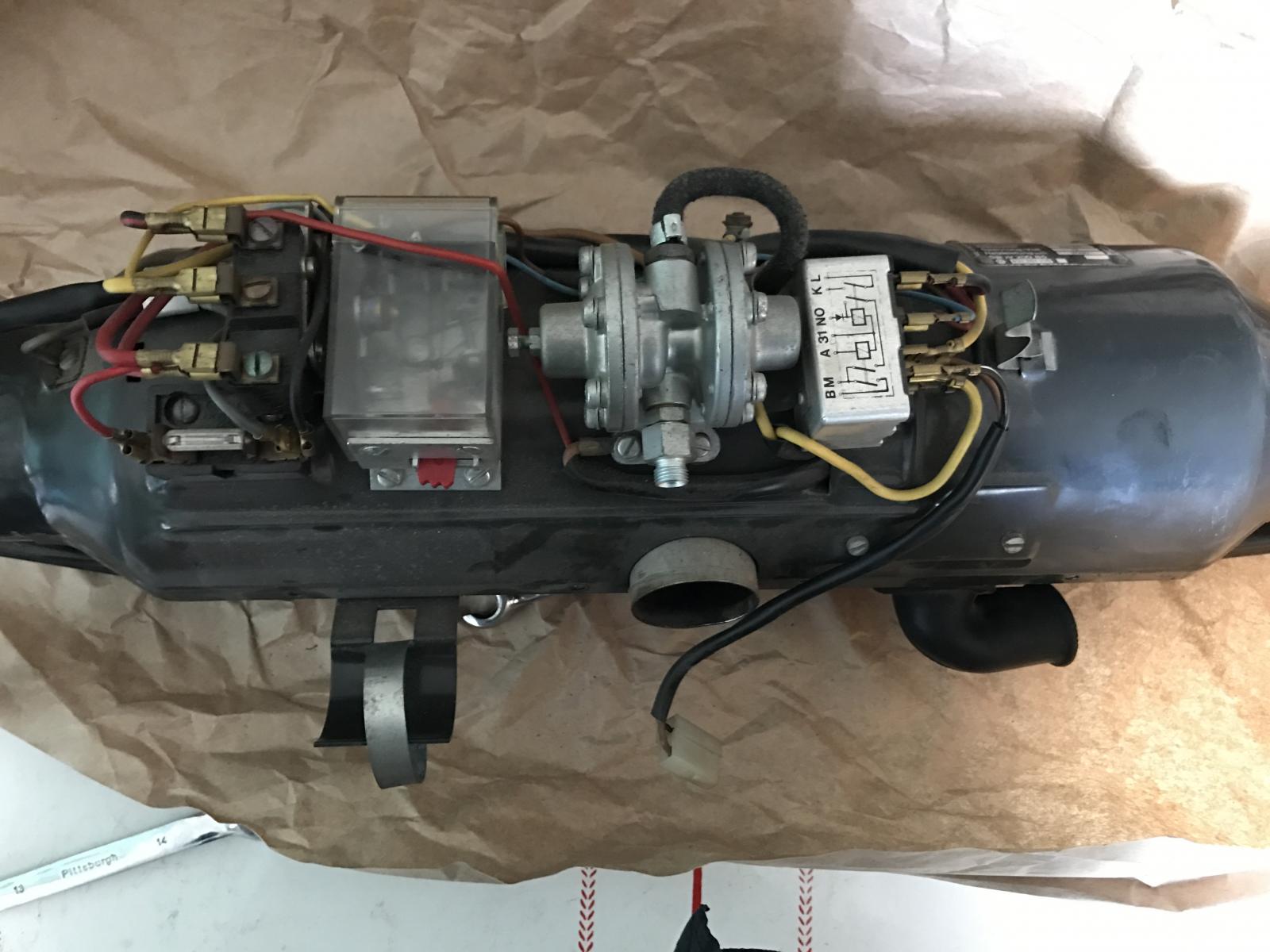

So, we recently got our hands on a BN2 in "good" condition for a decent price. Everything looks great from the outside, but there are some issues. First is that the fan rubs on the metal housing. I discovered this just by rotating the fan by hand. I'm not sure how anything could be misaligned inside, but it definitely rubs on the bottom.
I also checked out the fuel pump diaphragm and it's as hard as a rock with varnished gas evident inside the cap. I'm going to assume that the pressure regulator diaphragms are screwed as well.
It seems that a lot of the info that used to be available on these heaters disappeared along with Russ Wolfe's site. While there's some general stuff out there, most Samba posts seem to be more about installation than rehab. I found this in the classifieds (and reached out the seller)

But I'm not sure what the best next move is. Clearly, I need some material for rebuilding the diaphragms before testing out the heater with gas, but are there any other tests to run in the meantime on other parts?
For fun, here's the heater without the wiring cover and the pump removed
