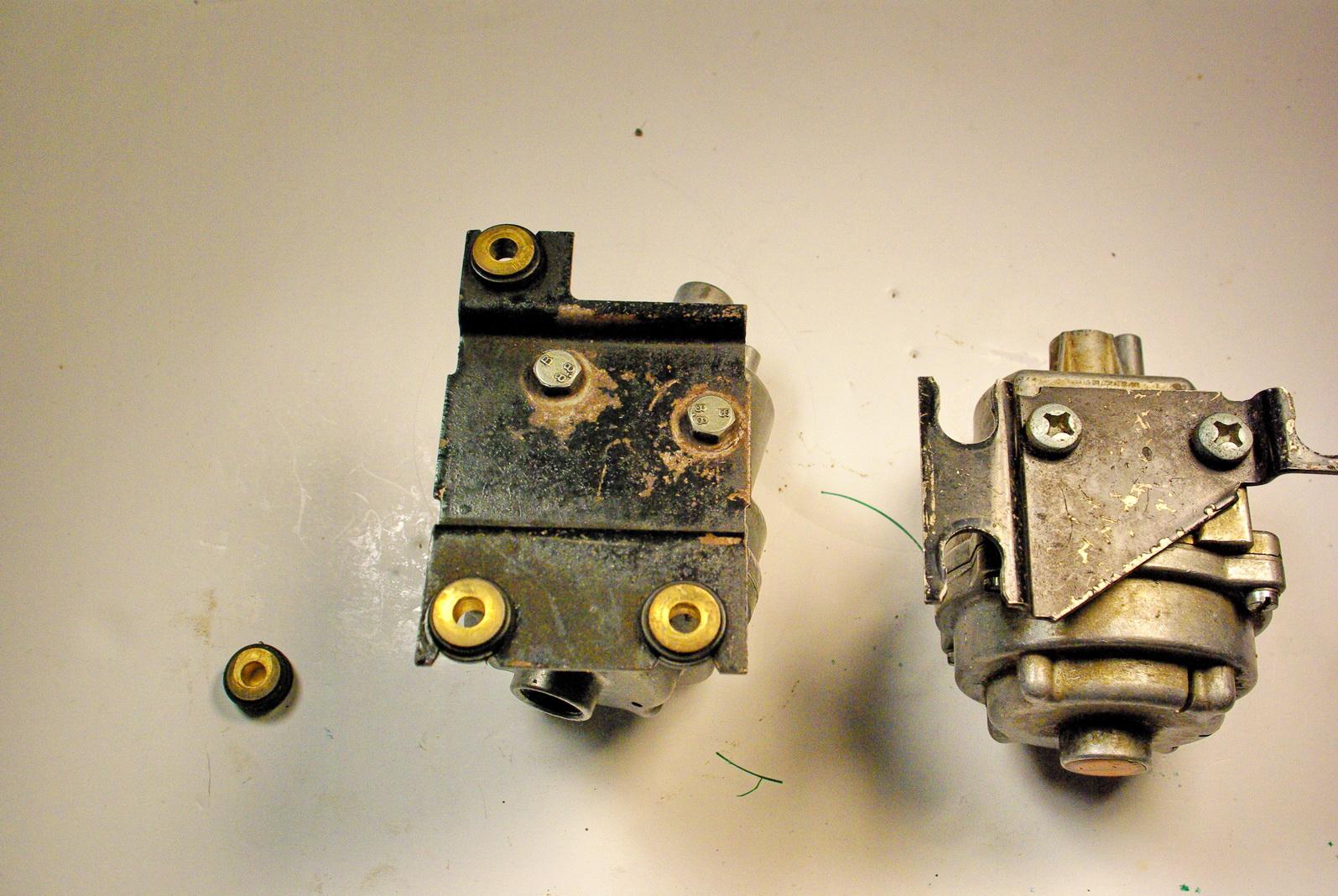

You beat me to the pictures. So here are some anyway. Sorry for the quality. I think I have streaks on my sensor from cleaning last week.
This is taken from the OP's video. The black piece shown by the yellow arrow appears to be one of the two standard mounts for MPS still attached to the firewall. I think you can just see the head of one of the three screws.
Note the similarity to the side view above
Those sheet metal screws are part # N 90 136 1
The bracket....and this is from my type 4 parts catalog so it has a 022 part # 022 906 200. Not sure if type 3 uses this part or has one with a type 3 prefix with a slight difference.
These are two of mine. The square one on the left I believe is a version from a square back 411 or 412.

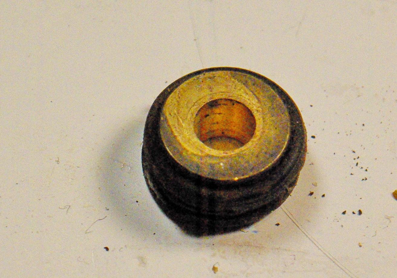

The grommet has a part # of 311 906 055A. The brass bushing has a part # of 311 906 057
In asnwer to the question...no you cannot use these rubber grommets without the brass bushing or some kind of bushing that the screws can get tight against. It mashes and destroys the rubber bushing.
