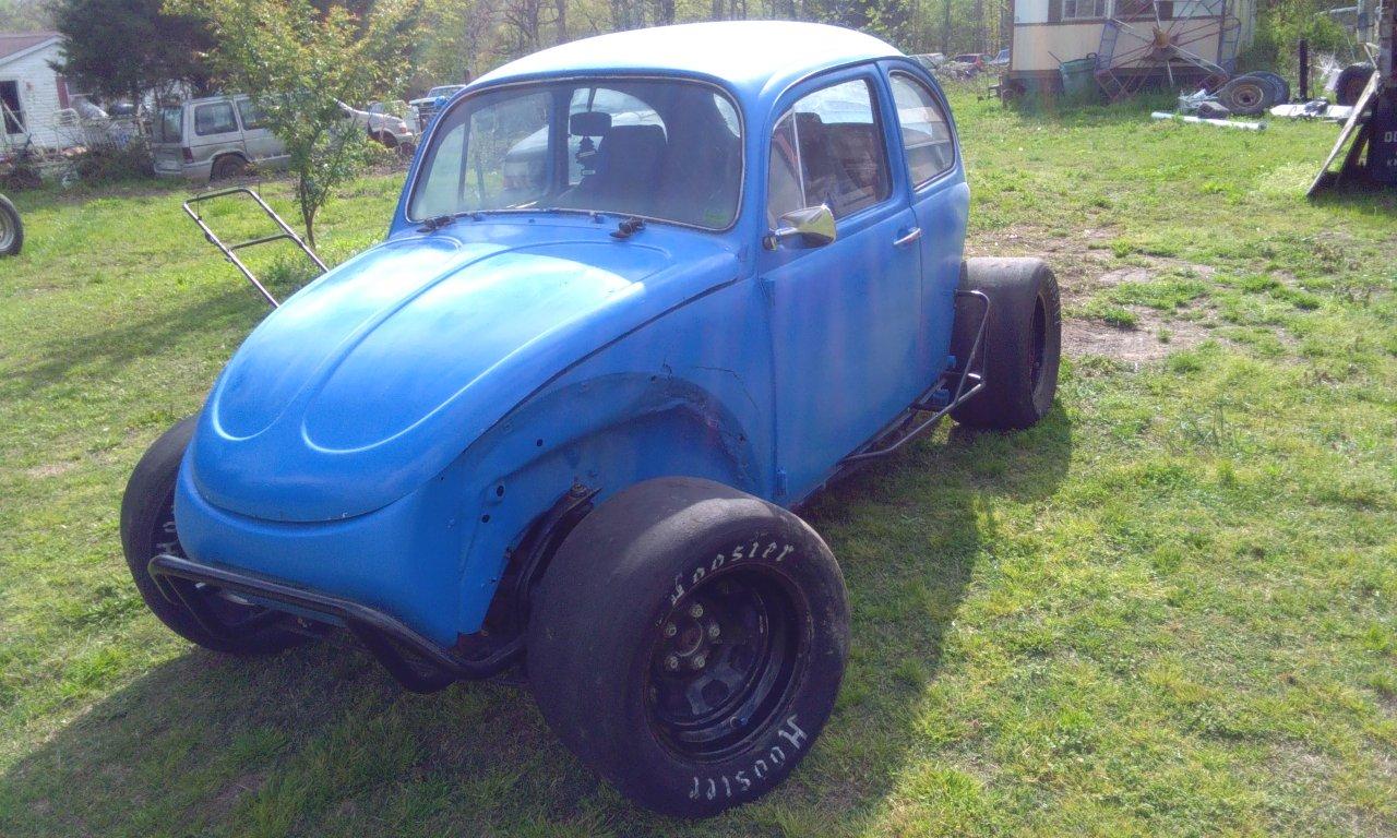

I'm in the same situation no fender and wheel wells are cut out at the line where the fenders would meet the body I just need to know how big I can go before I start to rub the shock towers it's a 69 IRS rear end

PostPosted: Thu Mar 09, 2017 11:38 am    Post subject: Re: Volksrod widest front tires and wheel options ??fenderless Reply with quote
green giant
Joined: March 14, 2016
Posts: 59
Location: N/A
green giant is offline
PostPosted: Thu Mar 09, 2017 11:47 am    Post subject: Re: Volksrod widest front tires and wheel options ??fenderless Reply with quote
Those are 10 in. wide. I don't have any rubbing issues, but I also have adapters on it so that widens it a little.I also believe the car has been lifted a little but not 100% sure. it was this height when i got it
