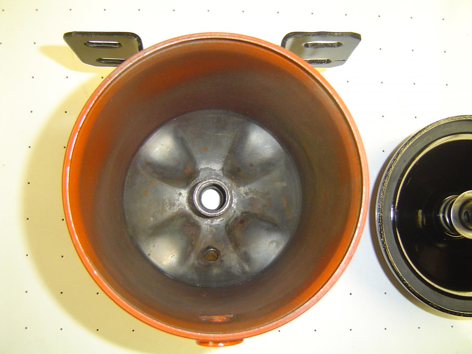

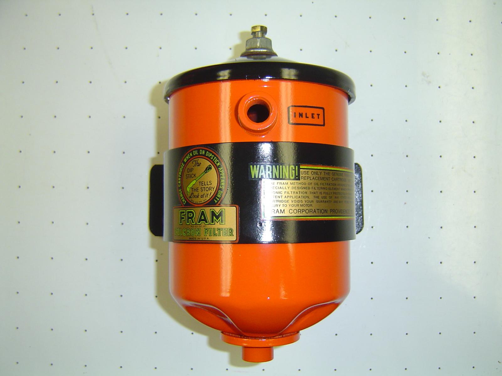

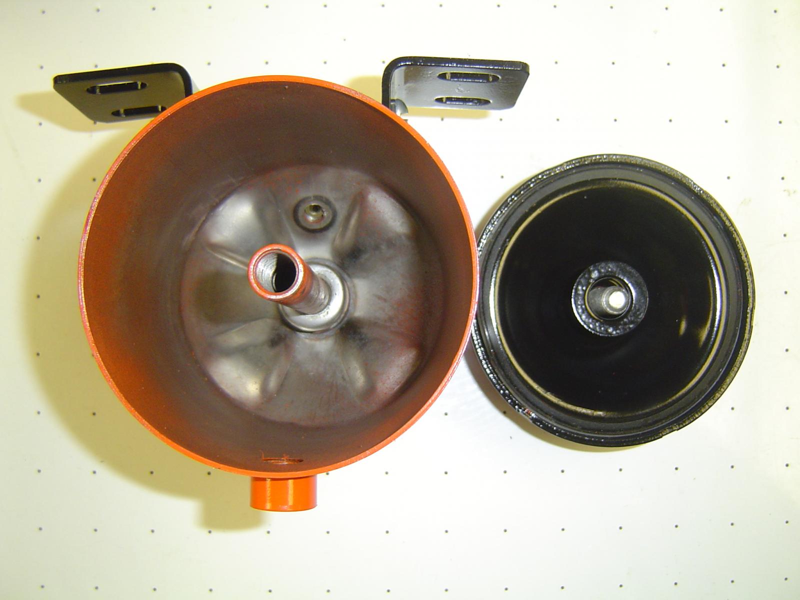

Does anyone have any experience with this P-1103 fuel oil style filter? I am wondering if it can be used as a bypass engine oil filter. I checked the canister size. It is the same size as the F/C-3. The C-3 filter insert fits. The fitting size for the inlet/outlet are US 3/8" The orifice size in the tube is a little larger than in C/F-P 3/4. So, I assume a restricter fitting would be needed in the supply or return line. Does anyone have experience, thoughts or suggestions on this subject?
