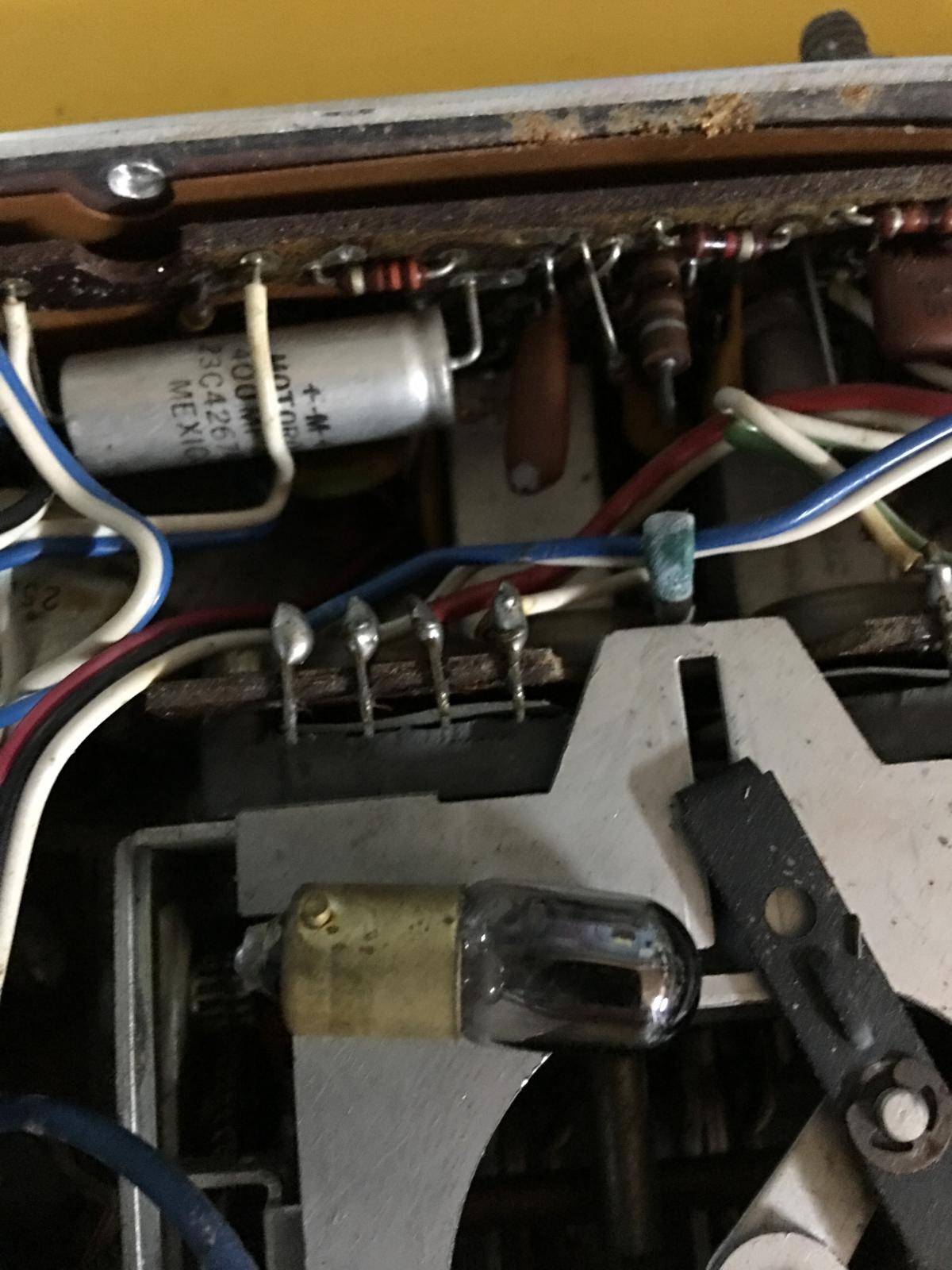

I'm trying to fix my original Motorola Sapphire XIV AM radio. I am hoping someone here knows what bulb I need for this bit of electronic history. lol

I am trying to locate the source for power on the original fuse box. Both the wiring diagram and my owner's manual say fuse 7 is for accessories. I'm guessing that's a radio. There is nothing plugged in on the backside to provide power along the 12v rail, so I'm not sure where else to go.
Originally, the radio above was installed in this bug. However, it stopped working in about 1990, and I pulled it out then, but had the sense to put it aside if I ever got the inspiration to fix it. Well, that day has come. lol
I have no clue where it was plugged in. There are 4 wires - two for the speaker, one for ground (light beige with a female connector and a male "piggy back" connector) and a fused black wire (female connector).

I found an acceptable replacement for the light above that works perfect in my radio. After comparing with 7 other Sapphires I have in various states of disrepair, the bulb I found fits all of them and works perfectly. 6 of the radios had bulbs that were burned out. The bulb I found that drops right in as a great replacement is BA9SF-WW-12AC from https://www.superbrightleds.com
