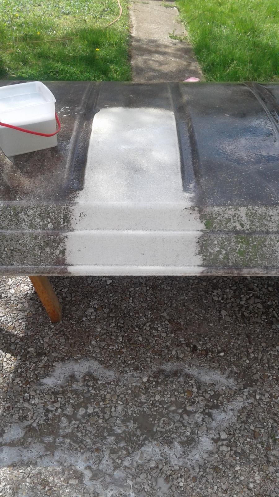

As the Good samba Says... Soap, Water, a little Bleach, and some elbow grease..
Came cleaner than I thought it would.
ALMOST left it at that, but couldn't resist throwing a little paint on it..
Used Rustoleum 2x Ultra Cover.. Did fine. I sanded it a little, but not a ton. Should I have used a good primer to fill some small cracks and sanded it again? Probably, but Im not after show-quality, really.. Im good with it. Threw it back on the roof, and put two bolts in it to hold it because next up is the luggage rack and taking out some ancient piece of hunk Air Vent someone put in a long, long time ago.. and replacing it with something newer, with a fan.. then sanding down the top and rain/drain guttering and painting the top. Will take pics of that progression.

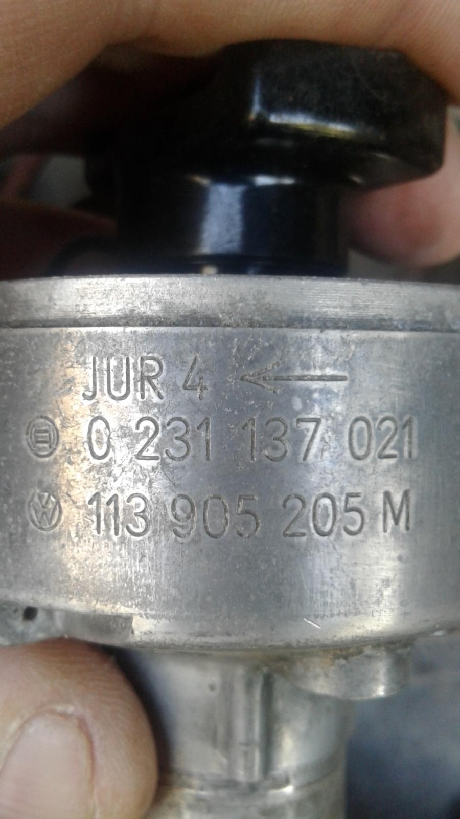

Dug around in the bus a bit.. I knew it needed a Distributor, and almost bought one from Aircooled.net, but Im glad I didn't because look what I found in the glove box along with a Bosch Blue Coil....
205M the the correct replacement according to old volks, and a Bosch to boot.. SVDA. Its got a 34 PICT3 on it.. (dont know the brand, Im not un-familiar with engines, but at Air cooled Engines, Im an amateur)

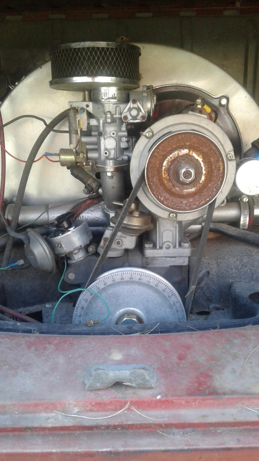

Engine really looks fine to me, Im just a little hesitant to put power to the vehicle without looking over some of the wiring, as it has been... *cough* modified...
Pulled the dipstick as well..
Leaning a little more towards that "engine is fresh" statement..

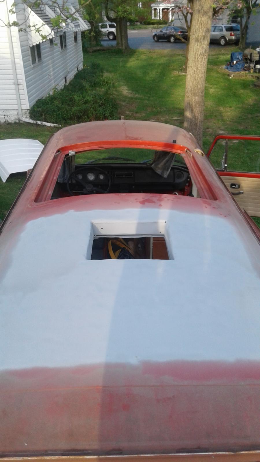

Little work before the rain tomorrow.
Grinded off all the screws from the old vent, sanded it down pretty good.. New vent didn't come in today, so just gave it an initial shot of primer, letting it dry then will sand again and tackle the whole top and gutters.
Here is a pic of "that damn hole some idiot put in the roof a few decades ago".

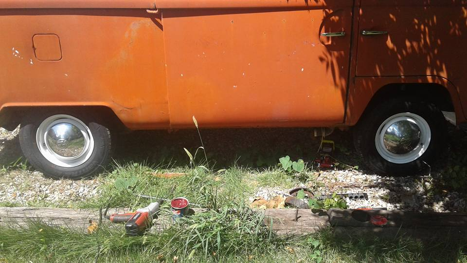

Been awhile, but life tends to do that from time to time. Progress is being made tho..
Painted the rims, mounted the tires with new valve stems.
Replaced both the front brake wheel cylinders (well, all four), both sets of shoes, new hardware, new hard lines and new soft lines.
Next up, the rear brakes, as long as I can find a socket for the hub..

Got the top hole issue fixed with a exhaust vent for a RV. Fit perfectly, even has a little 12vDC fan I can hook up for a little airflow. Sealed it good, no leaks. Sanding the roof down and painting it probably this week, then the pop top and luggage rack can go back on.

Tinkered with it today.. Drained the fuel tank, (Varnish) put a gallon of fuel in the tank, drained it... better..
Put #1 at TDC, put the distributor in after new points, cap, condenser, and rotor..
Put the battery to it. Checked for smoke (laughing, but semi serious).. turned on the key, and the only things that worked were the headlights, Wipers, and dash lights... Oil and Gen Light on..
Crossed my fingers, said a little prayer to the VW Gods, and kit the key for a sec... it cranked.
and cranked... and cranked...
After checking for spark (yep!).. No fuel. Mechanical Pump wasn't doing its job.
Got a 2.5-4psi electric, hooked it up to a switch. Turned it on, and checked for leaks.. and leaks there were... 4 of them...
Got line (not the right ones, but we're just testing here, purists) and fixed the leaks.. Ran it again... waited, and hit the throttle, and heard a squirt. Oh boy...
Cranked and WANTED to start, but the timing was off.... got the wife, and told her to just hold the key.. fiddled with the distributor until it finally started.. Get it a bit more close to in time, let the fuel flow a bit.. two wasp nests popped out the exhaust.... adjusted things a little, and....
The belt, obviously, is screwed.. hence the rattle.. I did take the belt off and ran it for a minute to check, and yep... sounded great.
NOW WE'RE COOKIN' WITH GREASE!

mattlockwood wrote:
I think with a 205m dizzy you'll want a 30 PICT carb, not a 34. Smarter minds than me will tell you for sure tho.
Project looks awesome.
Carburetor/Distributor Matchup
http://www.vw-resource.com/carb_dist.html
wcfvw69
Samba Purist
Joined: June 10, 2004
Posts: 13709
Location: Arizona
wcfvw69 is offline
PostPosted: Sun Aug 27, 2017 7:50 pm    Post subject: Re: Help on the way... (1970 Camper Project) Reply with quote
Nice thread and nice work bringing your bus back to life.
Your 34-3 carb is not a match for the 205M distributor. The 34-3 pulls tons of vacuum vs. the mild vacuum required to move the vacuum advance on the 205M. The 205M was installed on 1968 single port engines with Solex 30-2 carbs.
For that aftermarket 34-3 carb on your dual port engine, the best distributor would be a 034 SVDA distributor. It's a match for that aftermarket carb.
