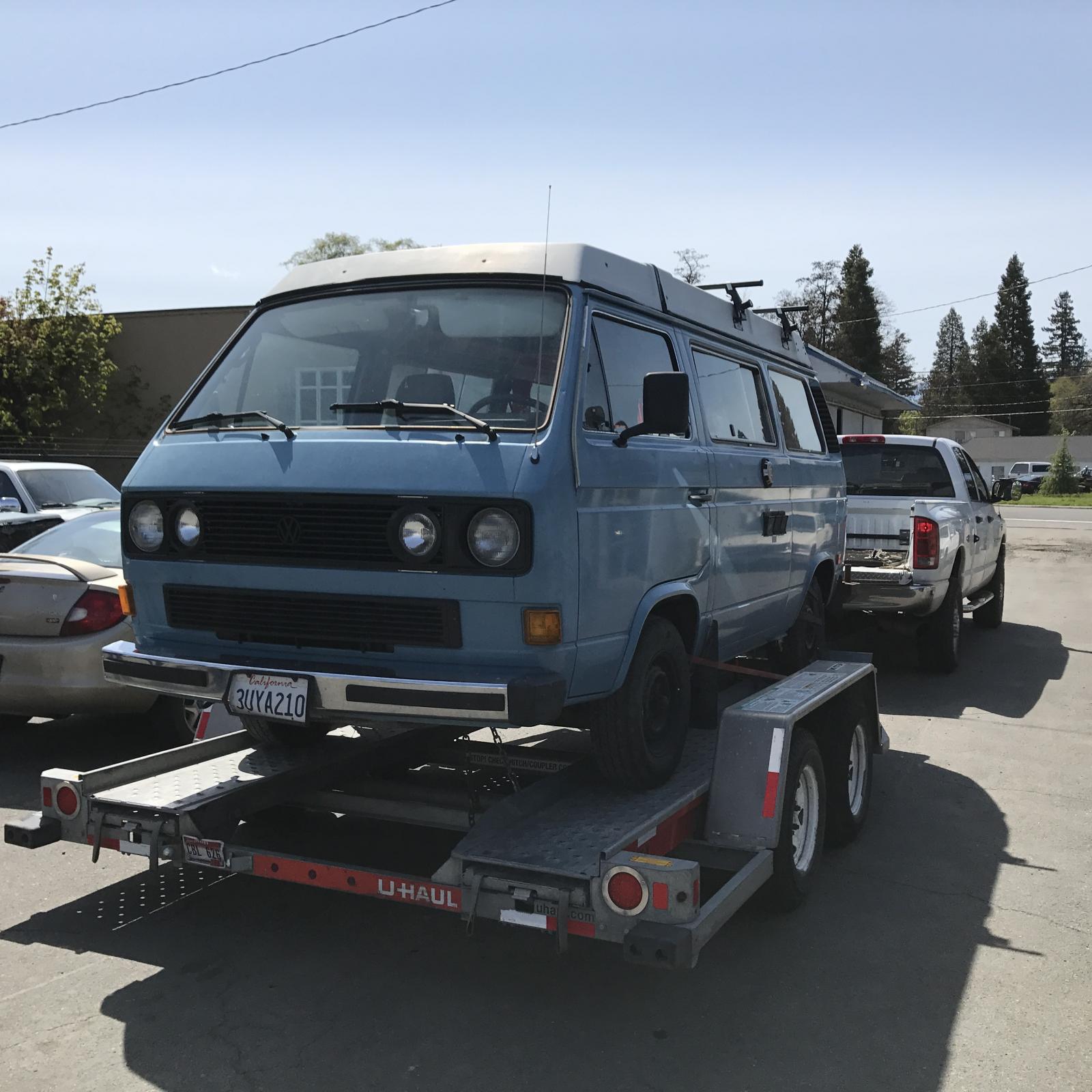

So, we were on our way up to Portland to show my kid Portland State. Just North of Grants Pass I decided to take a dirt road to camp for the night. The road was a muddy, tight single lane that turned out to be a driveway. I backed out about 1/8 a mile and all was great until the very end when I saw the road disappear in my rear view. I ended up sliding into a ditch.
I tried to get out but was wedged pretty good. I ended up getting winched out (thanks AAA!). I added some oil and it fired right up/sounded great. We went a couple hundred yards down the road and camped for the night. Well, when I left in the morning it was pretty clear that there was a lot of damage, confirmed by a local mechanic. I ran it too long with no oil pressure while trying to get out. So now I'm getting towed by my favorite uncle back home.
I bought this van because it is a diesel and I knew I could swap whatever I want into it but I wasn't planing on doing that for a couple more years. So now it is time. I've read EVERY thread on the whole internet on this subject (yes, all of them) and am not sure which way to go. So I thought I'd start yet another thread so entrenched interests can get back to war on the subject.
I was originally thinking diesel (Subaru or TDI) but I really don't want to worry about the transaxle. So I think I've decided on gas. I'd prefer not to have to put premium in because I don't know if premium will be available all the places I hope to take this van (think Drive Nacho Drive). So I think that takes out the 1.8T option (all turbos?). I've put some thought into the attributes that are available to me, in descending order. I'd love to hear your thoughts. Thanks in advance.
1) reliability
2) fuel efficiency
3) availability of parts (this could easily be a #2)
4) ease of maintenance
5) ground clearance
6) power (I want to pull hills at 65 without destroying anything)
20) cost (I want to do this once and do it right - never looking back and wishing I hadn't gone all the way) (don't tell my wife this is #20)
