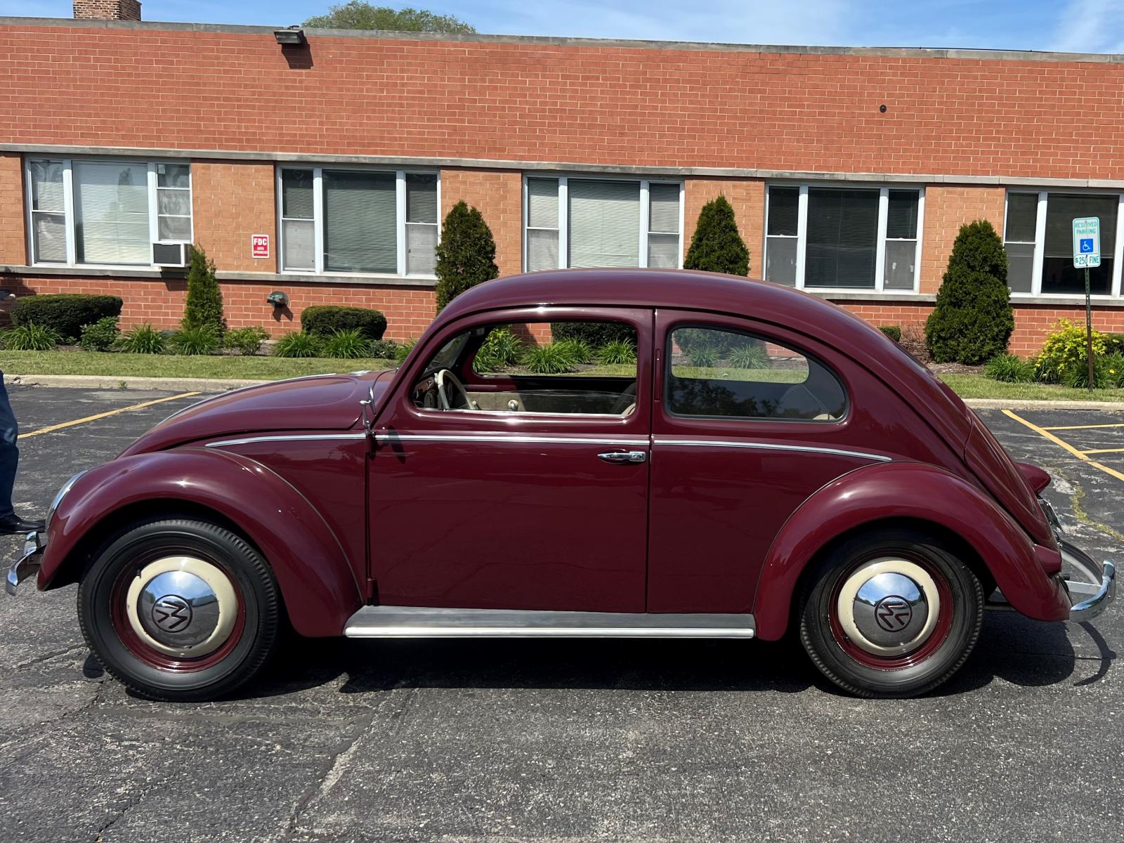

I have owned many VWs over the years but recently acquired a 1950 Hoffman Sedan ( I also own a very low mileage 1977 Sunroof Sedan, and wanted one of the first VWs in the US to go along with one of the last!). This car was restored at some point in the past, but I know little about who did the work and when. If anyone knows my car, and has info on it, I would appreciate it! I purchased it from the widow of the previous owner.
I know there are some things that are not correct on my car, and would like to correct those items over time. I could use some advice on what is correct and what is not on my car, and have included a few pics here.
I like driving my cars-my son and I just did a 2,600 mile trip in my stock 1930 Model A Fordor Sedan, and i would like to put some miles on this VW, too. However, a few issues off the bat. The wiring looks to be well done in the engine compartment. but is a bit of a mess in the trunk. When I got the car, I noticed the generator light did not come on with the key. Pulling the wiring cover back revealed why-the light was unplugged, and is on all of the time once the key is on -in other words, it does not go off when the engine is running. A friend of mine and I adjusted the voltage regulator, and a multimater indicateds 7.4-8 volts at higher rpm at the regulator, but-here is the strange part, up to 32 volts at the battery at higher rpms. We disconnected the wiring at the voltage regulator, and even removed the fan belt, and still get 14 plus volts at the battery at higher rpms. With the engine off, the battery reads about 6 volts. This makes no sense to either of us, so i thought I would see if anyone here has any ideas!
As mentioned, I am looking forward to correcting things and improving things, and would like to the dash pods restored properly, make sure things like the upholstery is correct, etc., but would like to get this car so its at least reliable so I can drive it for the next couple of months. Any advice/guidance are truly appreciated-this is my first split.

Agreed about the battery. I want to put it so that it is correct,and have been collecting the parts to do so. When I bought the car, it had a Gel battery laid on its side, but that would not hold a charge (it was fairly old). I bought this from napa just to get be able to start and move the car under its own power. It seems that once the cover is on, the seats springs will push right down onto the battery, as they are much bulkier than later VWs. Is that how they were?
I will get a photo of the 50 and 77 together at some point-this 50 is at my house in Chicago, while the 77 is at my house in Chandler, AZ. Not sure which will end up being moved.
Joe Ruiz built the engine-there was a receipt for it in the car, from 2012. But I do not think it has done many miles since then, something I full intend to change!

For me the pulley looks just the correct one. The upper, generator pulley is updated at some point, when this version in the pics introduced on Jan 1951.
The correct Split battery height is 215mm.
Red color is very nice!
