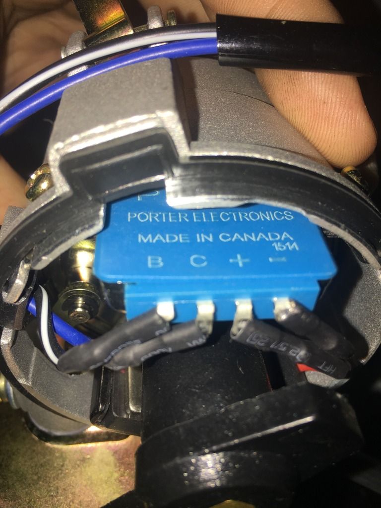

I run a VW10 and have been completely satisfied with it over the past few thousand miles. It's a departure from Bosch based distrubitors in that it's a Nippon Denso adaptation to VW use.
A VW10 is a Richporter copy of the 009. You're lucky since many have reported many problems.

I have both units. The VW10 is a completely different distrubitor platform. Like I said it's based on mid 80's Japanese units. It is in no way related to or shares any parts compatibility with a Bosch or an electronically converted Bosch. It's literally as different from a Bosch as a GM HEI is. For the $120 you pay for it with a lifetime warranty (if purchased through a major parts chain) there's basically zero risk to owing one. If you are nervous save the old spark scattering 009 for a emergency roadside repair to get home.
