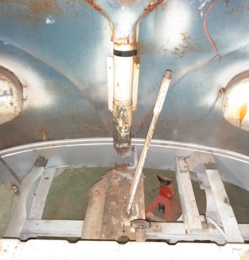

NOTE: Plenty of queries ahead...
As some of you know, my bus is over 1,000 miles away from me and this part of the world isn't laden with barneys, so bear with me if I'm asking what may be seemingly ignorant Qs, please.
1. My bus came from the factory without rear seats. We've now installed a floor with seat brackets, but are unsure of where to place the brackets and which direction they, and the plate, should face. Yep, I know that the plate is not in the right vicinity in the photos.
2. Where should the holes for the rear seats be, what size should they be and is there any reinforcing that we need to weld in? I am intending on modifying a Fleetline bench and rear seat.
3. Should the handbrake mech' and arm be straight or leaning towards the driver? Looking from the underside, the entire mech' looks to be bent to me, but perhaps I'm in the wrong...
4. Whereabouts can I find a decent RHD accelerator pedal, please?
Any info' on any of these queries would be greatly appreciated.

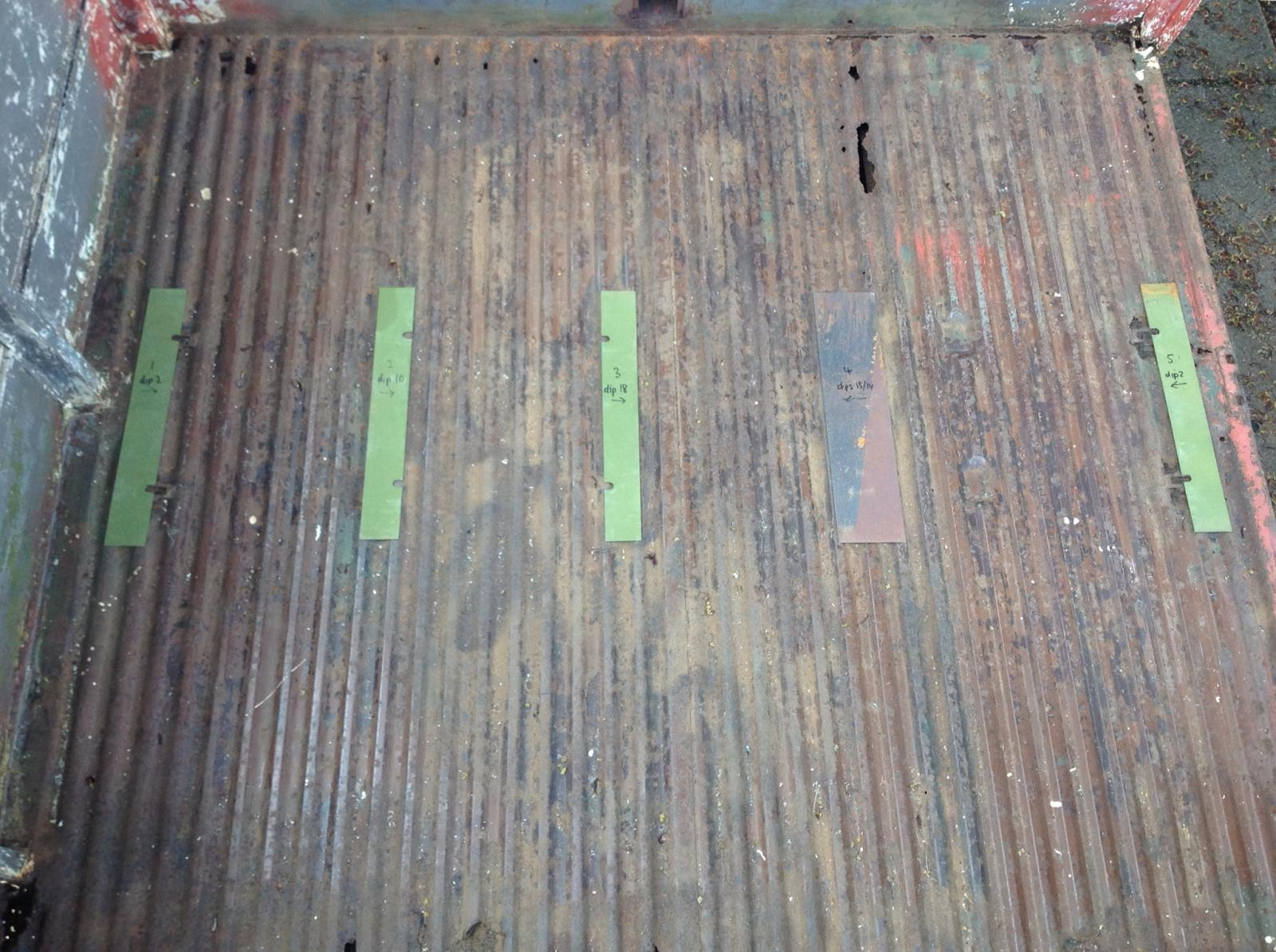

Middle seat plate locations & cutout directions.

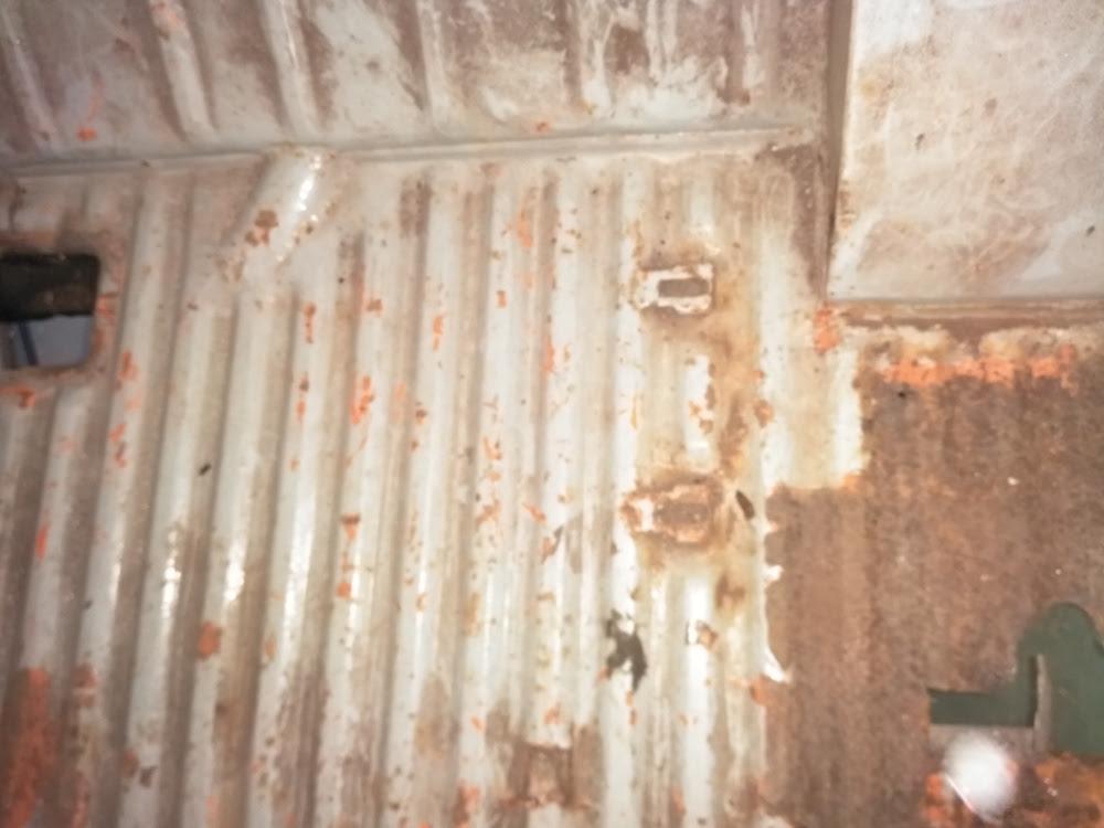

Seat brackets: flat side of the bracket's hole is always closest to the centre of the bus. Curved edge of hole is always closest to the outside of the bus.
There's no other strengthening involved (someone else can confirm).
The rear seat has no floor plates. The middle seat has those five floor plates.
The rear seat brackets straddle the 10th Dip in from the side.
Best to get your seats modified & test-fitted/positioned first...
It looks like your floor, where the rear seat mounts, has raised areas when they should be recessed...the brackets should sit pretty much flush with the Ribs...check the reference pictures.
You need to get that bus closer to home! _________________ -StockRocks- |

The section under the rear seat in those references photos (which are an excellent aid!), is very peculiar. My bus has definitely had any metal replaced before now. I'd love to hear from more barney owners, to see if anyone else has raised ribs there.
I know that my Kombi was ordered without rear seats. We're retrofitting a passenger floor. I can't imagine that they'd use an upturned panel there if no seats were ordered.
Do you perhaps have photos of where and how the backrest mounts, please? ...unless I'm blind and have missed that in the photoset?
Sadly, my bus won't be moving any closer for a long time yet.  _________________

The rear seat mounts on the 55 look the same as mine, and yours appears to have recesses for the lug brackets too, unless it's an illusion.
