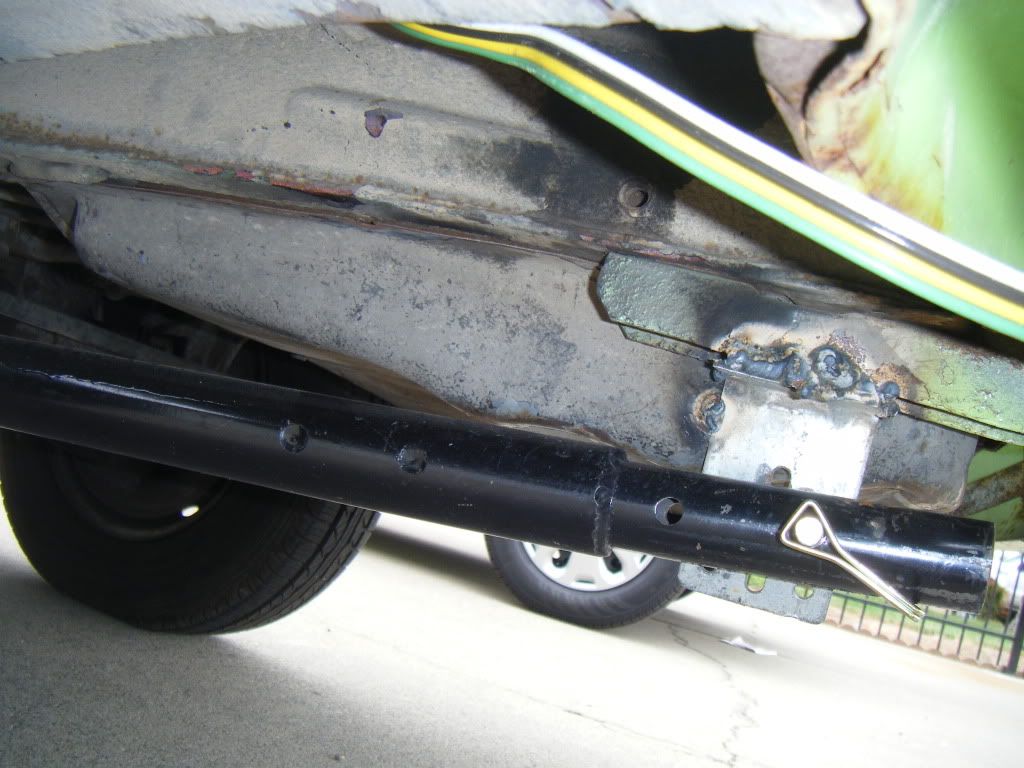

Why buy what you can build.

WOW, look at that weld in the last picture. Flippin blind Monkey must of done that.

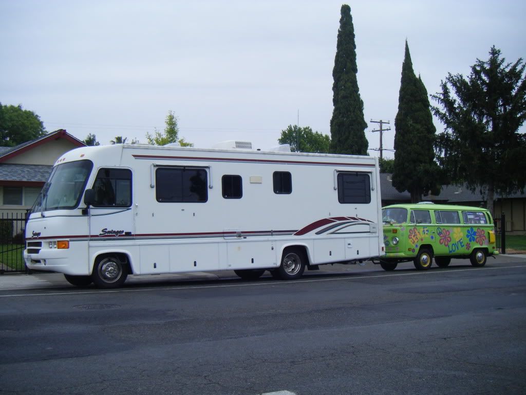

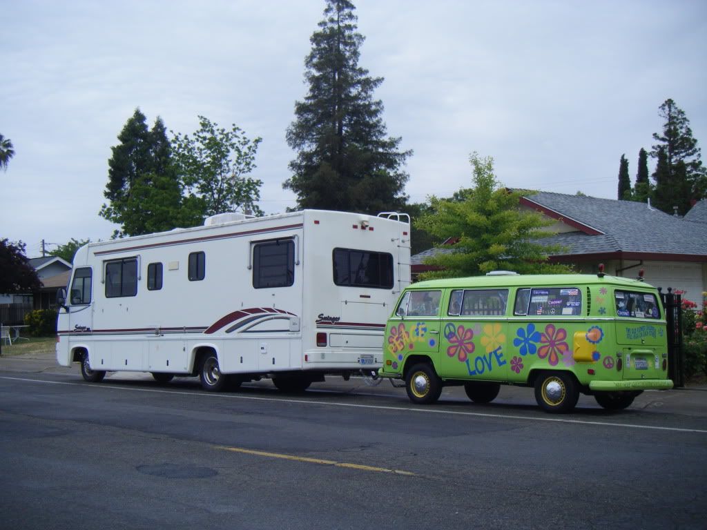

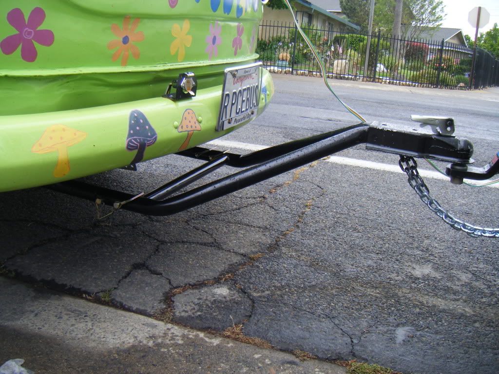

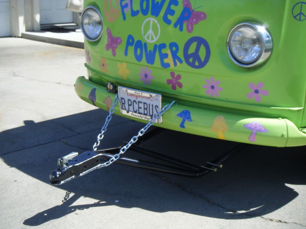

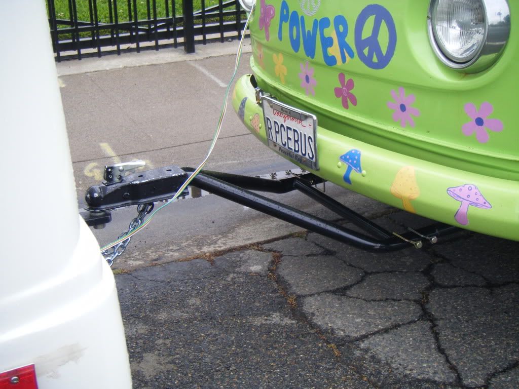

I tow my 67 everywhere with my old class C RV. Never had an issue.. thousands of miles. I've got one of the tow bars made and sold here. I picked it up at the Litchfield Bug In years ago. Couple of issues, the pins holding the bar to the beam were a bit small. They bent on me. Drilled them out to 3/8 pins and never looked back. Also, the bar rubs on the sway bar. You also have to remove the stabilizer shock to mount to bar to the beam.
When I first started towing the bus, it didn't like to turn with the RV in tighter corners. It sometimes dragged the wheels in a real tight corner. I thought it was the large over hang past the back wheels on the RV. Come to find out, the lower trailing arm was bent in and the camber was way off. Replaced the arm and it turns like a dream. It probably also caused the pins to bend. I load it was parts, DJ equipment, camping gear, whatever I'll need for the trip I'm taking. Never a problem.
I put chains on everything. Beam to bar, bar to RV. Here is what it looks like...
