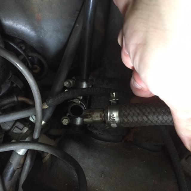

PostPosted: Sat Jun 10, 2017 2:29 pm    Post subject: Re: Engine suddenly runs terrible Reply with quote
So here are some pics of my hose in question:
Above you can see the braided hose in my hand with a metal pipe in the end, and a hose clamp. This hose goes to my decel valve, and connects to the open plastic T fitting you see in the pic.
Above you see the braided hose and pipe plugged into the T fitting. It goes in and out with not much effort, which leads me to believe air leaks here easily. Note there is a hose clamp on the plastic T fitting as well. I am hesitant to crank down on that because if the plastic cracks, thats a whole other can of worms.
Another shot from the rear hatch of the hose plugged in place. The T fitting goes to the LH side of the plenum and to the LH side of the engine bay, where it exits. I take it this is for the vacuum booster brake servo? It is a hard plastic type line, not rubber.
How can I secure this hose and prevent leaks? Can I use electric tape around the metal pipe junction so I have to really twist it in lace, then tighten the clamp on the plastic T fitting? Should I widen the pipe somehow? It needs to be a more snug fit, for sure.
Thanks for any suggestions...
