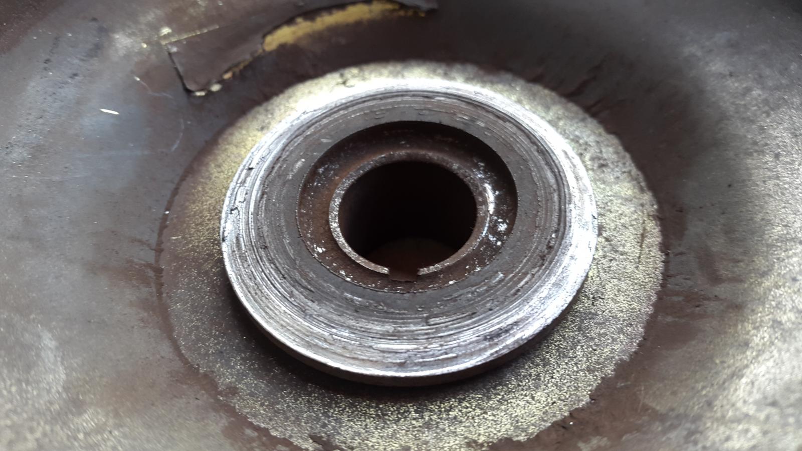

I think I'm having the same issue with the rubbing. Here are some shots of the damages. Left me stranded down in Los Padres a few months back. The rubbing had gotten bad enough that the motor wouldn't turn over which is what made me aware of the issue. I fixed it on the side of the road with a washer and made a new spacer when I got back home. However, the spacer I made has since bit the dust (shouldn't have made it from aluminum, Embarassed )
Here's a quick video showing the rubbing.
https://youtu.be/o4VOc4LN9o0
Also, the spacer (aluminum) I think has mushed apart and has mechanically locked the pulley to the shaft via that woodruff key. Got a new alternator and pulley kit coming from CB. I'll keep you posted on it getting installed and what parts are required.
