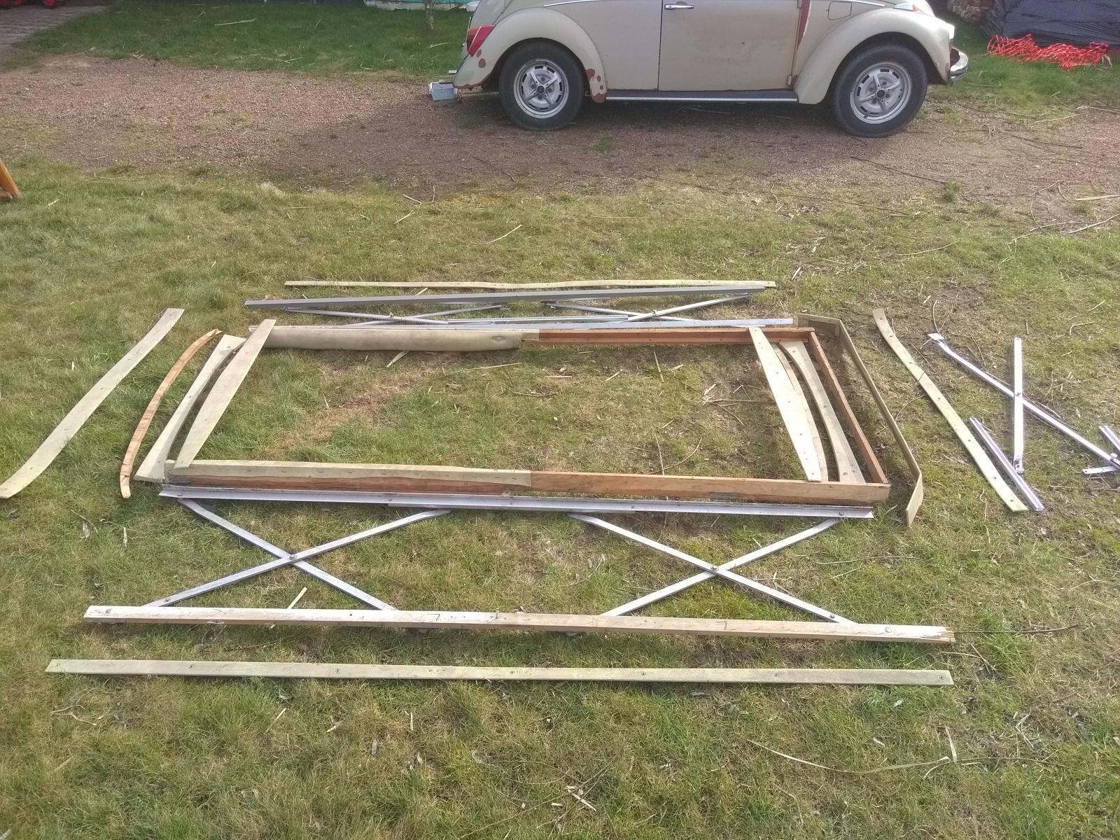

Been thinking about putting a poptop on my tintop bus for a while now, with two kids some extra sleeping space is much appreciated.
Since a westy roof needs a lot of work on roof support etc I decided tot start searching for a Riviera roof.
About a week ago I found a (mostly) complete roof only 20 minutes from home.
Picked it up last weekend.
Now the puzzle starts...
I've been looking through all the stuff that came with it.
As far as i can see i'm missing the latches to hold the roof down (ordered online) and the springs are not with it.
Now my first question, what is the length, thickness, etc of the springs? And how many do i need?
I've been searching online but looks like some roofs have the springs on the top and others are at the bottom.

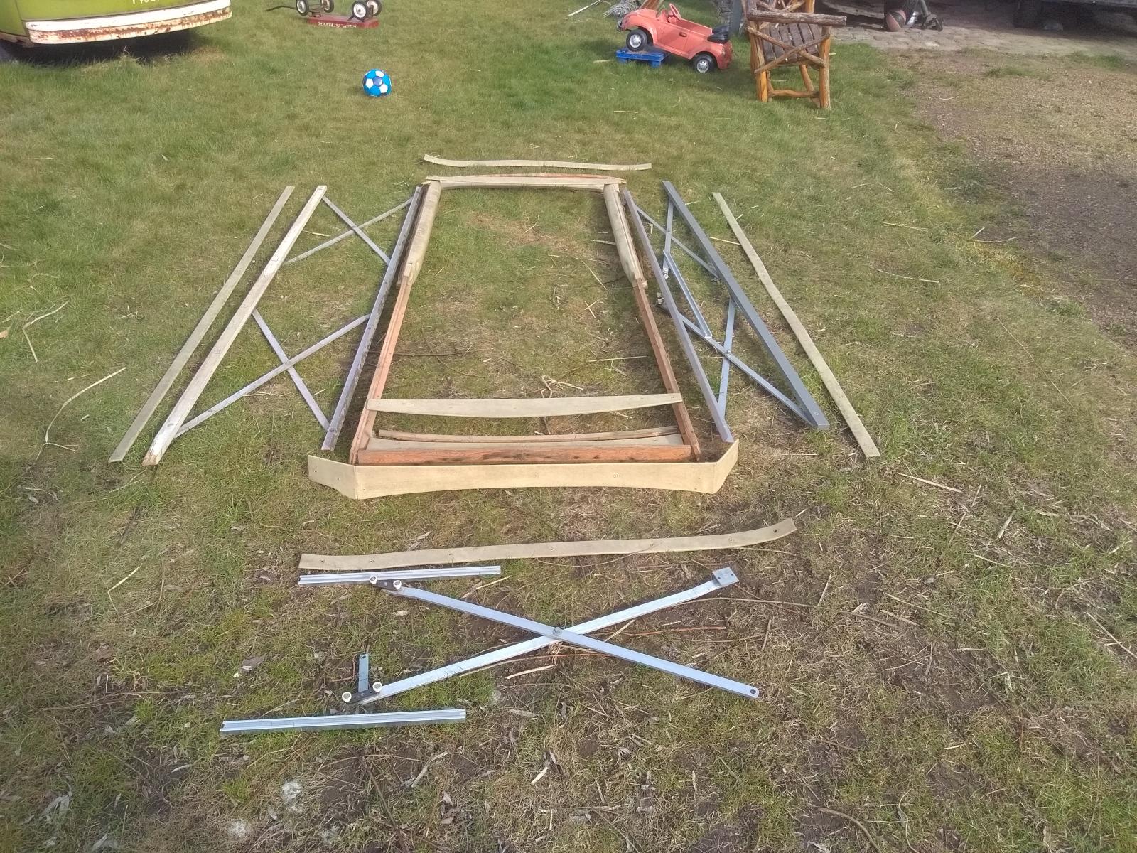

Now some pictures of the frame etc, if you see anything wrong or missing please let me know!
If you have any detailed mounting pictures please feel free to add them here!

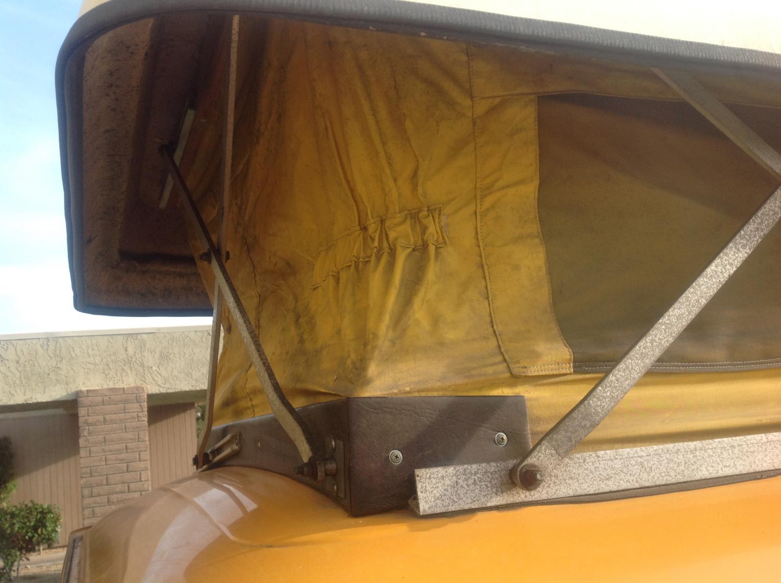

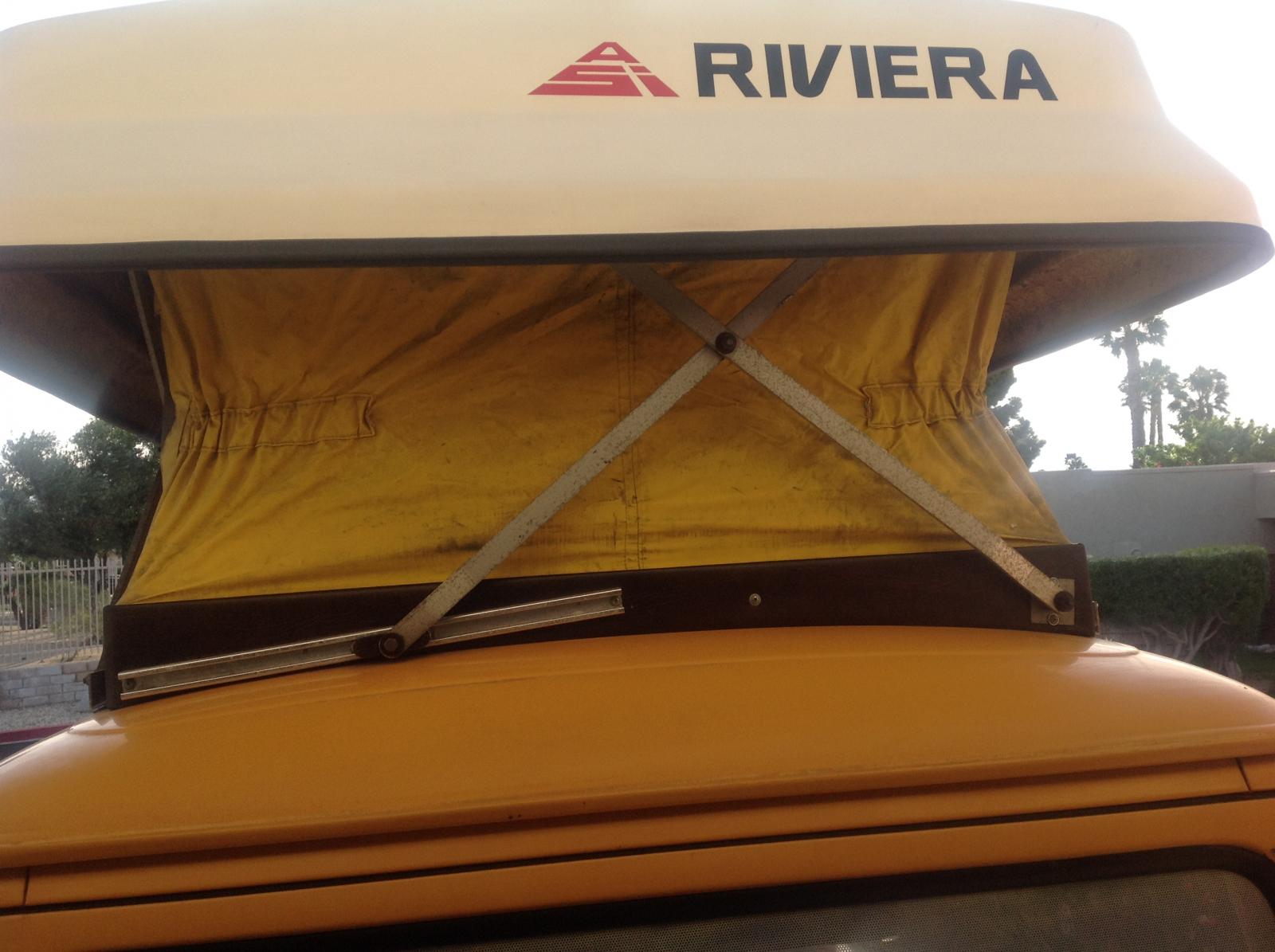

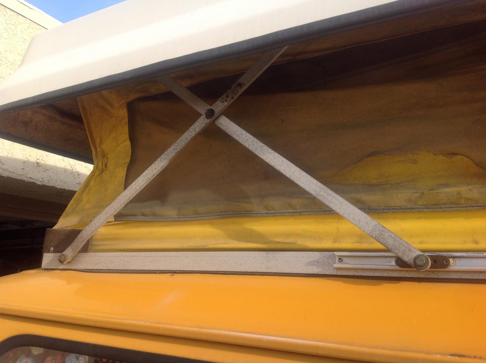

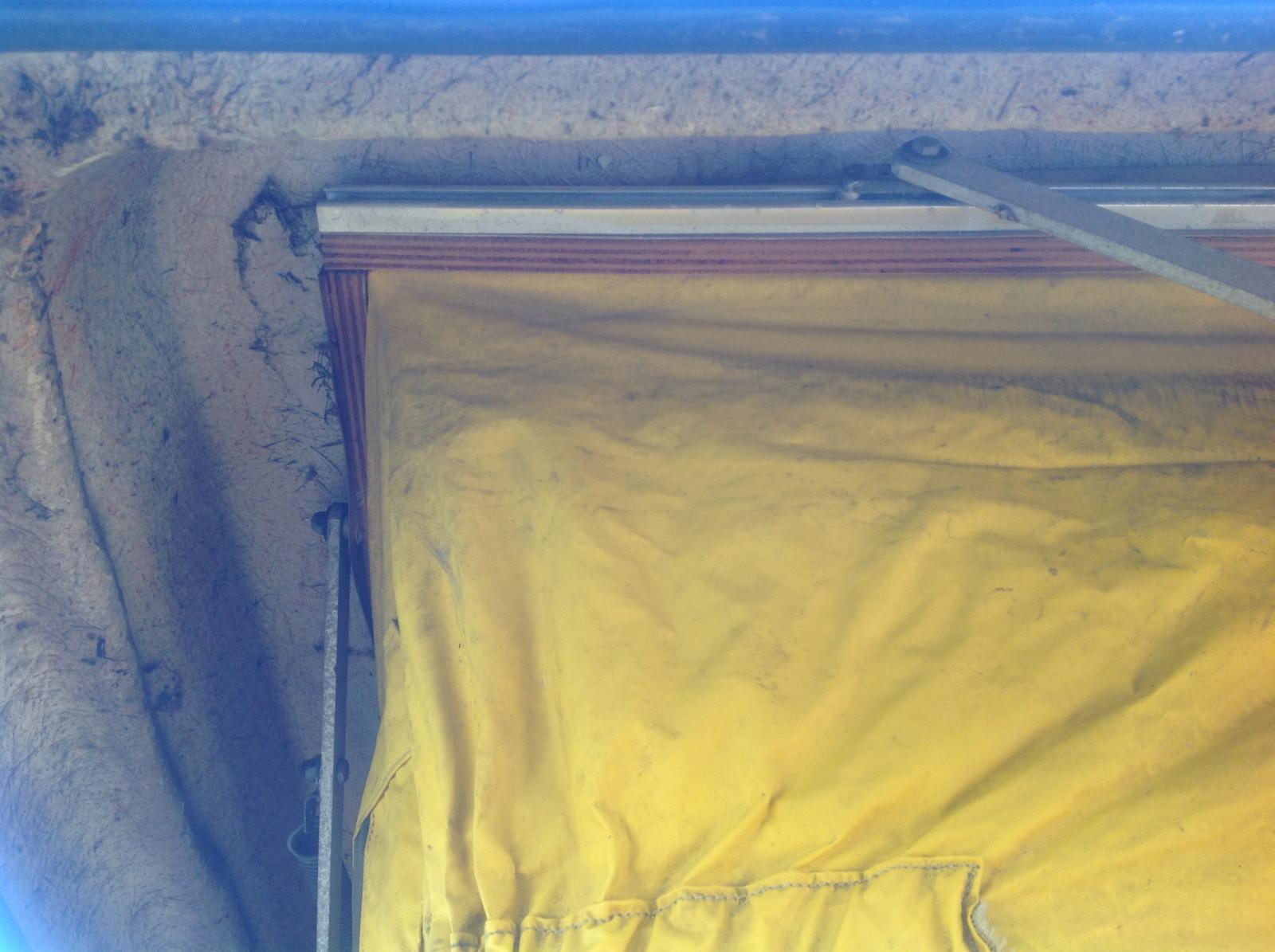

Here are some pics of the exterior...
NO laughing at the original ripped tent. It functions...just isn't pretty...

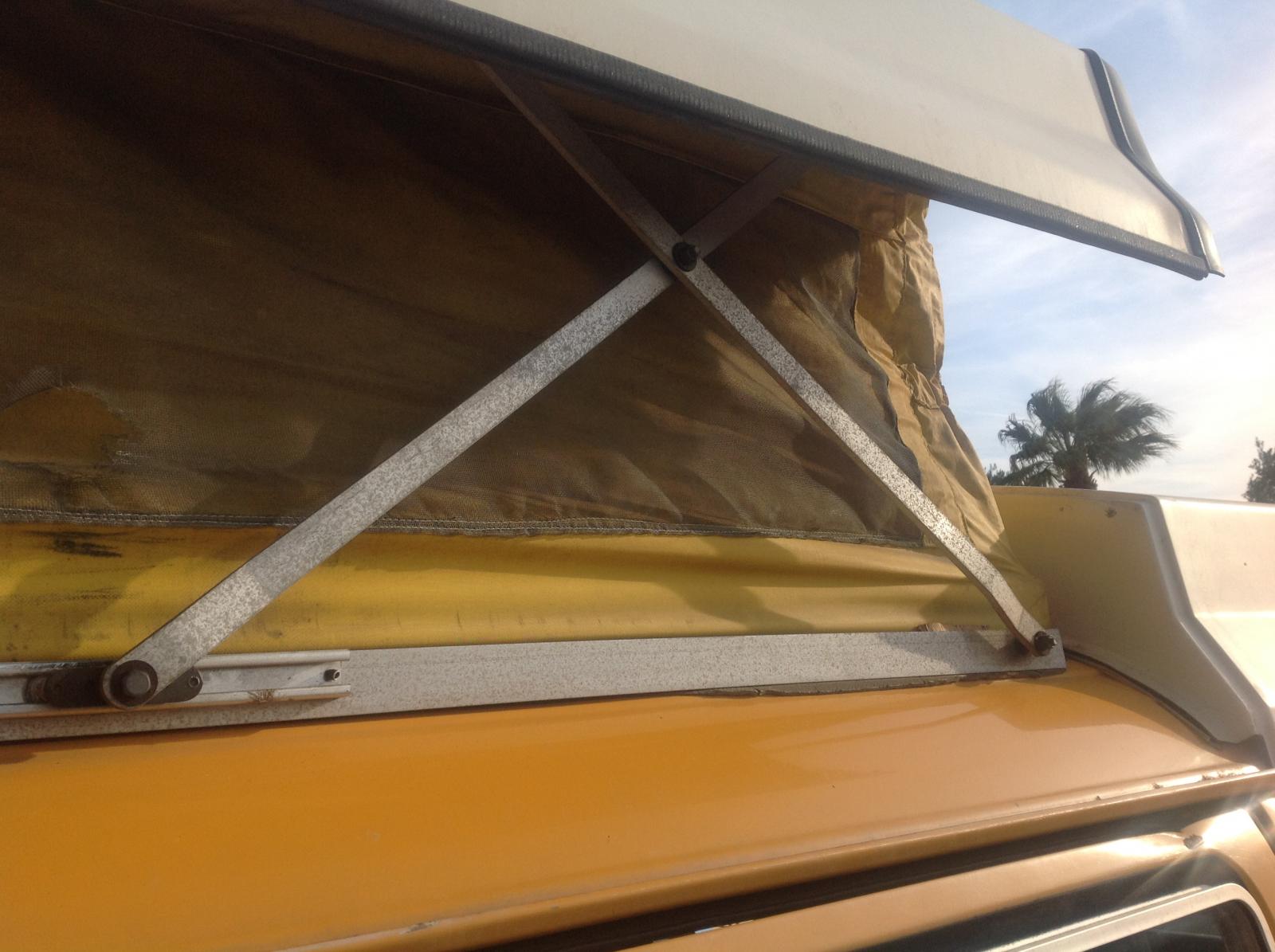

Passenger side:
Rear:

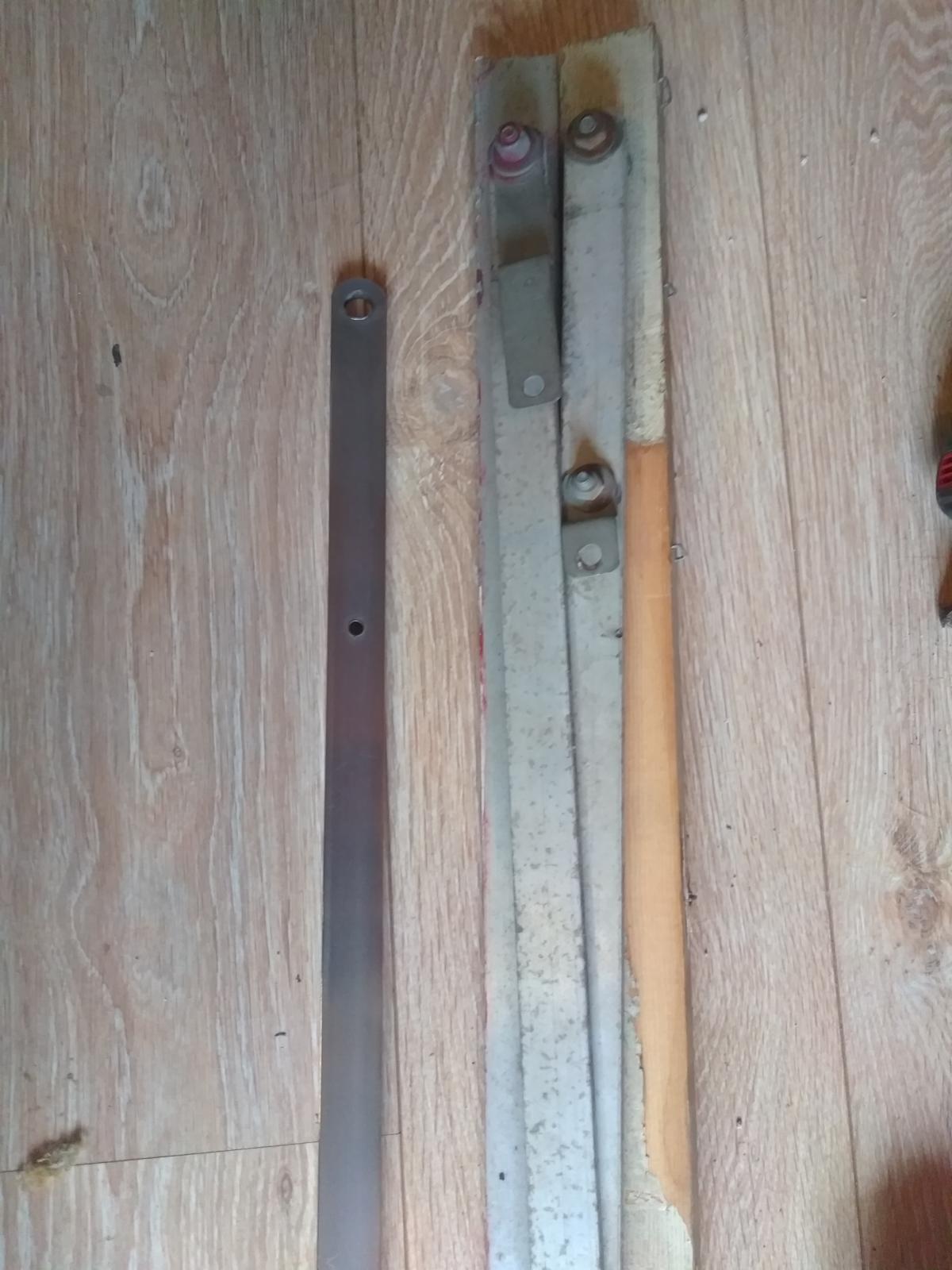

Spring:
The springs are pretty massive, and under a lot of tension even with the top up. So I'm not sure if I can get one off to meaure it. Can you contact the previous owner and ask if he/she still has them?
-Kent-

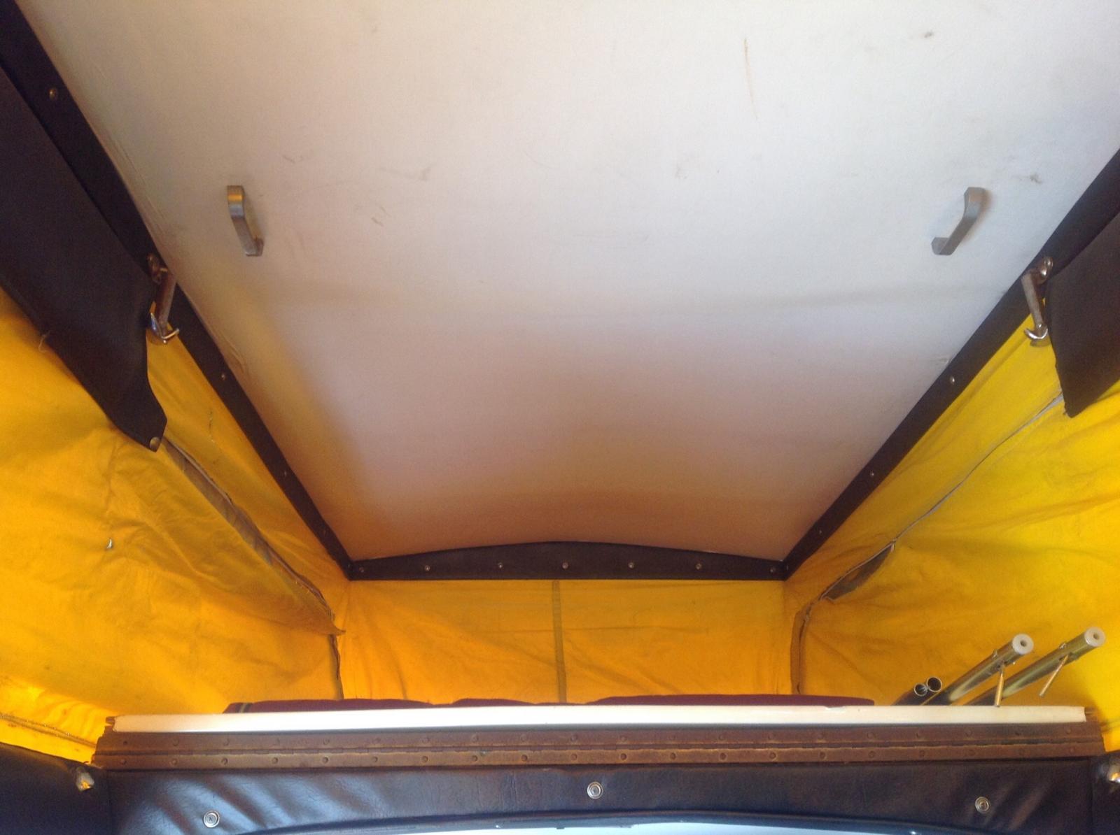

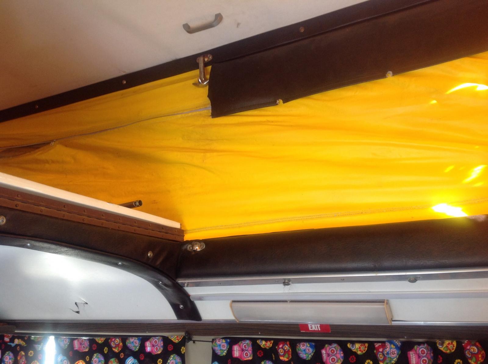

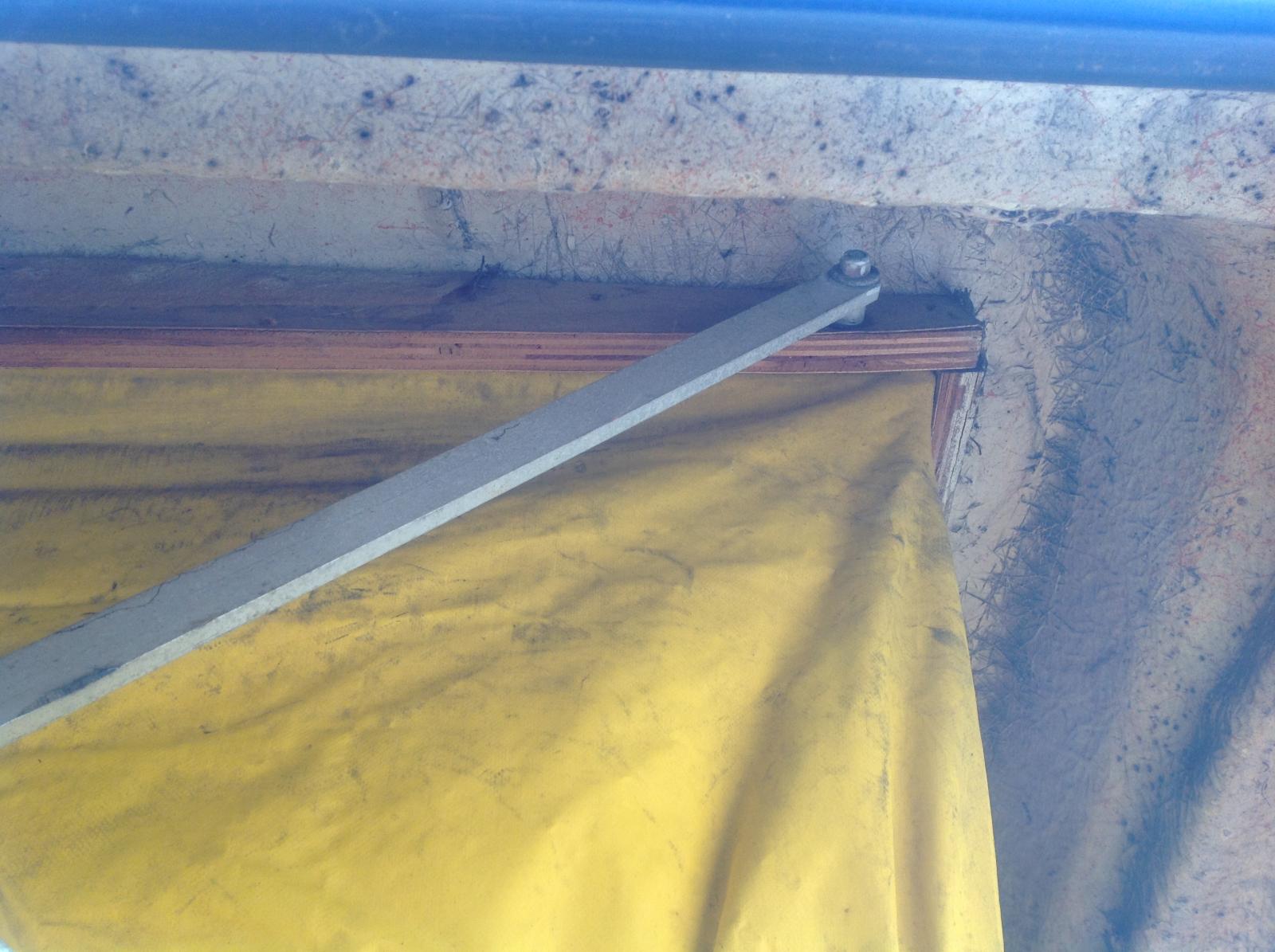

A few interior shots:
Let me know if you want any pics of specific areas or dimensions of anything.

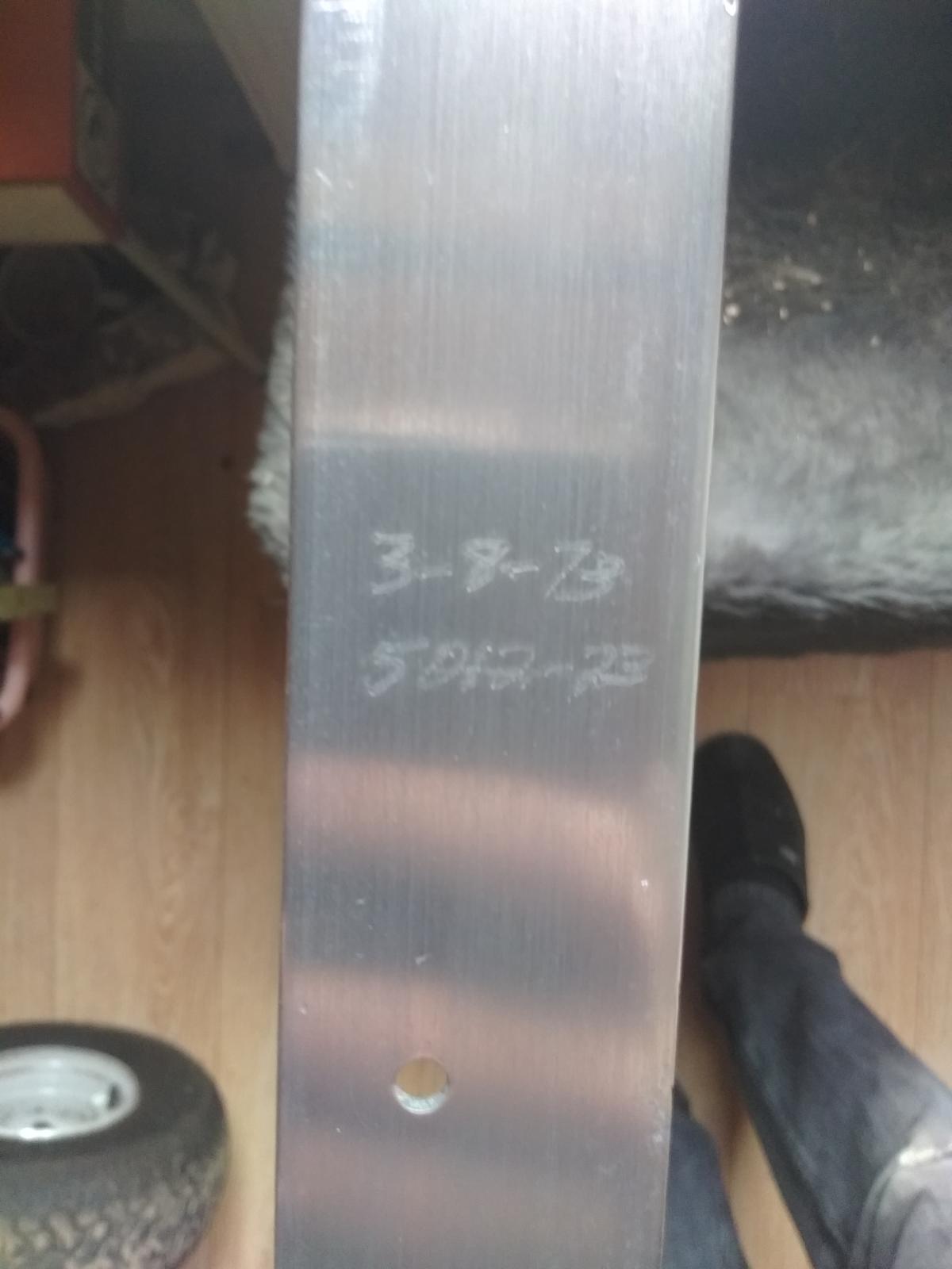

And while polishing the part that is bolted to the roof this number appeared. Is this perhaps the production date? 3-8-73 5012-23

PostPosted: Sun Mar 18, 2018 5:52 am    Post subject: Re: Riviera roof install on tintop Reply with quote
It's amazing how something 45 years old can look brand new again.

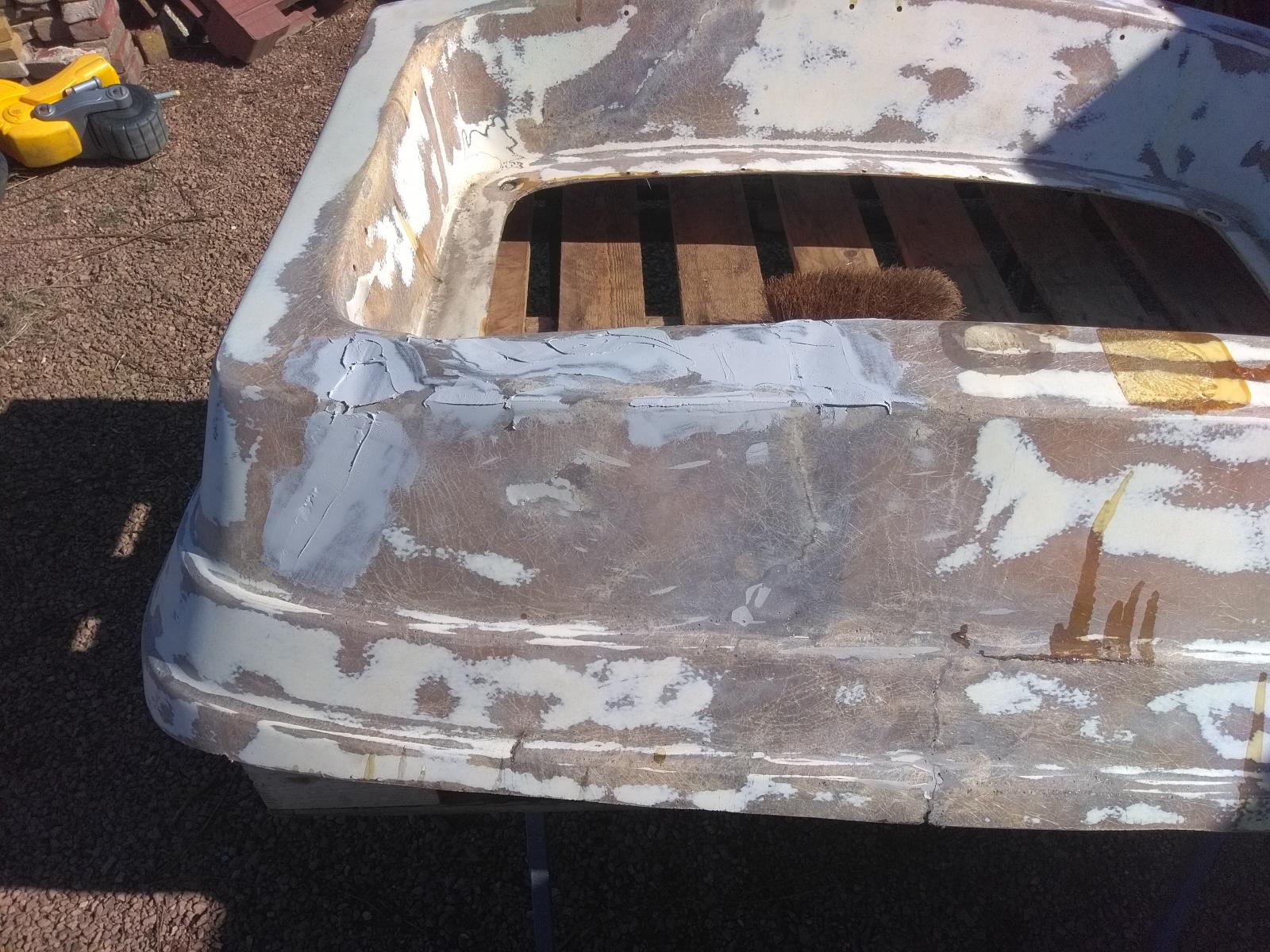

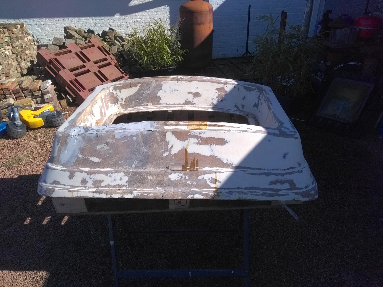

Started work on the front roof part yesterday.
This is in rough shape, lots of cracks, dents etc. Looks like it almost broke in two pieces once.
The previous owner had the inside done with a new layer of fiberglass so it's got it's strength back.
But the outside still needs a lot of love.

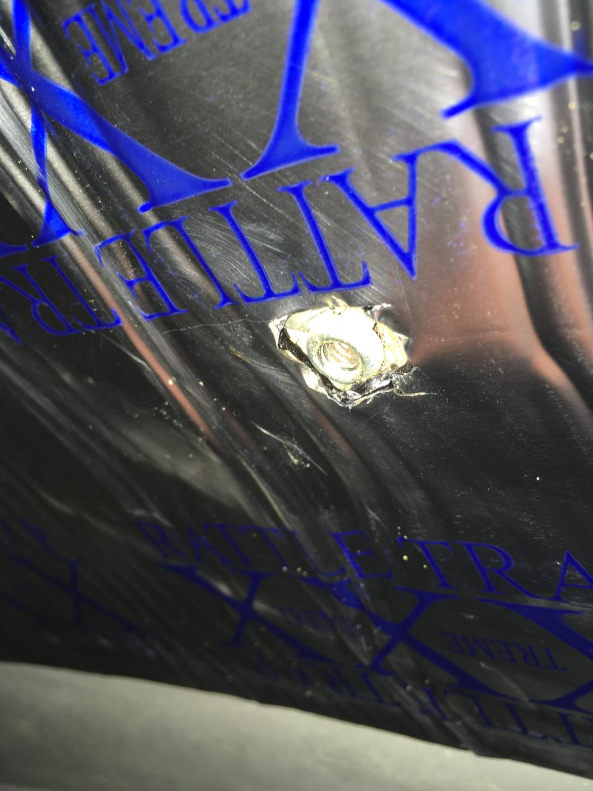

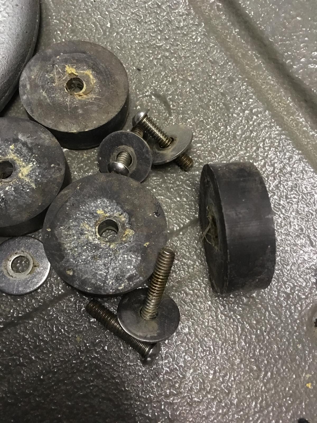

Anyone can show me a picture of how the luggage rack is attached to the metal roof?
I've heard there should be some sort of spacer in between the Fiberglass and metal roof. But i haven't got a clue how it looks.

PostPosted: Wed Mar 21, 2018 8:32 pm    Post subject: Re: Riviera roof install on tintop Reply with quote
There are four holes in the roof over the cab that have threaded nuts welded to the cab ceiling on the original riviera. On the outside there are four hockey puck like hard black plastic spacer/washers that go between the metal roof and fiberglass top. I will try to find a photo.
1974 Riviera - Subaru EJ22
Build Thread: http://www.thesamba.com/vw/forum/viewtopic.php?t=630031
Ives676
Joined: June 20, 2013
Posts: 274
Location: Rogers, AR
Ives676 is offline
PostPosted: Wed Mar 21, 2018 8:45 pm    Post subject: Re: Riviera roof install on tintop Reply with quote
I snapped these pics real quick.

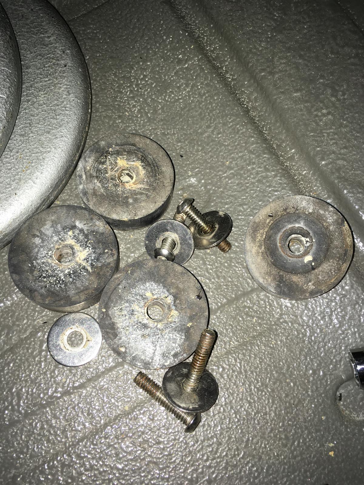

Not sure what they are made of but they feel like really hard plastic. Very dense like a fiberglass or plastic hockey puck.
And last....not a great picture because the sound deadened is covering the welded nut but there are four of them that line up with the four holes in the luggage rack.
