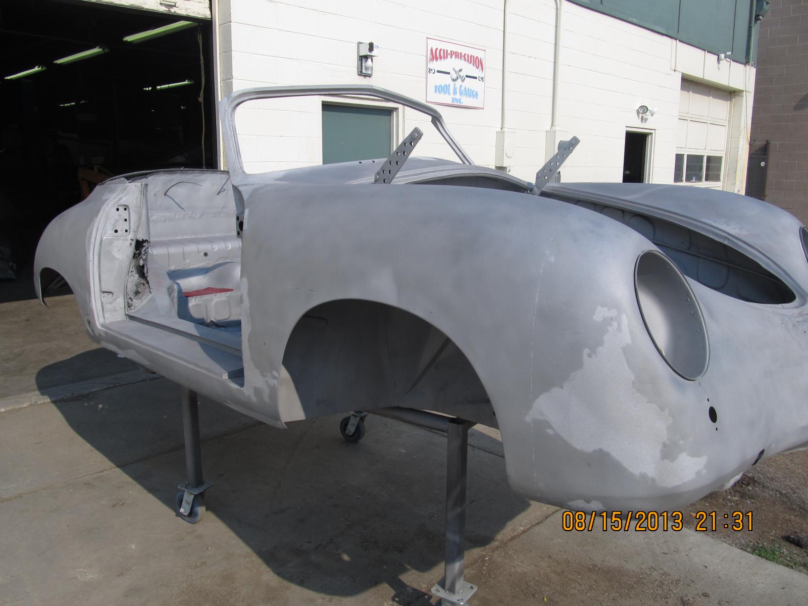

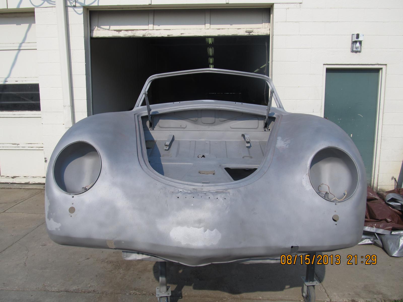

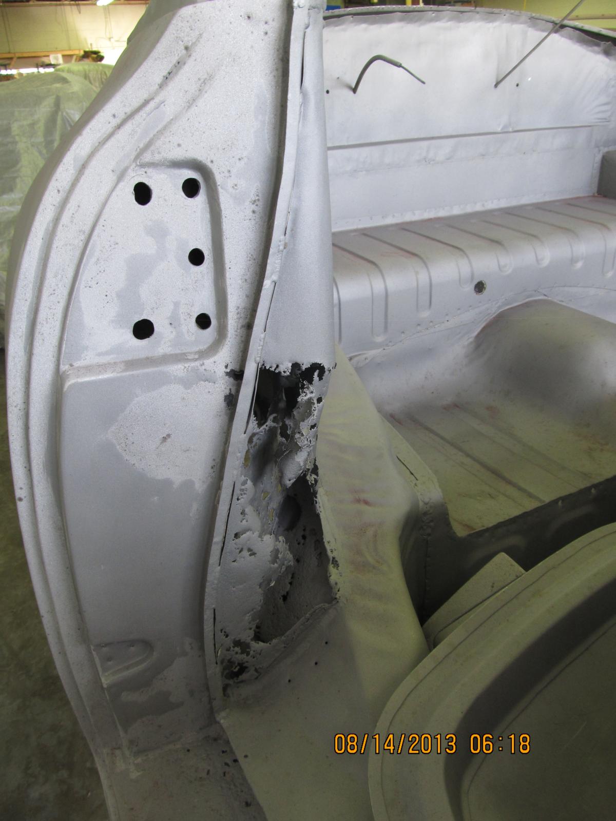

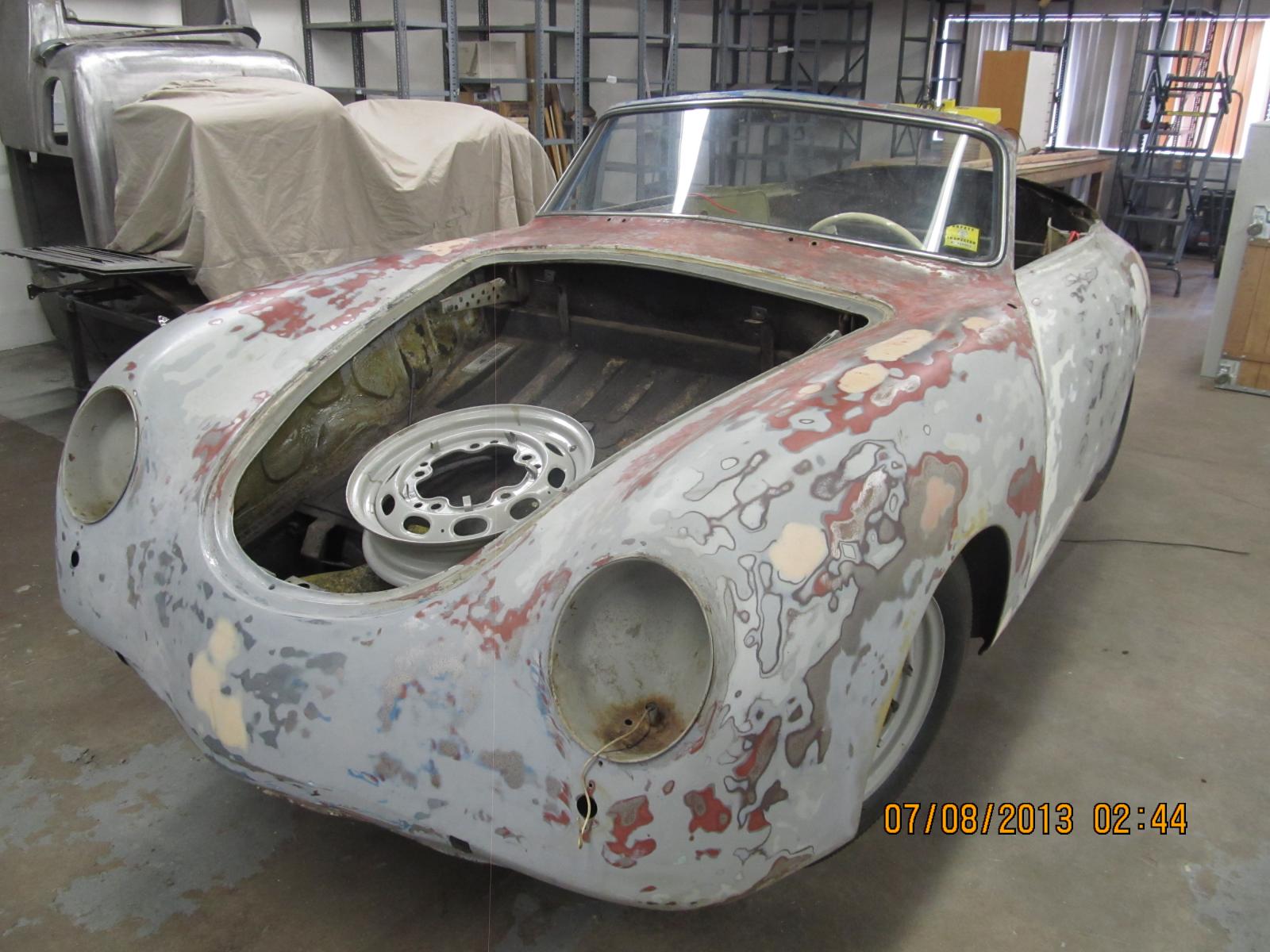

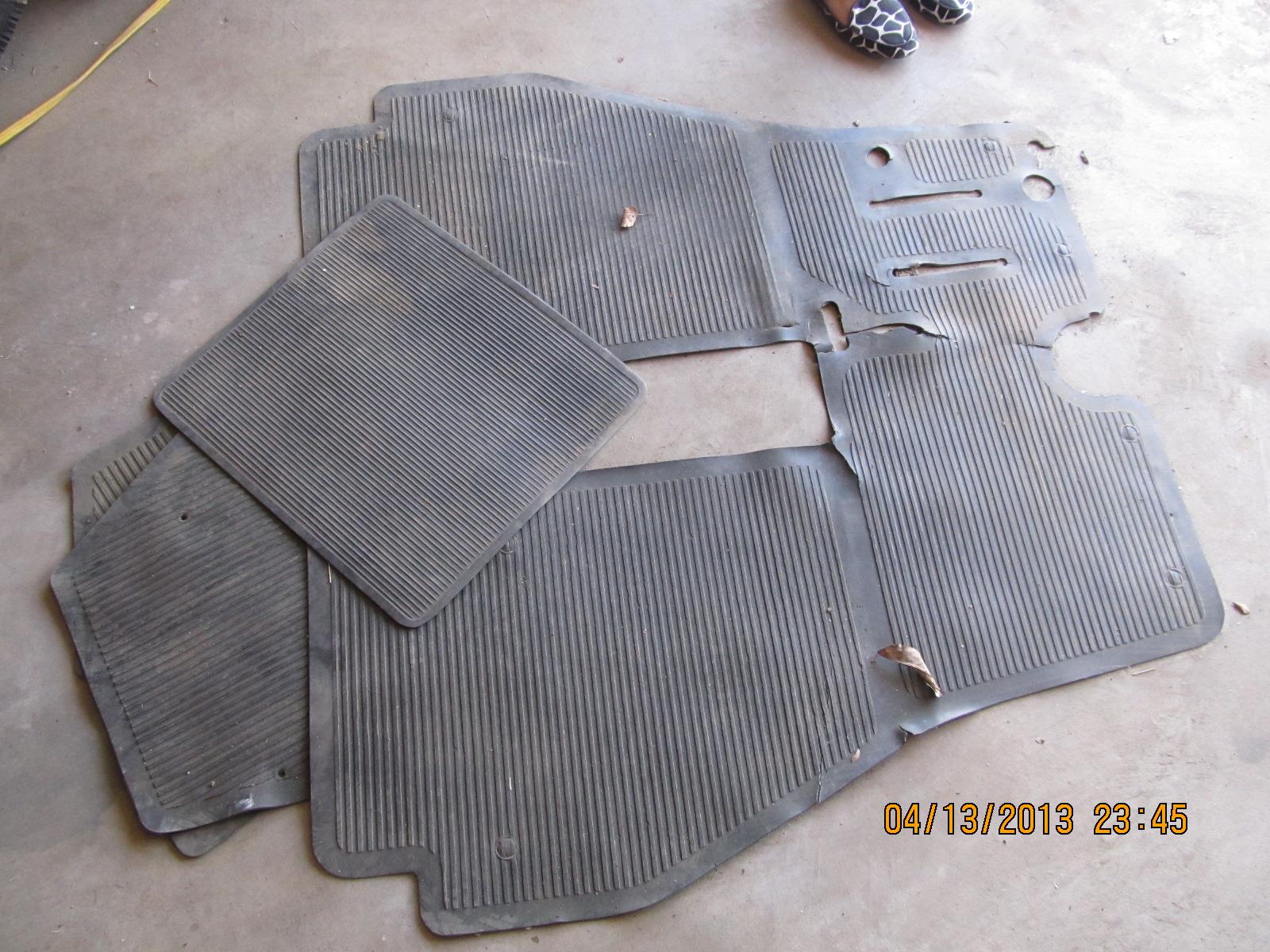

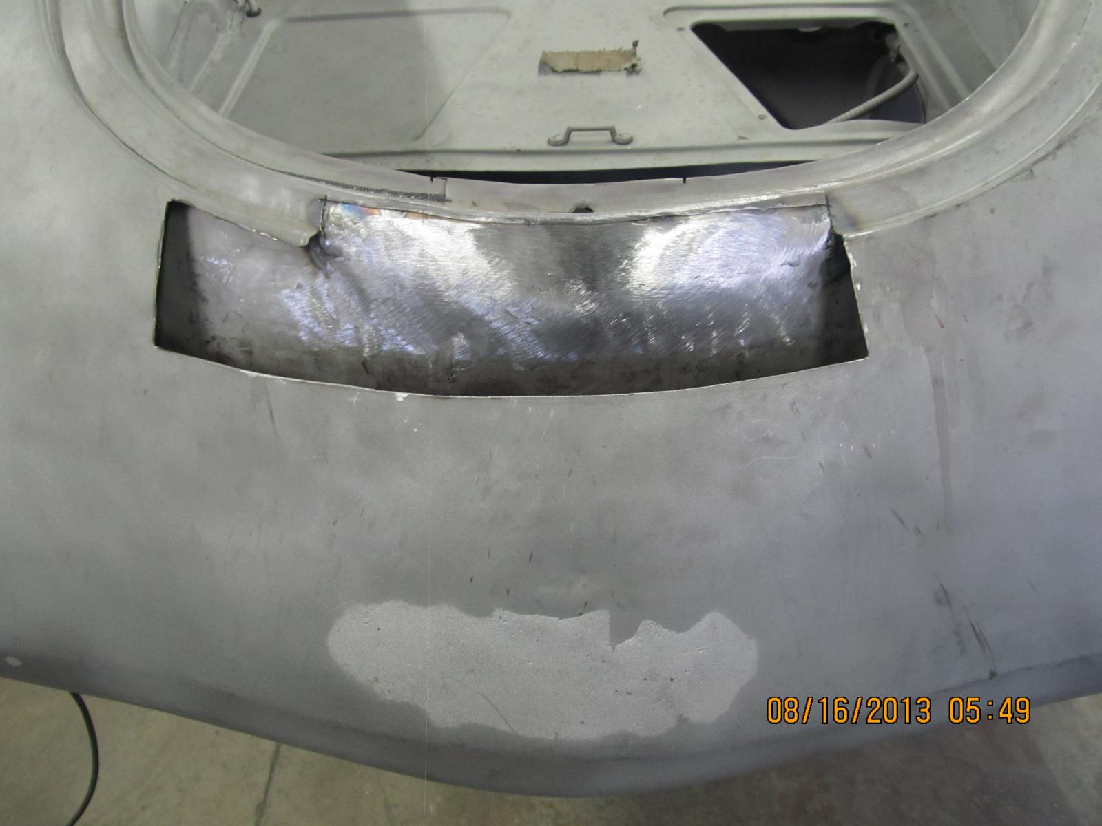

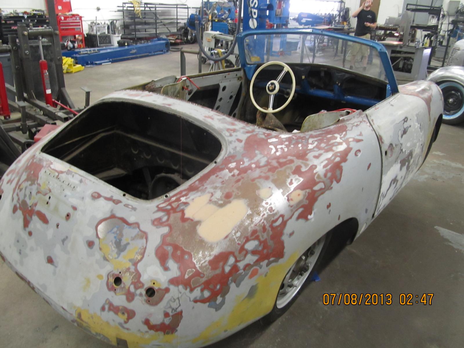

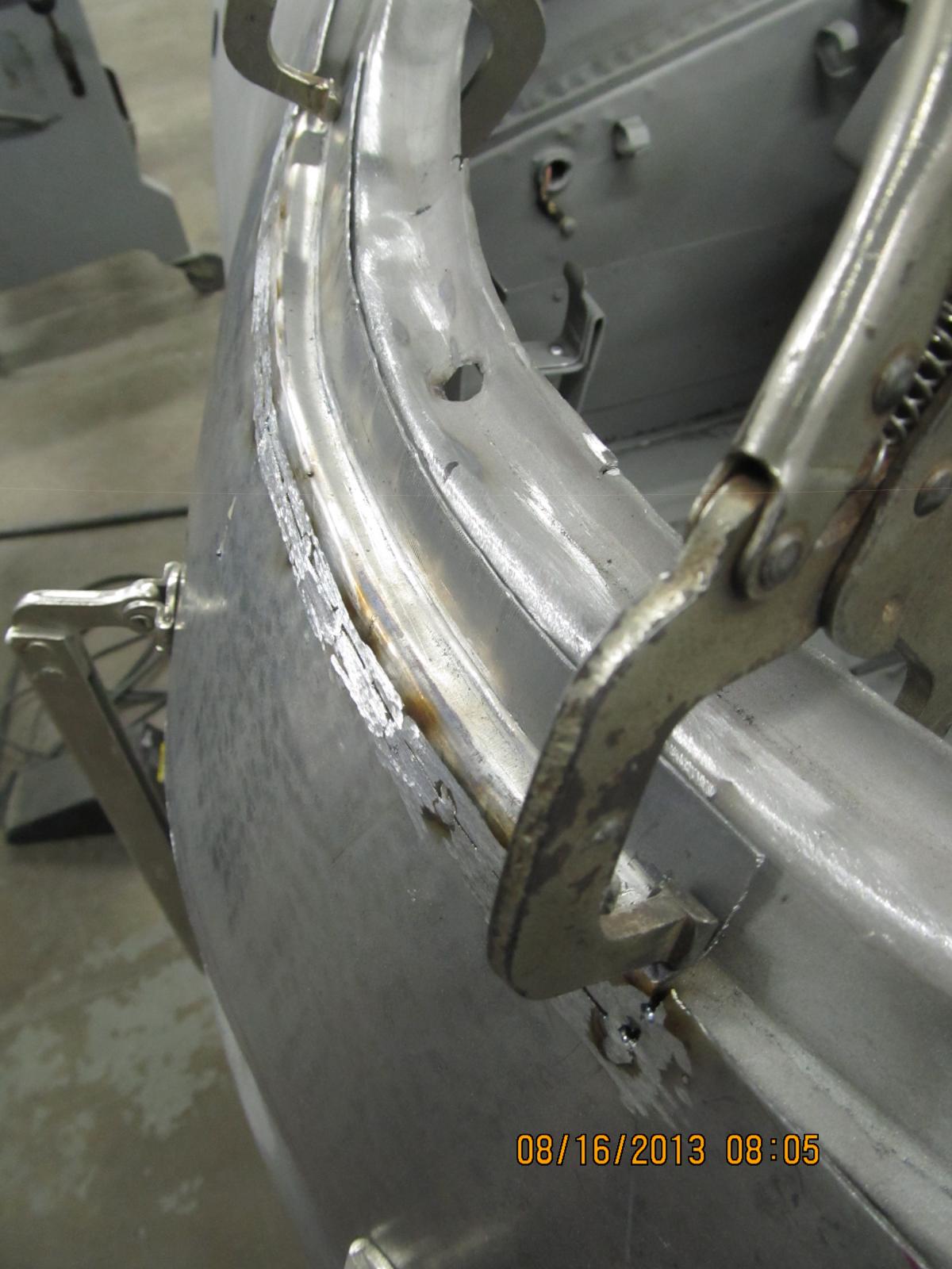

New project in the shop.Same guy has owned this car fro 50 years! Even has the original floor mats in excellent shape.
The car came to us partially stripped as shown in the first few pics.

Not many bad spots apparently. The '55 Knickscheibe I saw on a trailer last monday look liked a hopeless case with not a single panel in reasonable shape. According to the driver of the van it wasn't too bad, the speedster he had in the van arrived with them as a pile of parts on two pallets. Now it was fresh from the painter and looked very nice.
What kind of material do you use for blasting ? Steel or glass particles ?

plastic media blast

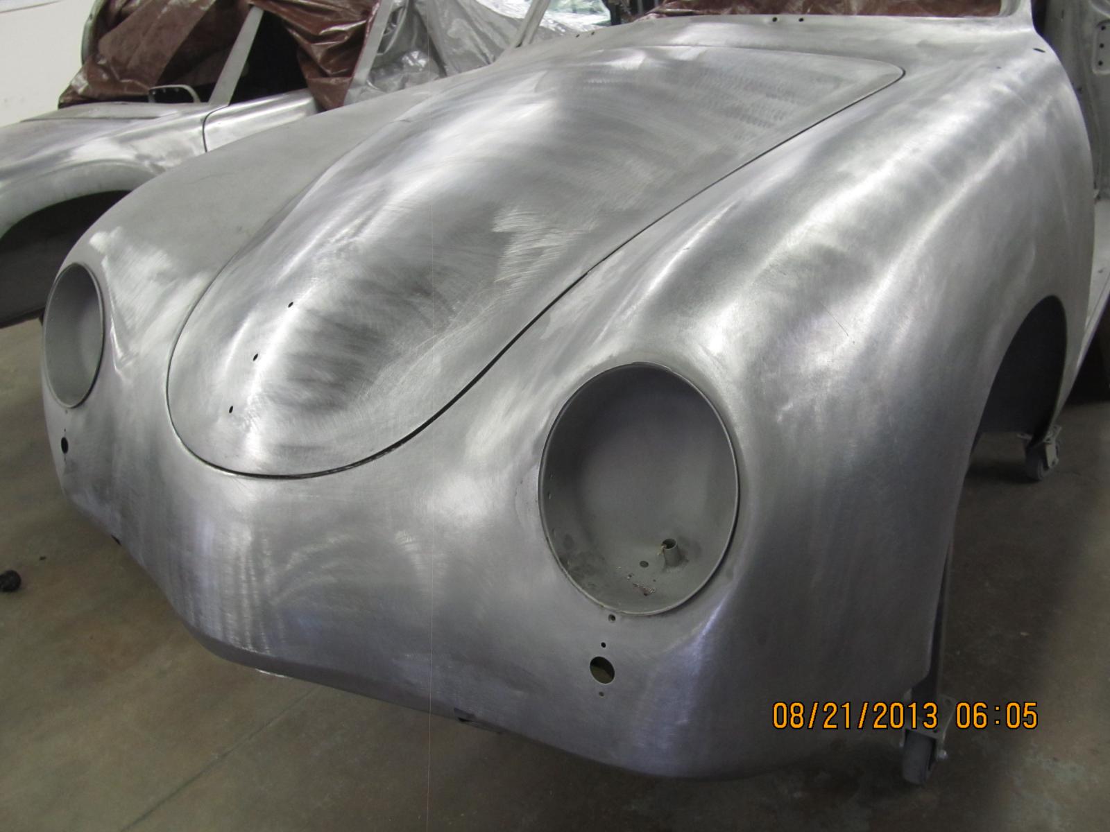

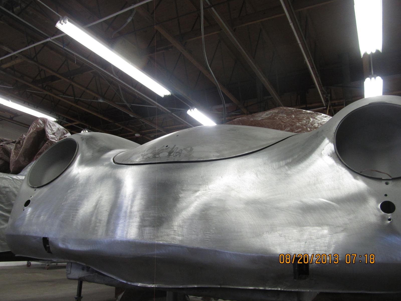

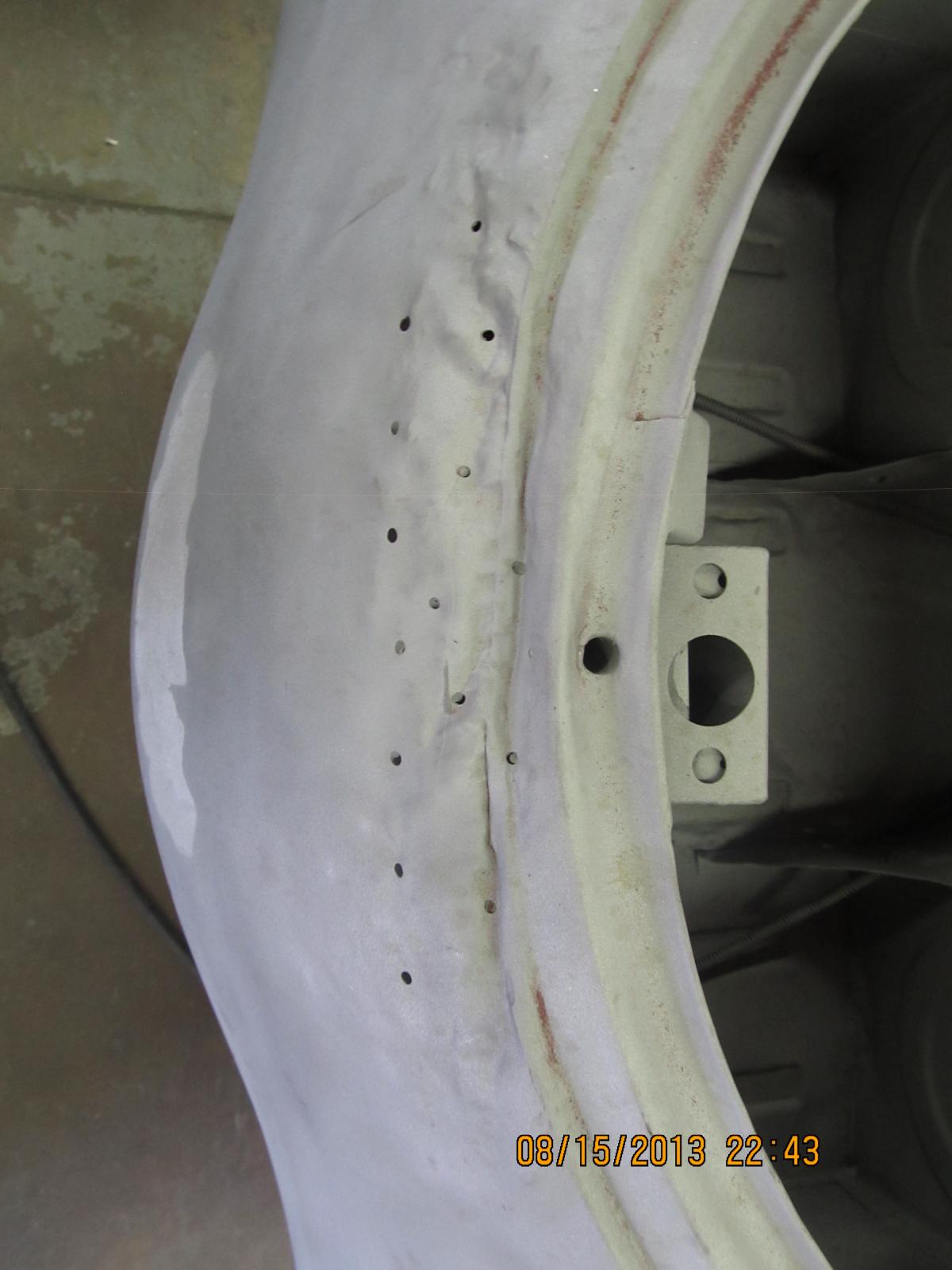

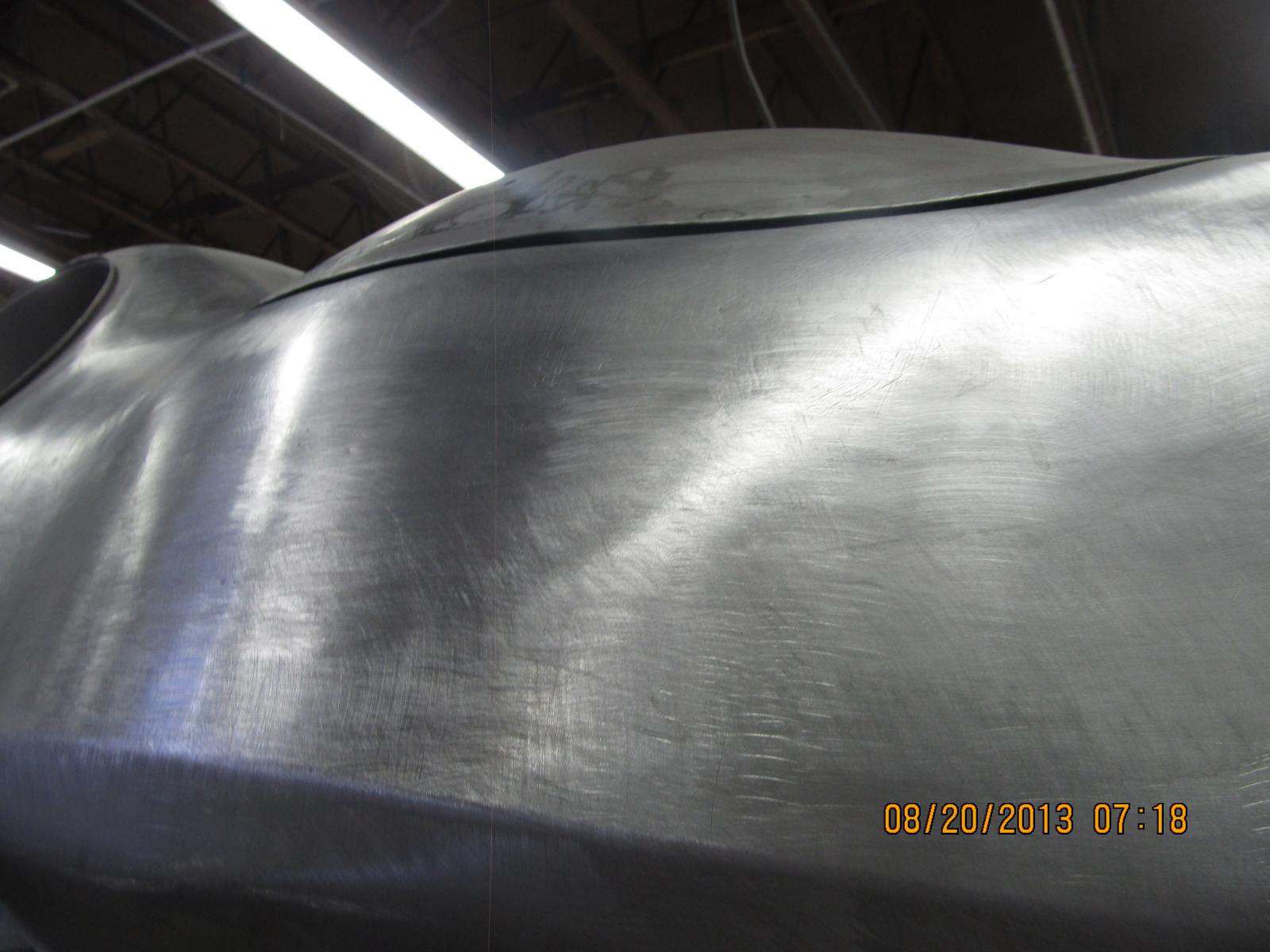

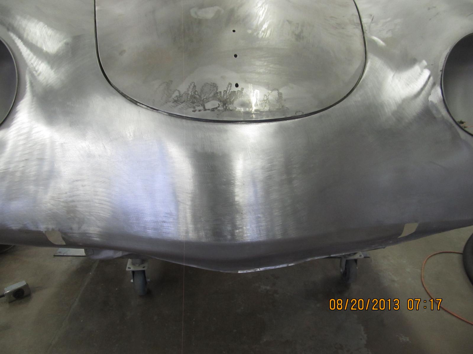

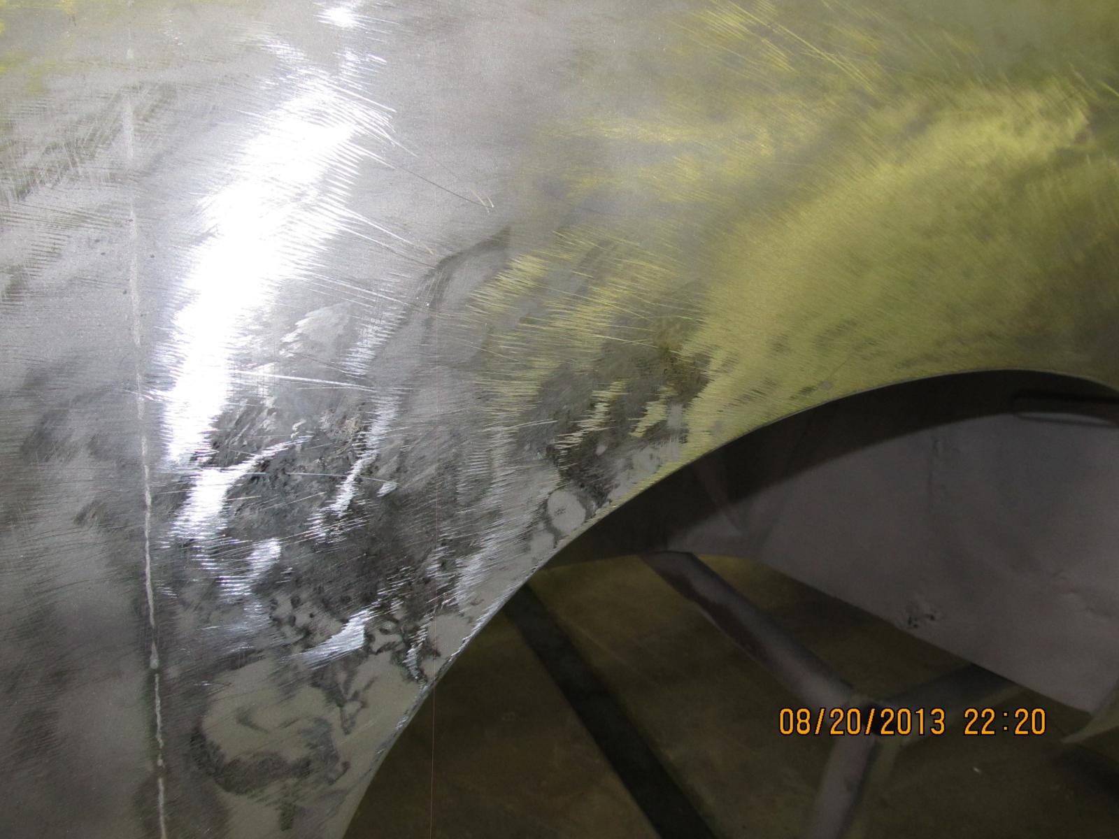

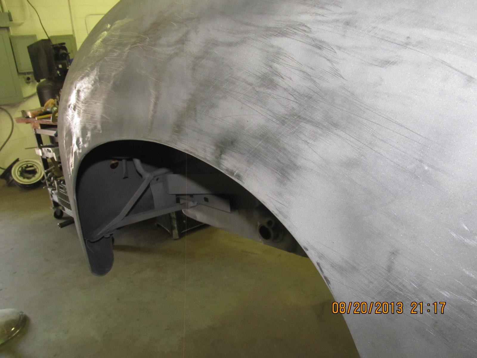

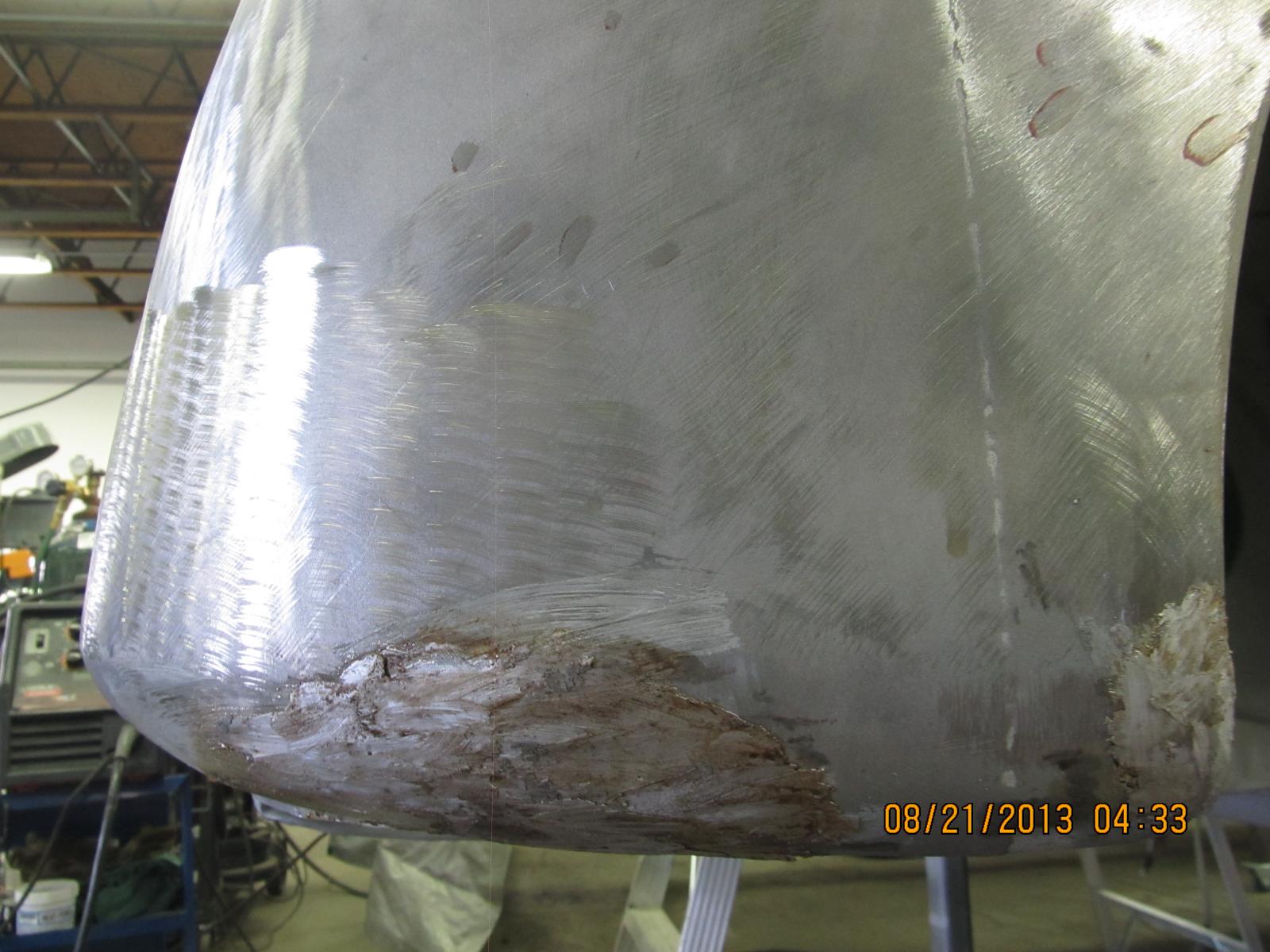

PostPosted: Tue Aug 20, 2013 9:14 pm    Post subject: 1953 Porsche 356 Resto Reply with quote
fixing /rebuilding the outer and inner nose sheet metal

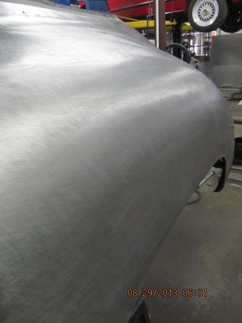

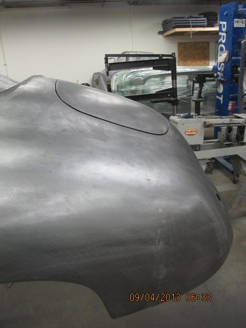

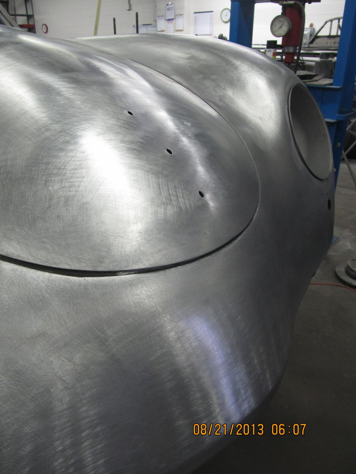

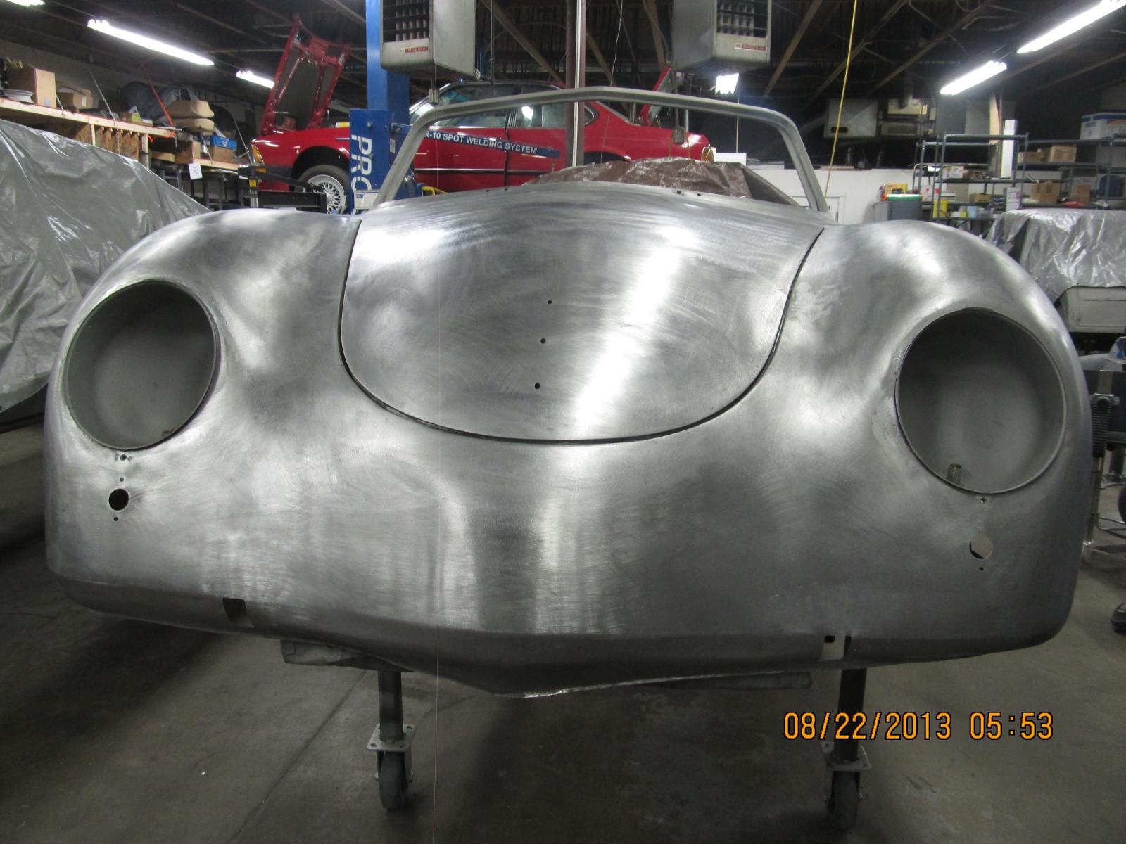

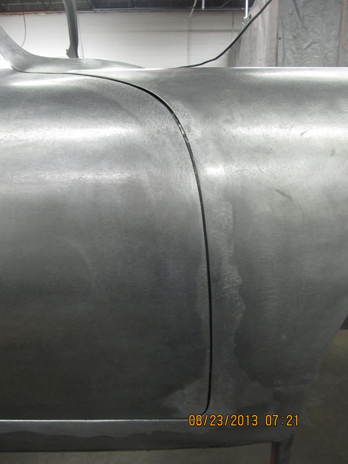

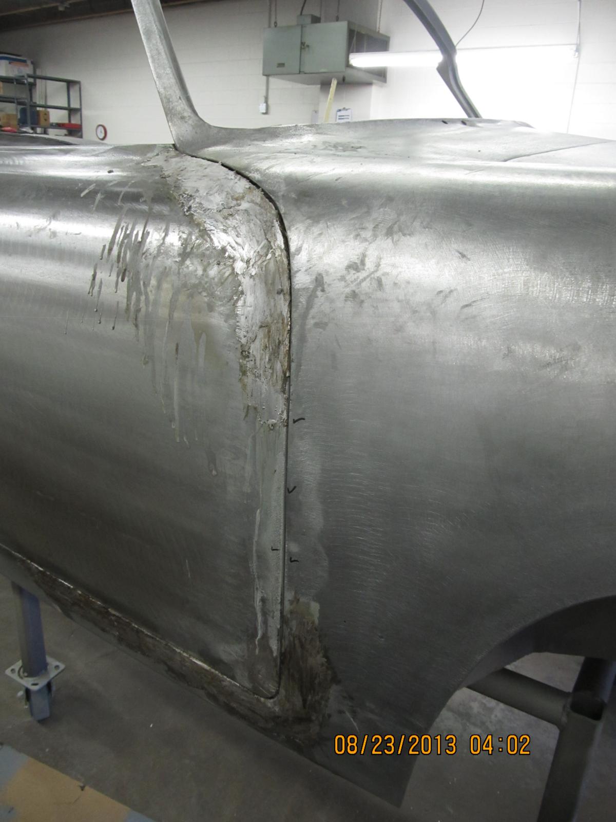

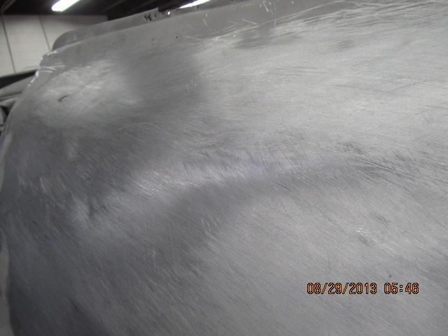

PostPosted: Wed Aug 21, 2013 10:00 pm    Post subject: Reply with quote
more progress made.....metal finishing front left fender and hood.Small amount of lead work where the fender bracket sits behind the fender sheet metal.

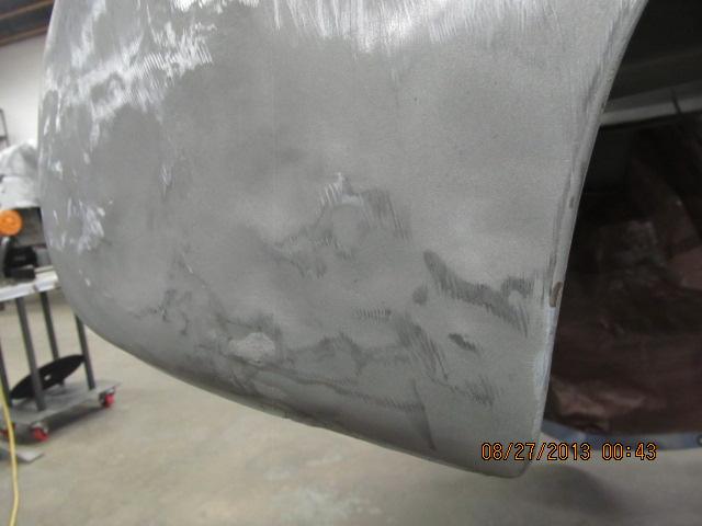

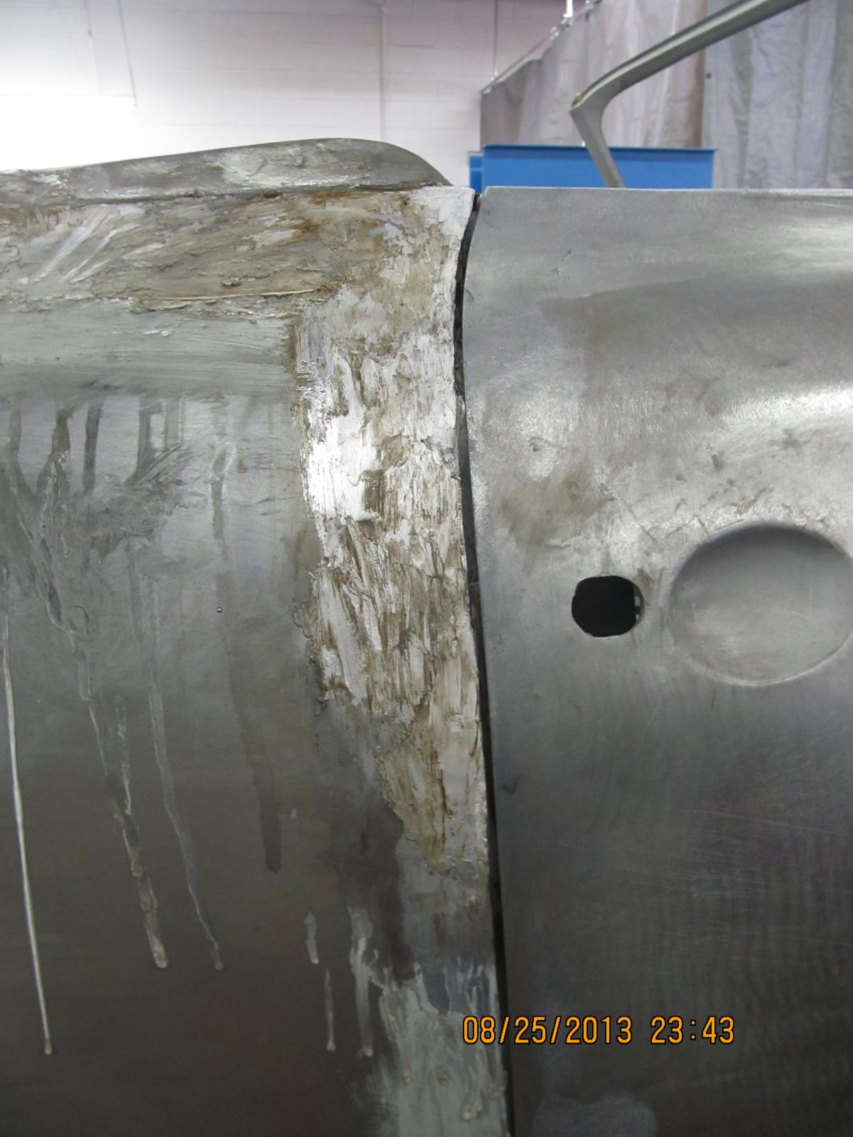

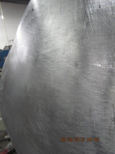

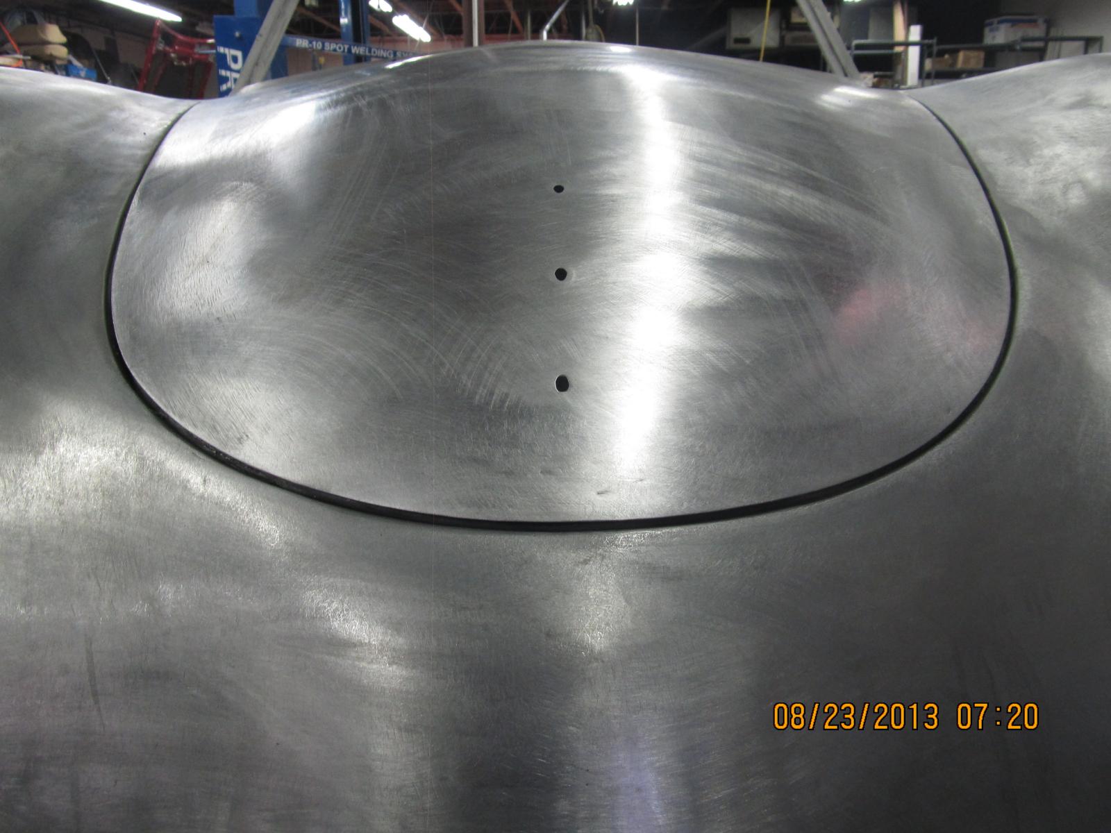

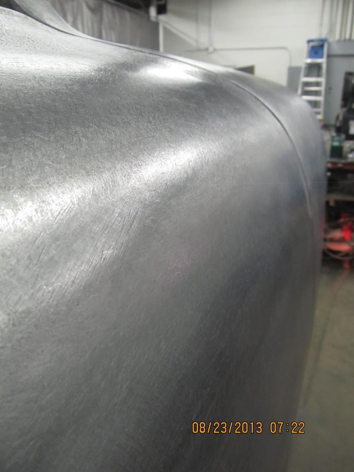

PostPosted: Fri Aug 23, 2013 11:37 pm    Post subject: Reply with quote
hood ,right hand fender and door resto including lead work to define surface and door gap finish.

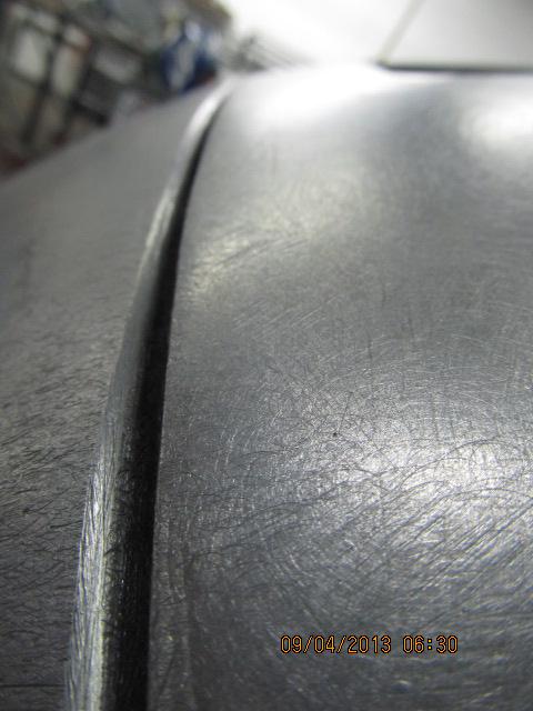

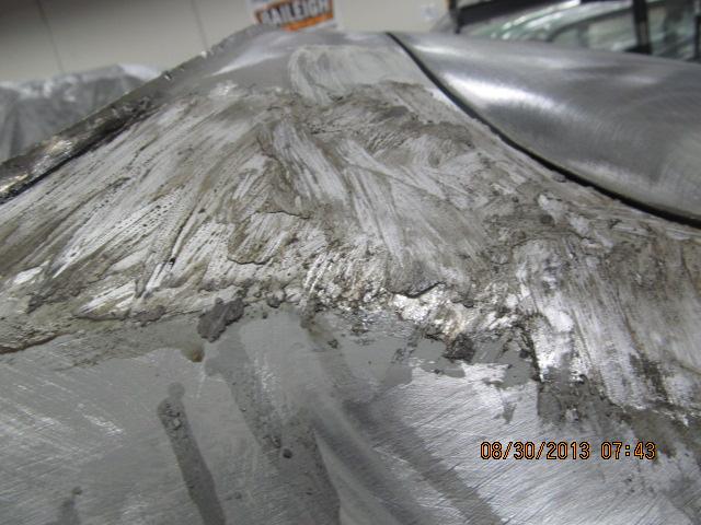

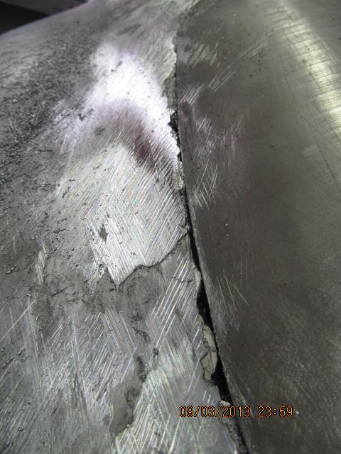

PostPosted: Tue Aug 27, 2013 8:38 pm    Post subject: Reply with quote
progress.....

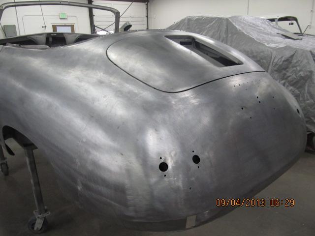

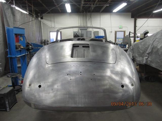

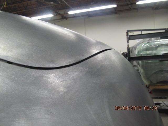

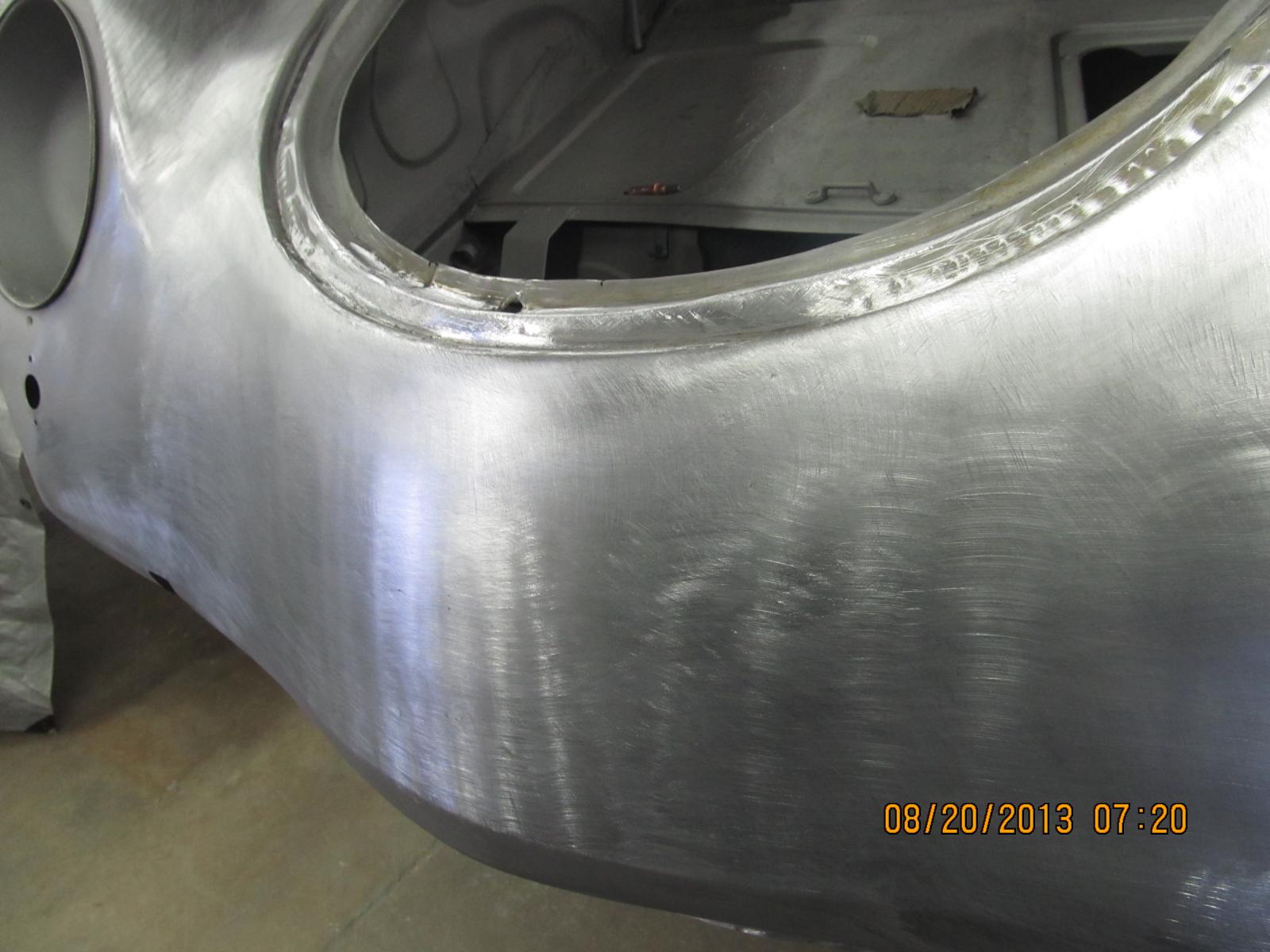

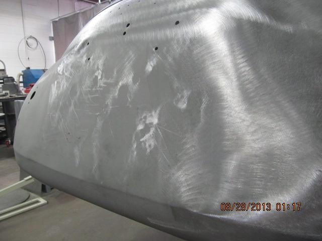

PostPosted: Wed Sep 25, 2013 9:27 pm    Post subject: Reply with quote
continuing rear,rear quarter metal finishing and deck lid lead work

Super thread. Just looked through all the photo's yet again. Its the dream of most 356 owners to have a body finished like that. Super gaps, very nice leading. It is a form of art to get that perfect.
I have a question? for its age the car was obviously well looked after by its owner and after seeing some shots of the floor I presume that most of the structural area of the chassis were in good condition apart from the area behind the bak of the passenger side door. Was that and the thin rear floor attended to first?
Just like Justin Rio's restoration techniques this restoration makes it look sort of easy to do. How far no doubt that is from the truth. I remember many years ago trying leading for the first time and seeing most of my effort on the garage floor. That front nose repair you did looks a lovely job not so easy at all.
