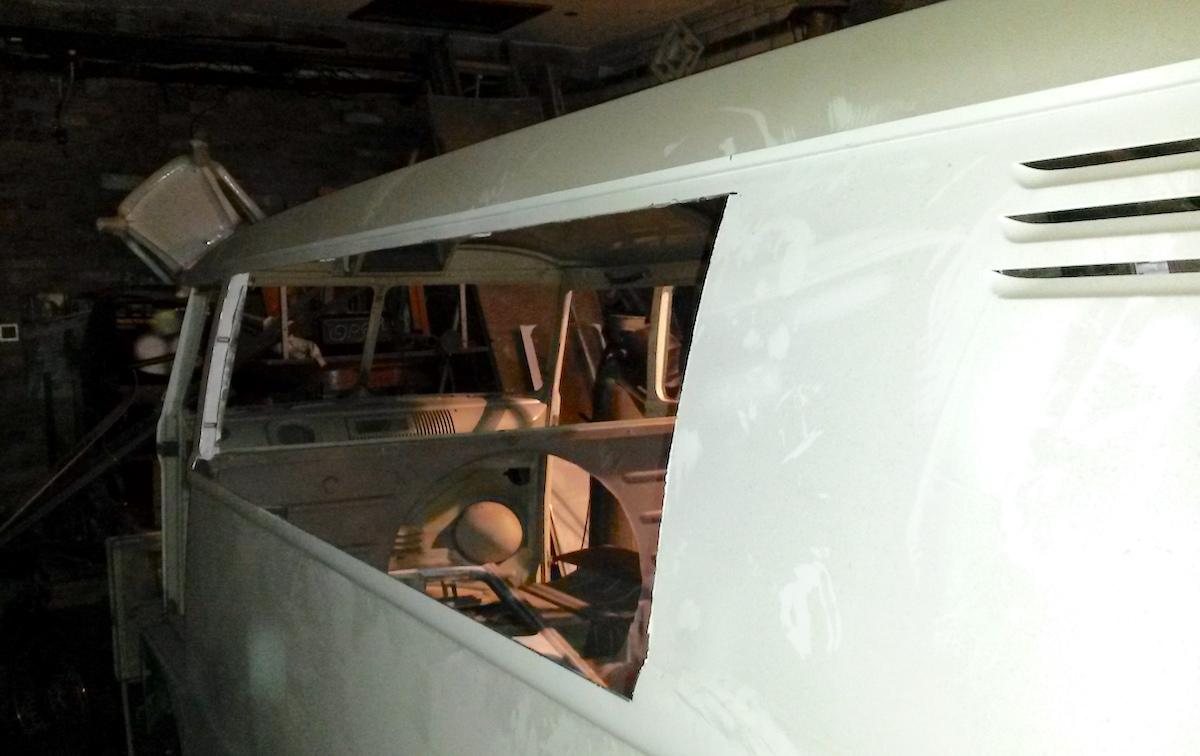

At October 3th 2015 I bought a Finnish T1 panel in north Germany and at October 10th I started the project in the Netherlands, were I live.
Without any experience of car restorations I learned a lot by reading a lot of topics and studying hundreds of pictures, also on this site. Thank you all for that! Very Happy
I also did a welding course of a day and the rest I learned myself. Laughing

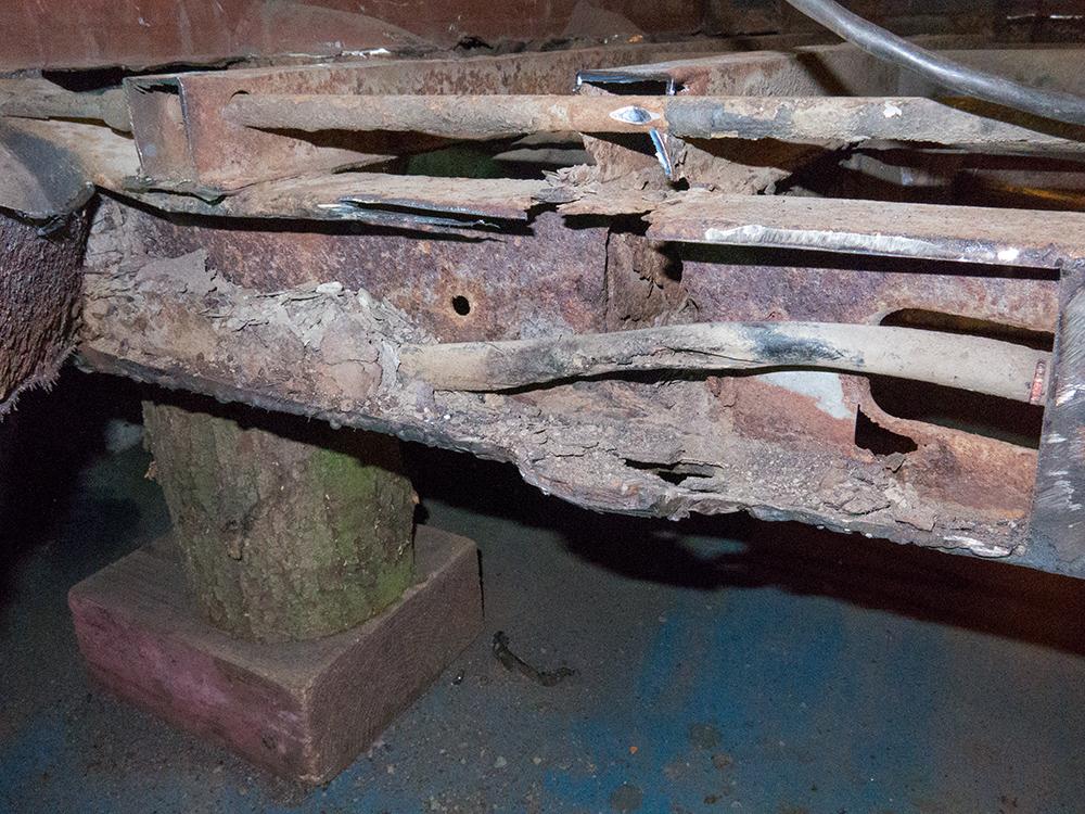

Most of the floor and chassis framework had to be renewed and also the lower 20 to 30 cm edge all around the bus.
I think the bus was used in the mud, because there was a lot of sand in the floor beams!
In Finland there where holes made by a company called Wiima, to create windows in the panel, but of course the glass doesn't fit well in the curved sheet metal. So during the restoration proces I bought original window parts from a 13 window bus, enough to create a 11 window bus.
I also found a nearly complete Dormobile roof in Italy, so I will fit this on the bus also. I only had to make the framework around the hole in the roof myself.
