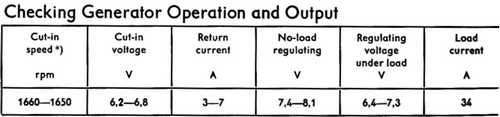

I too would like to see the schematic, The IC part number etc... I think there may be a dedicated dynamo regulator (all in one chip) for this but don't know what it is?
Yes, a "Schottky Diode" not the little silicone diodes for the (generator D+ to Battery Diode) which needs to be capable of at least 30 amps!
Not sure what the current needed to run a 6-volt generator field winding is, Probably about 1 amp.

PostPosted: Fri Feb 16, 2018 2:56 pm    Post subject: Re: 6 volt solid state voltage regulator Reply with quote
Not sure, but looking at some values, I think it might be a little bit more than 1 amp.

PostPosted: Fri Feb 16, 2018 4:15 pm    Post subject: Re: 6 volt solid state voltage regulator Reply with quote
I would think it would be less than an alternator armature, My 12 volt VW Motorola alternator measures about 4 or 5 ohms across the rings and it is powered off of the little didoes.
Doing some research here The TLE8880 can be purchased from TransistorMosfets.com for $3 and it is a modern automobile alternator excitation device, there may be a way to use it for a generator but It normally is a 12-volt device and it requires a LIN interface to do anything other than a default 14.3 volt output. It is capable of 12 amps excitation current.
