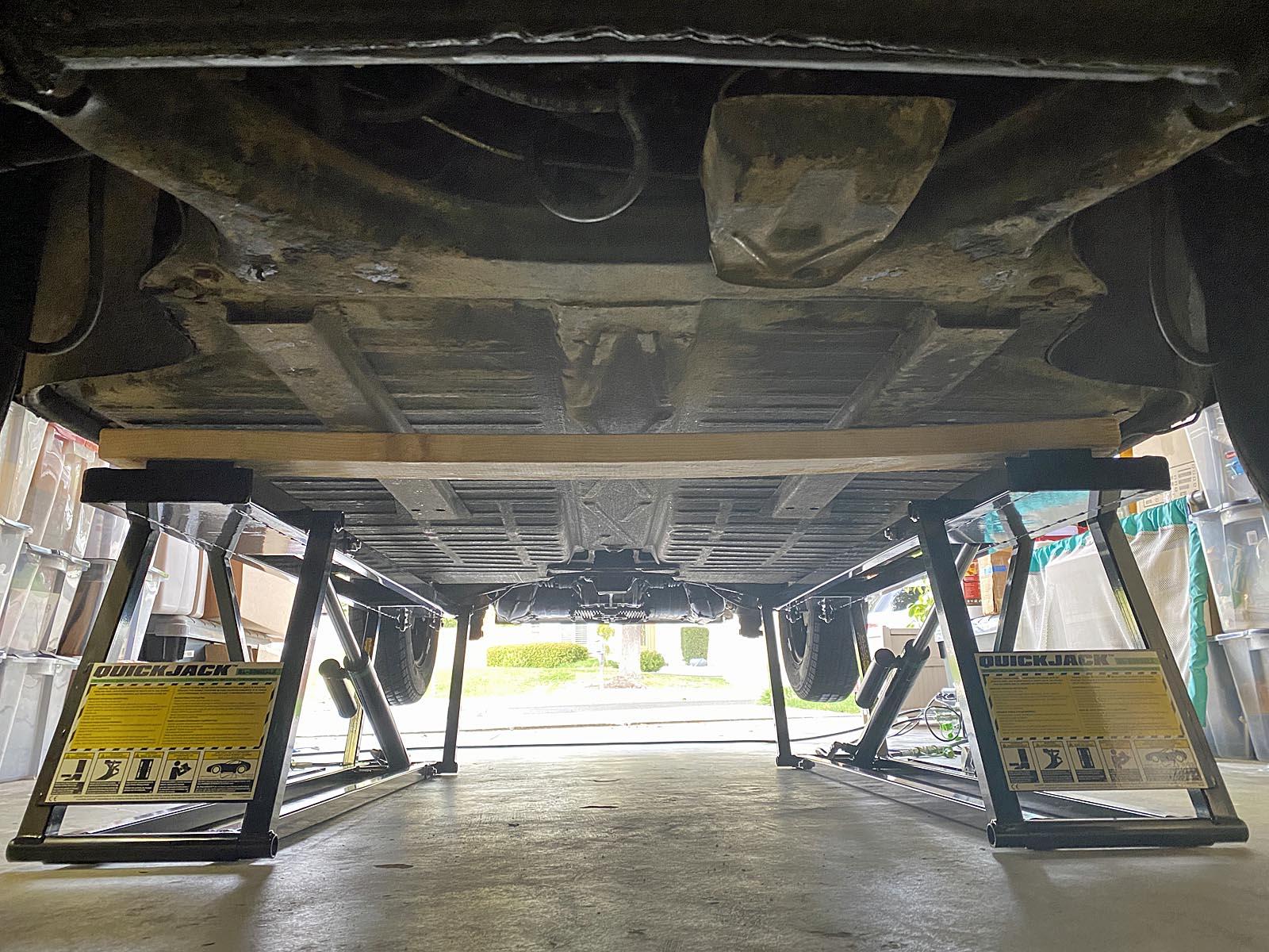

I am posting my experience here since it is for a Type 3, but most of the current discussions are in a Type 1 thread:
https://www.thesamba.com/vw/forum/viewtopic.php?t=697791
So I sprung for the 5K lb unit, and have just started using it. This is overkill for a late Type 3 fastback, but large enough for my small Audi SUV as well. I hesitated so I paid $1200 through Costco; they had it for about $1100 a few months ago. I figured the Costco reputation for service was a bonus, plus this was about $200 cheaper than elsewhere.
It arrived missing two fittings in the packaging, but within 48 hours the company had mailed me the missing fittings and had followed up with email, so they get points for responsiveness.
I took a while to figure out the safest and most stable way to lift, and here is what I figured out.
First, only use this in a level surface. You will have best results if the car is out of gear with the e-brake off, and wheels blocked, tightly at the rear, but loosely at the front with a few inches of gap. The car needs to be able to roll forward a couple of inches.
This is counterintuitive, but it's needed to prevent the rear blocks from slipping off the torsion tube. This is because the car must travel forward as it rises, due to the parallelogram rising action. If the car cannot roll (which it won't want to with the tires on the ground and brake on), it will want to slide the blocks rearward, and probably out from under the torsion tube. I did it this with the brake on the first time and I didn't like the way the blocks moved/tilted on the torsion tube mount, so I tried it again w/o brakes and out of gear. Presto!
The main weight is of course at the jacking point, since that is about the balance point front to rear. I set mine with the tall block plus a cheap Amazon pinch weld block at the rear, near the outer end of the torsion tube.
For the front, I didn't use the pinch block because even then it would have probably crushed the evap line located there. I used a 4 foot 2x4 on top of the medium block laterally, so the load was on the pan but mainly at the two reinforcement rails.
This gives me about 20 inches or so of clearance (I didn't measure it but will next time). It's enough that for most work I can fit a low profile creeper underneath, saving my neck and back.
I will make a few mods. Up front I'd like to use solid wood blocks sized to the "block trays" and connect a 2x6 (instead of the 2x4) to both blocks with lag bolts, which will also ensure they are spaced apart correctly. For the rear the branded pinch weld blocks (pricey at $80 a set) may fit better.
When not in use I plan to leave the trays shoved to the car centerline and drive above them, so they don't take up any more room in the garage. I can then slide them apart, fit my front wood piece, than align each rear. Then lay my chock blocks, let out the brake, take it out of gear, then plug in the quick-connect hoses, and raise away! You don't drive over these things, and I will disconnect the hoses (they come with drip-free quick disconnects) so I don't drive over them, either.
Time will tell how well they work, but they seem very stable, easy to set up, and give me the quick lift that will save my aging/aching back.
It's possible the next smaller size might work better for ACVWs since they are shorter, and pose less of an issue with coming close to hitting the tires as they initially lift. My scheme with blocks and letting it roll a bit on its own seems to make the 5K size work well enough, though.

There is another advantage here, and it's peculiar but meaningful for me. In the past, I used a floor jack and jack stands in the driveway. The driveway tilts a little, but no so much anything would topple. It's worked for me for years. And for a quick front end check (one floor jack in the middle of the beam), or a single tire check, I'll probably still do that.
But our HOA is not happy with car work being done in a driveway. I did stealthily manage to drop the engine in the driveway in one day a few years ago, lower the car and put a cover on it, so it didn't look like I had worked on it at all. But there are prying eyes in the neighborhood and I don't need the fines and aggravation.
This way I can lift it while in the garage, something I don't have enough side clearance to do with the conventional floor jack approach. On the VW, I rarely have to get in from the side, and there is very little to be worked on in the car's center pan area, so it's mainly access from the front or rear, and I have easy access from either end this way.
There's not enough height (with a roll up door) in a conventional suburban garage to use a 2-post lift, either.
I'll post as I use it, pros and cons, over the next few months. But I hadn't seen much real-word experience posted here, and no photos, so hopefully this may help others decide.
