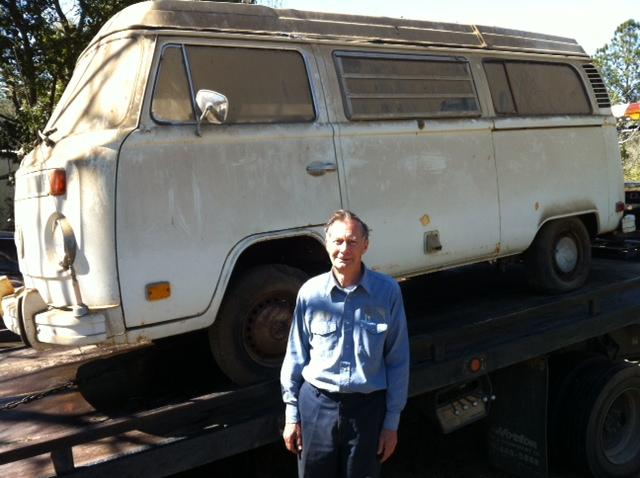

I bought this bus from an older gentleman a few years ago. His parents were the original owners and traveled the US with it. 100k, all OG and stock.
Been in a shed since 1993. Had been undercoated from new. Finally getting serious with it.
As found...
Gentleman I purchased the bus from.
(Actually 2 busses, a clapped out fastback, 7 Mercedes 240Ds and one Mercedes 300SD!))

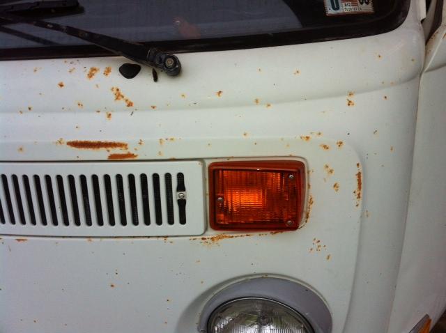

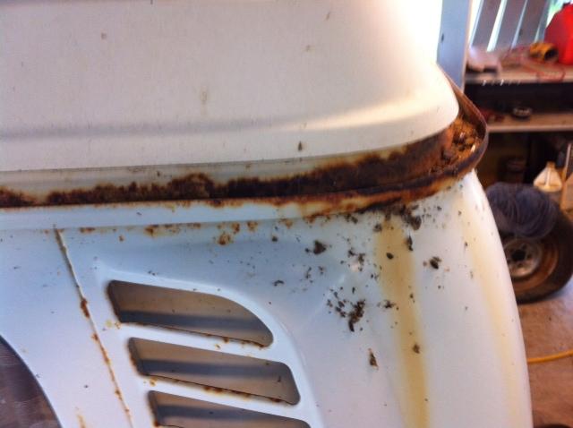

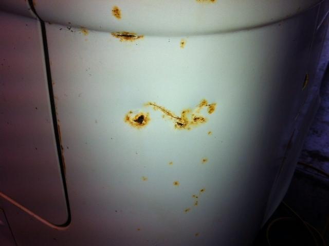

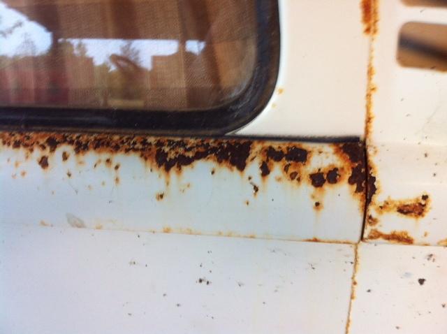

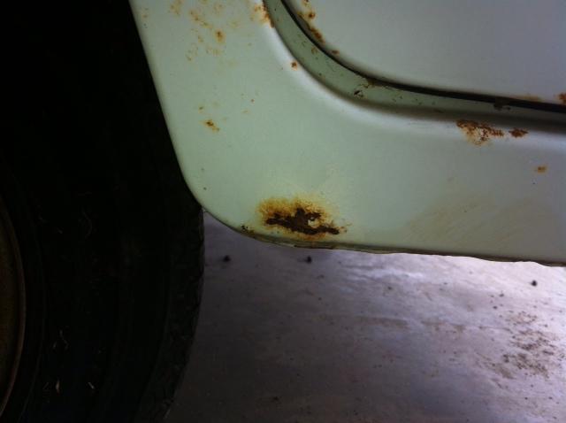

After a qick scrub to get the dust off of it. Some thin OG paint, some dings and some scaly surface rust. A couple of places needing a small amount of metal work.

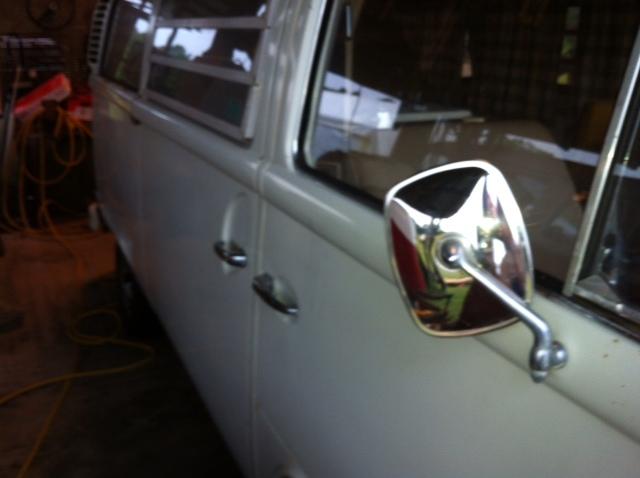

Door windows, jalousie windows out.
Interior out and I've cleaned OG floor and scrubbed interior down.
I'll get more pics tomorrow.
Interior scrubbed. Felt like Cinderella.
