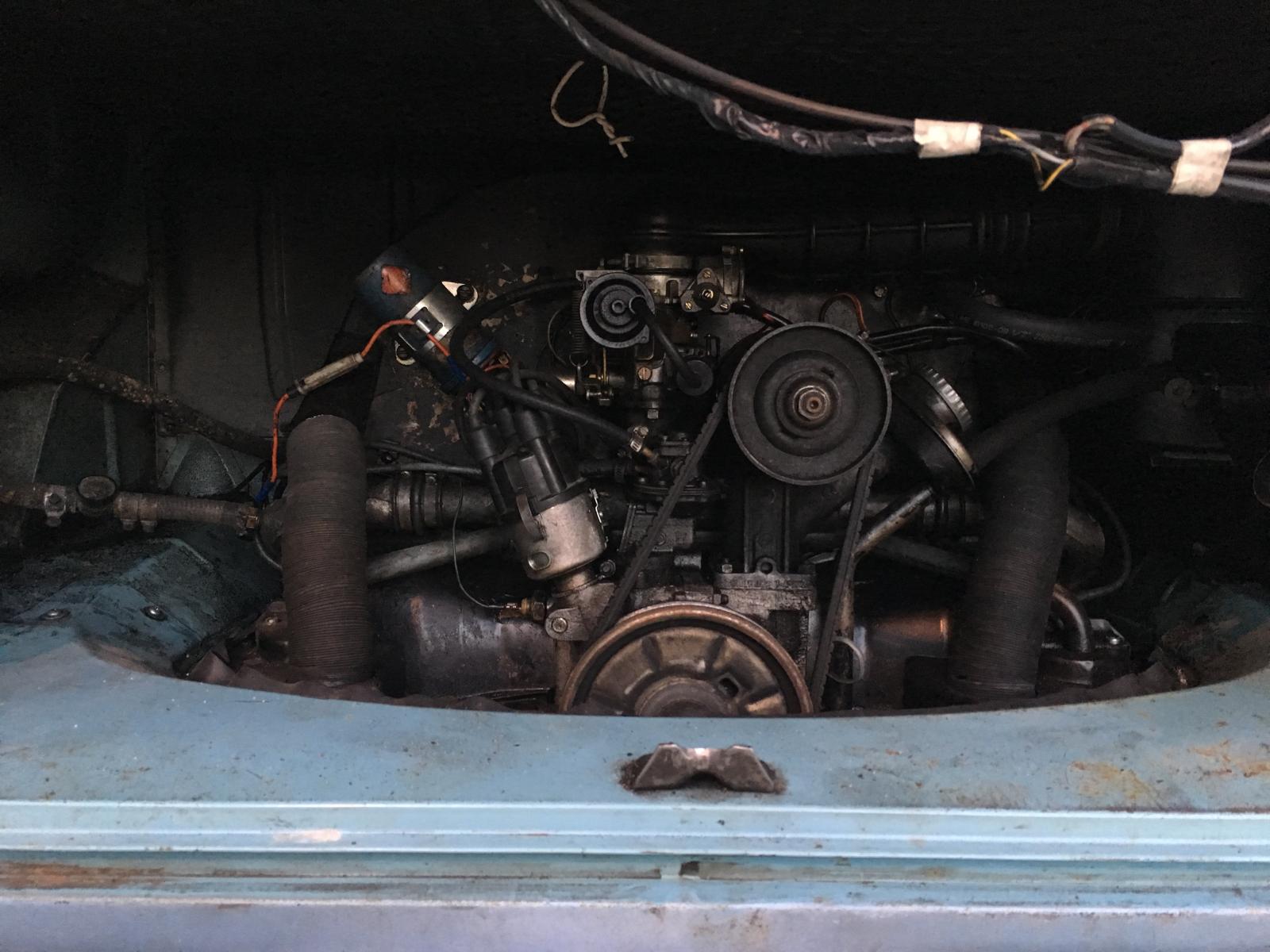

The 1600 engine, which is in fantastic shape as far as we can tell (no oil leaks anywhere, runs nicely)
Broken down in the middle of the road Embarassed

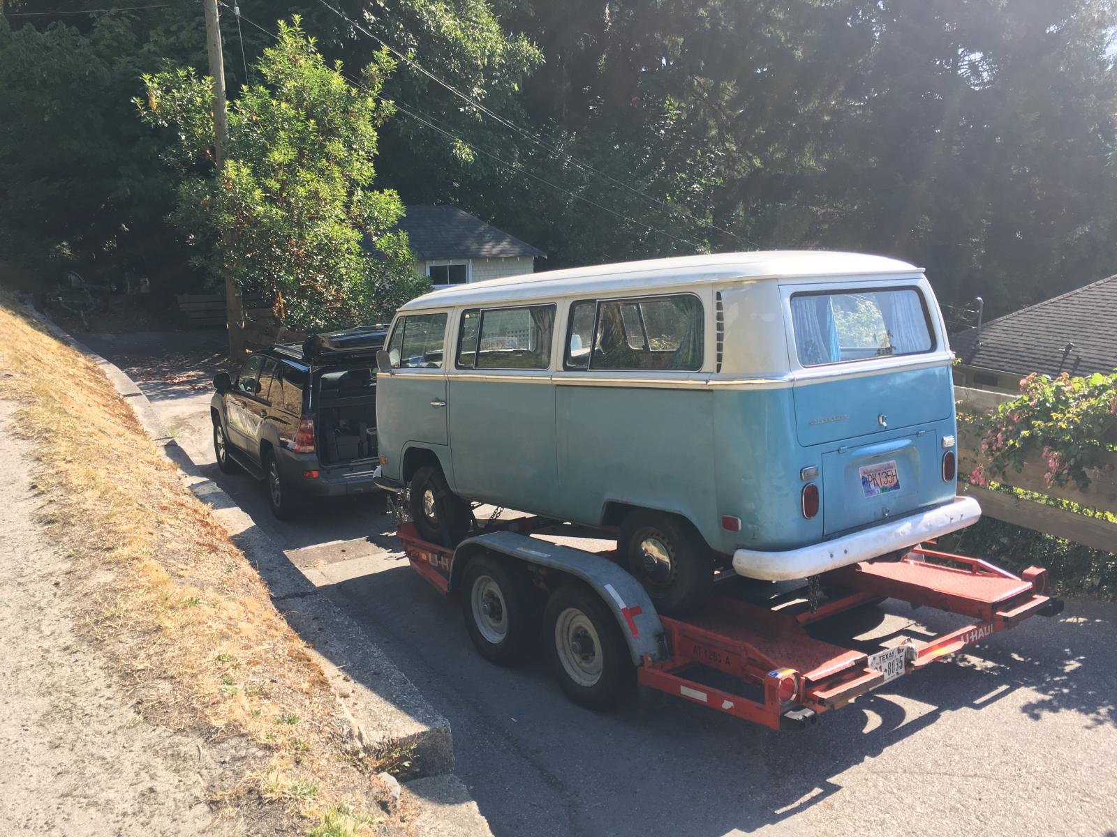

Yesterday we returned to pick up the bus...
On the ferry
Unloading...
Made it!

Oddly enough, the power to the dash has mysteriously returned, although we believe the ignition is bunk and needs replacement, as it doesn't spring back the key upon being pushed to the "start position". I was also poking around my engine, and I saw that there was about half a quart of oil in my airfilter, I've heard this is common but how can I fix it? Also, I do already happen to have a muir book and bentley from my last bus. Thanks again everyone!!
I believe you have a stock "oil bath air cleaner" in your bus. It's supposed to have oil in it
Ah okay, thanks for clarifying. I thought it was a bit weird.

PostPosted: Sun Aug 20, 2017 11:08 am    Post subject: Re: The '71 Deluxe Reply with quote
Congratulations
IIRC the Air cleaner service is in the owners manual and in the Bentley.
Owners manuals
https://www.thesamba.com/vw/archives/info/
Air Cleaner ID T2
Good luck

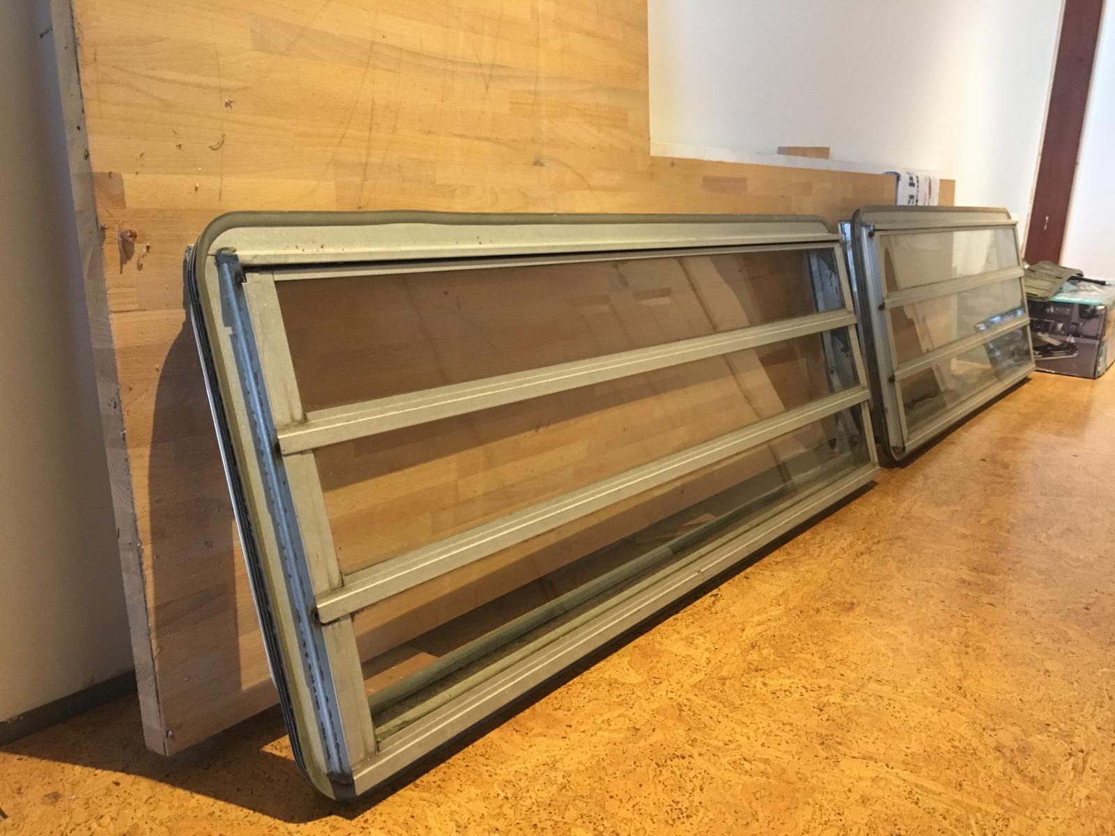

Crossed the border the other day to pick up some cheap jalousies in nice shape! I know their disadvantages and how many people don’t like them, but I just can’t help but love their classic look, especially on an early bay Very Happy All they need is some new rivets and a good shine.
Also painted the grille & emblem Rustoleum Heritage White, unfortunately it’s just a touch more beige but it’s not too noticeable in real life. I’ll probably paint the grille niagra blue again in the future if I can find a good match, however it will do just fine for now.
Got the bus running again on the weekend too, runs like a dream everything works perfectly (except the lowbeams Think ) Just need to figure out how to mount the flashers under the dash and install my new Gates fuel lines, and I should be ready to go campin’ Very Happy Very Happy Very Happy
