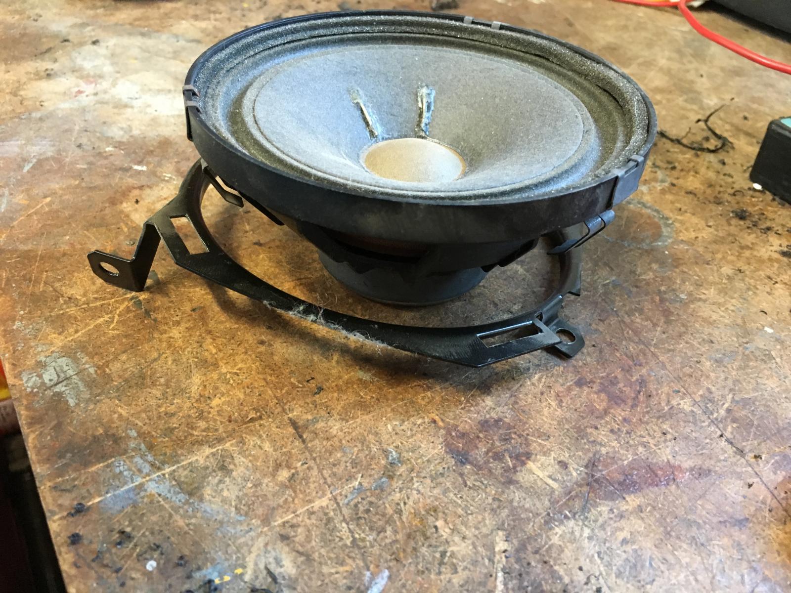

After installing a Sony XAV-AX100 head unit (see that thread here) , Kenwood KAC-M3004 amplifier, and Kenwood KFC-P-710PS front door speakers in my 01 EV I replaced the rear speakers as welll with Fosgate 4" R14X2. The rear speakers are the same in all weekenders, I did this in our older 1993 as well as our current 2001.
Here's the details:
*Carefully remove the speaker grill by pulling/prying. I used a hook tool to start
*Remove screws and unplug speaker:
*remove metal bracket (there are 3 metal clips)
*Cut the old speaker basket so all that is left is the outter ring and the wire harness connector (I used side cutters and snipped it off)
*Bend the screw tabs on the Fosgate R14X2 as close to the inner side of the screw slot as possible.
*Drill and fasten screws. I only used two per speaker, also you might want to start each hole for a marker and then remove the speaker to finish drilling as you will be going through the metal frame which makes shavings which are attracted to the speaker. Put the 3 metal retaining clips back on and assembled the frame and speaker. I also trimmed the ends of the speaker flanges by the screw holes so the wouldn't stick out.
*Connect the speaker wire to the speaker, trim it to length and then solder/attached the other end to the factory terminals. (sorry, no picture for this one)
*Plug the speaker back in and fasten it back into the van
I put a little bit of grease on the tabs of the speaker grill so it will be easier to remove in the future if needed.
