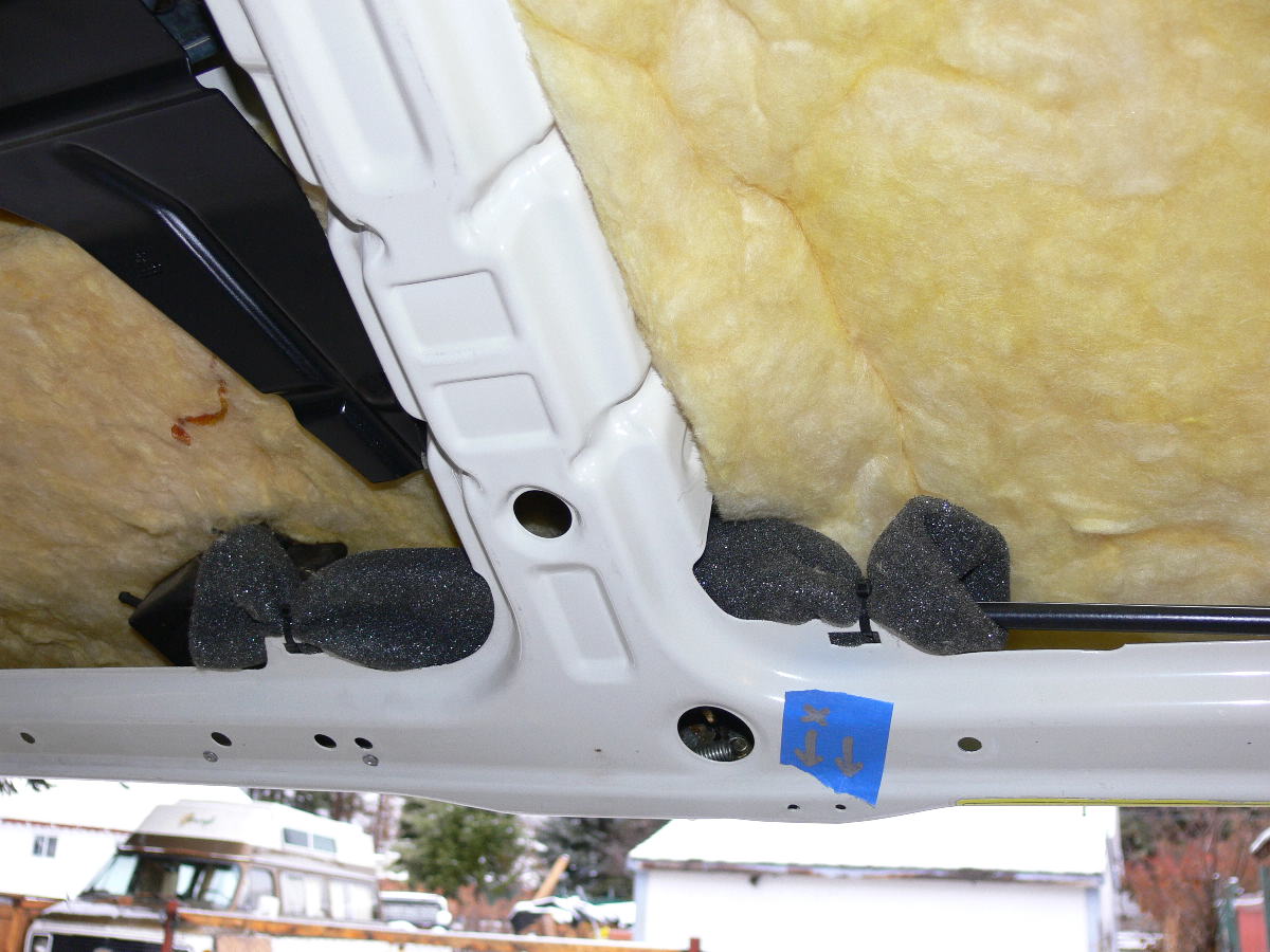

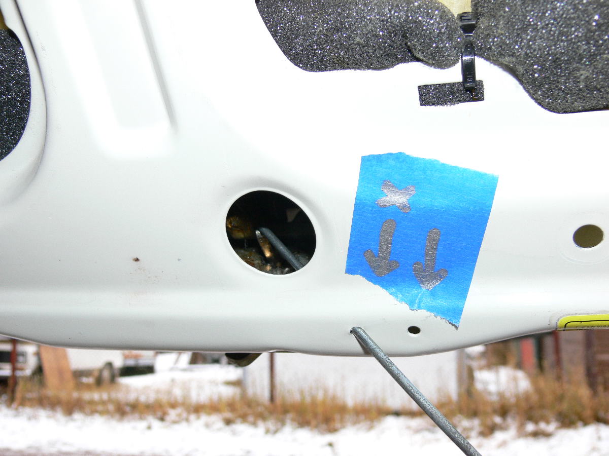

I got out there today and pulled back pad and rug, exposing the lock area. Discovered two small holes to the right of lock mech. Fished around with a thin rod but couldn't get any traction.
So...I went and pulled the rear panel on my Syncro (this is whats nice about having more than one van of same vintage!)
With panel off I could see where lock lever was and sprung!
Here are a couple photos. As you can see from this shot, just prying back the panel from the top and reaching in won't get it done. Too much stuff in theway.
In this shot you can see holes and where the rod needs to go
This is the Multivan with the stuck hatch. I kinda stretched the hole a little fishing for contact. You have to angle upwards (towards window) to engage latch.
Hope this helps someone else in the future.
Now I can get the panel off without destroying it, and figure out where the rod came loose.

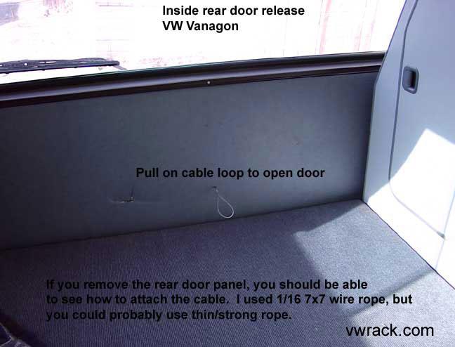

This Gary Lee mod is on my to-do list. Not sure if it works with power locks.

Thought I'd add an update to this. I've had this problem off and on for years. It always fails on a trip 300 miles from nowhere with all my gear in the back. I've got '90 with auto locks. Finally failed at home and I could not use any of the tricks this time. Took off the back cover from the inside while its locked and found the auto lock mech and had the wife lock and unlock the auto lock and could see the arm move. It's attached to a sliding part that allows the key lock to engage with the latch...the sliding part moves along a shaft about 3/4" long. So in the lock mode, this part is moved so the key lock has nothing to hit, when unlocked it moves the part further along the shaft and key works. My problem was that this shaft had very old lube on it and was supper sticky so it would not move back to the working position. Cleaned and re-lubed the shaft and problem solved! Wish I had looked at a long time ago. The different shops I've use don't seem to know this either.
