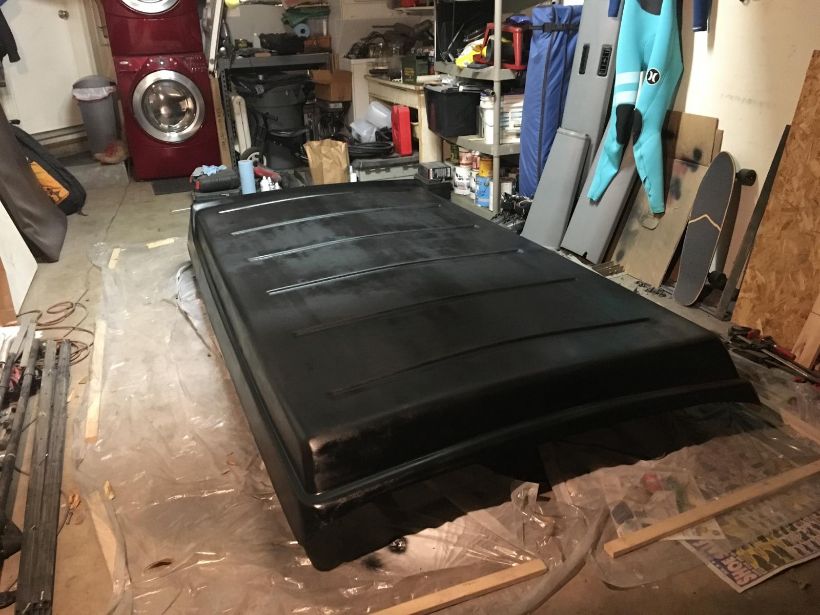

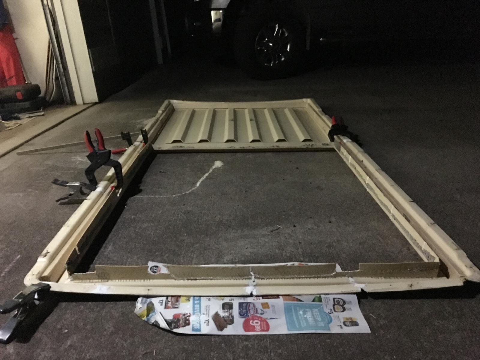

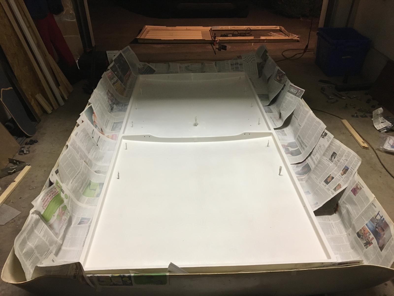

When the top arrived, I was a little overwhelmed and honestly almost took a hard pass. But instead I dove in head first. Being a plastic top, the external top was in very good shape...however the base was cracked and the wood sub-frame was demolished. I started by rebuilding the subframe, then "fixed" the plastic around it. A little paint and it turned out pretty good.

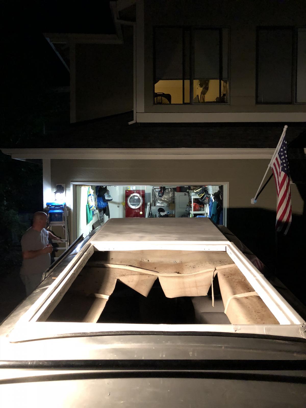

It took about a month and 60+ hours to restore the top in my garage, and about 3 - 4 nights for the installation including cutting the hole, assembly and installing the top, and then finishing up the trim inside.

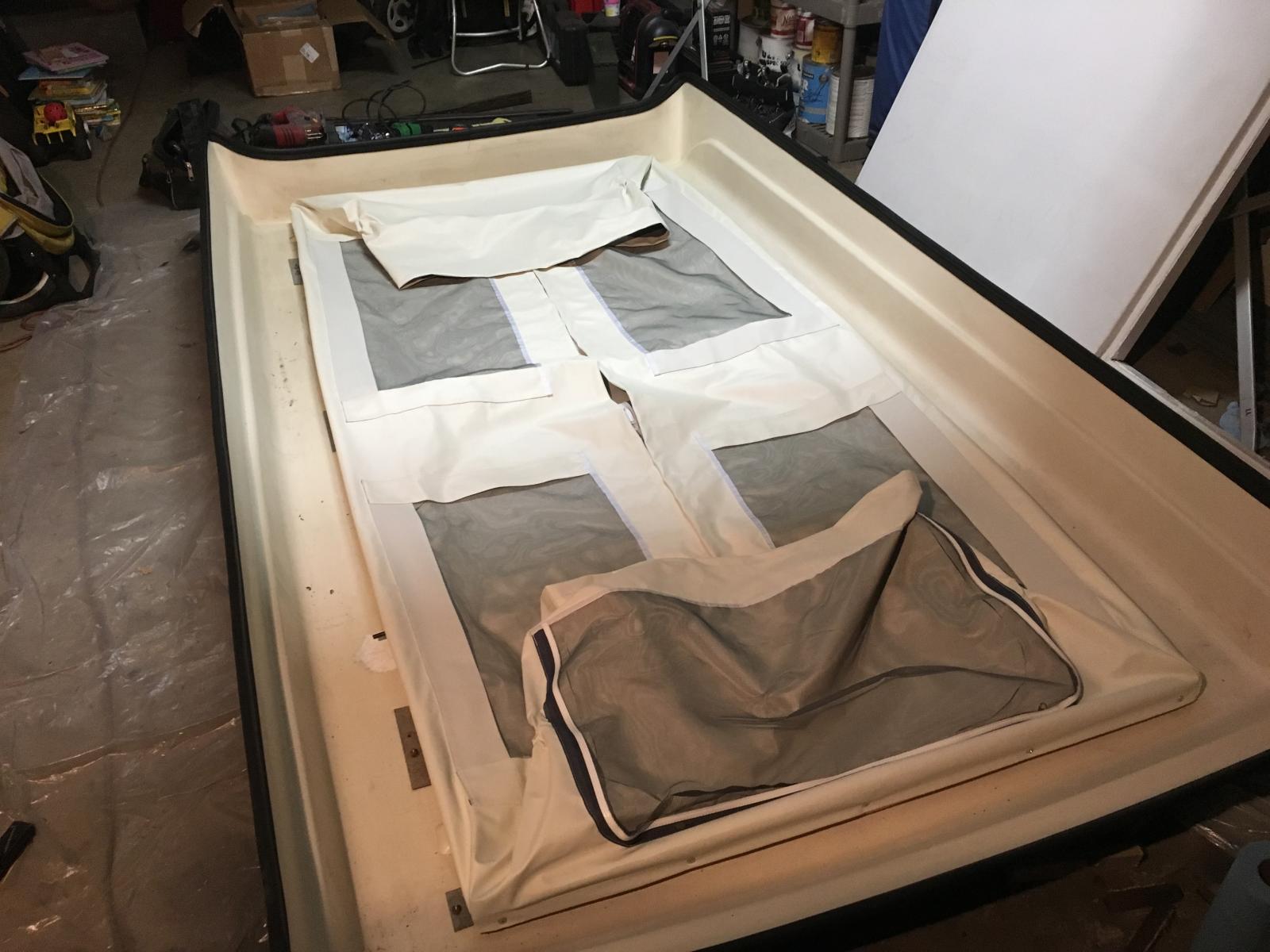

The day it arrived in my garage.
The base was in the worst condition. Cracked in a ton of places.

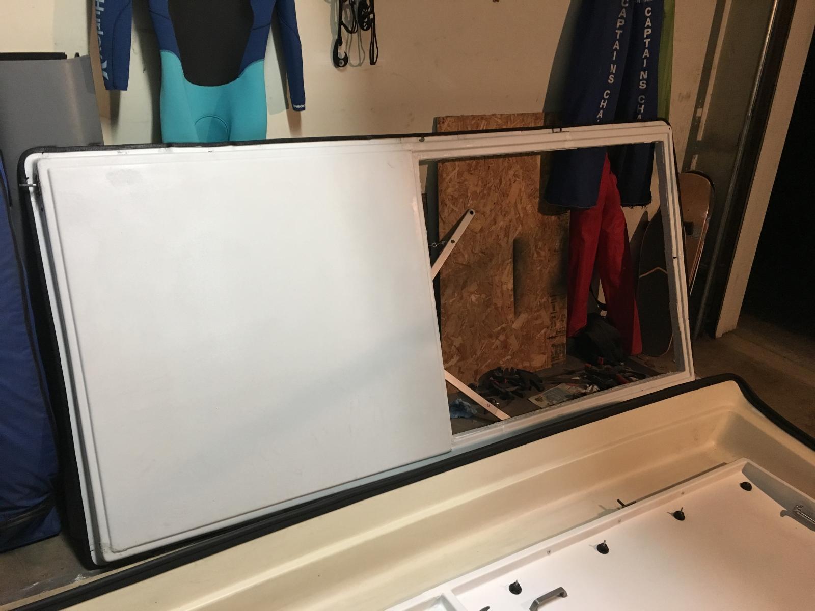

Repaired and painted
The ceiling plastic was very yellowed, and also cracked
Painted the top black

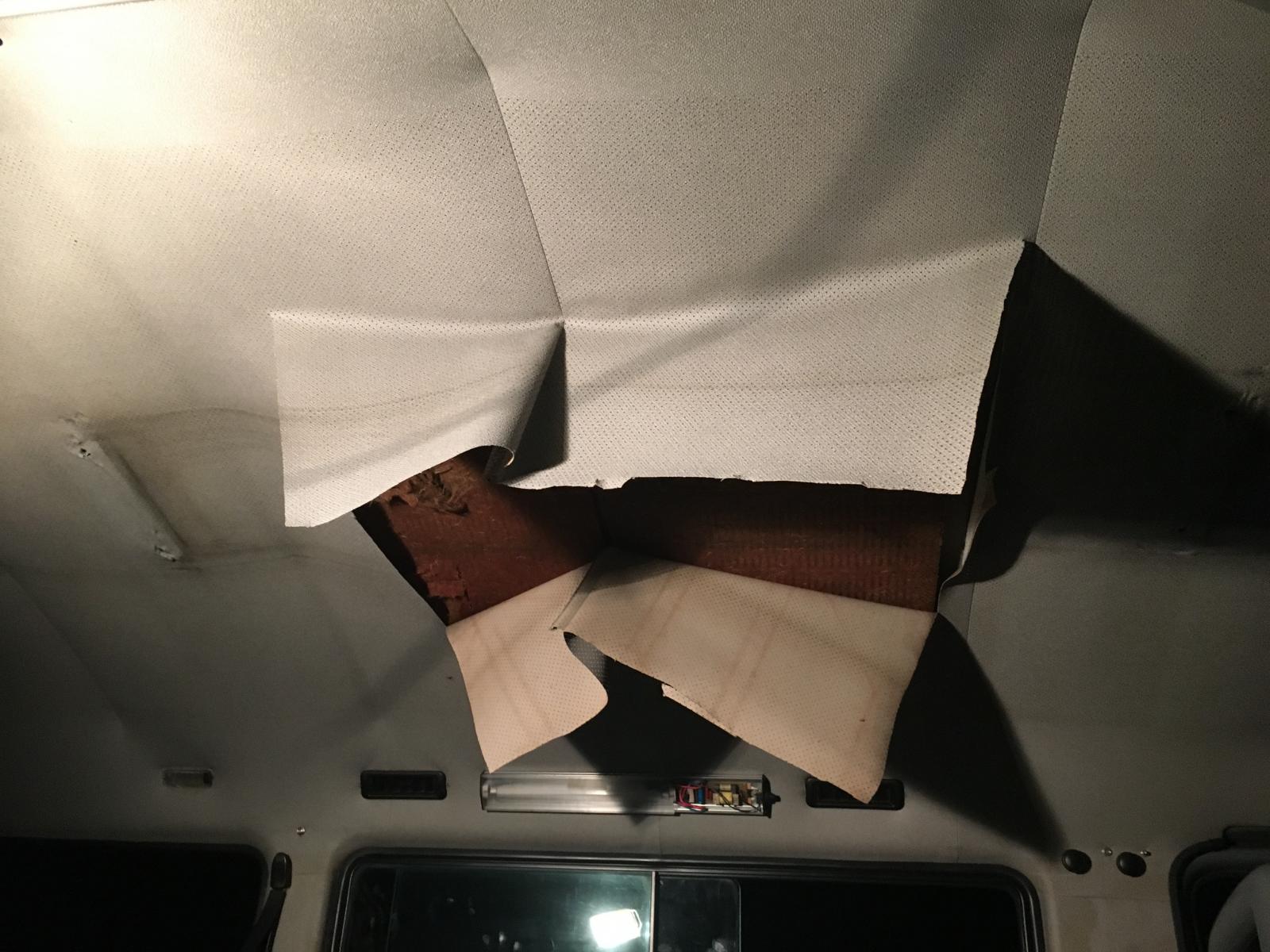

Cut headliner hole
Cut hole in roof
Test fit base on roof
Final assembly in the garage before it went ont

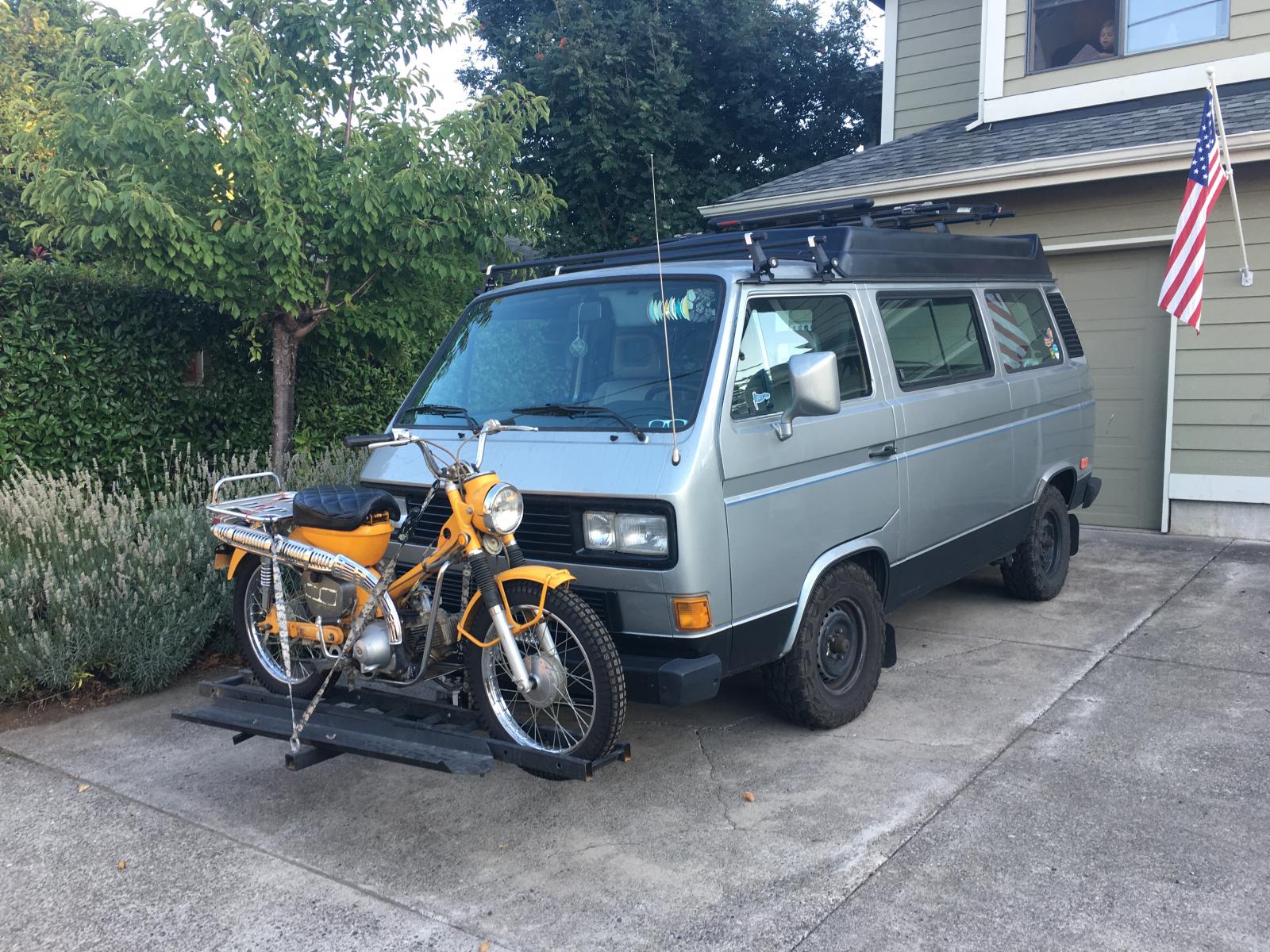

Yesterday
So far it has lived up to a 70MPH drive for 4 hours, two paddle boards on the rack, and about an hour of down poor while driving with no leaking. That's a good start.
