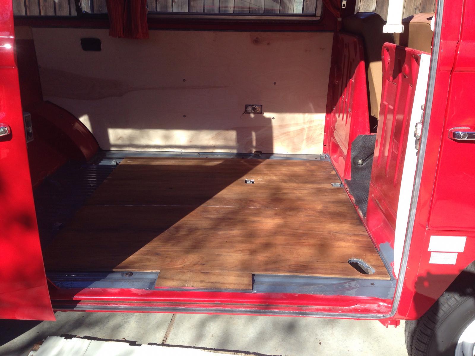

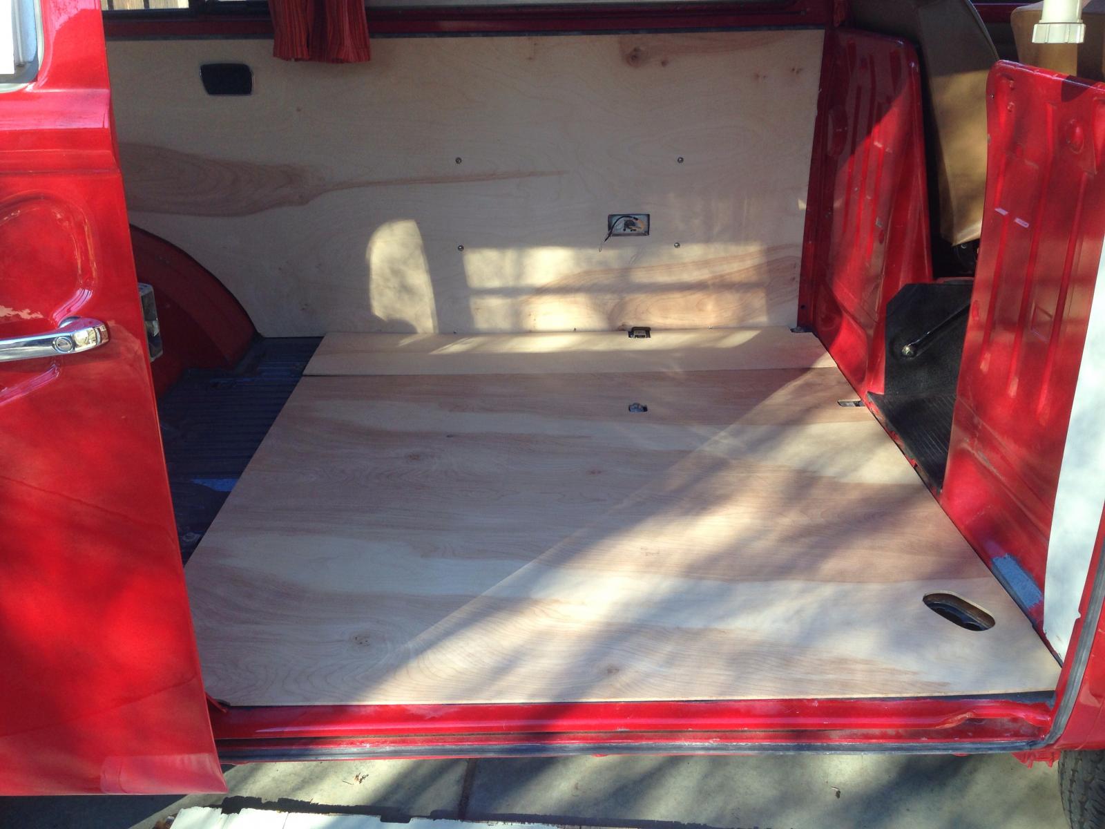

PostPosted: Fri Jun 09, 2017 1:04 pm    Post subject: Re: Westy Cargo Area Sub Floor Reply with quote
More pics in my gallery, but when I did mine the base plywood (1st layer on floor) was about 3/8":
And the top was on ~.20" (5mm) but I used 1/8" since my sheet I was using was thicker than the original. Next time I'll use 1/4".
I had trouble finding 5'x5' plywood sheets in my area, but of course found it after I was done. Here's the final result after finding this checkered sheet stuff from the UK since I couldn't find it in the US:

PostPosted: Fri Jun 09, 2017 7:29 pm    Post subject: Re: Westy Cargo Area Sub Floor Reply with quote
The base ply is metric, but 3/8" works. The vinyl is attached to ~1/8" ply. The floor does not extend under the bench seat/bed but does go under the jump seat and sink unit.

PostPosted: Fri Jun 09, 2017 8:12 pm    Post subject: Re: Westy Cargo Area Sub Floor Reply with quote
The Z-bed/cabinet goes on top of the flooring so it actually does go under the bench seat. Also, my original flooring is on plywood thicker than 1/8", but less than 1/4". I just measured it and it reads as 4.42mm thick for just the plywood that the flooring is glued to.

PostPosted: Sat Jun 10, 2017 7:23 am    Post subject: Re: Westy Cargo Area Sub Floor Reply with quote
lintbrush wrote:
You're correct, I now remember the floor does go under the seat a few inches - if you look at the second picture I posted, you can see a faint line where the front of the seat rests. There are two 3/8" ply blocks (small, only a few inches across) that sit under the back end of the seat near the the seat belt attachments - similar to the rectangle ply block near the sliding door in the first picture. The ply the vinyl attaches to is metric as well, so it is thicker than 1/8" (hence why I used the ~), but 1/8" ply will work.
