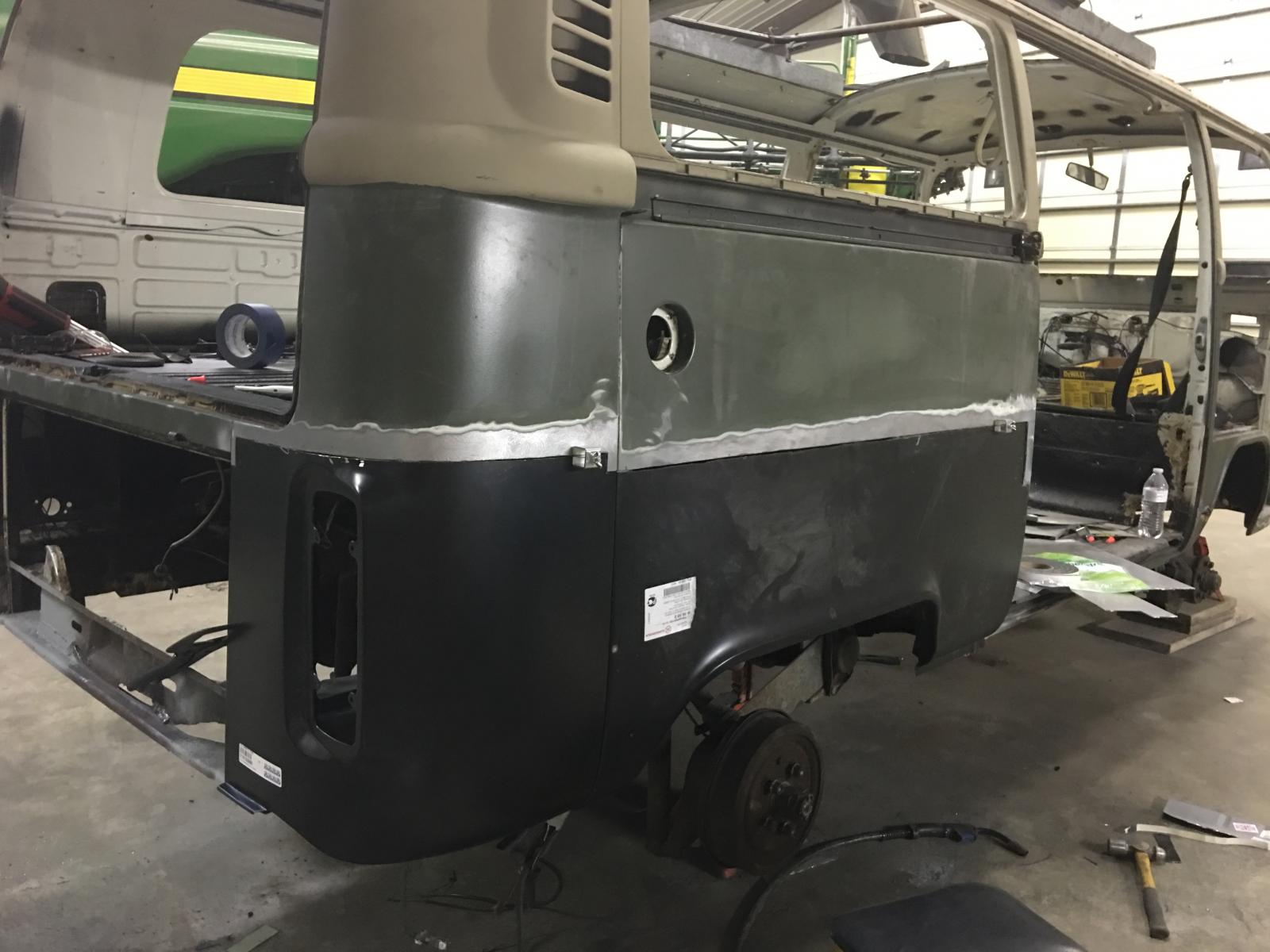

Finally got started on the body work.
Replaced the area under the windshield. This is the first body work I have done.

PostPosted: Sat Mar 24, 2018 5:55 pm    Post subject: Re: 1977 Sportsmobile/Westfalia Build Reply with quote
Your first-time body work looks pretty good to me. It gives me confidence to tackle Chloe's body work.

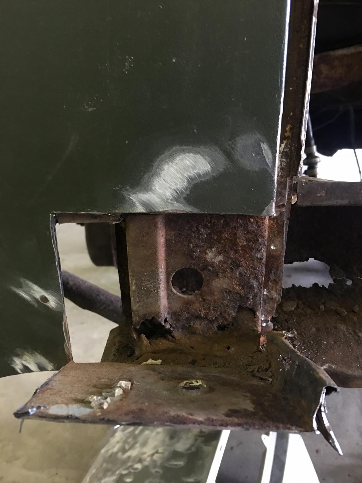

PostPosted: Fri Apr 20, 2018 8:37 pm    Post subject: Re: 1977 Sportsmobile/Westfalia Build Reply with quote
Here are some pictures of my body work so far. I'm about to weld the corner and fender in place. Had to dig pretty deep to get rid of all the rust back here.
ivwshane
Joined: May 19, 2011
Posts: 1921
Location: Sacramento ca
ivwshane is offline
PostPosted: Fri Apr 20, 2018 9:47 pm    Post subject: Re: 1977 Sportsmobile/Westfalia Build Reply with quote
You've never done bodywork? I'm calling bs! I'm guessing you have some sort of background in welding at the very least.
Where did you get your battery tray?
Looks great though! I too like the custom setup you have with the pop top and interior.

PostPosted: Sat Apr 21, 2018 8:19 am    Post subject: Re: 1977 Sportsmobile/Westfalia Build Reply with quote
I practiced on a piece of a bug body to see how thin metal welds and have built a dune buggy. So not my first time welding. I am only 18 though so not like i could have too much experience Laughing Thanks for the compliments though!
The battery tray and corner piece are from wolfsburgwest and everything else is from bus depot.

PostPosted: Mon Apr 23, 2018 8:15 pm    Post subject: Re: 1977 Sportsmobile/Westfalia Build Reply with quote
Didn't have much time today but got it tack welded. I think I'm happy with how its looking/fitting. Now i just have to spend time grinding-welding-grinding-welding.....

PostPosted: Mon Apr 23, 2018 8:40 pm    Post subject: Re: 1977 Sportsmobile/Westfalia Build Reply with quote
That windshield lip you have to be careful not to just weld metal in over top of the old base or you could have trouble getting your windshield to fit or not crack as your reducing the dimensions of the windshield frame itself.
If you've never done bodywork then just make sure that none of your exterior patch seams end up as raised areas - because you can't blend that.
Kind of looks like he's got it down. Windshield lip looks great, panel fitup, nice clean flat tacks with his welding. Sometimes I do work that nice on a really good day...
Yup. I hate him already. Wink
dualbay
Joined: March 21, 2018
Posts: 108
Location: USA
dualbay is offline
PostPosted: Wed Apr 25, 2018 4:37 pm    Post subject: Re: 1977 Sportsmobile/Westfalia Build Reply with quote
Well I'm not sure what he did with the windshield; he showed a pic of the lips rust holes grinded down and then the next pic the replacement metal was welded in - so I was just concerned that he may have welded the replacement metal OVER TOP of the old metal reducing the frame size and possibly guaranteeing a cracked windshield on installation. But, who knows maybe he cut the old metal completely out after that pic? Just felt it my duty to warn him as I've cracked several over the years and had frames be way off after welding.
As far as his tack welds and overall work, that makes two of us that hate him Very Happy
