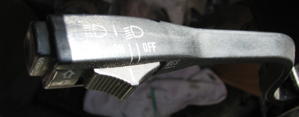

Where is the VSS for this thing? I can't find any kind of speed sensor. There is nothing on the backside of the speedo where I assume the factory added CC would be, nor on the drive shaft. How does this thing know what speed to hold?
Good idea idea on adding photos(duh!), so here they are -
“May your trails be crooked, winding, lonesome, dangerous, leading to the most amazing view. May your mountains rise into and above the clouds.” - Edward Abbey
Click to view image

you may have a magnet on the CV joint, with wiring to a pickup, going to the control unit.
My first 83 Westy had this system installed.
The top picture looks like the servo to the throttle on the engine.
The unit is a universal one, it need some way to correlate speed, if the magnet is gone, that very well may be the problem unless the box is blown.
Adjustment was a pain in the ass until I finally got it right.
Also do a search. Aftermarket Cruise control, dogpilot has info posted.
ck http://www.thesamba.com/vw/forum/viewtopic.php?t=256451&highlight=dana+cruise
