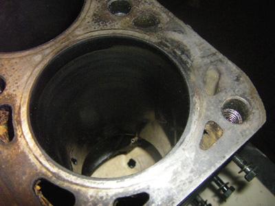

First 3 "clean" cylinders

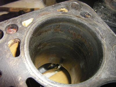

Rusty cylinder
Rusty cylinder after a bit of light sanding

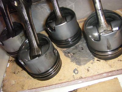

I see a "scuff" on one of the piston skirts. I imagine you are going to have the cylinders bored out? You will want to remove the oil squirters prior to having any type of cylinder work done. |

MarkWard wrote: |
A guy on vwdiesel.net suggesting that machine shop work would not be necessary, but I don't see how that can be the case.
I am going to need new pistons also, no?? _________________ www.edwardpowell.com |

as someone who spent a bit of time in a shop rebuilding engines, i can say, with strong confidence, that what the cylinders and piston look like is less important than what they measure.
you have to do a lot of rebuilds before you can read the wear, with anything close to accuracy, and even then, looks can be deceiving.
i've been told the tolerances on VW NA Diesel engines are fairly tight. that makes accurate eyeball assessments more difficult.
you really won't know what those cylinders need, until someone who knows how to do it makes an accurate measurement with a micrometer.
if you need to bore the cylinders, you definitely need new pistons. the precise measurement for the cylinder bore is determined by measuring the pistons.

As told, get the parts to a reputable machine shop specialized to engine rebuilding and they will tell if honing (cylinder resurfacing) is enough in your case or boring to oversize with new pistons needed.
As these VW blocks are similar since the late 70s and they were used in Skodas to the mid 2000s there is low risk that they cannot work with it.
BUT it may cost a lot. That is why its common to change those to more recent 1.9 engines (either direct or indirect injection ones) even illegally. _________________ Zoltan

Read the size of the old pistons. Let the mashine shop bore the block to next oversized pistons minus 5/100 mm.
If there are no more scrahes on the bores, buy new oversizes pistons. Give them to the mashine shop and let them hone/bore the block exactly for the new pistons with 5-6/100 mm clearance.
