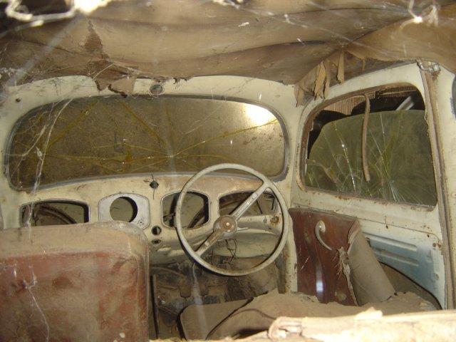

I know this would definitely not apply to your car but for interest sake SA assembled cars had tan or red leatherette upholstery.
I found this Azure 52 split with factory red leatherette upholstery.
This is the only car so far that I seen with red but confirms red was an option.

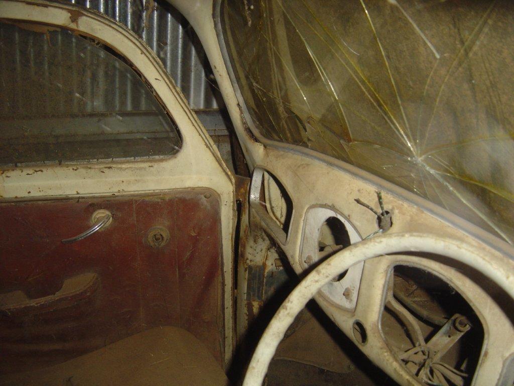

Jdt1976
Joined: March 23, 2014
Posts: 25
Location: South Africa
Jdt1976 is offline
PostPosted: Tue Dec 26, 2017 6:01 am    Post subject: Re: Correct interior colors for Azure Blue car Reply with quote
It is definitely factory.
The seat material and door material (both tan and red) is not the same type material. The door material is thinner and more a paper type finish on the outside. The seats more of a thicker leatherette material that can stretch a bit.
The only difference I could see was the red seat material got a rougher pattern on the outside compared to the tan:
For the rest, for both door and seat it is exactly the same type of material.
I loaded more pics in the gallery for interest.
This leatherette was original for SA cars.
