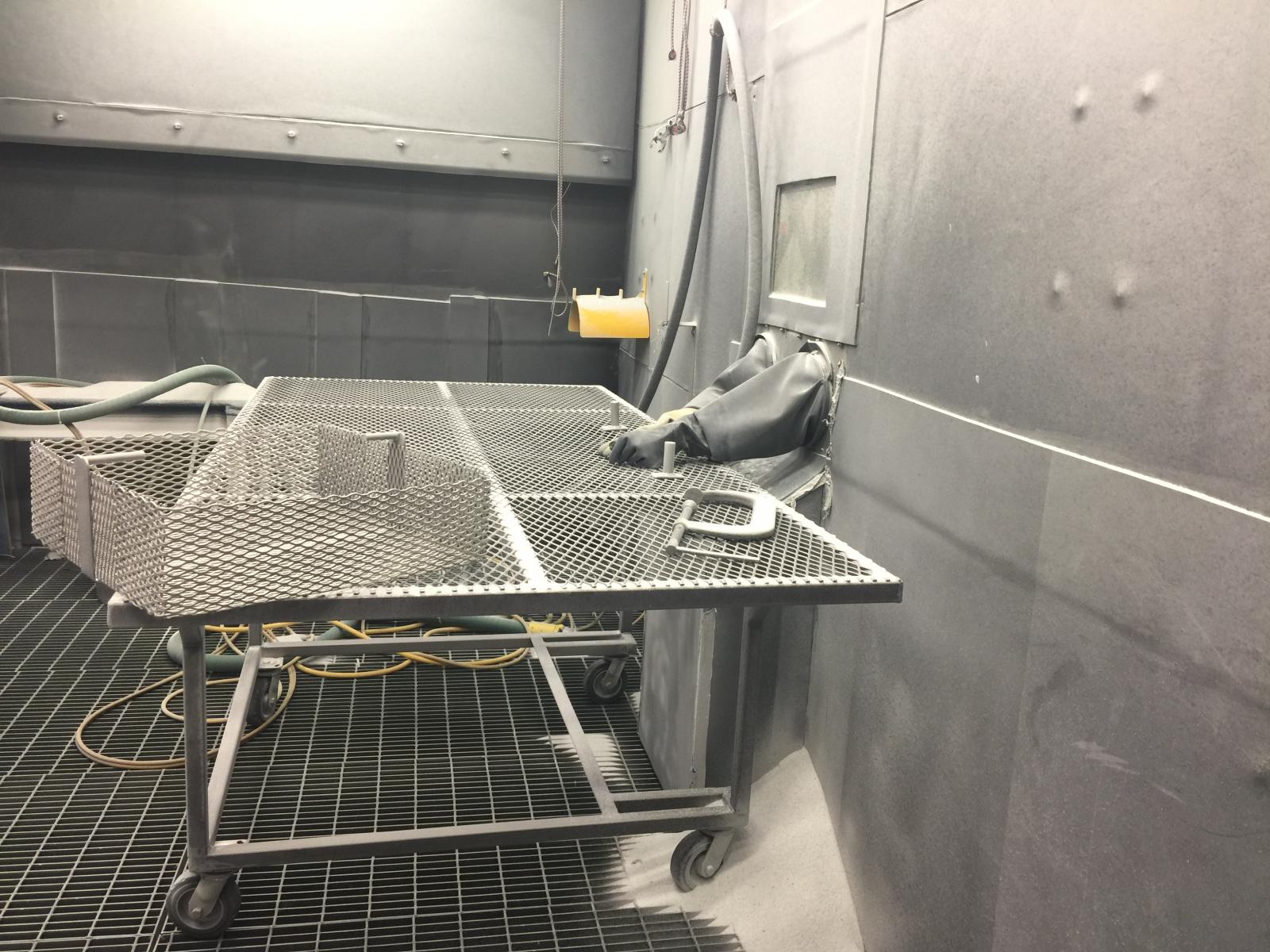

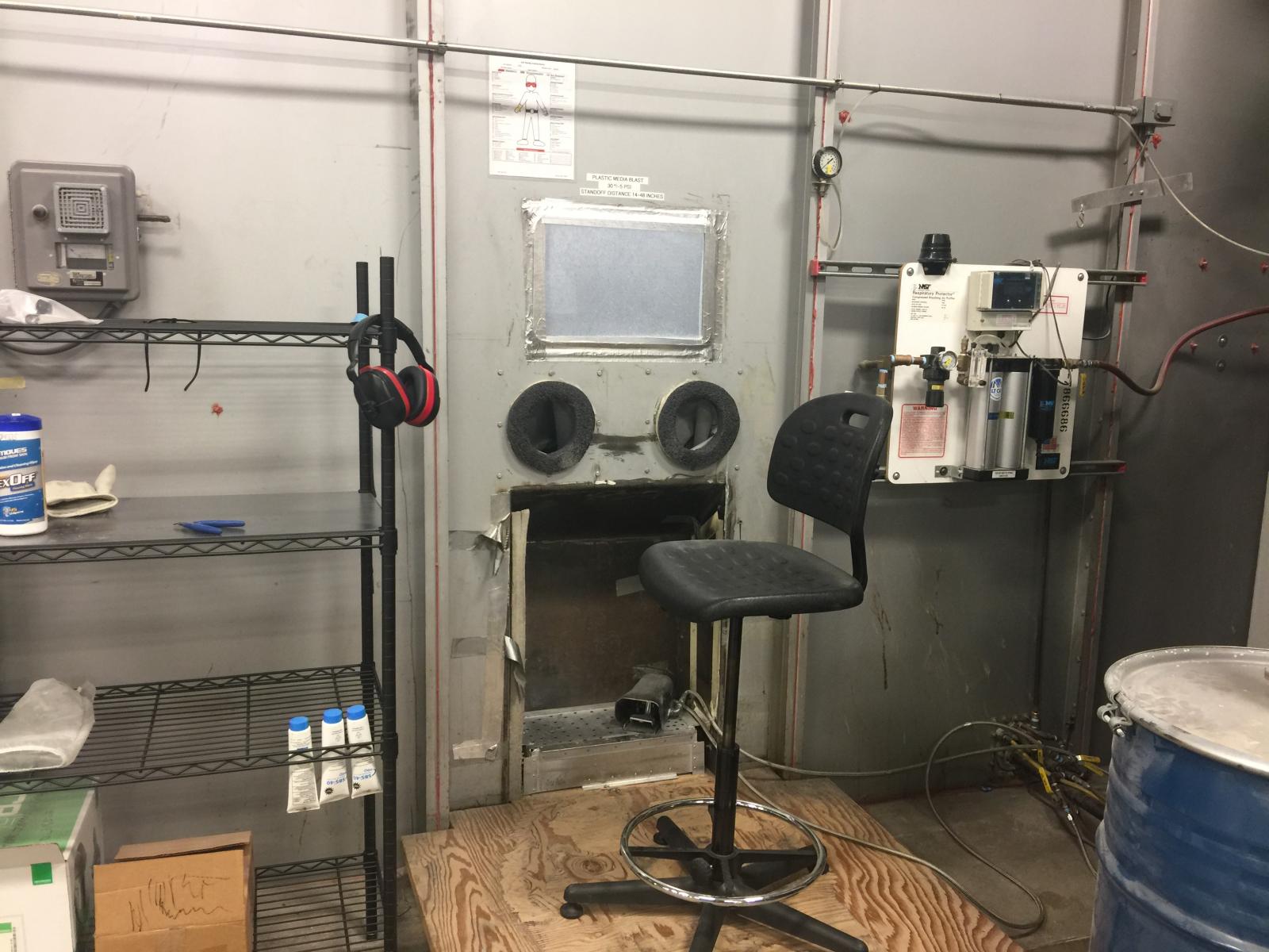

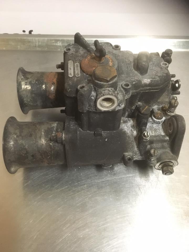

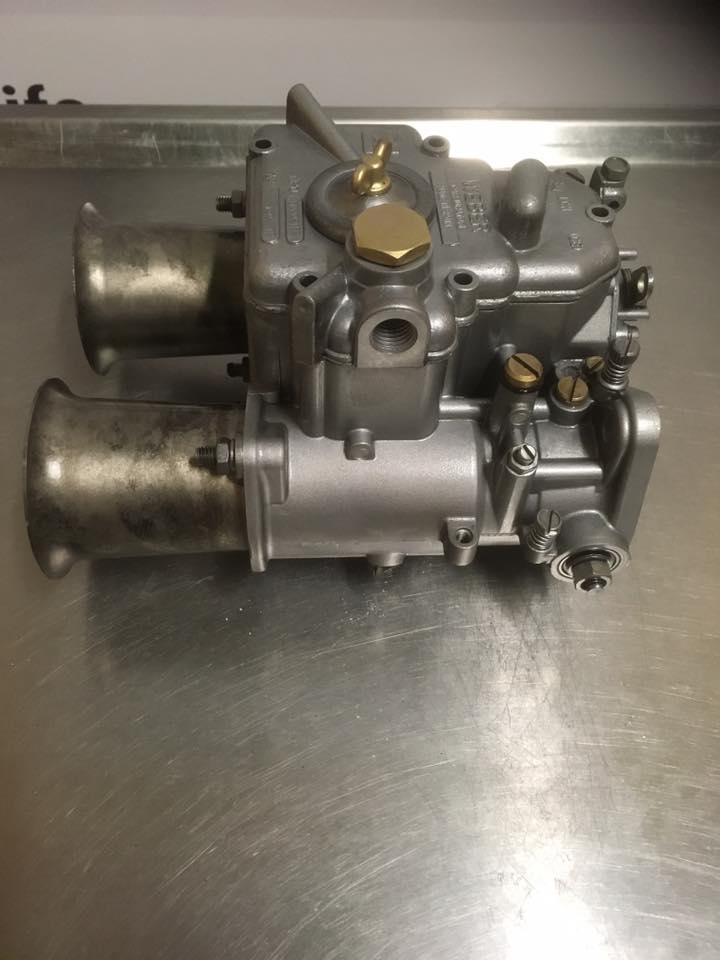

Yes go big like this machine which uses a plastic media to clean light alloy parts. It will not erode or remove any factory coatings but does remove all dirt and stains. Does a beautiful job on carbs,fuel pumps,distributors, cylinder heads etc. runs about 35 psi and can be used as booth or walk in. Cleans faster than a cat can lick its ass. Very Happy
