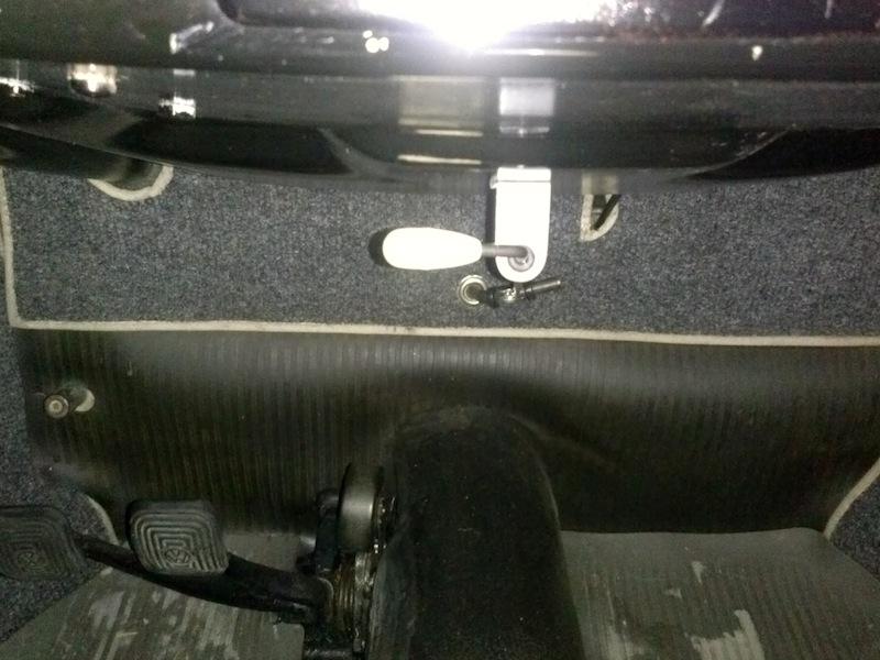

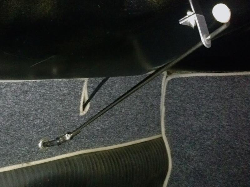

PostPosted: Tue Nov 14, 2017 10:27 pm    Post subject: Re: Reserve handle extension Reply with quote
I made a new longer bracket for the reserve handle extension. Now I can turn the handle without hitting the bottom of the dash. On this bracket I included a momentary push button for mist mode wipers. A few other parts are required, including a 5 terminal 6 volt relay, a diode, and a transient voltage suppressor across the relay coil.

PostPosted: Wed Nov 15, 2017 11:28 am    Post subject: Re: Reserve handle extension Reply with quote
The center lines of both the extension handle rod and the through-the-firewall section of the operating lever have to line up as close as possible for correct operation. Look closely at the Brezelwerks repro and note how the attachment clamp is not symmetrical......it is designed to go on one way only, to get the best alignment. If the clamp is on backwards, or if an incorrect symmetrical clamp is used, operation will be adversely affected.
Reaching down for the firewall lever should not be done while driving; the lever is supposed to be nudged over with ones foot. As far as slop is concerned, many of the operating levers have their attachment holes worn oversized by now. Using a too-small attachment spit pin to attach it to the fuel valve is another common culprit.

PostPosted: Wed Nov 15, 2017 7:25 pm    Post subject: Re: Reserve handle extension Reply with quote
The reserve handle extension works good now. I also replaced the handle with a reproduction one from WW, mine had some extra curves that likely happened when someone insisted on turning it with a frozen fuel tap. The prior owner replaced the fuel tap on the tank. I think the tricks to using the common and inexpensive repop extension is to use O-rings or grommets to hold the handle loop on the reserve lever, and to make a longer bracket so the handle can turn a little more than 90 degrees without hitting the bottom of the dash.
