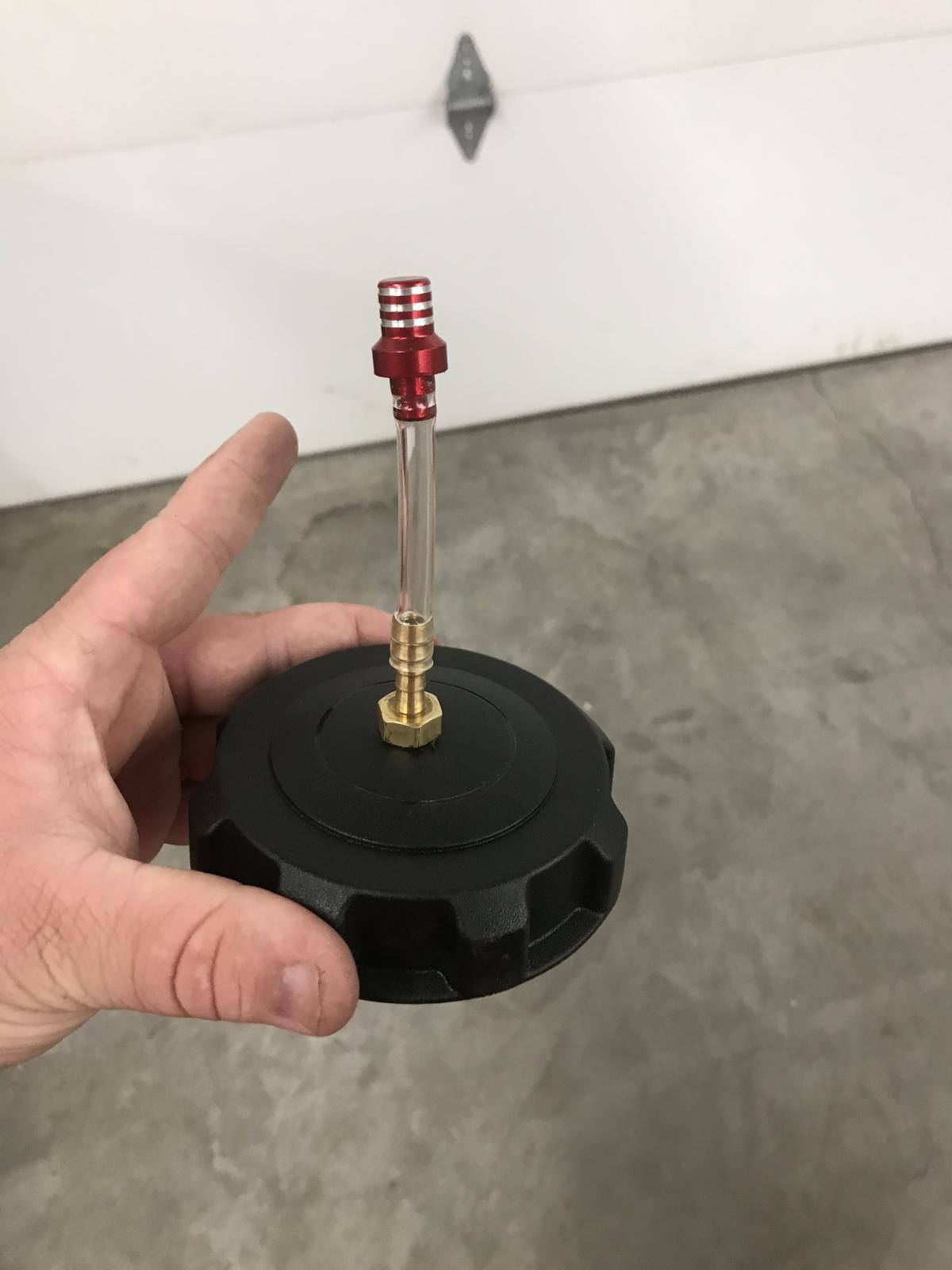

Bkhansen93
Joined: July 14, 2018
Posts: 207
Location: Coal City, Il USA
Bkhansen93 is offline
PostPosted: Fri Aug 09, 2019 8:57 am    Post subject: Re: Poly Fuel Tank Venting Issue Reply with quote
So this is my 1st iteration of the cap to vent and prevent spillage. Some may be familiar with this. It is a valve commonly used on dirt bike gas tanks to prevent spillage while upside-down. I later found that I only have about 1.5-2” of room from the top of the tank to the trunk lid so this hose has been shortened. Will go hit some bumps on my lunch break to see how it does.
slalombuggy
Joined: July 17, 2010
Posts: 9318
Location: Canada
slalombuggy is offline
PostPosted: Fri Aug 09, 2019 9:10 am    Post subject: Re: Poly Fuel Tank Venting Issue Reply with quote
You could trim the brass barb back a bit also. Makes it less obtrusive when taking the cap off the tank.

Bkhansen93
Posts: 207
PostPosted: Sat Aug 10, 2019 5:52 am    Post subject: Re: Poly Fuel Tank Venting Issue Reply with quote
I was considering it. I may do it. Should onlt take a minute or two
