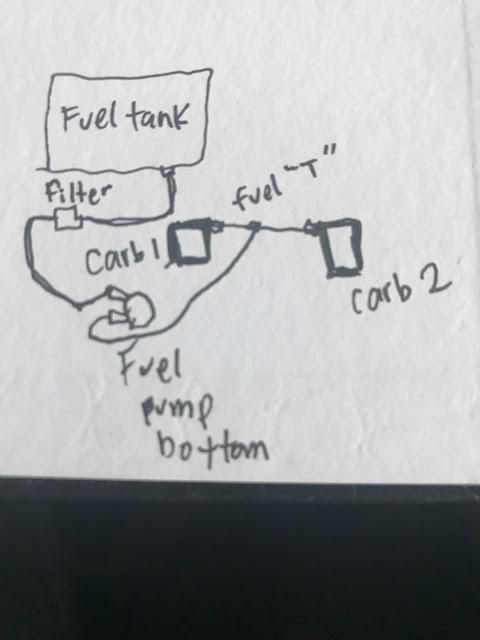

It's a 1776, I can't remember which pump this is. The line from the fuel tank goes to the fuel filter, then to the top port on this fuel pump. Each carb is connected with a "T" in the center, and that "T" goes to the bottom port on the fuel pump. I thought this is how it was before but I may have accidentally crossed something?

Fuel pump is pumping! I cranked it by hand and the send/out is the one on the bottom, which is going to the "T" then the carbs. I poured 1/2 of a spray paint cap full of gas down one of the carbs and it started up for a second but died. Im sure it all needs to be tuned but getting it started TO TUNE is proving to be a challenge. I've been cranking it over a lot.
