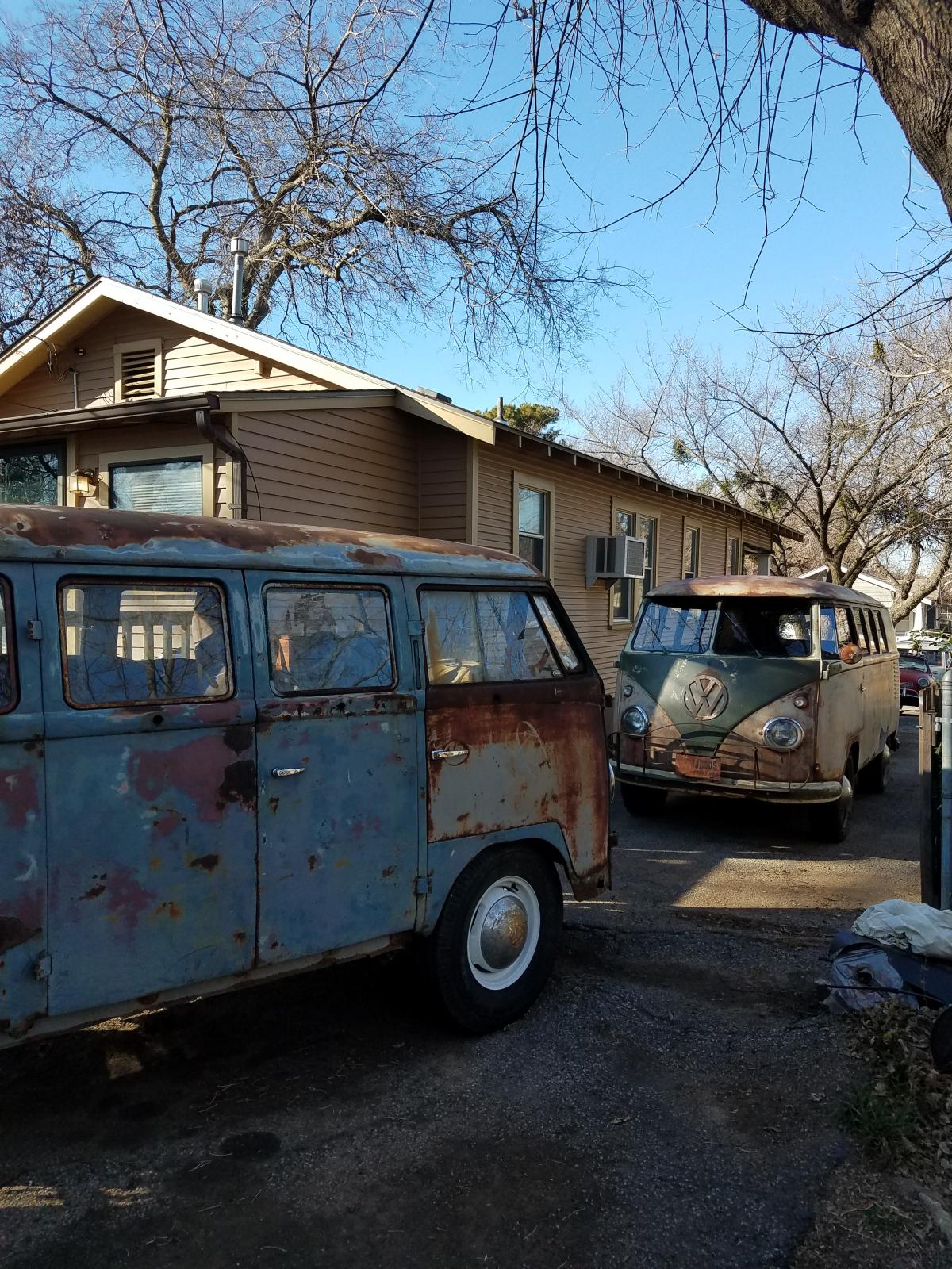

I am amazed sometimes thinking about the buses that used to be cut up. This bus got its fair share of cuts but the most odd one to me is by far the removal of the roof bows. Luckily the roof didn't receive much damage during the removal and the roof survived for years afterwards.
I got some donors cleaned up and ready to install.
The worst part about this and probably the saddest is that two original stationary windows from the driver's side got splattered with sparks and slag from the removal.

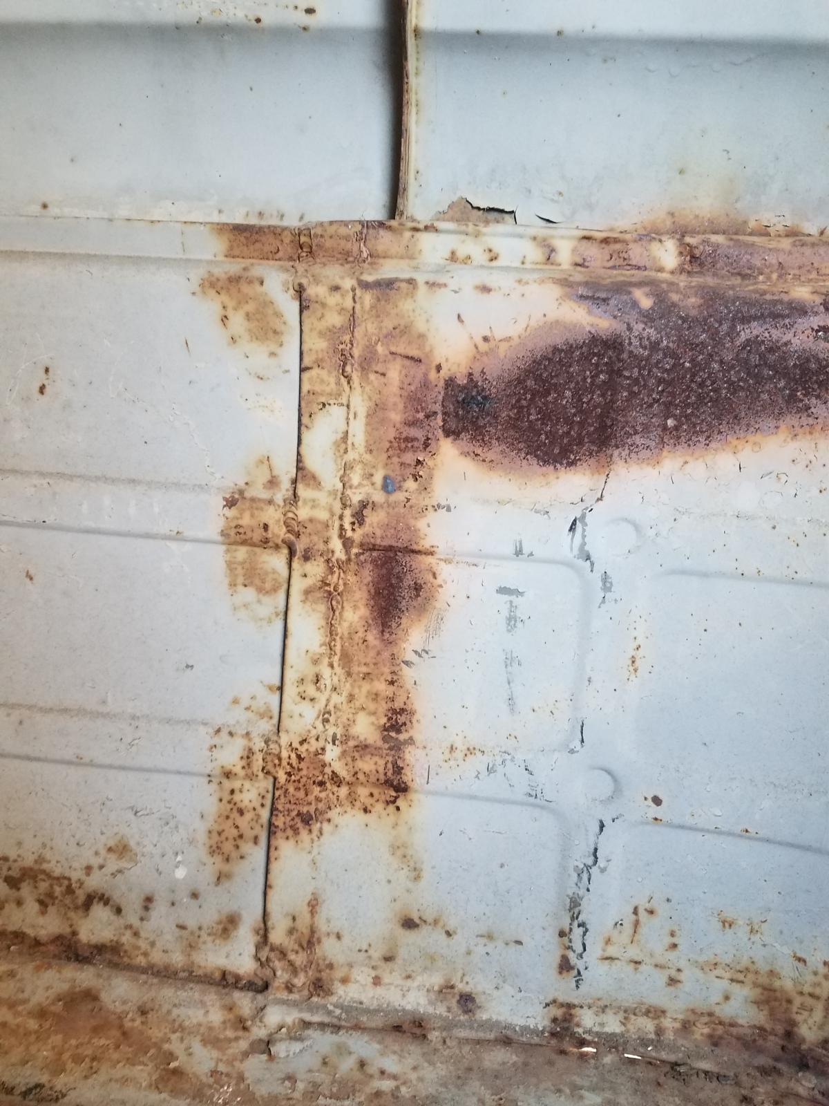

It's been a little bit since I had an update but this past weekend I made some progress. There were some measurements that seemed off to me on my bus and before I put in the rear corner I wanted to find out what was what. Travis drove the church bus over to my place so I could measure another Wolfsburg Bus. It's always nice to have him for a visit and I appreciate the 2 hour drive he made because it cleared up a bunch of stuff. It was good to have these two buses together too. Pretty cool!
My apron mounts told the tale. They were almost an inch closer together than his. The hunt was on to find the discrepancy. The driver's side corner has signs of filler but after some investigating it looks more like that corner has been off before. Things started standing out at this point that weren't quite right. Something had either come loose, was put together incorrectly, or had been hit and knocked out of place again. No matter, it has to be fixed so I took pics and noted measurements off Travis' bus before he headed home. The triangle support is probably going to have to come out but for now I am going to get the passenger side firmed up so I have a solid point of reference.
So back at the passenger side, I was pleased to find, after measuring Travis' bus, that the fitting I'd done on the corner was spot on! So next on the list, I started fitting the battery tray in. There's still some trimming to do on the inside edge. The bus is supposed to have a one piece battery tray/engine surround so I will butt weld the two pieces and grind it smooth.
I'm ready to get the donor lower corner cut and fit but I ran out of daylight.
It doesn't look a lot different at the end of the day but I know all I accomplished and it feels good!
