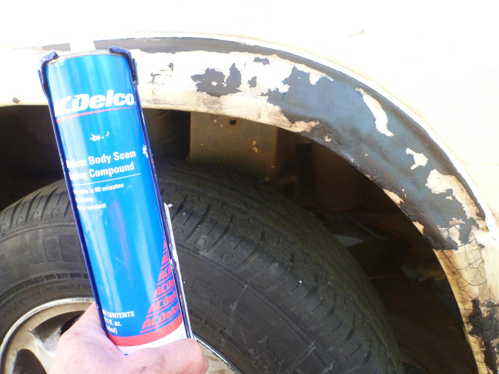

Meet my body workers, 10:30 at night in a gas station in Morgan Hill, used a porta-power and some hammer and dollie and shaped the fender lip for a hundred dollars, as well as pushing and pulling a couple of dents in the door.

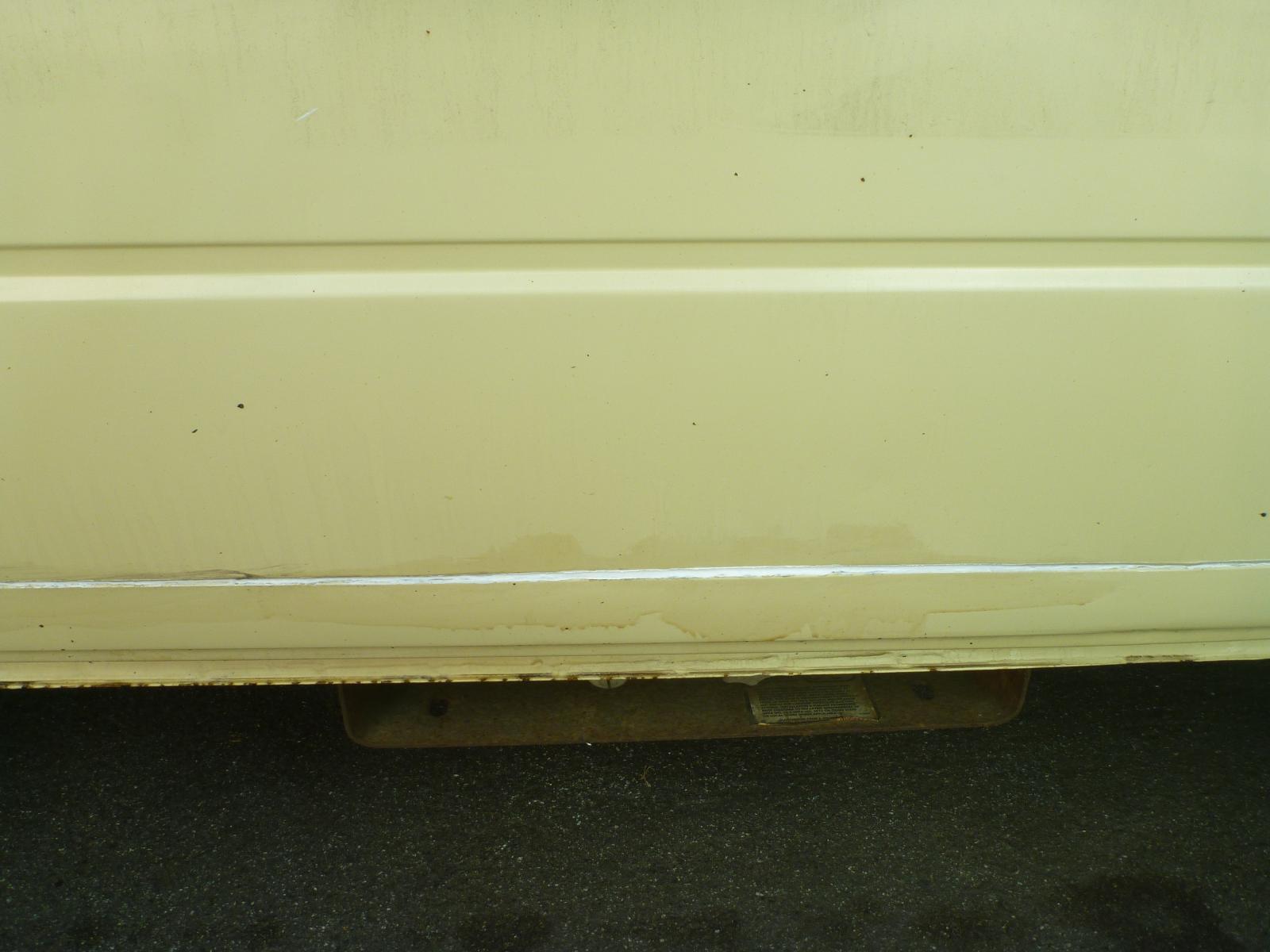

So I picked the ugly out of the seams and applied plastidip brand rust converter,
Some seam sealer, reputable brand, single stage,

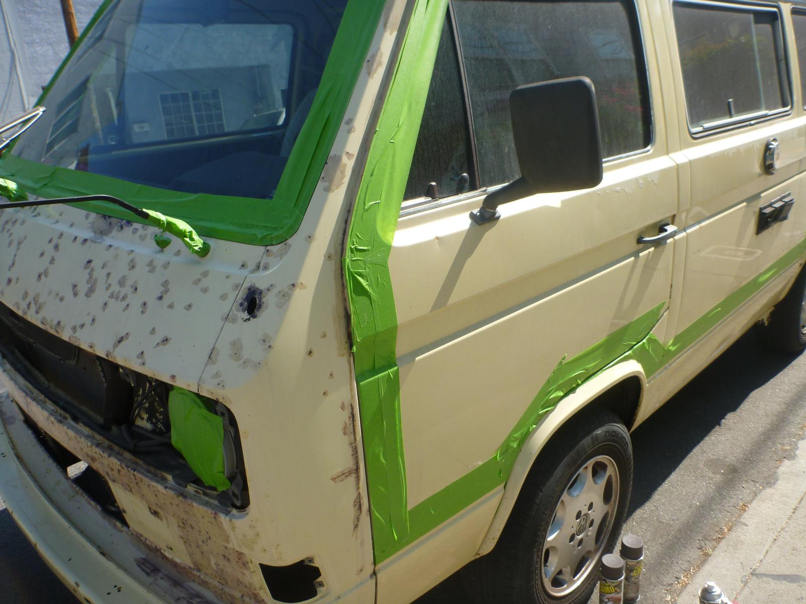

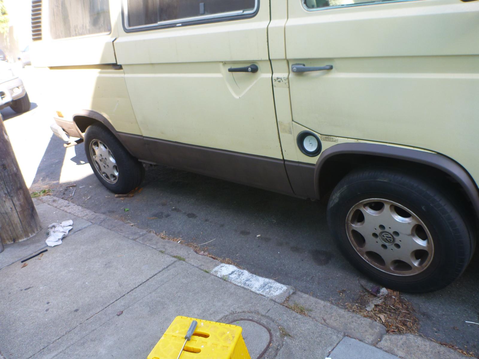

Wipe down with acetone, mask and start spraying. The weather was marvelous these 2 days I sprayed, 20 minutes between coats was plenty,
The bit under the front door is the 1st coat, recommended to be very thin,
some more coats, I think 5 or 6 in all,
I've always envied the two-tone paint jobs,

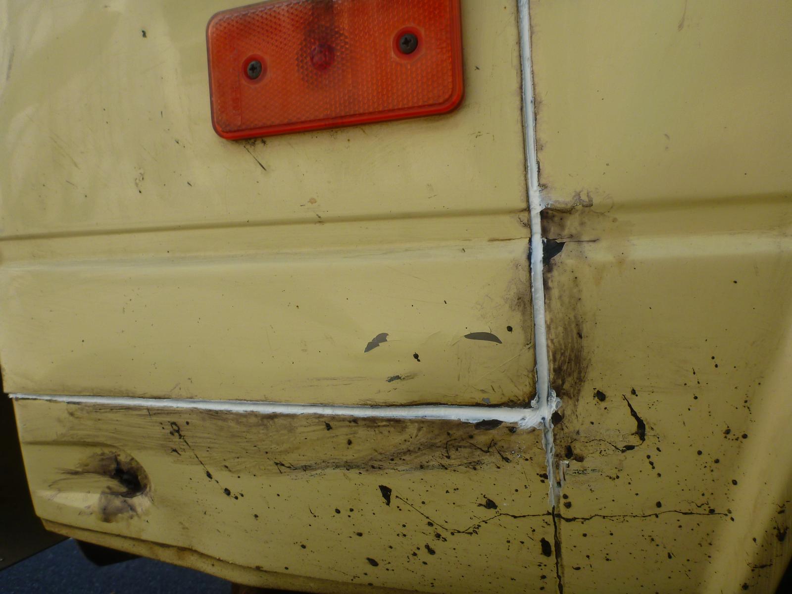

Skipping ahead to the other side here's the kitchen seam treated and gooped, sure to elicit some criticism,

So on to the ugly front, Yes the desirable thing would be to remove the windshield, cut out the offended metal and weld in donor lip. If I hold myself to that standard nothing will happen and the van will be even uglier next spring,
maybe a pic repeat,
The rust converter instructions say not to apply to paint but that's not practical across this expanse,
On the paint the converter leaves a little opaque residue that will wipe off with acetone and some rubbing. On the front I left the residue, we'll see,

Looks like I tried to upload too many pics at once and time to get ready for work, one more for now and I'll show the final later,
Overspray removes easily with a little acetone, the trick to getting a clean edge is peeling the tape just after the final spray almost simultaneous as the last coat melts the prior and the tape will lift off while the dip is wet,

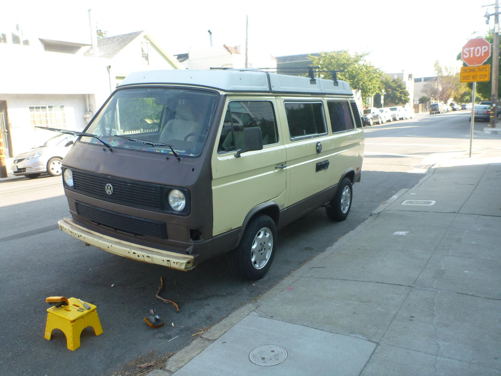

I thought I had a pic of where I worked rust converter under the windshield gasket but don't see it. It turns into a black oxide that looks and feels stable.
Without further ado,
Kicking the can down the road, I can peel the dip off in a year or 2 and see what's going on. If rust is slowed at all I don't think there will be much more work to repair than if I were to do it right now. I had one can of the camo brown and bought 6 more and ended up with a can left over. 6-pack of cans was about $50, seam sealer about $10. Acetone and masking tape were on hand.
I dinged it up a bit installing a new antennae, I just held a piece of paper up to mask the antennae and spritzed a bit on the repair. It melts into itself and doesn't show at all. Overspray wipes off easily with acetone.
For bonus points I razor bladed peeling clear coat and put in new utility boxes. It's not an embarrassment at this point, we'll see what it looks like next spring and beyond!
