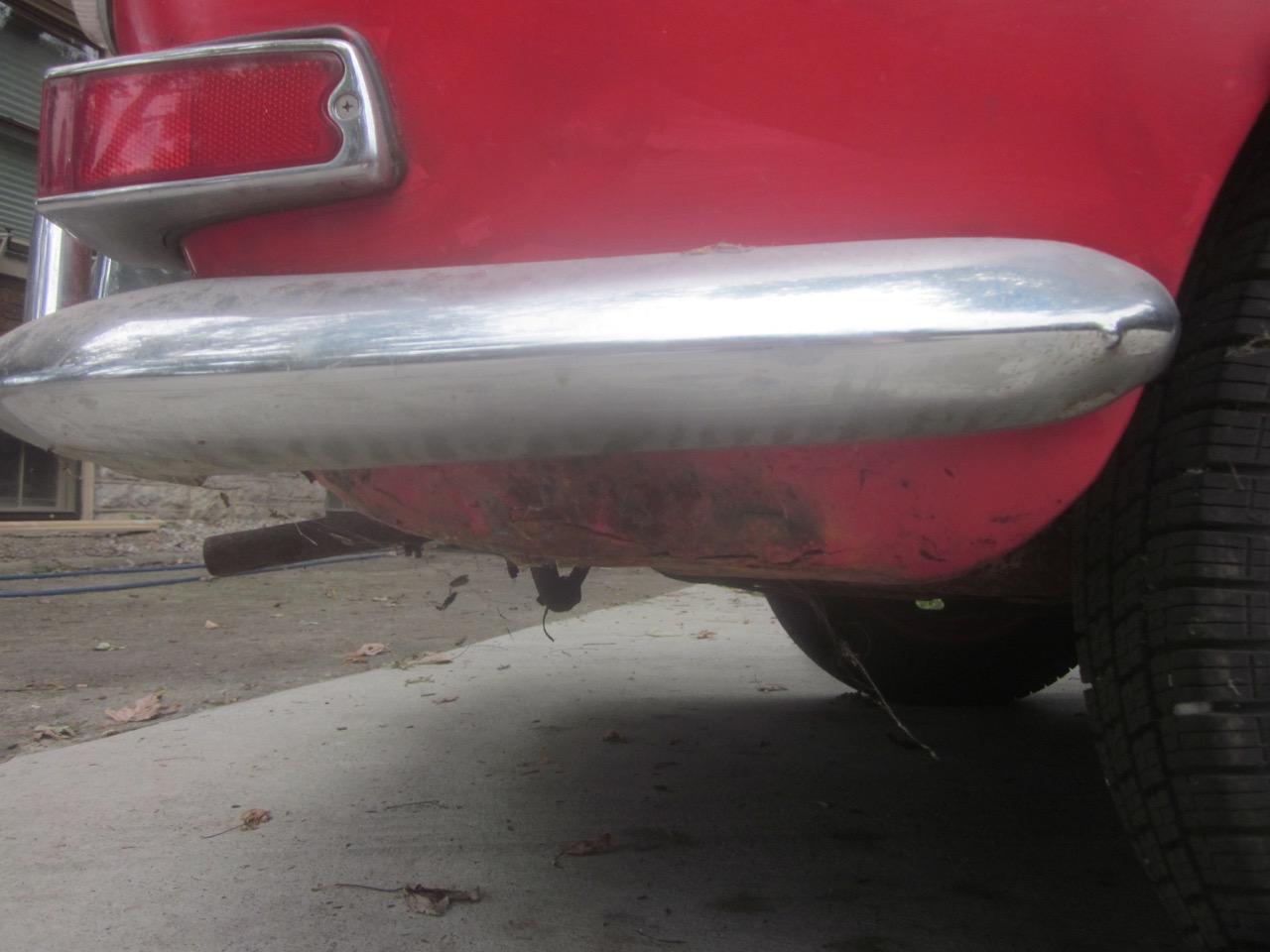

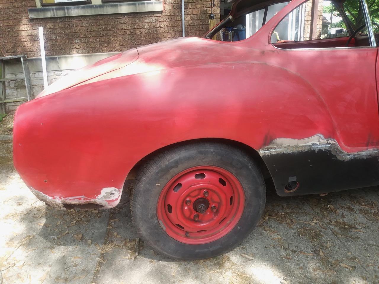

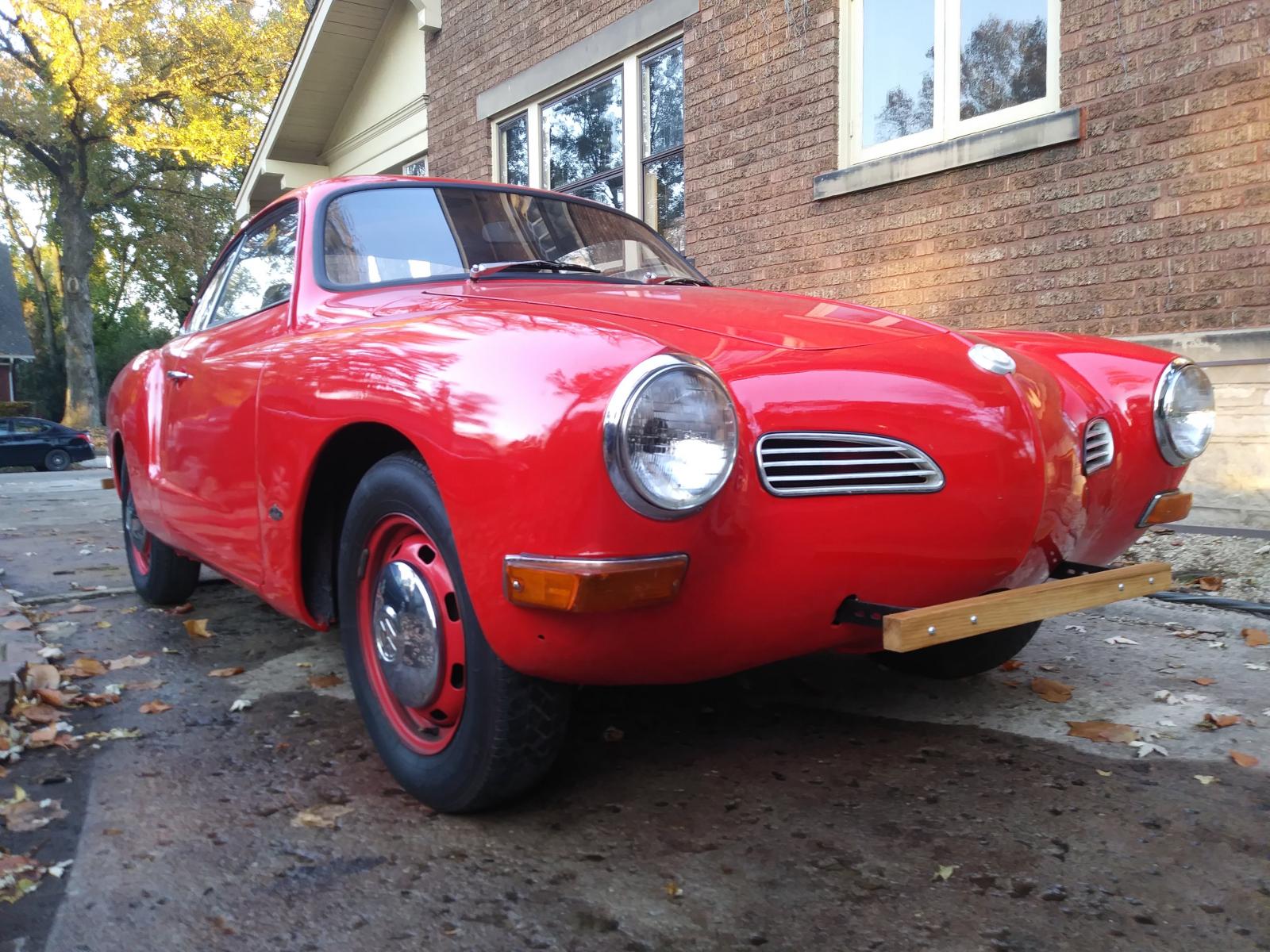

Here's how it looked. It needed a fuel pump and battery to start and some wiring to sift.

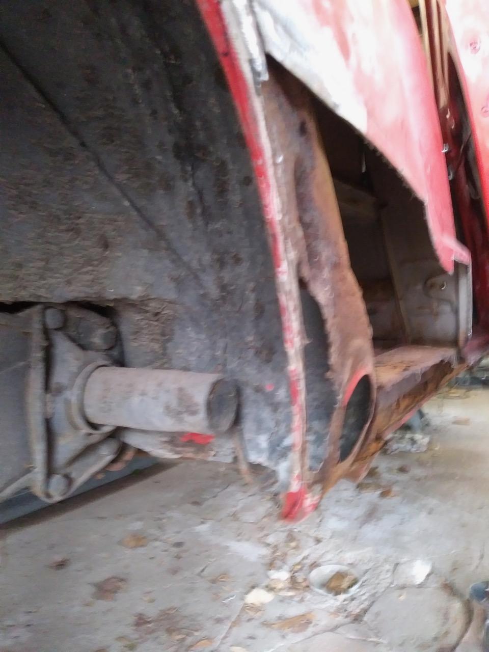

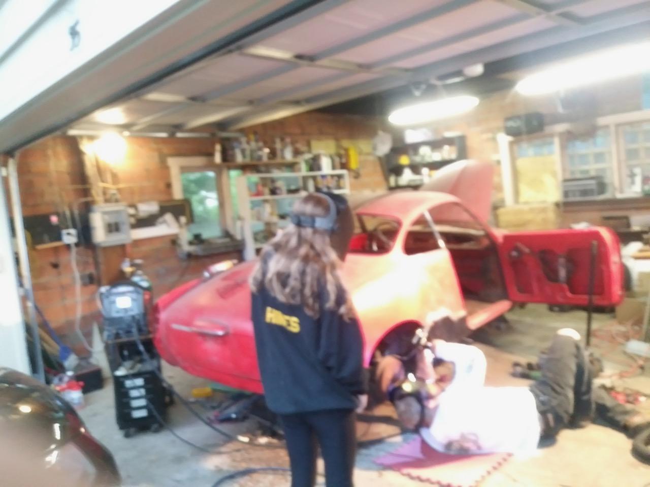

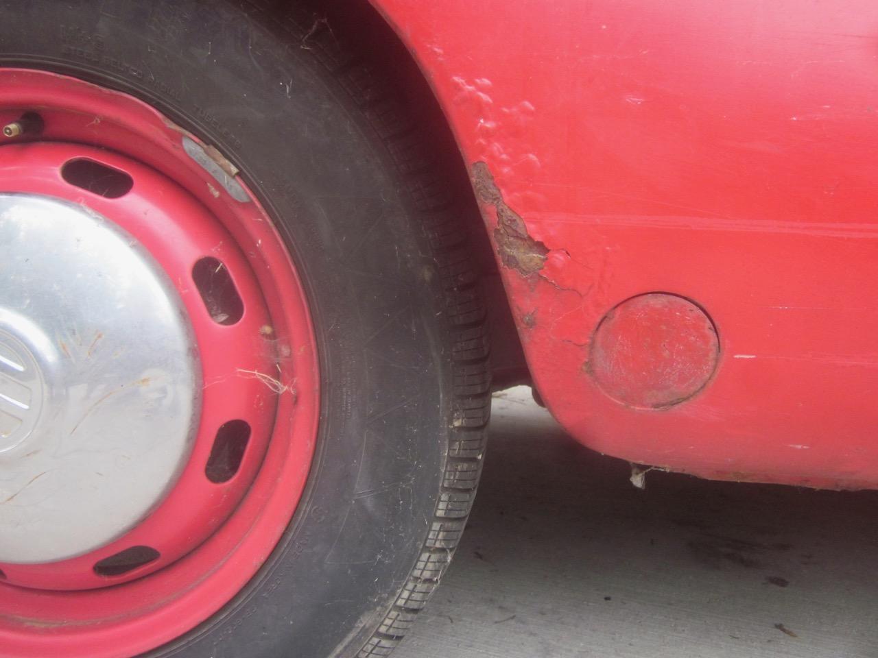

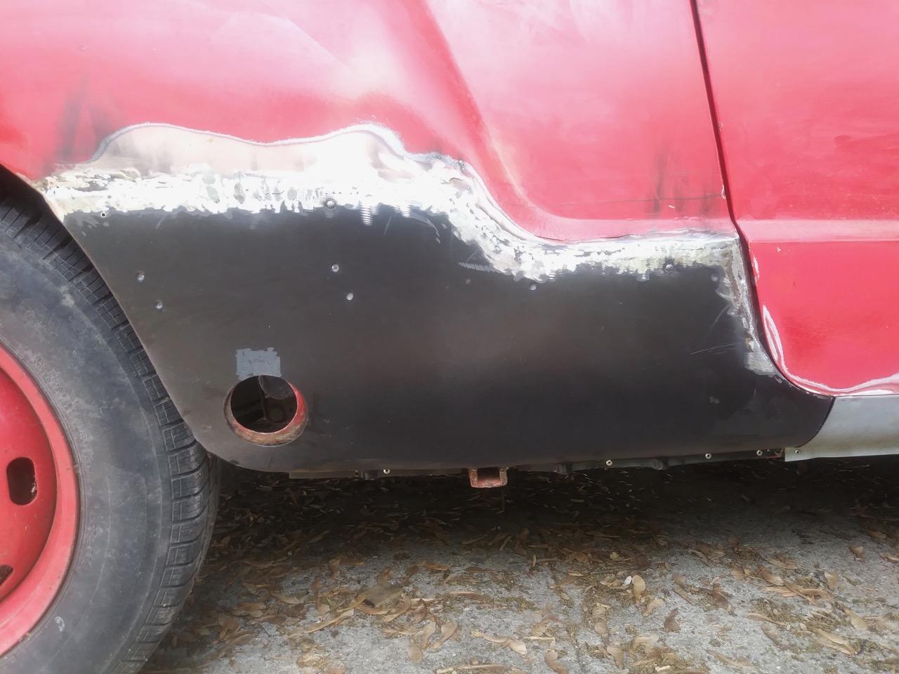

I saw plenty of rust on it. I didn't realize how much until I started chipping away at it.
I am new to welding in pieces. My first welding was on a 67 Volvo I restored for a friendd last year.
Here is the passenger side:

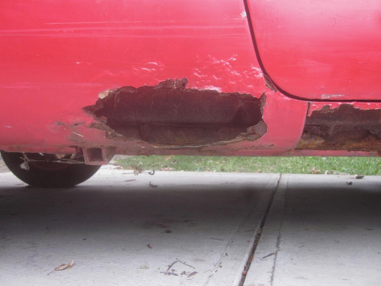

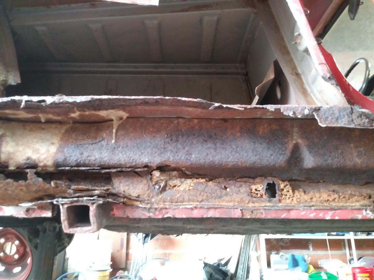

rust removal -pass side
As I started picking away at the rust, I found it more extensive than I anticipated. Icut away what you see here. Then I ground, scraped, sanded, and chemically treated any exposed rust. I did not eliminate rust from this car. It was not going to be worth the time investment. So, I made it good enough for what I was willing to put in it and get out of it.

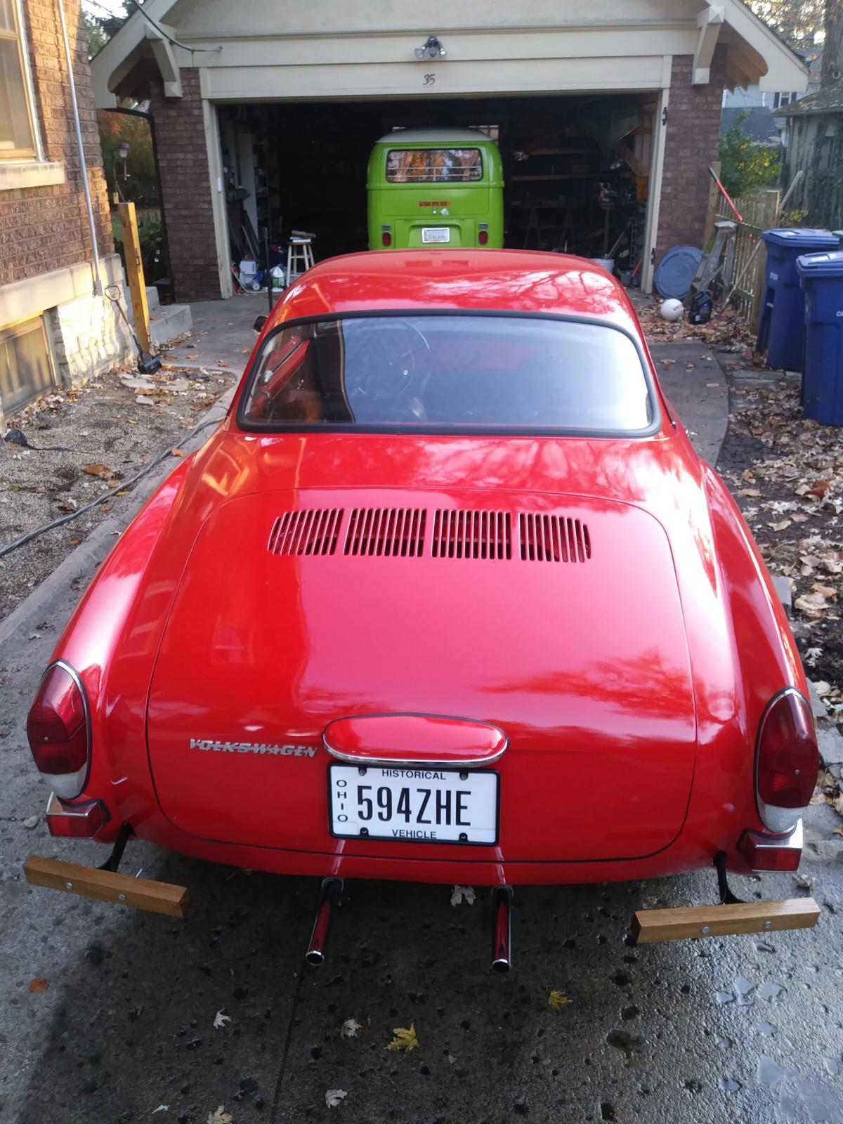

PostPosted: Wed Nov 06, 2019 11:20 pm    Post subject: Re: 1971 VW Karmann Ghia Coupe runs in my blood Reply with quote

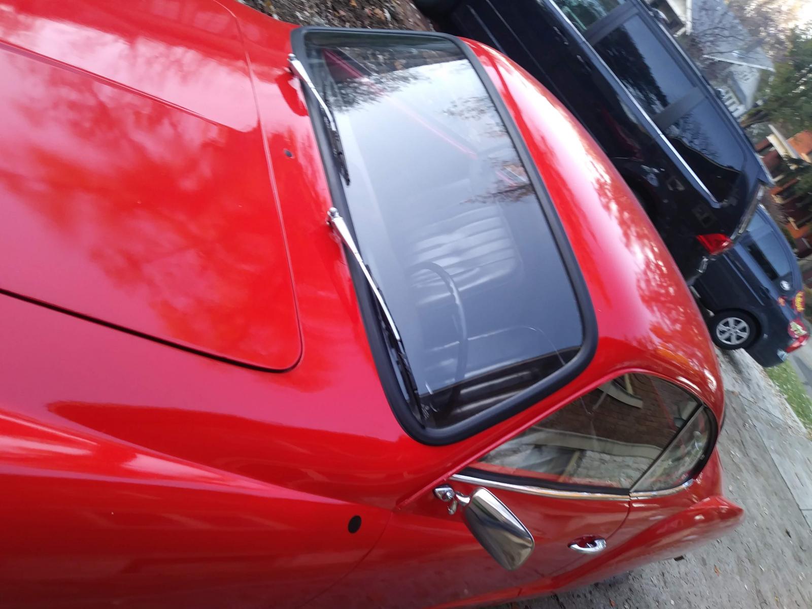

Primer and paint

PostPosted: Thu Nov 07, 2019 6:06 am    Post subject: Re: 1971 VW Karmann Ghia Coupe runs in my blood Reply with quote
bruehoyt wrote:
Primer and paint
Haha, looks like you painted the tires too!
Love the color!

PostPosted: Thu Nov 07, 2019 6:09 am    Post subject: Re: 1971 VW Karmann Ghia Coupe runs in my blood Reply with quote
bhartwell59 wrote:
bruehoyt wrote:
Primer and paint
Love the color!
It came to me with Red Wheels. I just cleaned them up. I sprayed some Tire Wet on the tires for the pics.
I was going to paint it the stock color, but it was half teh price to use a 90's VW paint code that was close.

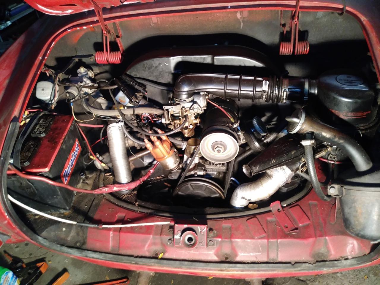

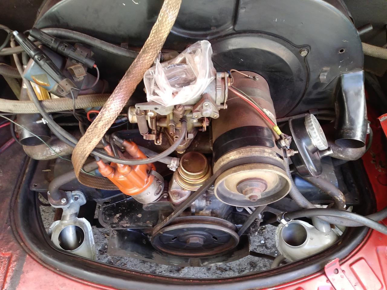

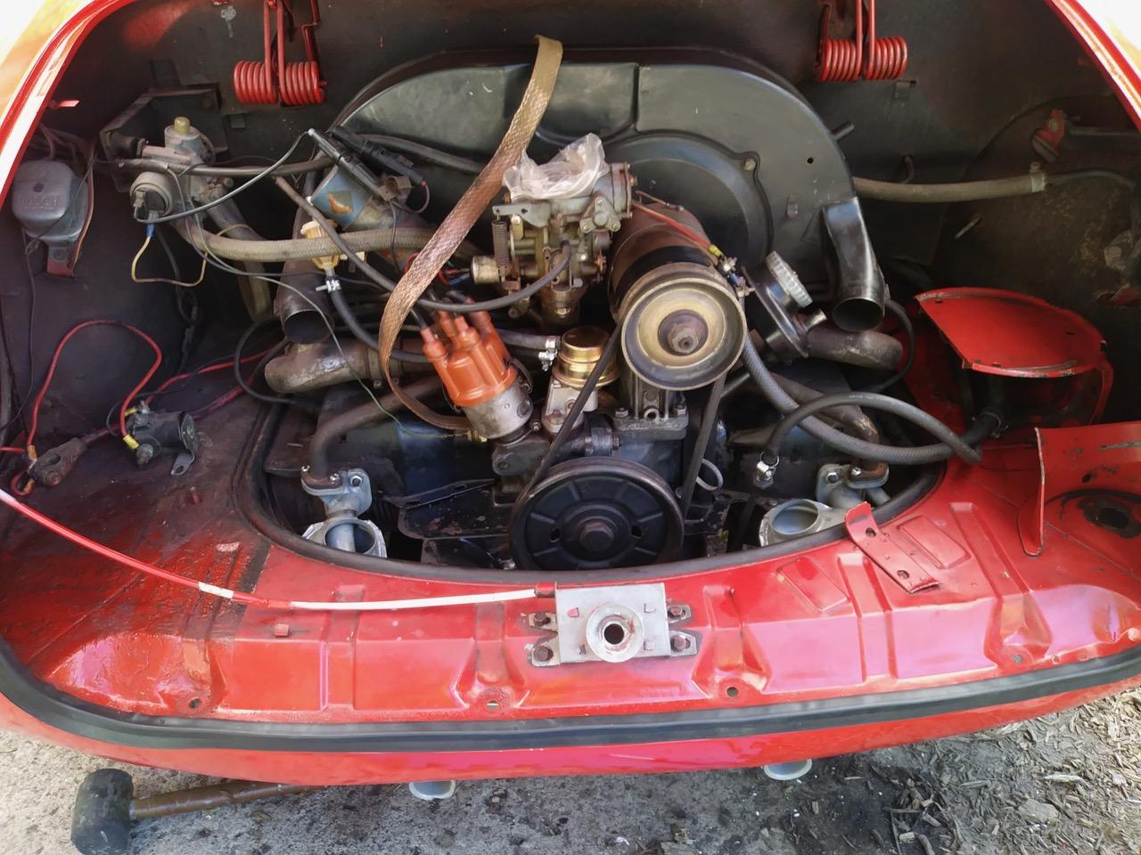

Engine bay: Nothing special here.
I replaced the fuel pump before this pic to get it home.
I took out external pieces to get to bodywork. I cleaned up and painted what I took out.
New ground strap, battery, fan hoses, stock exhaust and pipes, fuel pump, fuel filter, oils gaskets, points, spark plugs, plug wires, belt
Carb rebuilt, valves adjusted.
Eliminated a hard start relay. Cleaned electrical connections.

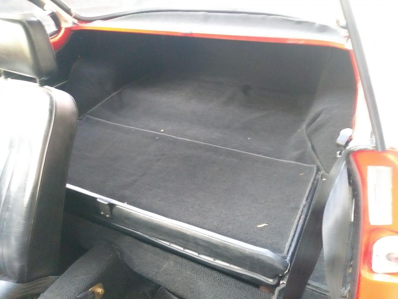

Passenger seat upholstery - I covered it. I made a cushion -foam wrapped in vinyl.
Driver's side repaired with clear adhesive vinyl repair. The seats are what they are. If I find a great price to reupholster or replacement seats, I might do it.

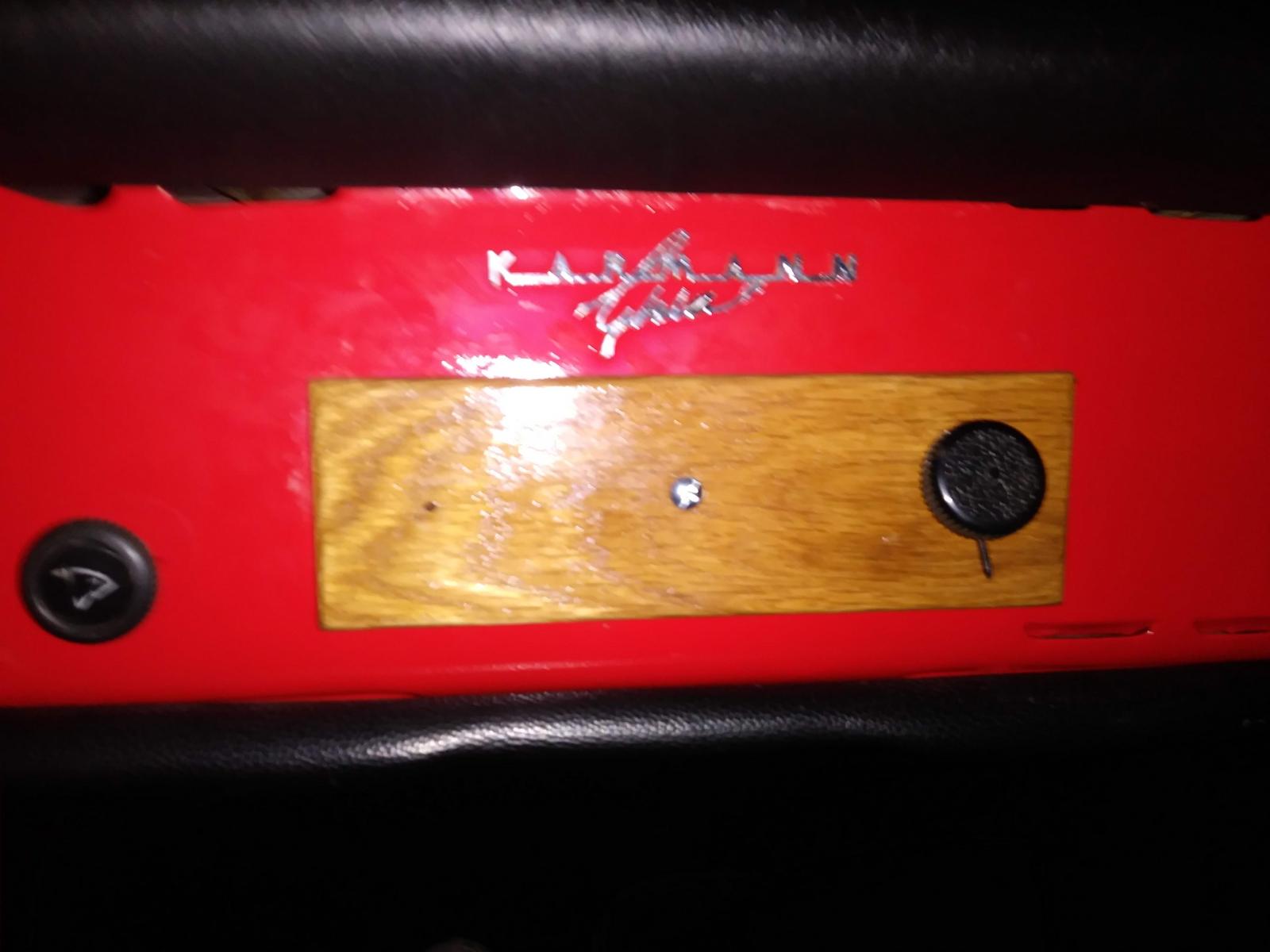

Interior lights were added. LED with a lit blue toggle switch in the aux heater dash hole.
